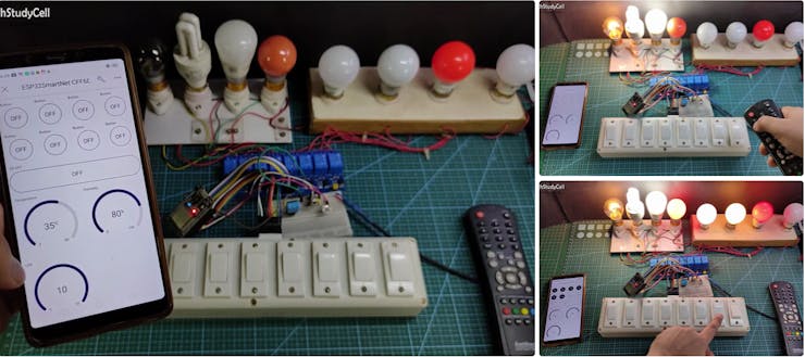

Before designing the PCB, I have made the complete circuit using ESP32, an 8-channel relay module, sensors, and manual switches.
As you can see, the relays can be controlled from the Blynk IoT app, IR remote, and manual switches.
If the WiFi is not connected with ESP32, still you can control the appliances from manual switches and IR remote.
Control Relays With Blynk IoT App:
If the ESP32 is connected with WiFi, then you can control the home appliances from Blynk IoT App.
You also use multiple smartphones to control the appliances with Blynk App. For that, you have to log in same Blynk account from all the smartphones.
In this way, all smartphones will be sink to the Blynk server. You can control, monitor the real-time status of the relays, room temperature & humidity from anywhere in the world in the Blynk IoT App.
If the ESP32 is not connected with WiFi, still you can control the appliances with IR remote and Manual Switch without internet.
ESP32 Control Relay With IR Remote:
You can always control the relays from the IR remote. For this project, you can use any IR remote.
You can monitor the real-time feedback in the Blynk IoT App.
I have explained how to get the IR codes (HEX codes) from any remote in the following steps.
Control Relays Manually With Switches:
You can also control the relays from the switches or pushbuttons.

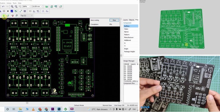

Designing the PCB for ESP32 IoT Projects:
To make the circuit compact and give a professional look, I have designed the PCB after testing all the features of the smart relay module on the breadboard.
You can download the PCB Gerber file of this home automation project from the following link:
Download the PCB Gerber File

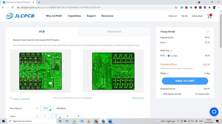

Order the PCB from JLCPCB:
After downloading the Garber file you can easily order the PCB

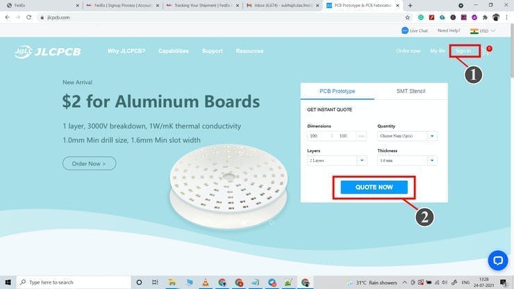

1. Visit https://jlcpcb.com and Sign in / Sign up
2. Click on the QUOTE NOW button.

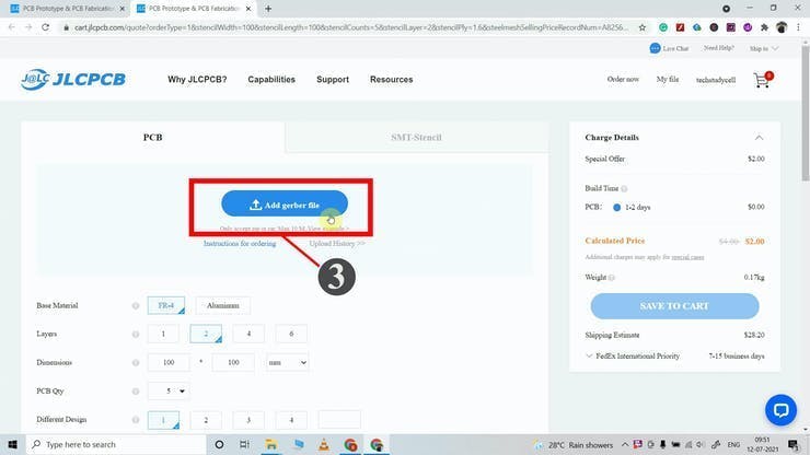

3. Click on the "Add gerber file" button. Then browse and select the Gerber file you have downloaded.
Uploading the Gerber File and Set the Parameters:
4. Set the required...
