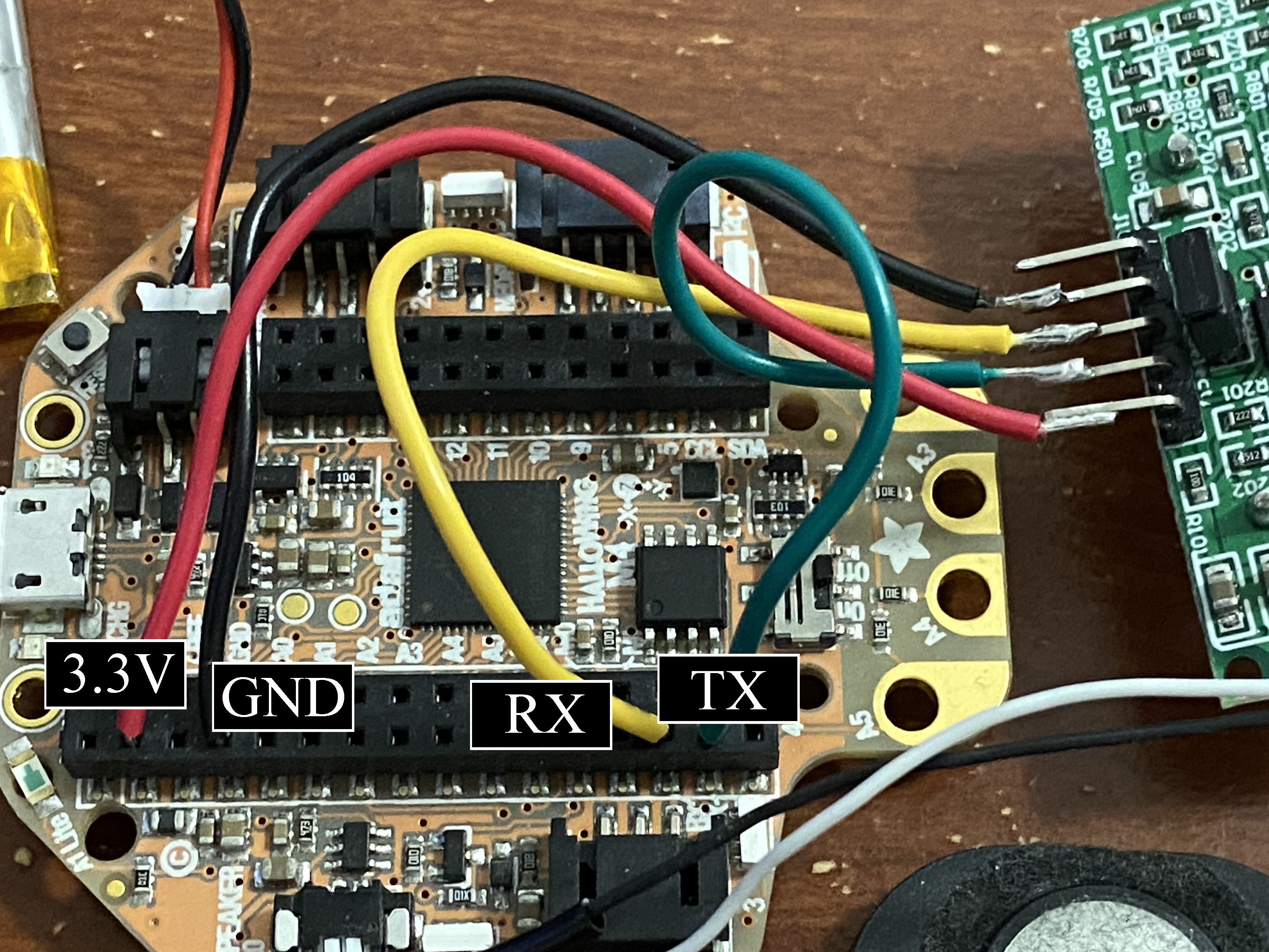

5Assembly
The Hallowing fits on the posts in the center of the tombstone base. I found room on top of it for the battery to sit. The distance sensor fits into the two holes at the bottom and the speaker plugs into the Hallowing and can sit loose or be mounted in the indentation on the back plate.
Hooking the UC-100 sensor to the hallowing is the trickiest part of the assembly. I soldered wires to the sensor that fit into the Hallowing feather ports. The sensor labels what each pin is. Ground and VCC go to the Ground and 3.3V holes on the Hallowing.
The RX/TX pins go to the RX and TX holes on the Hallowing. This is important as some sensors have RX go to TX and vice versa. Not for this sensor.
You can either hope things hold in place or use a small amount of hot glue or tape to hold the wires and components in place. You could also get a ProtoWing that can mount into the Hallowing and then solder the wires from the sensor to the ProtoWing.
