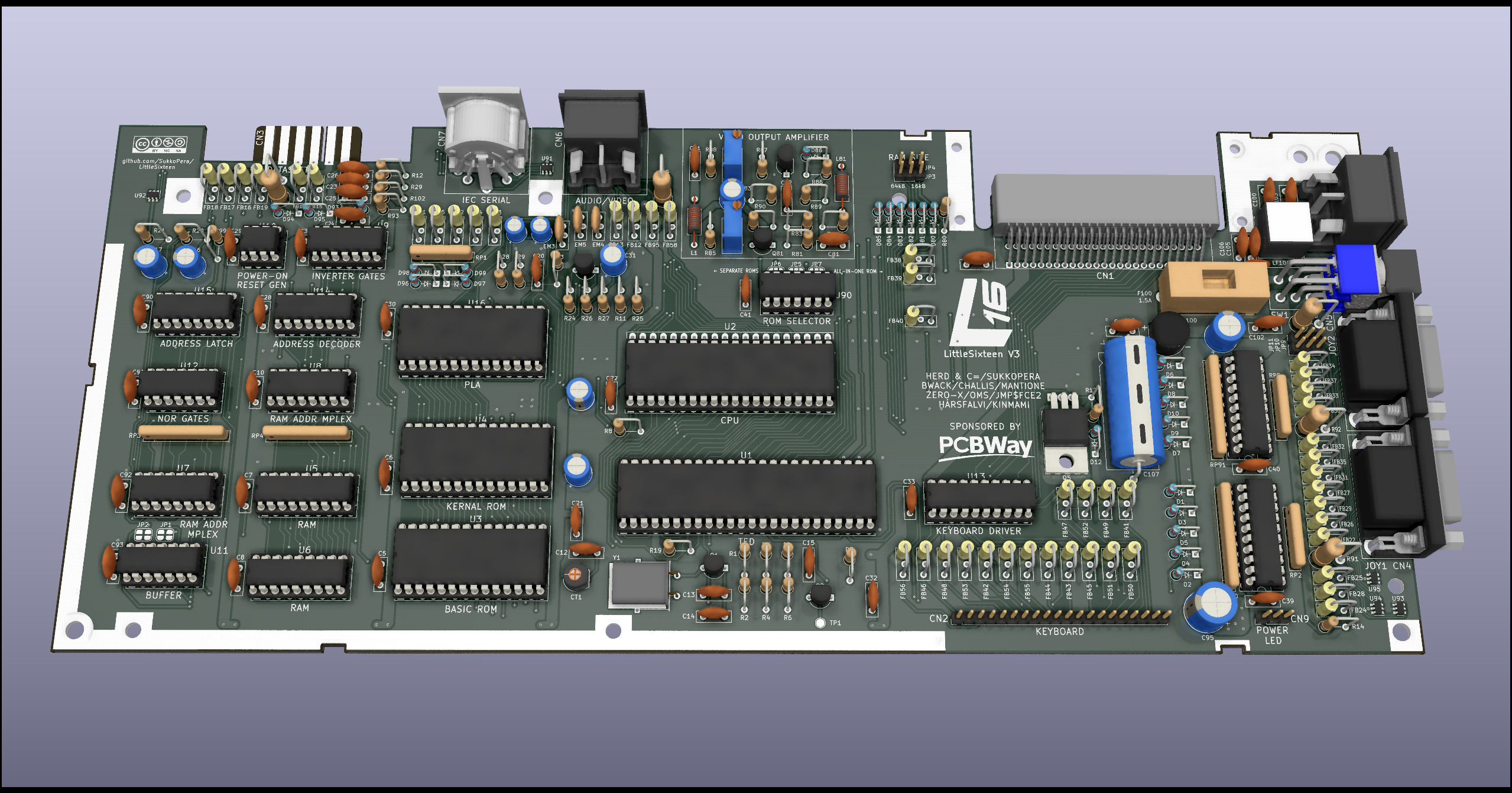

When I embarked on this new development, the first concern was to make the two-layer board robust from a power management and safety point of view. We knew that the CPU and TED should be fully ESD protected, I/O ports changed to Commodore 64 style and few additions to the original concept without spending a fortune.
Given the limited size, reducing the loop area seen by signals on the two-layer PCB—to achieve a better, not optimal noise reduction—was the headache. The approach was to define a critical netlist and to place components accordingly. The adoption of Through-Hole Technology components (except for the tiny ESD protection) was a compromise to preserve the early 80s design. However, the logics are HCT, not LS as well as all parts available on the aftermarket and official disty.
The machine works flawlessly providing superior audio and video performance, low power consumption and compatibility with the 1530 Datassette Unit (C2N model), SD2IEC, Atari joysticks and pads.

01/30/2022 at 13:26 • 0 commentsAfter endless additional tweaking, I thought it was about time to order the first board prototypes.
PCBWay let us have 5 boards with ENIG gold surface finish. They will be shipped straight to Edoardo in Japan, who will review them, forward some to me in Italy and finally patiently assemble one.
Of course we found something that we wanted to change like 5 minutes after the order was placed, but oh well...

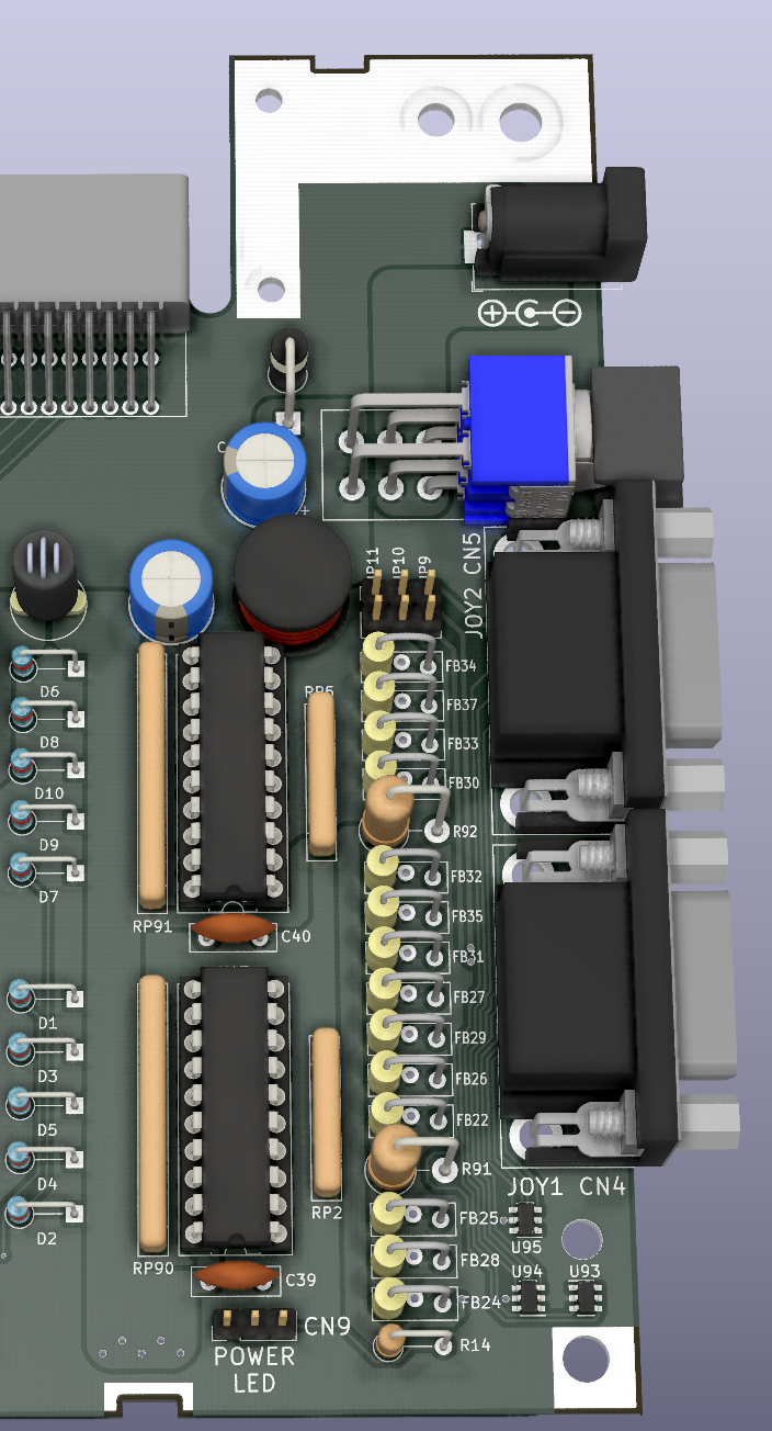

01/13/2022 at 21:05 • 0 commentsAfter a lot of thought, I decided to replace the Mini-DIN-8 joystick connectors with standard DB-9's. This might be a controversial decision, but I really think there is no point in keeping that odd connector since it's very hard to find a joystick that is using it. We are not making a replacement board for damaged C16s but rather trying to bring the C16 into the future so there's no reason to strive for compatibility with a dead standard, if a standard it ever was!
I put the +5V power rail on pin 7 of the DB-9 port as the Amiga and C64 do, but I also left the option to connect it to pin 5 as required by Sega Mega Drive controllers. You will have to close a jumper to do so (JP9/10) as this can be dangerous in certain cases. Don't do it, unless you know what you're doing.
Replacing the joystick connectors forced me to replace the power switch too, as the original one is wider and would clash into the DB-9 ports. This is actually good news though, since the original one is nowhere to be found and the C64 switch is a perfect substitute both electrically and mechanically. The exact original C64 switch might not be easy to find either but there are a few alternatives. Let me quote this post by Lemon64 Forum user Skyfox:

01/04/2022 at 22:49 • 0 commentsThe most attentive of you will surely have noted those cylinders that are bigger than the others in the pic I posted a few logs ago:
Those are current-limiting resistors, which I added in order to prevent drawing "too much" current from the I/O connectors: if anything draws more current than expected, they'll "burn" and fail open-circuit. This might sound a bit crude and in fact it's not the best way to implement such a feature, but it's a good compromise in price/simplicity vs. effectiveness and definitely better than what the original boards have (i.e.: nothing). It's the same technique used in the A500/600/1200 for instance. The Big Box Amigas use a better design with a dedicated power rail (ever heard of +5V_USER?) but they have big internal power supplies with a lot of cables and sometimes even a dedicated power plane on their PCBs. We'll take it into consideration when we design an ATX-format Commodore 16, LOL! :)
Anyway I have added resistors on all the I/O connectors having a power line. You can always replace them with a short piece of wire if you don't want this additional protection.
Before you ask, there is no resistor for the IEC Serial port since it has no +5V pin, as already mentioned. On the other hand, while I was adding the one on the A/V port I noticed that the original board has no EMI protection ferrite on its +5V pin. I'm assuming it was left out because the design was already pretty tight, but I managed to squeeze one in. That's the icing on the cake :).
