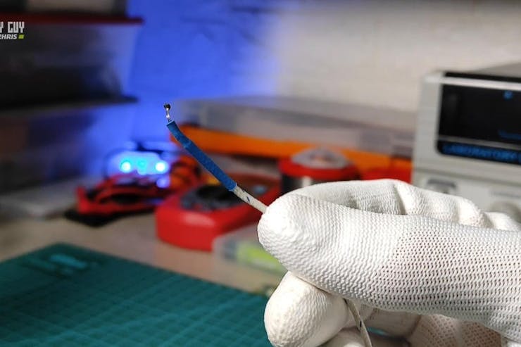

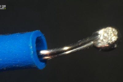

I attached in the above images the digital microscope camera view of the thermocouple that I will use : )

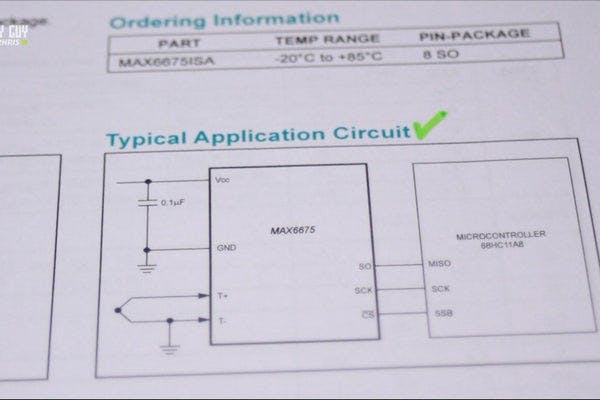

Considering the circuit datasheet, it says that the IC performs to digitizes the signal from a type-K thermocouple sensor, the chip has a simplified SPI communication port and designed to work in conjunction with an external microcontroller, it has a good conversion resolution and a high temperature mesurment range that could reach 1024°C which makes it suitable for many industrial applications.
You can also find the appropriate schematic setup for your circuit layout.

Don’t forget to follow the datasheet recommended setup that shows the need of a 0.1uF decoupling capacitor placed in the power line of the MAX circuit, I also dropped two screw header terminals where I plug-in the thermocouple sensor
