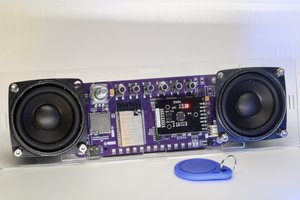

In short, the radio contains a several components :
- ESP32 microcontroller board
- SI4732 radio chip
- 2.8 inch TFT colour display with Touch screeen
- Small D-Class power amplifier board
- Speaker
- Lithium Battrey 3.7 Volts
- Lithium battery charger
- Upconverter board 3.7 to 5V
- Rotary encoder
- and Potentiometer
Si4732 chip can be purchased on Aliexpress at a price of about US $ 10 for one piece, or US $ 21 for 5 pieces. Now the Radio has new firmware from Gert Baak with more visual and functional improvements.
