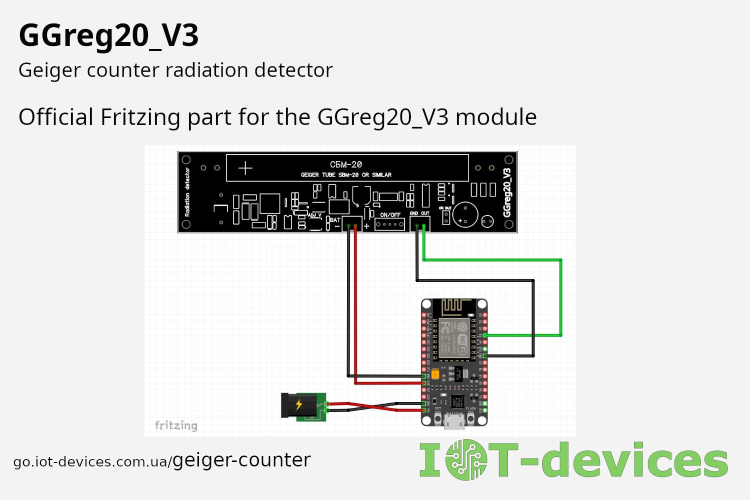

Dimensions and Pin assignments
GGreg20_V3 module pin assignments are as follows:
  • BAT - Power supply input 2.2V - 5.5 V;
  • ON/OFF - Main switch on/off;
  • OUT - Pulse output, active-low;
  • BUZ - Buzzer enable jumper.
The dimensions of the GGreg20_V3 module are as follows:
  • X: 126 mm;
  • Y: 30 mm;
  • Z: 12 mm.
