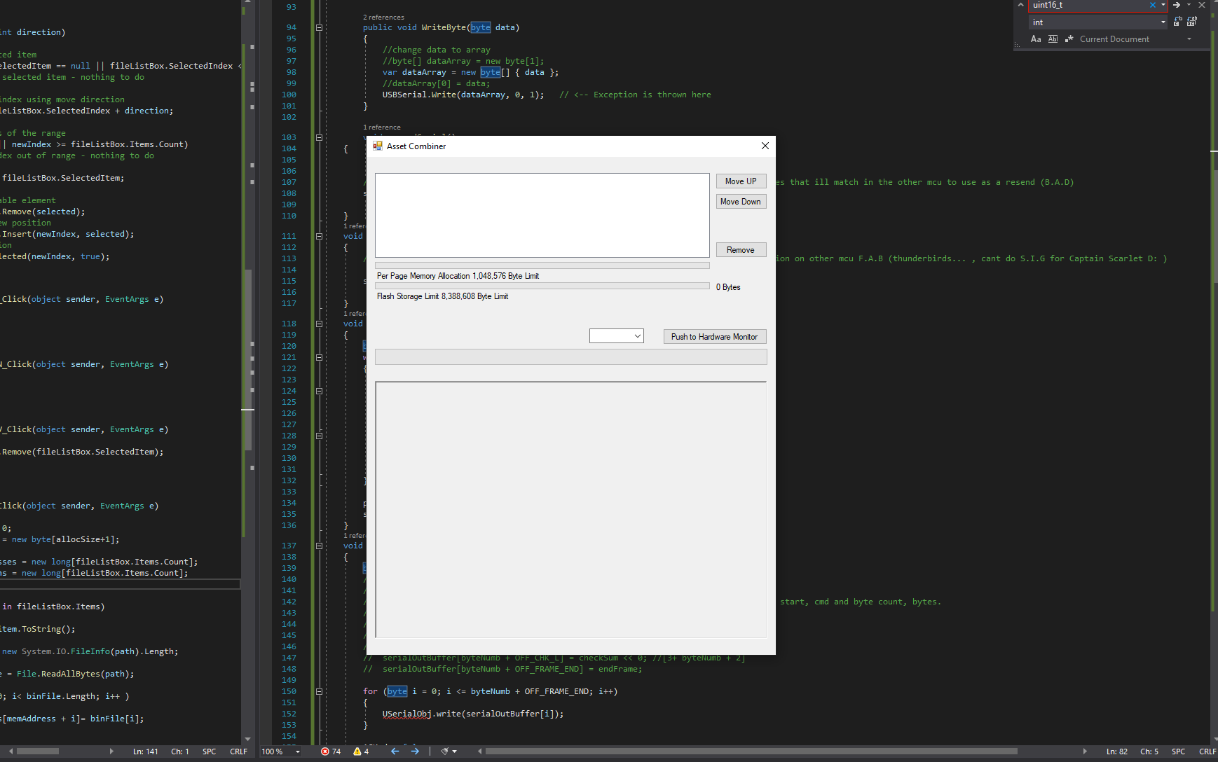

    I could tweak my asset combiner code, put in a separate entry box for font assets, and in the program stream the data from the binaries, making sure to calculate the new locations these will go, and inject those addresses into the bytes 144-148 in the font assets steam before pushing to flash.
    And it works :D
    Im so glad I finally got round to learning desktop apps. no idea why I didnt do this far sooner.

    Anyway the flash is working now. And now I need to finish the asset file combining and pushing app im currently putting together.
    The combiner I think is working. But I think I might have a carrying the 1 bug to deal with. But I want to test first.
    Currently adapting my framed serial code to c#, then I can figure out a good protocol to push the asset binarys to the flash.
