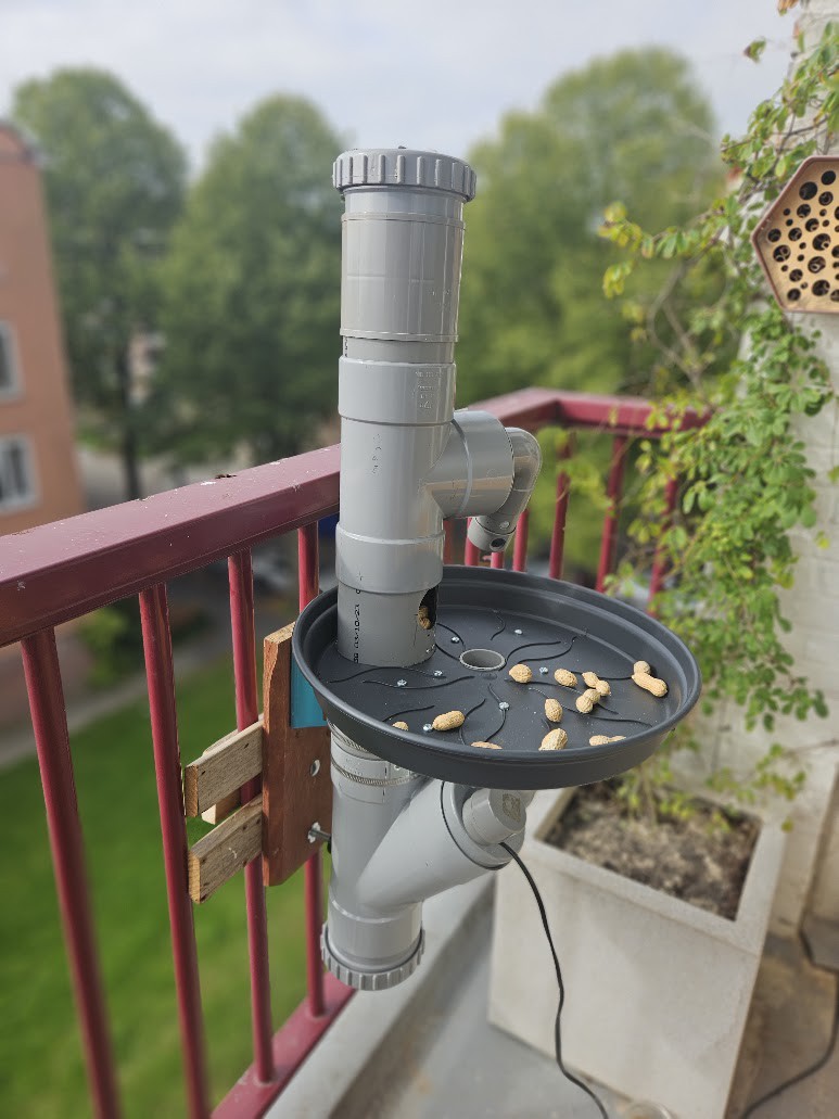

  • VMFB Everywhere
    Stephen Chasey • an hour ago • 0 comments
    I've partnered up with Crowbuddy to get some VMFB's in the hands of corvid enthusiasts, and have deployed the first one in Diemen near Amsterdam.
    Here's the device we installed (on my own balcony during testing).
    This will be a real test of reliability, durability and effectiveness. Instead of being babysat by a tech nerd it will be used by academics who expect it to just work with no fuss. I also hope to get some interesting data and insights from these devices operated by other people.
    I'm already working on a next version of the software with more features like cloud upload and remote operation (no wifi) and so I can upgrade from a Raspberry Pi Zero W to a Zero2 W. Someday I will port it to an ESP32, but while adding features like this it's easier on the Pi.
    Big thanks to Crowbuddy for kicking this off with me!

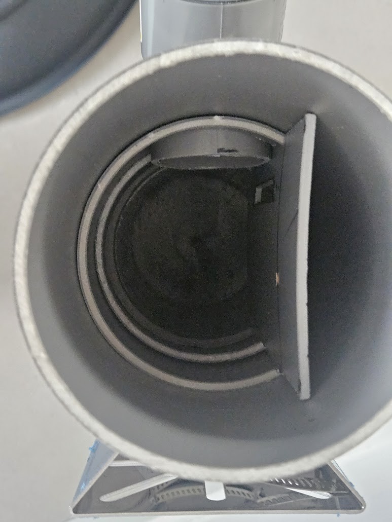

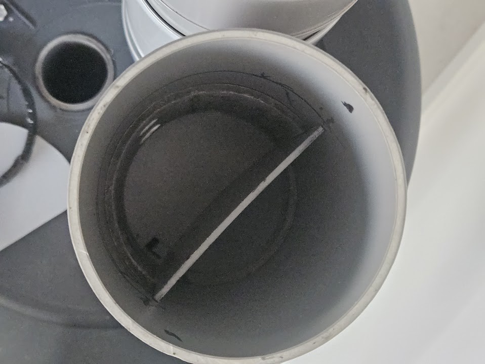

  • Baffle angle and clearance
    Stephen Chasey • 11/27/2025 at 14:51 • 0 comments
    I've been having more dispenser jams with the new design and the reason turn out to be the increased baffle angle. I made it steeper thinking it would make sure the peanuts would roll off of it onto the vibration platform. The side effect is more lateral force on the peanuts. Peanuts in the shell are relatively light (compared to shelled nuts) and have a rough, irregular exterior - even a little lateral force is enough to jam them up.
    So I'll be going from ~30° incline back to a ~15° incline to fix this. Otherwise, everything is working well.
    UPDATE
    The angle of the baffle is somewhere between 20° and 30°, about the minimum for unshelled peanuts to reliably roll off of it so none get left behind. On the old baffle, there would be a few peanuts sitting on it once the hopper was "empty". Instead of reducing the angle I cut a couple square cm from it and raised it about one cm to leave more clearance for the nuts to pass by.
    This seems to have fixed it - no more jams within the dispenser and quick, reliable dispensing of 1-2 nuts per dispense.

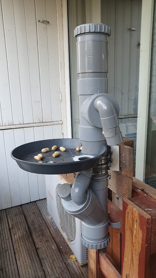

  • Redeployed
    Stephen Chasey • 11/10/2025 at 21:17 • 0 comments
    After a couple more tweaks, I turned it on and left it in timed dispense mode. The magpies and jackdaws remember it as a food source (even with a slightly different enclosure) and are visiting it already.
    I extended the dispense pathway tube to allow for a better fit for the mounting bracket and cleaned up the hose clamp mess by removing two of them. - now three hose clamps secure the mounting bracket and two of those also secure the platform. The fourth one below them secures the deposit assembly.
    The mounting setup is improved a bit as well. You can mount it on a wall or fence with just one screw. Three adjustable feet provide additional support and levelling.
    There are of course a couple more tweaks to the enclosure I want to make, but this is pretty close to final form as far as 110mm PVC goes. So it's open for business. I hope to make some progress with these birds in the coming weeks.

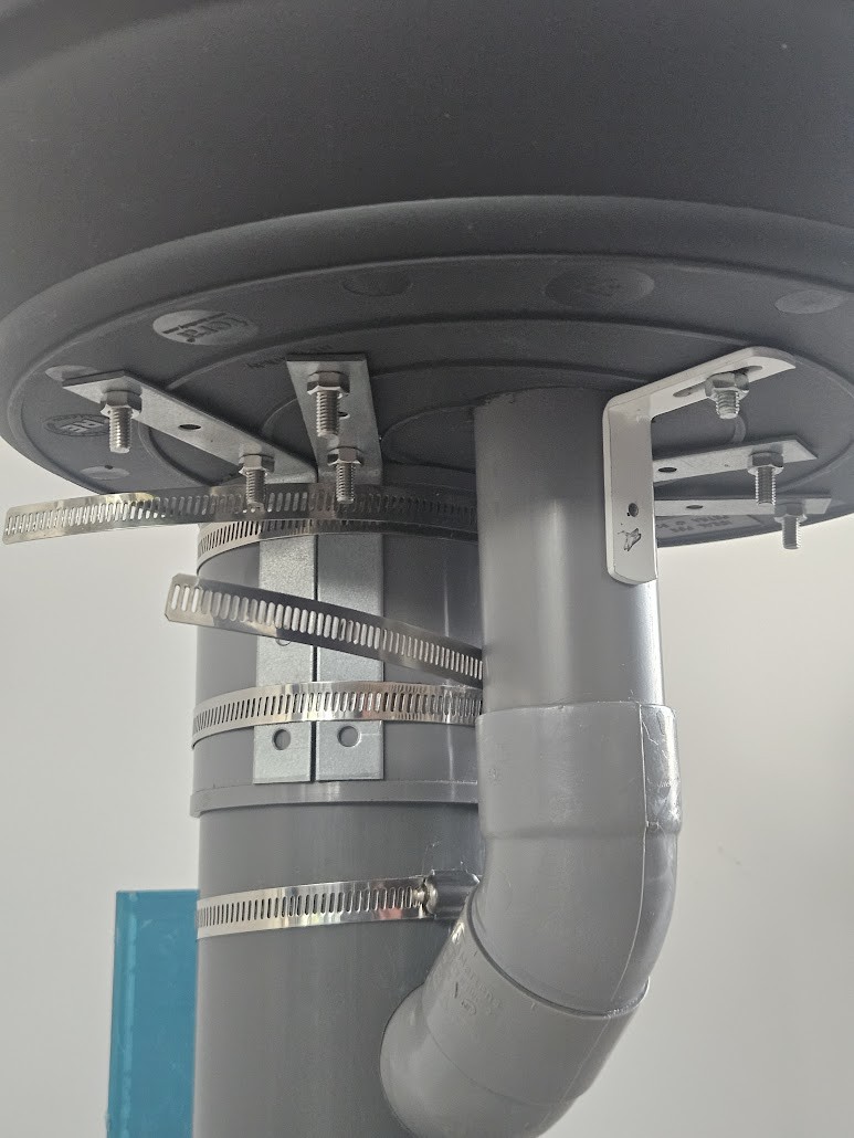

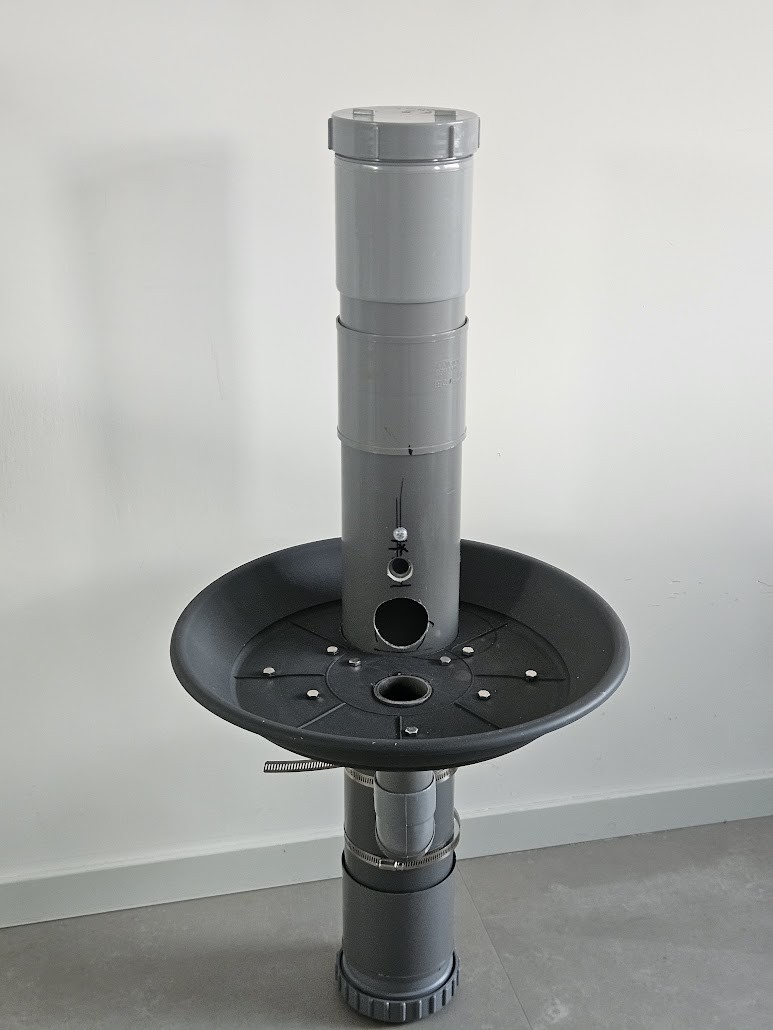

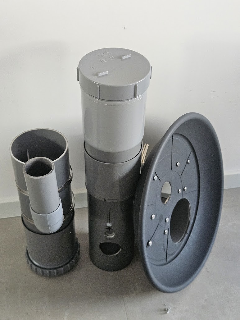

  • New Enclosure and Mechanicals
    Stephen Chasey • 10/21/2025 at 20:29 • 0 comments
    So I made the following improvements to the enclosure and internals.
    • The feeder is now 86cm (34in) tall (down from over a meter on the previous version)
    • Fewer parts and materials (and shorter wires) required to build
    • PIR sensor moved to camera arm
    • Dispense path is more difficult to jam
    • Deposit pathway is shorter and easier to mount the sensor on
    • Better way of placing internal baffles
    I've tested it, but have left it turned off for now. I'll first turn it on and let it run on a day I can work from home to monitor it. It took a bit of tweaking to get everything to fit while keeping it simple.
    Here's what it looks like now vs what it looked like before.
    Now
    Before
    I tried using one of those pole mounts for lights and cameras, but in reverse. I got this for 11 EUR on Amazon.
    It works prety well, but the feeder still needs a secondary point of support below the mount. I used a leftover bit of 110mm PVC pipe for this, but will hopefully think of a better way soon. If you are looking for hose clamps, sorry, I'm using all of them right now.
    The enclosure is now basically 4 sections. Here they are, and the parts they're made of.
    1. The deposit assembly.
    2. The dispense platform
    3. The electronics
    I was too lazy to disassemble the camera arm - it consists of:
    • 110mm to 50mm adapter
    • 50mm 90° elbow joint
    • ~10cm length of 50mm PVC pipe
    • ~3cm 200° arc of 50mm PVC pipe to secure the PIR lens
    • 50mm PVC end cap
    • small piece of transparency to protect the camera lens
    4. The hopper and dispenser
