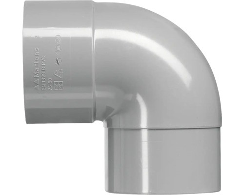

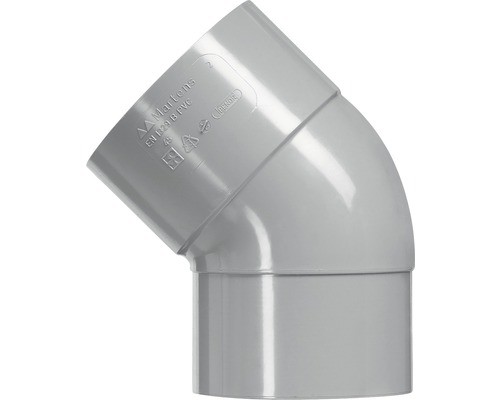

    110mm T-joint 45° 3x glue joint1
    110mm T-joint 90° 3x glue joint
    1

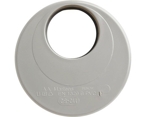

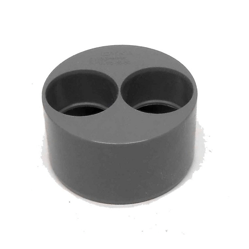

    110x50mm eccentric adapter1
    110x50x50mm eccentric adapter1

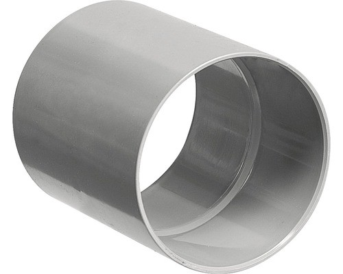

    110mm straight joint1
    110mm screw-on end cap2
    50mm elbow joint 90° (male-female)2
    50mm elbow joint 45° (male-female)1

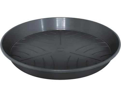

    Ø~32cm plastic plant pot saucer1

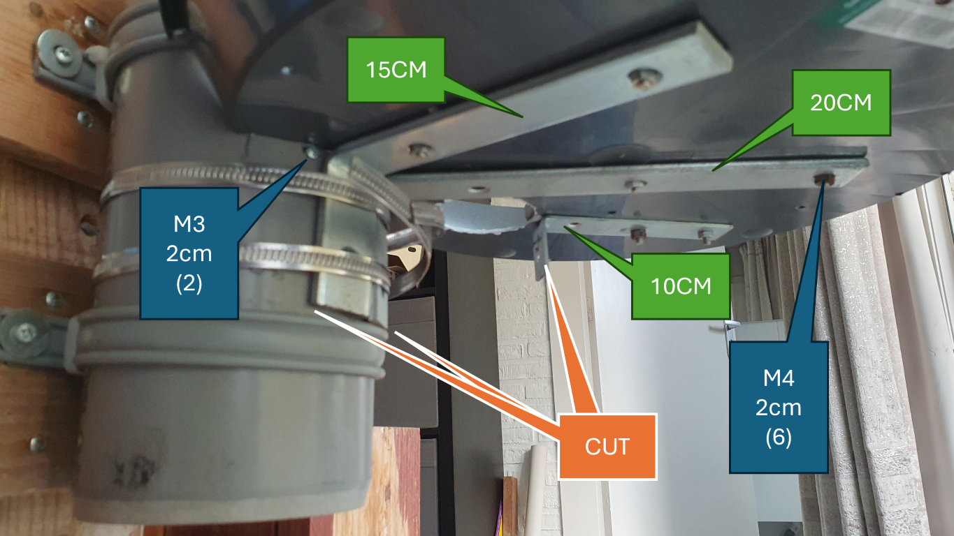

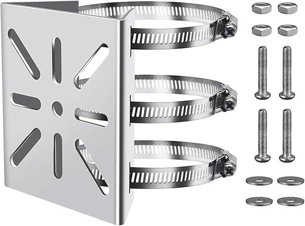

    Mast mount to fit 110mm PVC pipe1

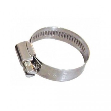

    Hose clamp to fit 110mm PVC pipe1
    Hose clamp to fit 50mm PVC pipe1

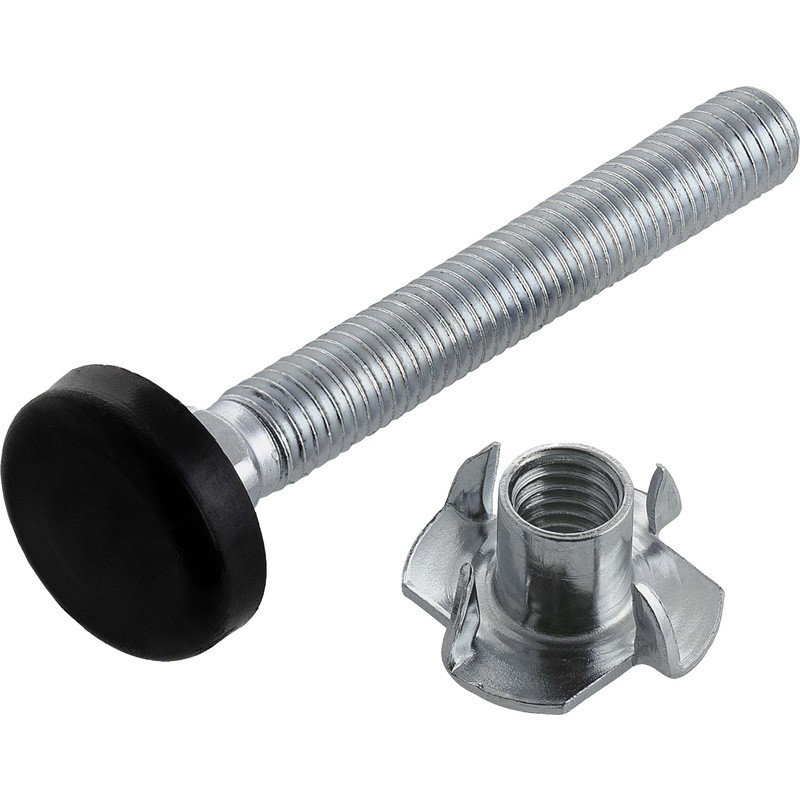

    Adjustable foot - 6-8cm3
    Hanging plate1
    20cm L brace
    15cm L brace
    10cm L brace
    M3 2cm bolts, washers and nuts
    M4 2cm bolts and nuts

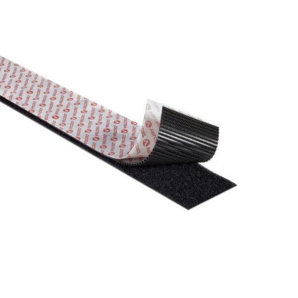

    Velcro tape~15cm

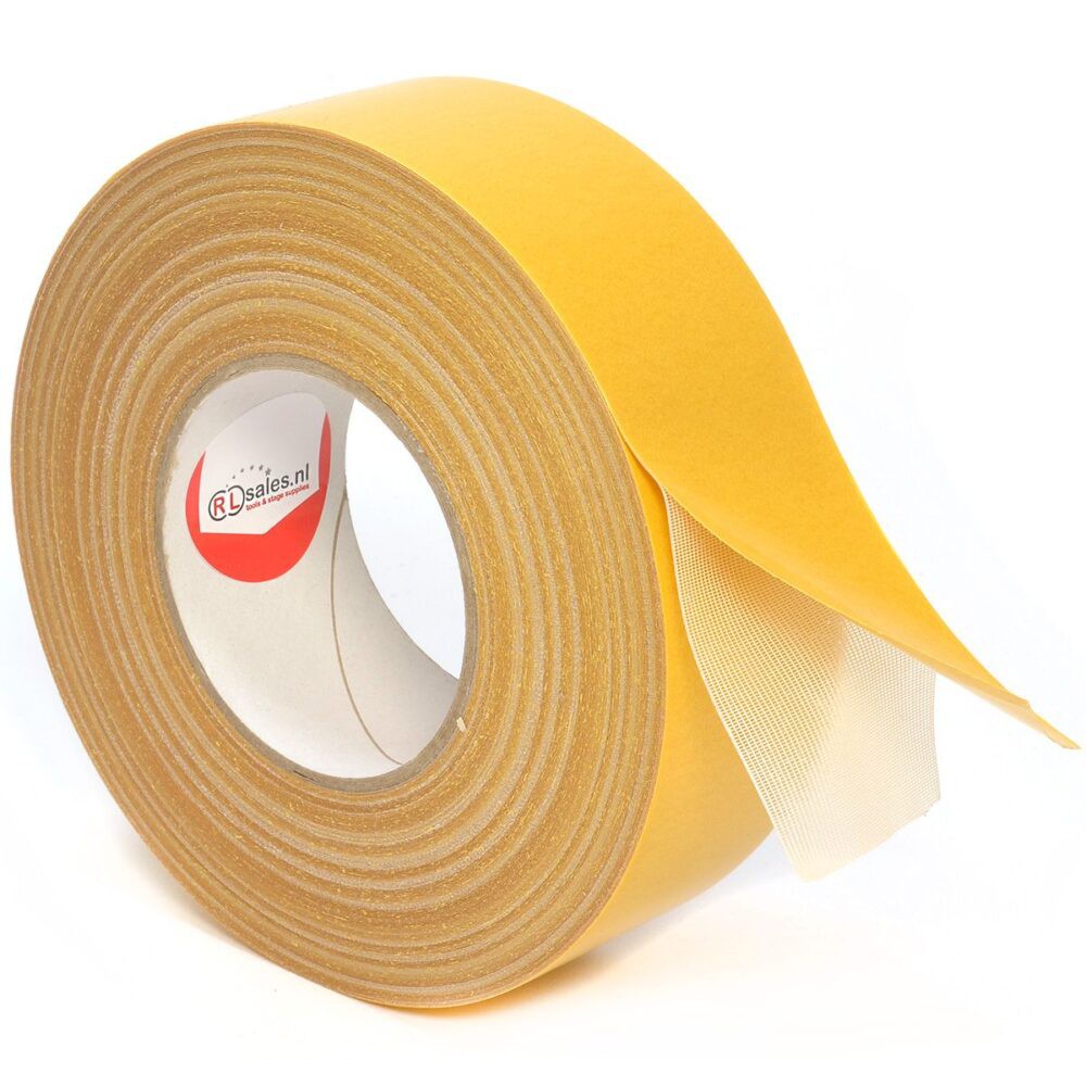

    Carpet tape~20cm

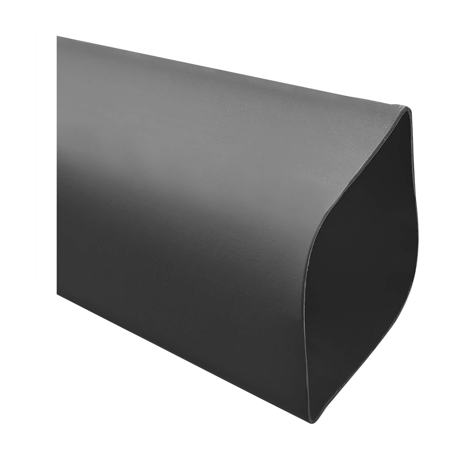

    Black shrink tubing - 3+cm diameter30cm

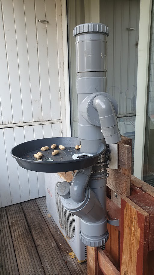

    A vending machine for birds that rewards them with food when they drop something in a hole. Electronics and enclosure materials cost <100 USD/EUR. I've designed a PCB and PVC pipe enclosure and dispenser (described below). The circuit is not complex, but I think a custom PCB makes it easier for people who are not electronics hobbyists to build this.
    This project is a continuation of the analog Vending Machine For Birds. I wanted to make a device that could be more useful to researchers, which meant monitoring, logging and control. For this version I also adjusted the dispenser design to dispense unshelled peanuts to avoid feeding pigeons while still attracting corvids.

    MAIN FEATURES
    • portable
    • saves power until a warm body is present
    • battery or mains powered
    • one moving part
    • accessible components and materials
    • rodents can't break in and get the food
    • remote monitoring, logging and control
    • cheap to build
    • customizable
