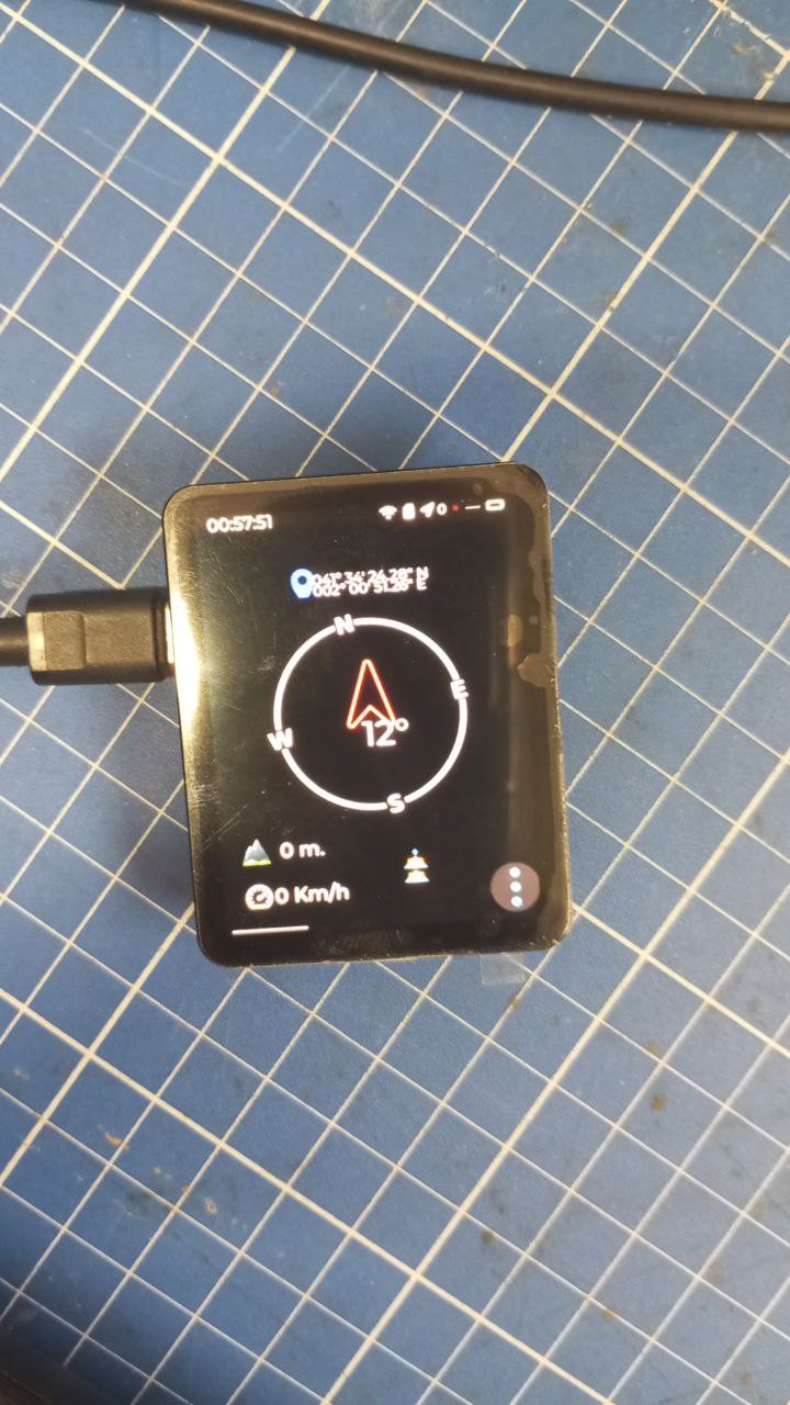

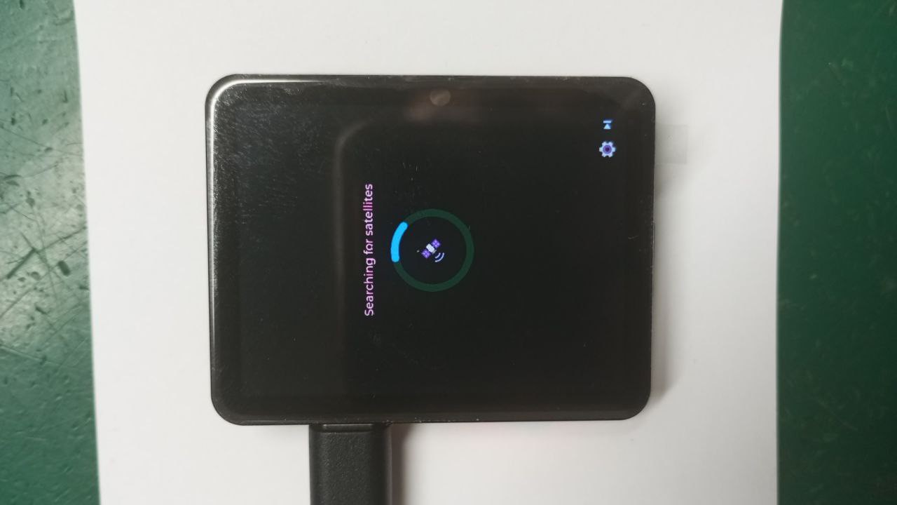

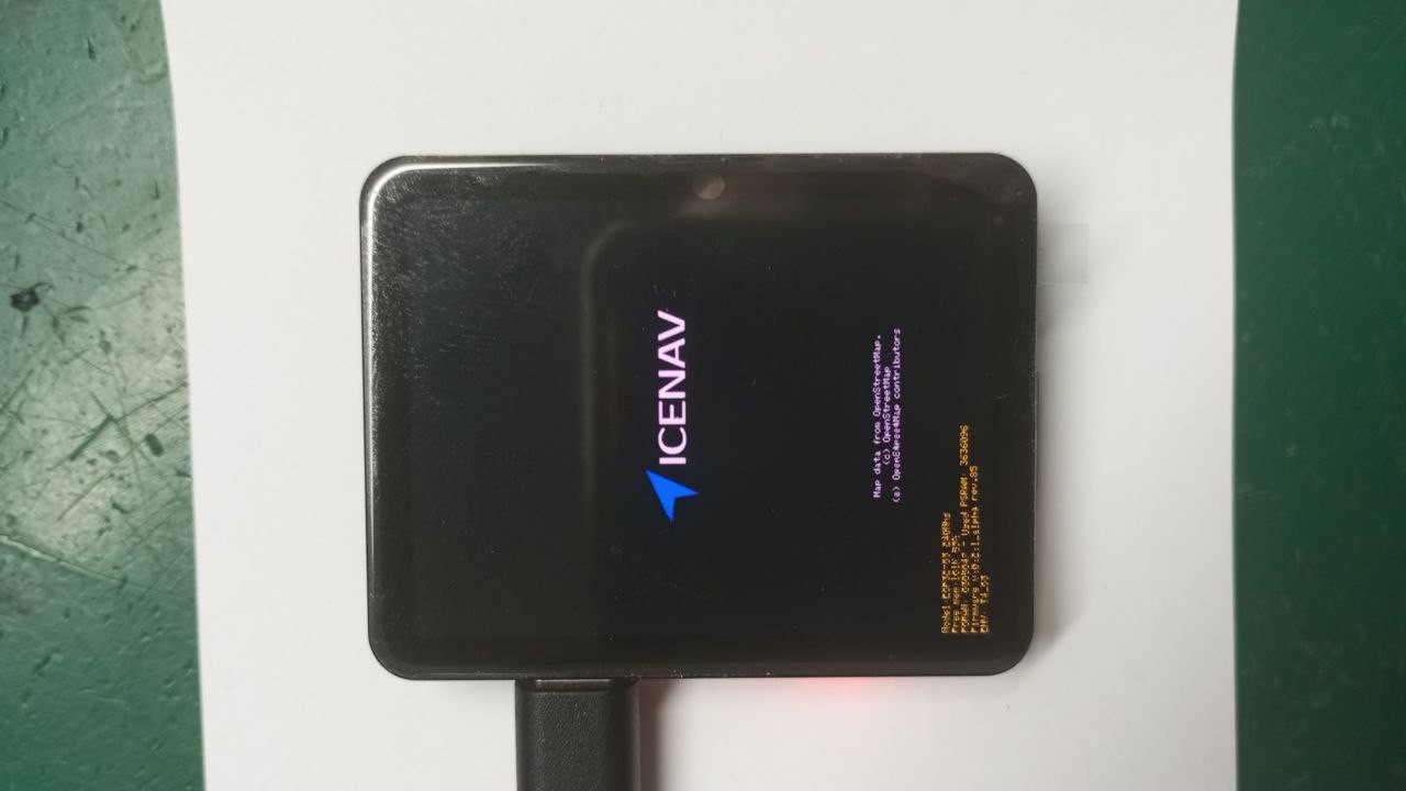

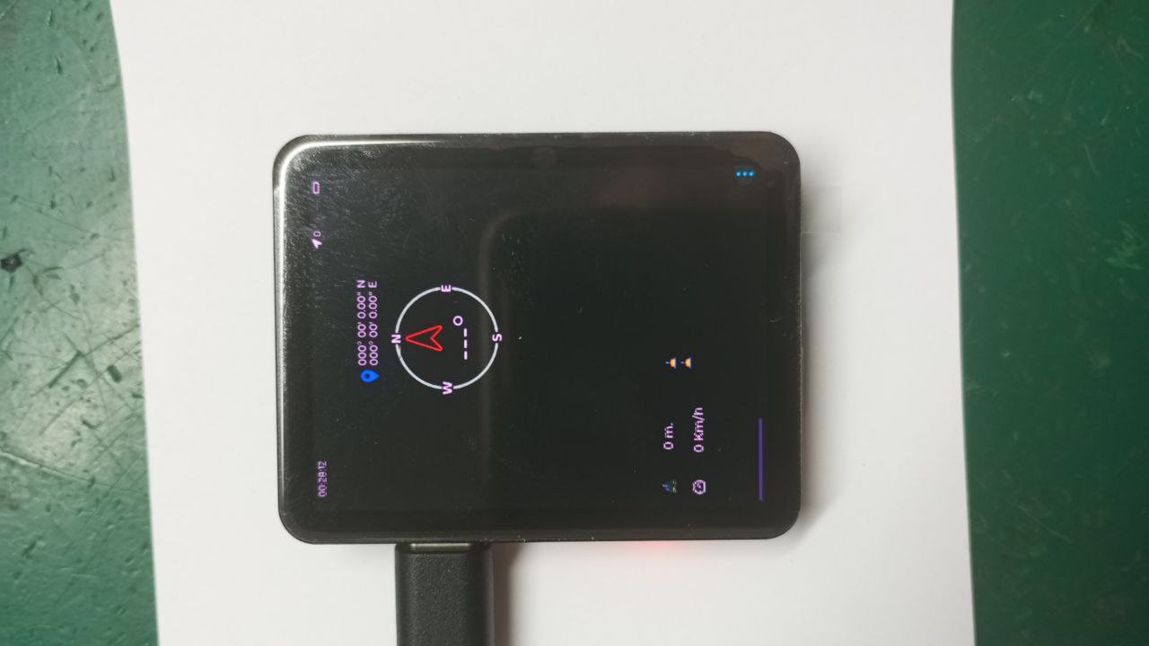

  • T4-S3 Support
    Jordi Gauchía04/25/2025 at 18:54 0 comments
    Well, it's been a while and I'm back up and running.
    This time with the first tests to support the T4-S3 from @LILYGO .
    There is still much to do but it is already a first step thanks to LovyanGfx library for bring support for QSPI AMOLED screen.
    On the other hand, a new release is being prepared with some improvements such as:
    • Import GPX tracks files and display in map
    • Possibility to pan map screen
    • etc..
    Stay tuned!

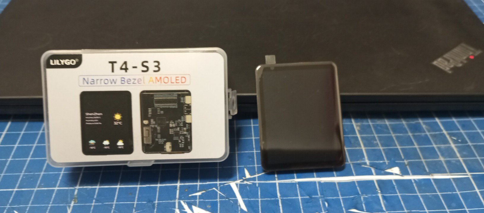

  • New board has arrived!!
    Jordi Gauchía12/30/2024 at 14:44 0 comments
    Well, new board has arrived .
    New challenge for the project, give support for LilyGo T4-S3 board.
    ImagenAn AMOLED ESP32S3 16Mb Flash and 8Mb PSRAM, 450x600 screen resolution...., really it's very cool!!
    First of all, try to support this board in LovyanGFX . This screen has a QSPI interface , and , well, maybe it will so difficult, but not impossible!
    Stay tunned!
