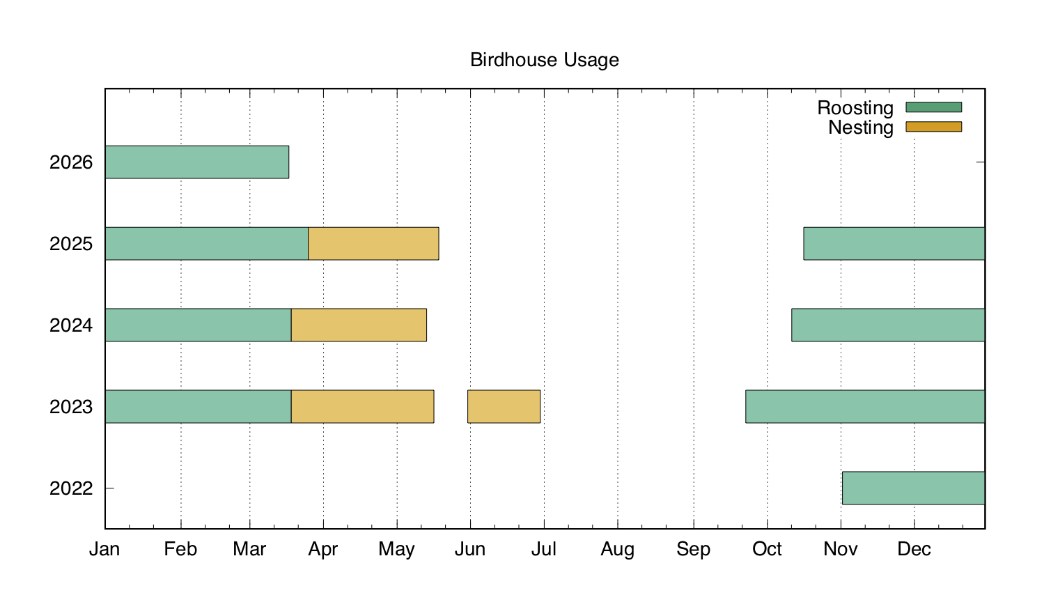

    Jan Schlieper • 03/22/2026 at 13:26 • 0 comments
    I just wanted to let everyone know that the great tits have started building their nest again. Instead of showing the usual dashboard image I though I could give a graph showing the birdhouse usage over the years. You can see that in 2023 there was a second brood. The duration for the second brood was much shorter compared to the first because the birds where simply reusing the already existing nest (didn't have to build their own). I have learned on Wikipedia that the great tit only does a second brood if there is enough caterpillar prey available.

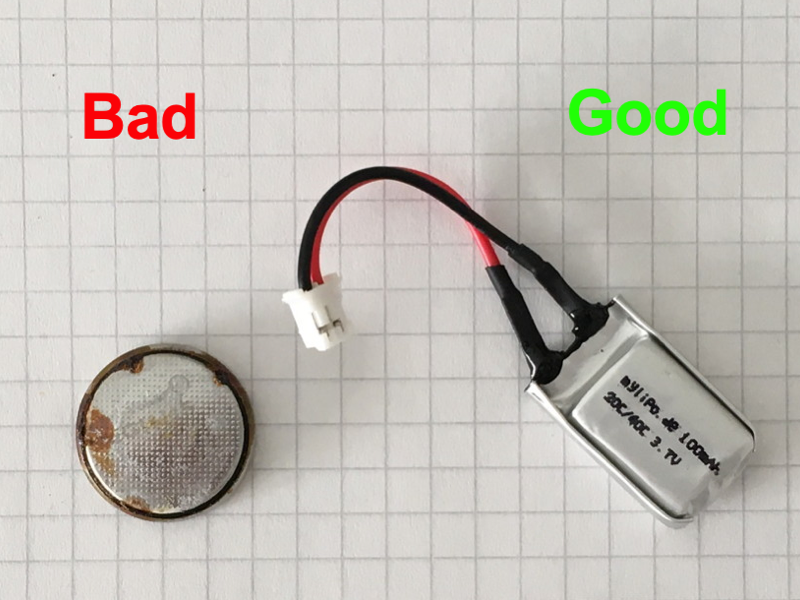

    Jan Schlieper • 03/03/2026 at 08:59 • 0 comments
    Today I replaced the LIR2032 coin cell battery (luckily the birds have not started nesting yet) . This one started leaking and it had also popped out of the holder when I opened up the enclosure. I'm done using the coin cells. The 100 mAh LiPo packs are more robust and dependable 😀 .

    Jan Schlieper • 10/31/2024 at 07:44 • 0 comments
    A couple of days ago the birdhouse stopped sending data. At first I thought they where doing maintenance on the LoRaWAN gateways because it started on a Friday evening. After a while I noticed that whenever the sun came out the birdhouse tried doing a LoRaWAN join. That told me that there was probably an issue with the battery because the solar panel was still working. Yesterday I took down the birdhouse. The LIR2032 coin cell was still fully charged at 4.0 volts. It looks like the coin cell holder is the problem (mechanical issue?). Maybe it is not designed for the temperature changes out in the field. Just in case I replaced the coin cell and put the birdhouse back up again. It has been working again without incident for the past twelve hours. I will replace the coin cell with the old LiPo pack (JST connector) should this happen again.
