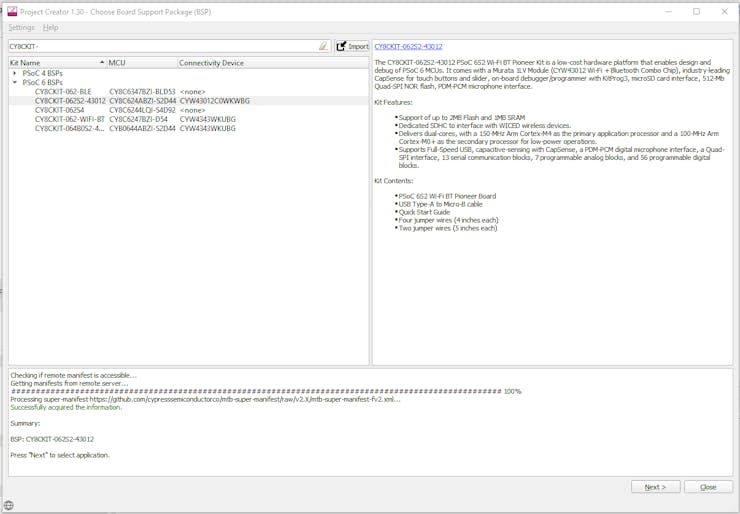

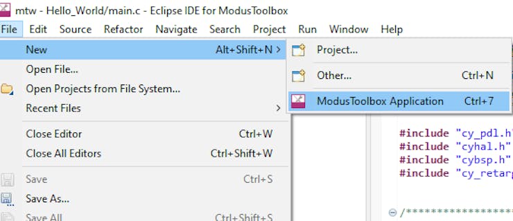

    Step 1. Click on: File> New> ModusToolBox Application
    Step 2. Insert kit name: CY8CKIT-062S2-43012, and click next

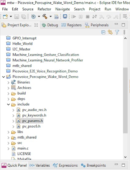

    Step 3. Select "Picovoice_Porcupine_Wake_Word_Demo" poject, and click on create. Below is the project:
    Step 4. Open main.c file and make the next changes:
