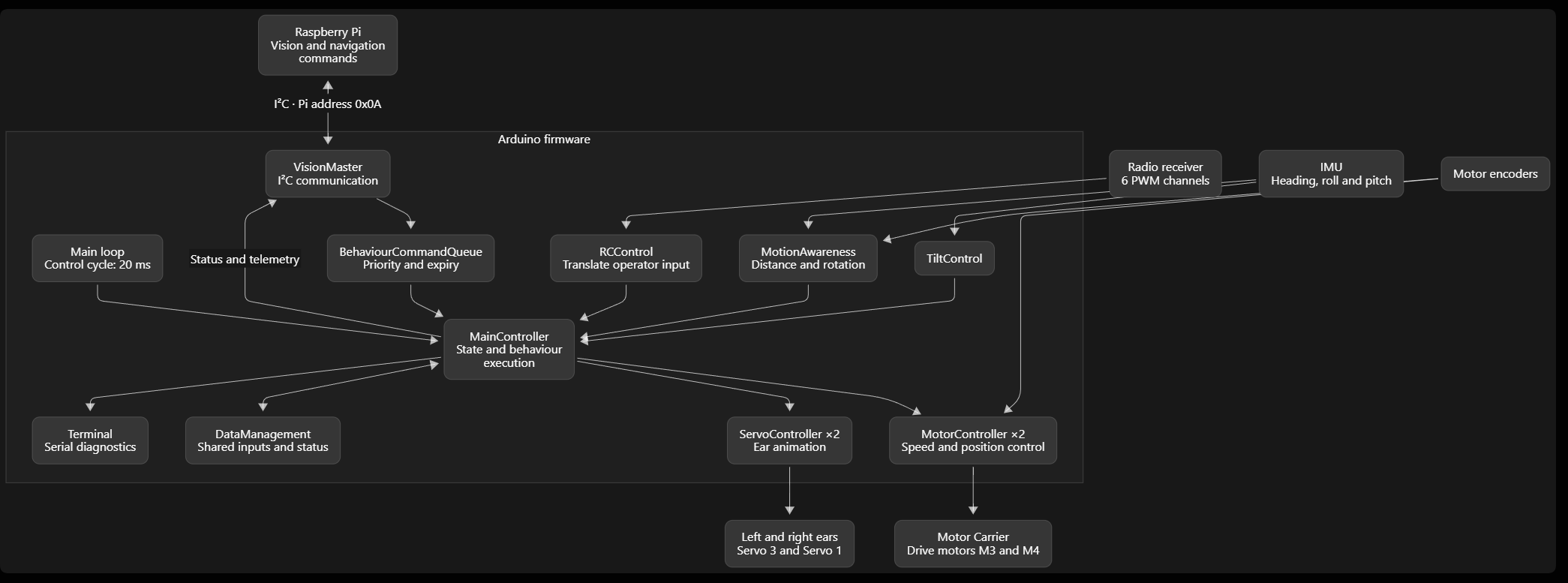

Sphaericae uses an Arduino-based control core connected to a Raspberry Pi vision system. This diagram reflects the current Arduino firmware architecture;
The Raspberry Pi handles high-level processing, including vision, environmental mapping, navigation, and behavioral logic, while the Arduino control core manages real-time motion control, sensor processing, and actuator execution.

Each control cycle runs:
1. Input: read radio channels.
2. Vision: exchange Pi commands and status during exploration.
3. Behaviour: select an action; higher-priority queued commands can interrupt an active command.
4. Control: update motors, ears, and motion feedback.
5. Debug: Serial status updates

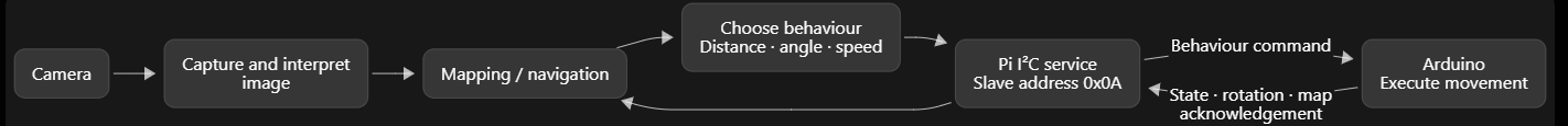

The vision interaction follows a request → observe → act → report cycle:
  1. Arduino sends WAKE when exploration starts.
  2. Arduino sends READ to request the next vision result.
  3. Pi prepares a command and responds with DATA_READY.
  4. Arduino executes the command, then includes completed movement telemetry in the next request.
  5. After a behavior has been executed, a follow up request will be send.

    1 Receive request → 2 Snapshot→ 3 Observations→ 4 Update map → 5 Choose behavior → 6 Return data
    1. Receive a request
    The Pi is setup as a slave module and awaits for a request. Each request has an ID so it can distinguish new work from a repeated message.
    Example: Request 12 arrives. The Pi processes one observation and saves its response. If request 12 arrives again, it returns that saved response instead of recalculating the data.

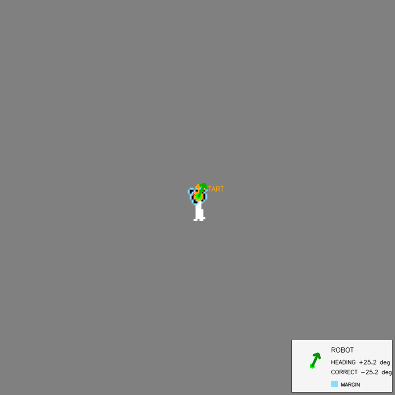

    The Pi obtains an image from the camera after the robot has settled. It associates the image with the current mapping step and estimated viewing direction.
    Example: “This is view 3. The camera is facing approximately 90 degrees to the right of its starting direction.” That direction needs to come from movement feedback and, potentially, visual alignment. The picture itself does not tell the Pi its heading.

    4b. Add the observation to the map
    The Pi combines the observation with its estimated position and heading. Think of drawing a room while turning around: every new view adds information to the same drawing.
    Example: The first view records a wall ahead. After a turn, the next image shows the same wall near the edge and a doorway beside it. The Pi should extend the existing wall and add the doorway, rather than create an unrelated second wall.

    6. Return the command and repeat
    The Pi packages its decision as a behavior, distance or angle, speed, and mapping step. It reports that the result is ready and saves the response for possible retries.
    Example: “Turn right by 45 degrees at 20 percent speed; this response belongs to mapping step 3.”
    On the next request, movement feedback helps the Pi update its estimated viewing direction. It then takes the next observation and repeats the cycle.
