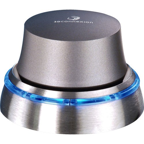

So I was researching into input devices, and I had an idea: what if there was a way to use the SpaceExplorer I have in a shelf as a 2D mouse? Hear me out here!
The main reason it was in a shelf was because I didn't want to have to keep swapping my hand between the keyboard and the mouse, and 3 devices takes up quite a bit of space (but that's mainly because a full sized keyboard is already quite large).
I've considered getting a trackball mouse to further reduce the amount of deskspace needed, but mainly so that I didn't actually need a desk surface to use the mouse accurately. Unfortunately, none that I could find had enough programmable buttons, and I only need 4 (+2 for left / right click).
The SpaceExplorer I have very much looks like an earlier iteration of the SpaceMouse Pro. I'm not really sure why 3DConnexion dropped support when the inputs are electrically identical.
SpaceExplorer SpaceMouse Pro, where I think the biggest improvement has been the enlargement of the topmost 4 buttons. The idea is simple:
- Move the cylinder X/Y like a TrackPoint to move the cursor
- Tilt the cylinder in one of 8 directions to send an event (a bit like the SpaceTraveller but not using 8 physical buttons). East/West will be the left or right clicks and up / down would be for scrolling, leaving 4 user programmable "buttons".
- The 'Fit' key on the SpaceExplorer toggles between mouse and spacemouse mode. The reason the "2D" button isn't used for this is because it's much harder to press with the thumb, and unreachable if the SpaceExplorer is on the right side of the keyboard.
[4 April: Morning]
Ok, so I've been digging though the forums for clues and I've got part of a solution, and have learned some things about the undocumented XML along the way. I've got cursor X/Y and scrolling working nicely, but I haven't yet been able to get mouseclick events or macros on the cylinder.
So first, navigate to
%appdata%\3Dconnexion\3DxWare\Cfg
There should be a Global.xml file. I edited it to make it look like:
<?xml version="1.0" encoding="UTF-8" standalone="no"?> <Global Default="false" xmlns="" CfgFormatVersion="1.3" ThisFileVersion="2.0"> <CfgProperties> <ID>ID_Global_Cfg</ID> <Name>STR_GLOBALCFG</Name> <InheritsFromID>ID_Base_Cfg</InheritsFromID> </CfgProperties> <Settings> <InstallerAutoCheckForUpdates>true</InstallerAutoCheckForUpdates> <LastAutoCheckForUpdates>3-4-2023</LastAutoCheckForUpdates> </Settings> <ButtonActions> <ButtonAction Type="Driver_Other"> <ID>Driver_Desktop_ToggleGrab</ID> <Name>STR_DRIVER_DESKTOP_TOGGLEGRAB</Name> <Image> <Source>[driver_images:Driver_Desktop_ToggleGrab.png]</Source> </Image> </ButtonAction> </ButtonActions> <Devices> <Device> <ID>ID_Standard_3D_Mouse</ID> <ButtonBank> <Button> <Input> <ActionID>V3DK_FIT</ActionID> </Input> <Output> <ActionID>Driver_Desktop_ToggleGrab</ActionID> </Output> </Button> </ButtonBank> </Device> </Devices> </Global>Driver_Desktop_ToggleGrab is a specific action that changes the Desktop.xml file (that you have to create), specifically toggling:
<Grab>Hard</Grab> <Grab>None</Grab>In "Hard" mode, the driver will lock onto using this .xml file everywhere and never let it go. However, if it's on "None", the driver acts as usual, selecting the .xml that relates to the application currently in focus.
The names for mapped buttons (eg V3DK_FIT) can be found in
Program Files\3Dconnexion\3DxWare\3DxWinCore64\Cfg\Base.xml
You can use the driver software to change the button map in some random program, look in the same folder as Global.xml / Desktop.xml and you'd get something like "HIDButton_13", which you can then look up in Base.xml, such as:
... <ButtonID>HIDButton_13</ButtonID> <V3DKID>V3DK_1</V3DKID> ...Anyway, next was to create Desktop.xml in the same folder as Global.xml
