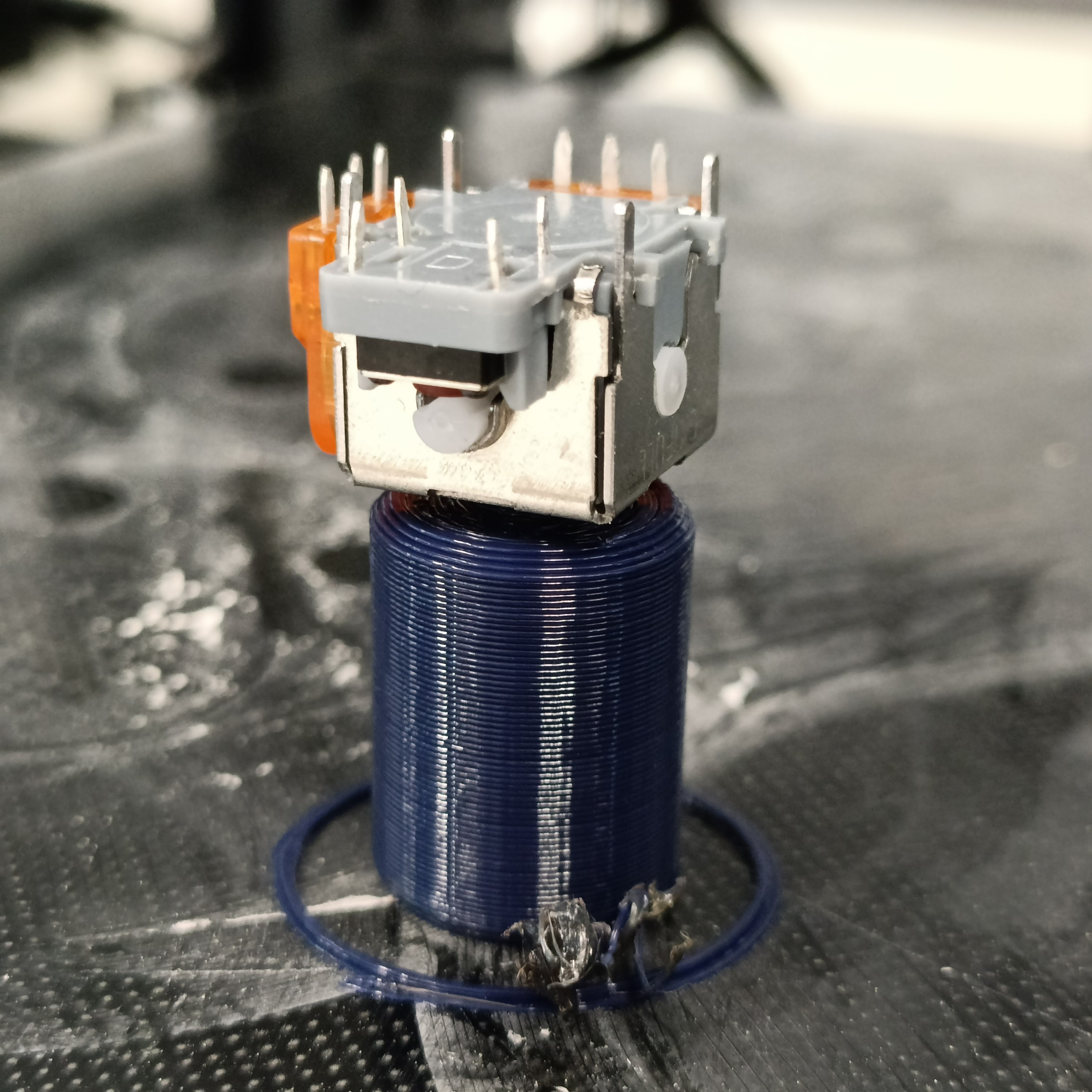

    Ginfull joysticks
    I've spent about an hour or two jointing up the joystick assembly so that I can drag the stick and everything moves (as an approximation):
    I've uploaded it to GrabCAD.
    I also talked with a user on Printables who informed me that they preferred the stiffness of a traditional spacemouse. I already had worries that the joysticks might not be stiff enough in the orientation I'm planning, so I started researching into increasing joystick tension. First I measured my SpaceExplorer, which was 300gf. Then I started looking inside the joystick.
    Source: MPE's Ginfull TMR video
    Inside the CAD of the joystick
    One of my first thoughts was to replace the spring with stacked O-rings. there's about 3-4mm of vertical height but, due to that middle cylinder in the base, only a 2mm diameter o-ring or smaller would fit. This would suggest either a 2mm and 1.5mm, 2 sets of 2mm or 2 sets of 1.5mm rings stacked on each other.
    However, I had suspicions that the ESP32-S2 ADC's would be able to detect the much smaller range of motion, so I looked into springs. The spring constant depends on a few factors, and since the original spring is 0.5mm wire diameter and 8.6mm outer diameter, I was able to calculate the expected stiffness increase of an 8mm OD spring with wire diameter of:
    • 0.7mm = approx 3X stiffness increase
    • 0.8mm = approx 5X stiffness increase
    I then found this video showing that the Ginfull Hall Effect joysticks have 60gf of force, which is lower than the standard of 80gf.
    This would mean that 0.7mm = 180gf and 0.8mm = 300gf. After much hopping back and forth, I've decided that using 0.7mm springs are more likely to work, or perhaps I should say that both share the same list of "reasons it might fail" but 0.8mm has additional reasons. One of them is that a 5X increase might be too much for the components in the joystick to handle.
    I'm not entirely sure if 9mm OD springs will fit, but I get twice as many 8mm OD for the same price.

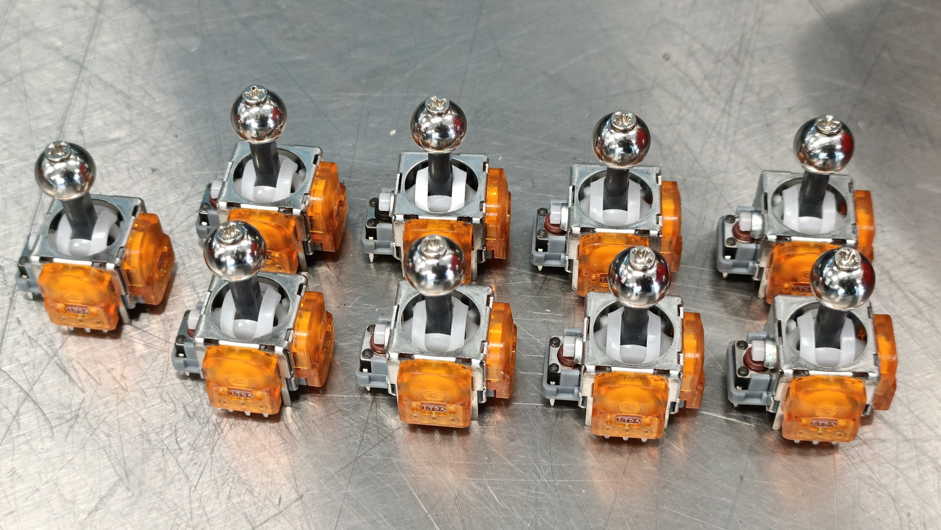

  • [E1][R] Hall / TMR joystick electrical properties
    kelvinA01/13/2025 at 21:25 0 comments
    I almost lost hope that I'd find out some electrical information for the hall effect joysticks, but then I found an oasis of information: Metal Plastic Electronics (which I'll abbreviate to MPE).
    It's a channel that has dug for details on many of the electromagnetic joysticks on the market! This log kind of serves as a TL;DW. I'll try and speedrun though the things I learned watching his tests yesterday, starting with a video where he tests these:
    The rise/fall time of yellow (Ginfull) sticks are unbalanced
    The one I found on ebay are the L4A sticks:
    Yellow is the current of the electromagnet.
    As it turns out, a capacitor is on the output pin meaning that it has to discharge when the signal voltage is lower than it. This results in fast rise times but very slow fall times. In a comment, MPE tried using pulldowns to no avail.
    This might not be too noticeable when orbiting around in spacemouse mode, but it's going to lead to overshooting if used as a trackpoint.
    As you can see, the magenta trace is a (not so traditional) potentiometer stick and cyan is Ginfull hall sticks. MPE manually moves both sticks to and fro.
    The rise/fall of the blue and green sticks are fast and symmetric
    Blue sticks
    Green sticks
    The green sticks use a larger magnet, so it seems they'd be less susceptible to stray magnetic fields than the others. The drawback for this application is that the sticks don't have a cylindrical hole, meaning I can't screw in a ball to the end of it:
    The blues/greens are similar in price.
    The sticks likely accept 1.6 - 5.5V
    The chip inside the Ginfull hall effect sensors is rumoured to be the Hallwee HAL9303, which has the following voltage ratings:

    TMR sticks use low power to output a signal that closely matches the magnetic field
    For example, here are the Hallpi TMR joysticks, which are about 2X the price of the average hall joystick:
    There were also the blue K-Silvers (cheapest) and black GuliKit on his channel.
    TMR sensors seem to pull around 210uA of current, compared to 700uA for the Ginfull L4B board (which was found to be identical to the L4A board).

    I've looked into the remixes and a user called Kempy has decided to use PS5 hall-effect joysticks instead of the questionable PS2 resistor-based ones, minimising the deadzone and allowing for smoother control:
    They made the PCB available on ebay and it'll only be a one-time fee of about £9 to use the PS5 sticks:
    PS5 joysticks + PCB
    PS2 joysticks already on PCB
    The author behind the DIY spacemouse code wrote a build log of a different remix and mentioned the amount of sanding that had to be done for smooth sliding. I assume Kempy experienced the same thing, spurring them to design the remix that uses 8mm steel balls and salvaged inner rings from 608 bearings. I've found the following search terms useful:
    • stainless
    • bead
    • ball spacer
    • 2mm hole
    In my search, I did also see acrylic and glass beads, but their roundness is likely questionable for this application. I may consider just printing using SLA printed ball ends for the joysticks.

    To avoid the nail for the top switches whilst also avoiding the fingertip hitting the wrong end of the bottom switches, I've come up with this solution.
    Quick doodle of the finger in the well
    I've opted for a printed keycap that is stuck onto the lever with double-sided tape. The keycap hook will then catch on an overhang to prevent it springing back too far.
    I need to design some way of adjusting the gap between the switches. Ideally, this would be a tool-less solution (aka doesn't need a screwdriver / allen key).
    As I was writing this log after drawing the doodle, I noticed the sharp edges in the path of the finger, so I've tweaked the design a bit:
