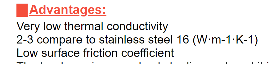

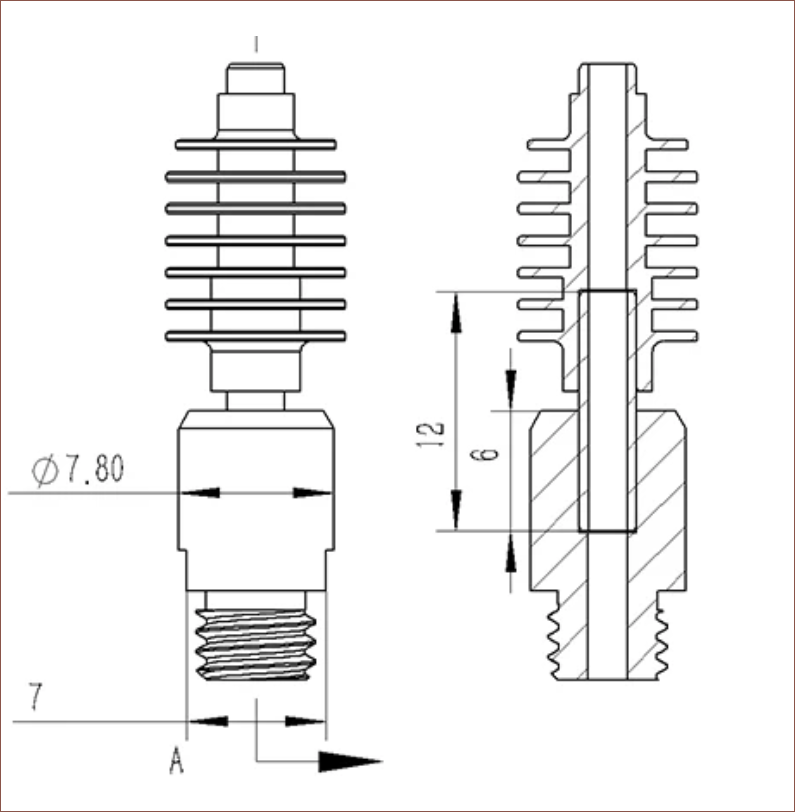

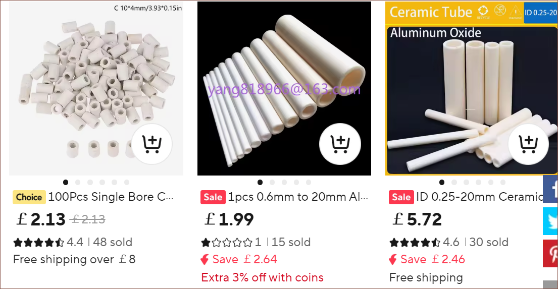

  • [T] Zirconia heatbreak?
    kelvinA06/20/2025 at 22:41 0 comments
    I was scrolling Amazon, searching for ceramic heaters when I stumbled upon a ceramic heatbreak, which is not something I've seen before.
    I thought ceramics would be too heat conductive (I mean, they make heaters with it) and too fragile to work, but if it's not the case, it would make a lot of sense since ceramic bearings have even lower friction than stainless steel ones, so perhaps that low friction translates to polymers. I did more searching on AliExpress and found out that Fysetc  and Trianglelab both make such heatbreaks, and I was surprised to find out how low the thermal conductivity is:
    Trianglelab conveniently has a section view and were able to tell me that the tube is "tightly fitted". Comparing pixels, I estimate that the OD of the tube is 2.9mm.
    The first tubes I found were low-cost but also had a matte surface finish. I then found some precision polished zirconia tubes in a variety of sizes, most notably 2x4x16mm and 2.05x3x25mm.
    The only thing is that this costs £2 more than what Fysetc charges for their entire heatbreak. £7 for a 2.05x3x25mm tube implies £3.50 for a tube half its length.
    I looked into it and, as I probably should've known, "ceramics" is about as precise as saying something is made of "metal" or "plastic". On AliExpress, there seem to be 2 types: Alumina and Zirconia. The former is 10x more heat conductive at 27 W/(m.K). NF goes one step beyond and uses "aerospace materials" for their NF Zone, which has a removeable black heatbreak so I don't even know what it could be:
    Source, who tested that it was possible to print PLA without a cooling fan and not experience clogs.
    On AliExpress, there are also quartz capillary tubes which might be a cheaper alternative that has a similarly low thermal conductivity, but they likely would be too fragile.

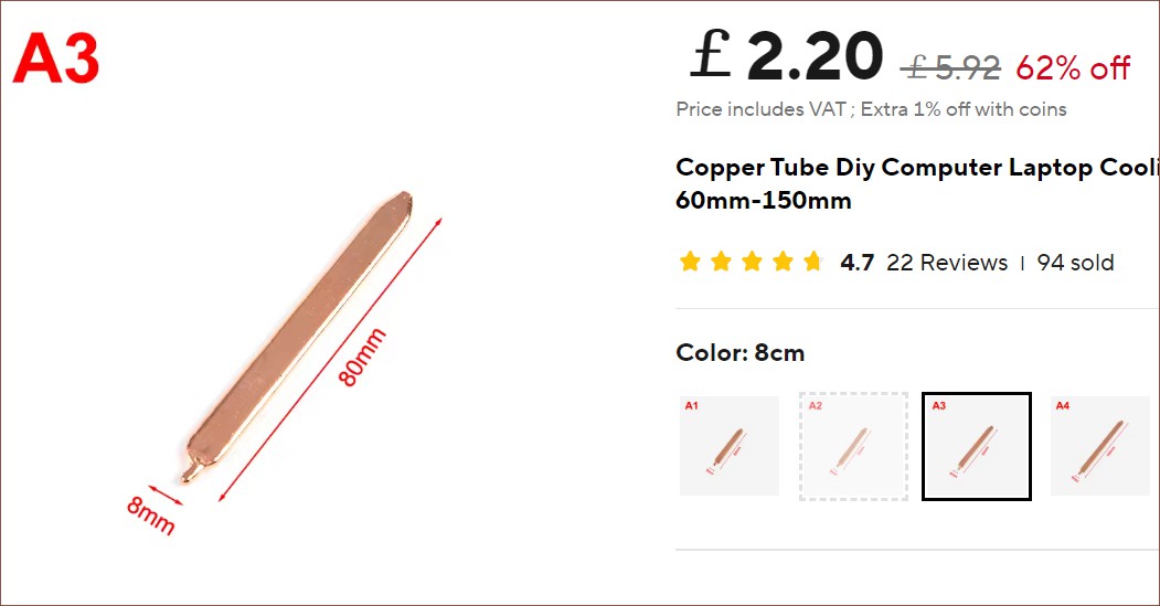

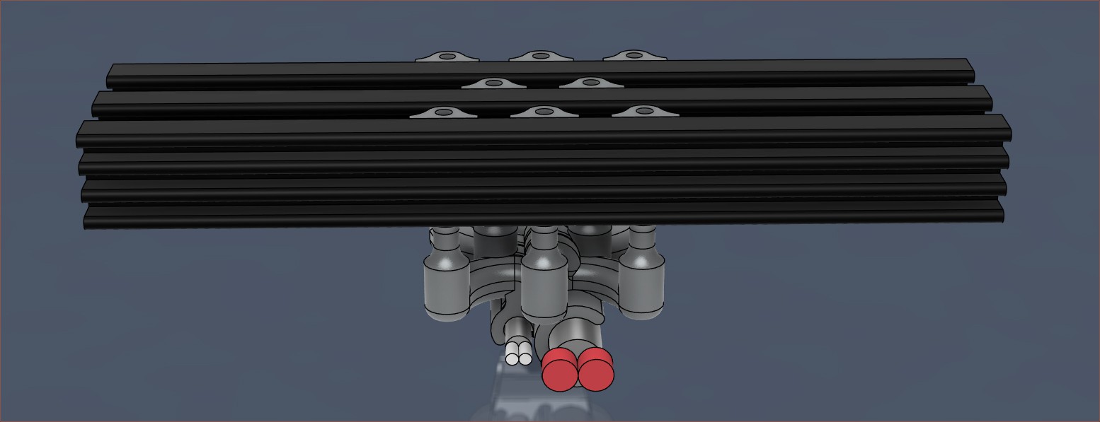

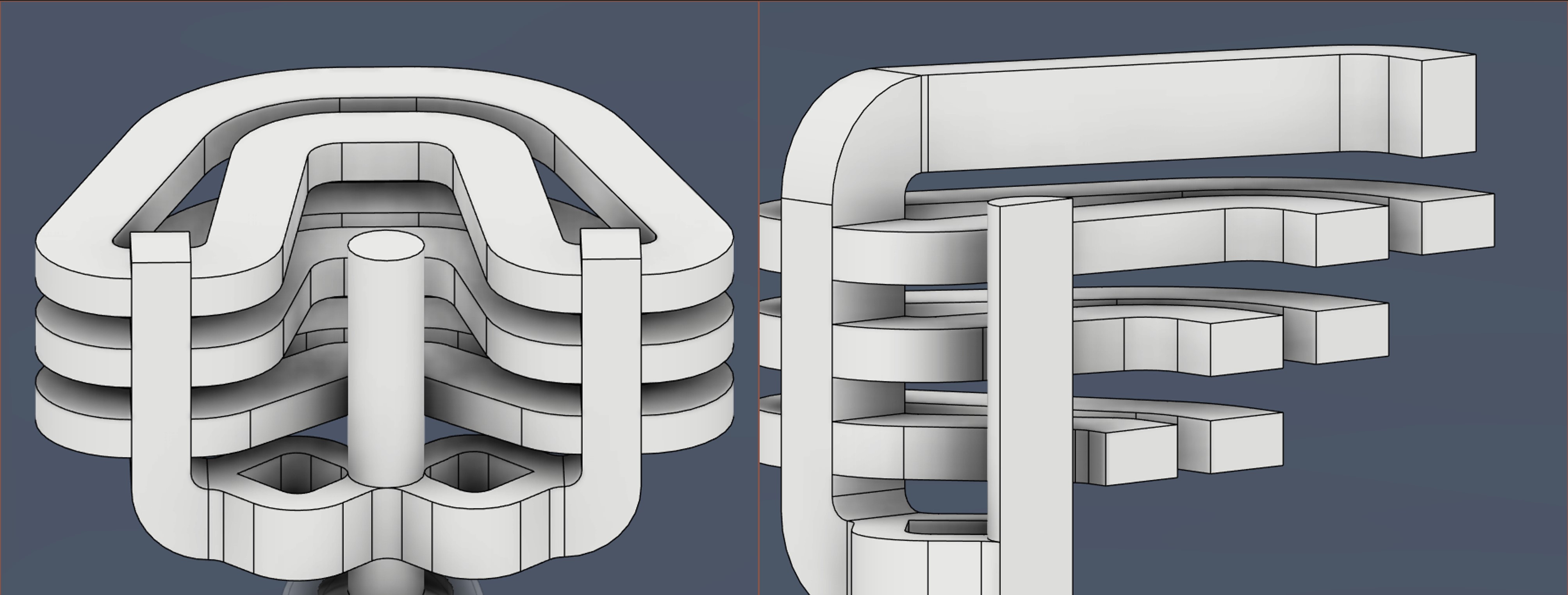

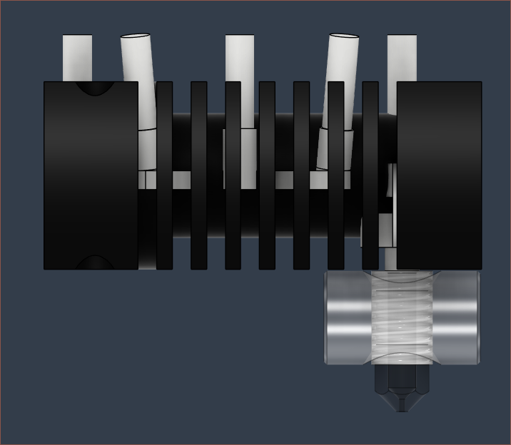

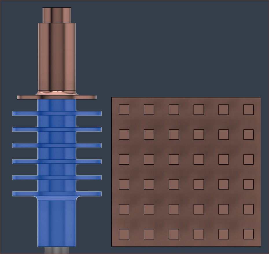

  • [M] Parallel printed heatbreaks?
    kelvinA06/12/2025 at 13:01 0 comments
    I wondered if it would be a decent idea to try a solution without the complexity of the heatvalves as more of an engineering sample that focuses on validating if the new internal geometry even reduces the transition volume to an acceptable level.
    The above design is 5.0 cm3, which is more than half of R2. This design doesn't use a clamp plate, which contributed another 3.5 cm3 of hot-metal volume to R2. However, since I'm still unsure about being able to use boron nitride paste to hold the cartridges, this value is likely to increase.
    The spacing between inputs is 10.5mm. I tried 10mm (like in previous revisions) but the front-corner inputs come too close to the coaxialiser.
    I tried to squeeze the heatbreaks to as little volume as possible because they really do add up when there are 8 of them. They also have to be short to ensure that the drill (and reamer) can reach. Each one is 0.23 cm3. There's only a little less than 6mm of space between rows, so I considered both heatpipes and heatsinks. I modelled 2 different 5mm-high heatsinks I found on AliExpress:
    50 x 11 x 5mm
    100 x 11 x 5mm
    When divided by 3, the 100mm one is a little over 1000 mm2 per input. For aluminium, this might be too low. Even if it was adequate, fitting the fan would likely be a challenge. Thus, the heatpipe option is more likely; the flat ones on AliExpress are 8mm wide and 3mm tall, starting at 60mm long.
    This seller has 10mm increments starting from 60mm, but most sellers start at 100mm with 50mm increments.

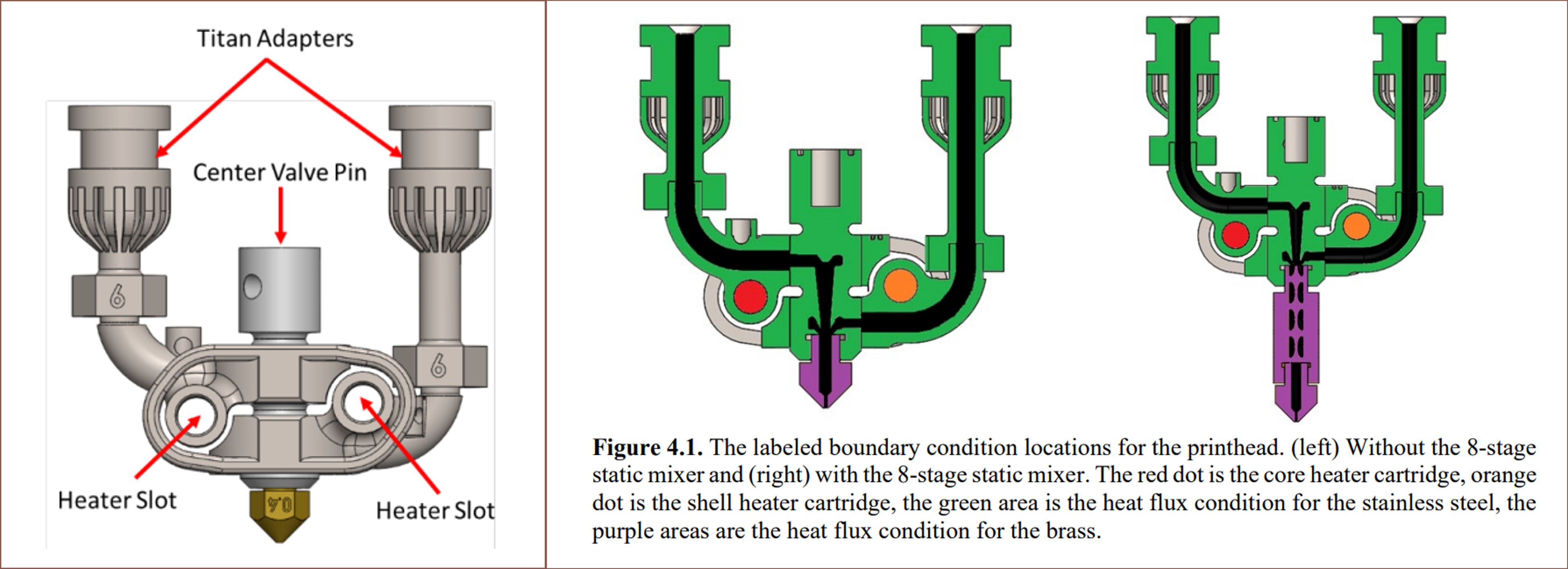

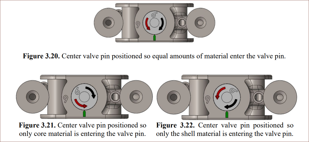

  • [R] Paper found: FDM of Multiple Materials via Co-extrusion
    kelvinA06/11/2025 at 06:27 0 comments

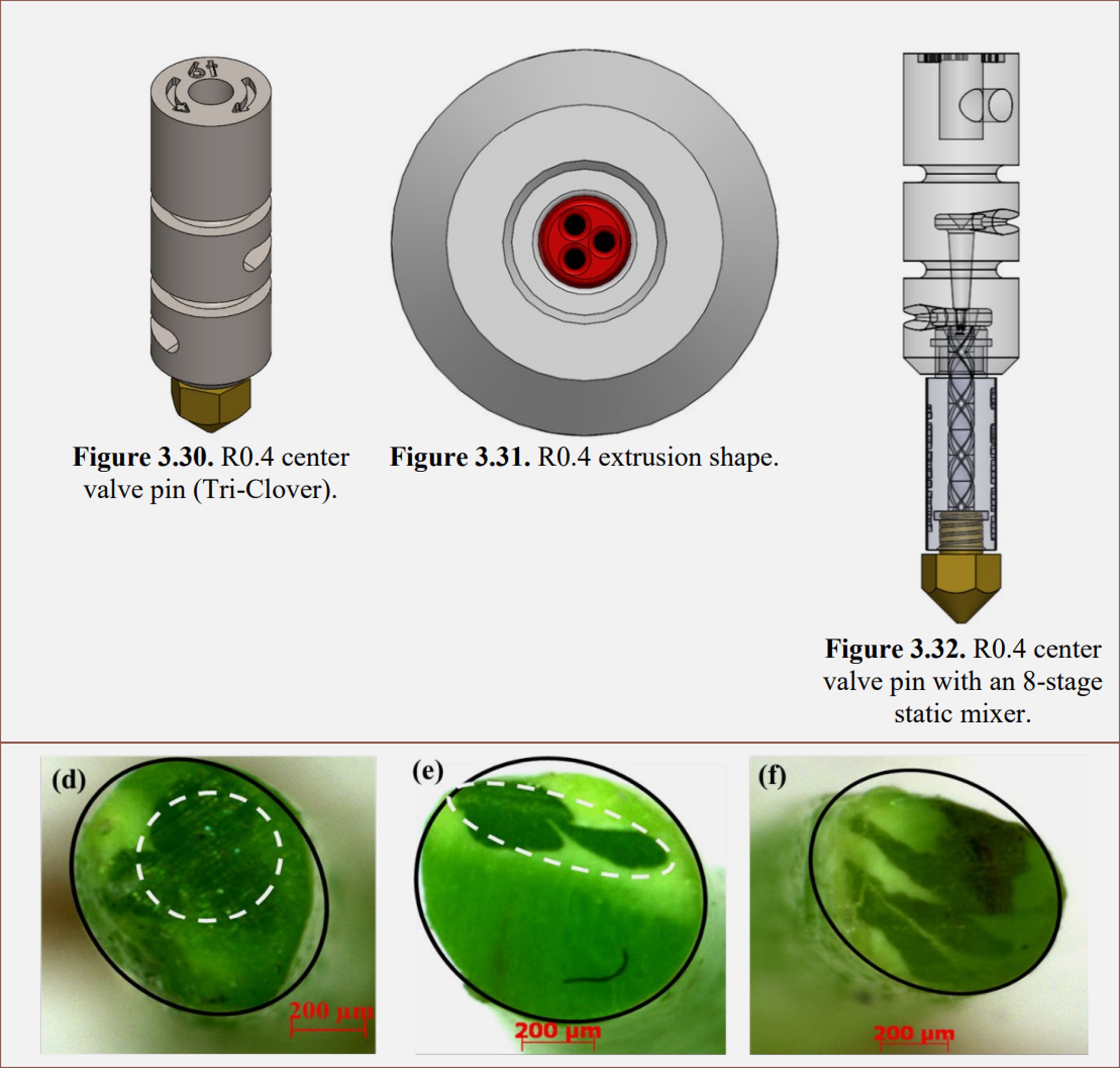

    DOI: 10.13140/RG.2.2.16367.87206 Name: Fused Deposition Manufacturing of Multiple Materials via Co-extrusion
    I'm not really sure how I even stumbled on this paper. I was just looking for SLM-printed hotends and learning why the heatbreak length is usually 2mm. I didn't think I'd find a 2020 thesis paper of a guy called Robert trying to make a coaxial hotend. This hotend was just to see if the desired extrusion was possible and wasn't connected to a motion system. Here's what I learned:
    • Fabrication: Binder jetting from i.materialse and Shapeways, starting at 60% stainless / 40% bronze and eventually going for 100% stainless due to heat conductivity.
      • He had to split up parts a lot because the parts kept coming in with powder! Is SLM less susceptible to this, or has PCBWay just not got that skill issue?
      • One of the issues from this is that the "shell" input only came in from one side, causing the extrusion to be pushed
    • Design: Essentially all-in-one. Since it wasn't mentioned till rather later, it seems that Robert assumed that each input needs to be thermally isolated for use of materials with different melting temperatures. The center pin generally averages out the temperatures anyway. He had flow issues that he attributed to the complex internal geometry, but I believe it's because he's trying to bend semi-molten filament. Interestingly, the centre valve pin can be rotated:
    • One of the unique pin designs was one that had 3 smaller holes instead of one. At high shell amounts, the core got pushed to a side. The static mixer just made some layering effect in the extrusion.
    • Not sure how it's being sealed though. While on the subject, in an earlier design, he added a "seal plate" which looks like the geometry I added to Coaxial8or R3:
    • He still uses Marlin's mix feature and had to use the bed heater to control the second cartridge. If you remember back for Coaxial8or R0, I used the chamber heater.
    • I noticed the little gap around the sealing face of the nozzle, so he probably knew about the whole bottoming-thread thing.
    • Oddly enough, only single material flow simulations were conducted.
    • He put switches so that the cooling fan can be turned off to allow material to heat up in the cooler section to clear blockages.
    • Further work was simulating 2 different polymer flows and mounting to a "hobbyist printer (e.g.,
      CR-10, Ender 3, Prusa) to support streamlined integration", which I've respectively kinda-done and done. His intent for the simulation was to visualise the cross section; I believe the OpenFOAM simulations I've run are viscous Newtonian fluids and they seem to do a good enough job.

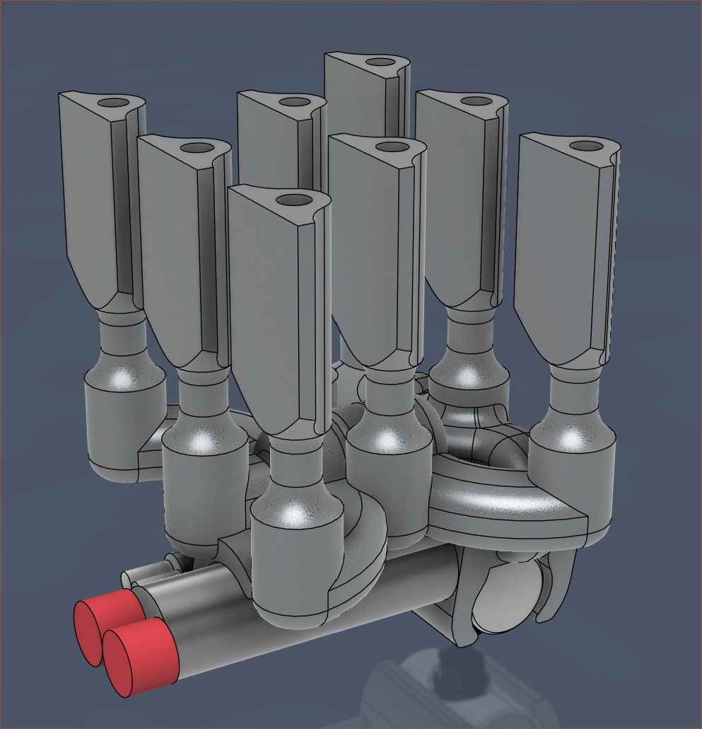

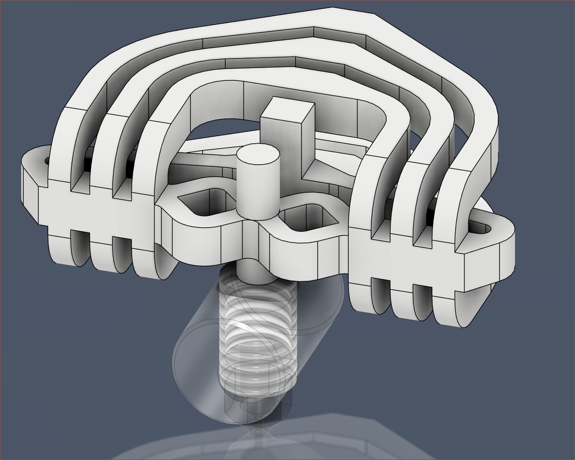

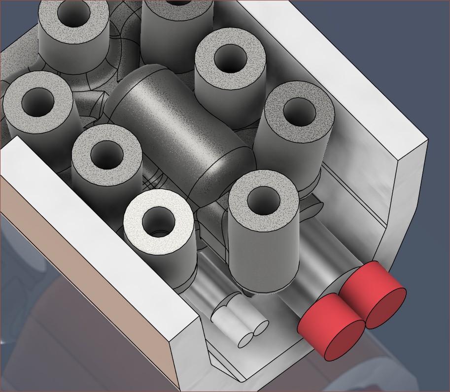

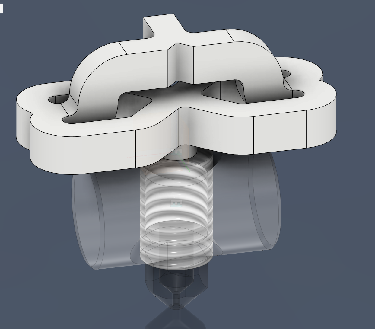

  • [M] Stainless print in place heatbreaks?
    kelvinA06/08/2025 at 12:58 0 comments

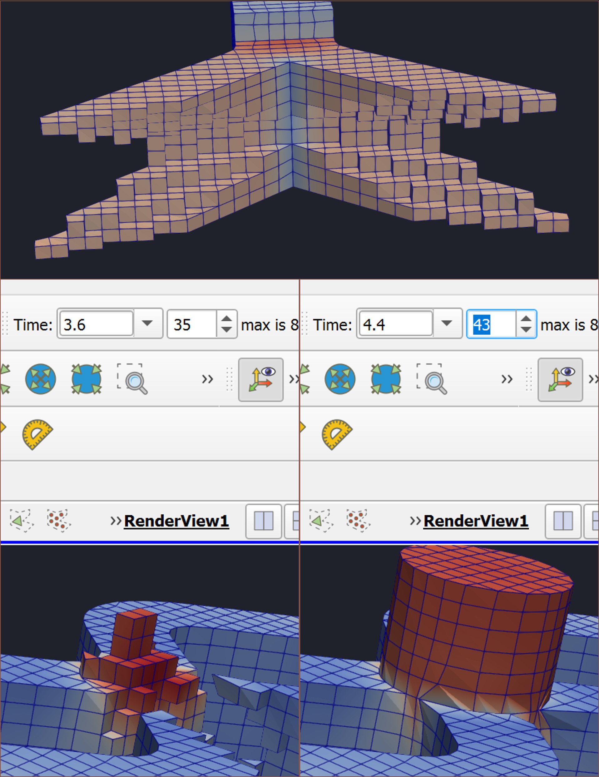

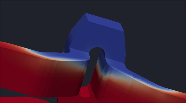

    This design is 3.4 cm3.
    I modelled the idea I had during the conclusion stage of the previous log. It's a proof of concept, so the actual 3D file is somewhat fragile at the moment. There's little benefit for perfecting things now when the idea might not even get green-lit by fabs or geometric conflicts arise when designing the heatvalves and heatsinks.
    I looked into the old-school all-metal heatbreaks and they use 3.2mm at the tube section. I believe I've also seen more recent hotend designs (like the SV08 in the previous log) use 3mm tube.
    Currently, I've modelled 1.8mm ID 2.8mm OD tubes to try and balance powder removal, ease of drilling and lack of heat conduction.
    The issue I see at the moment is the sealing of the heatblock to the heatvalve. Perhaps they would have to be integrated too?

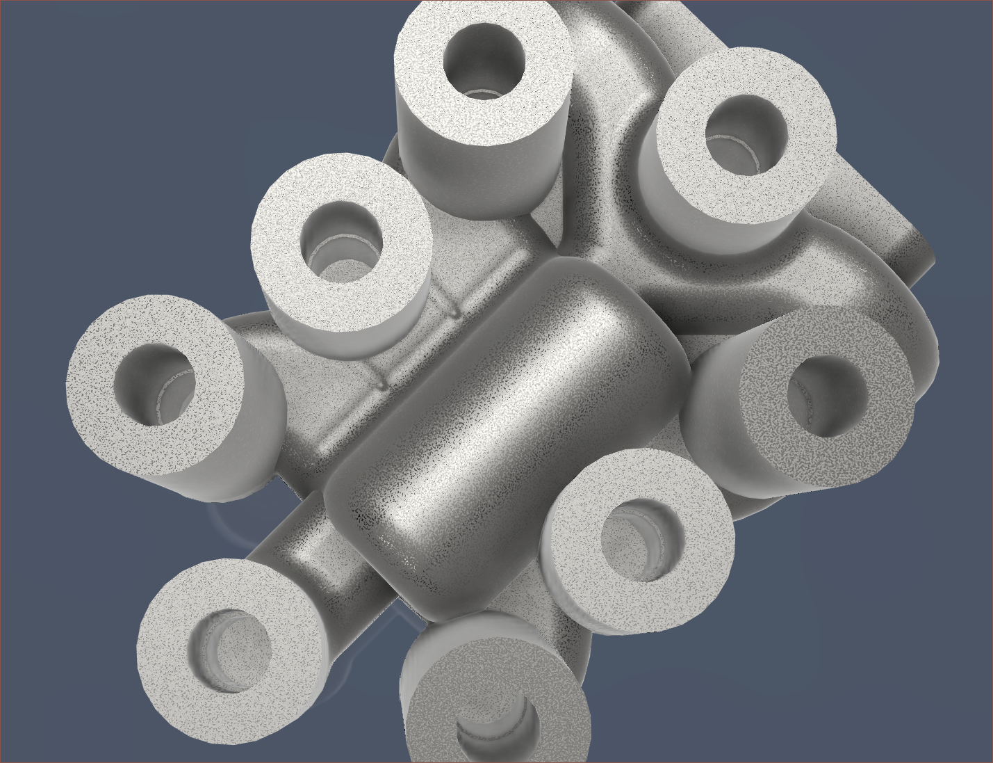

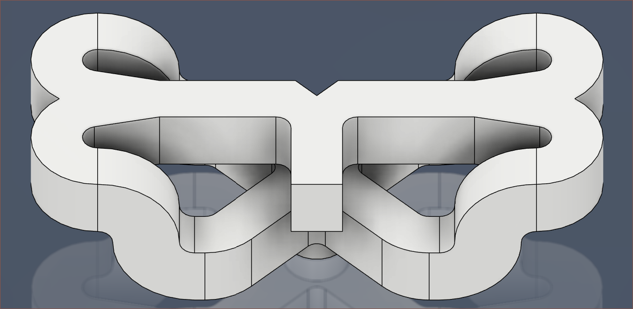

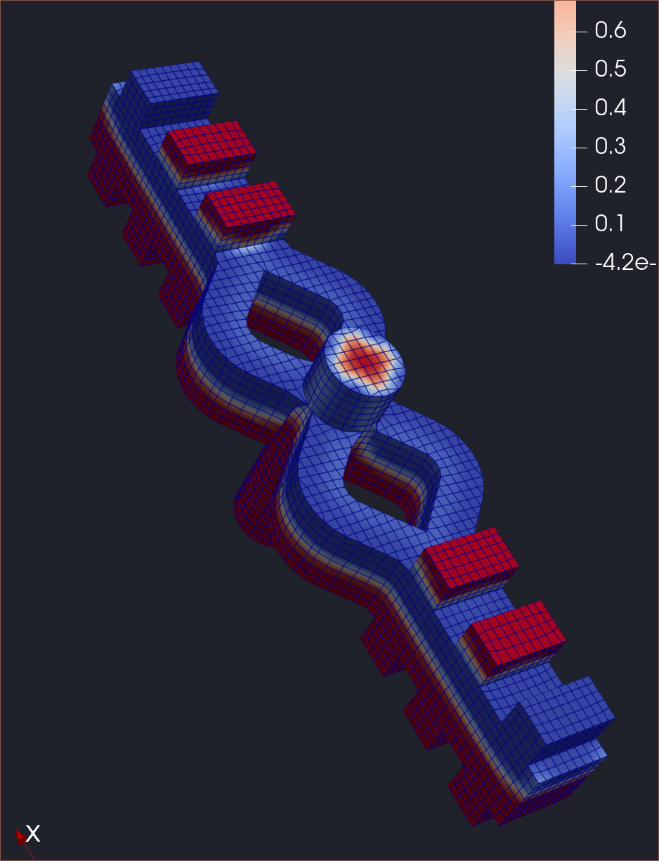

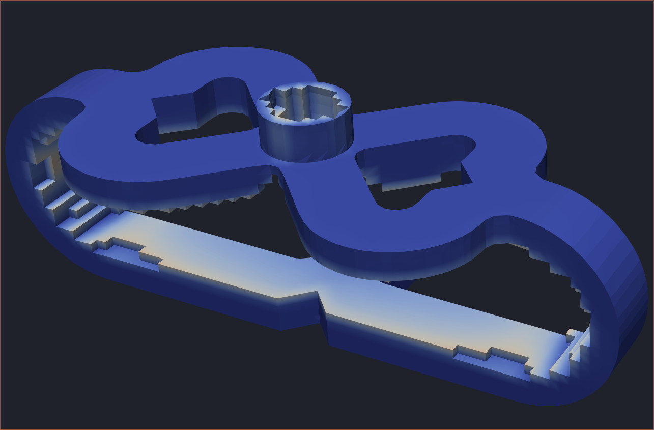

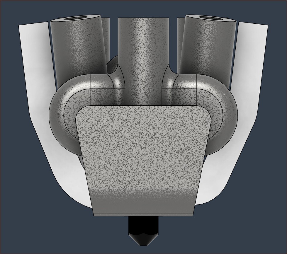

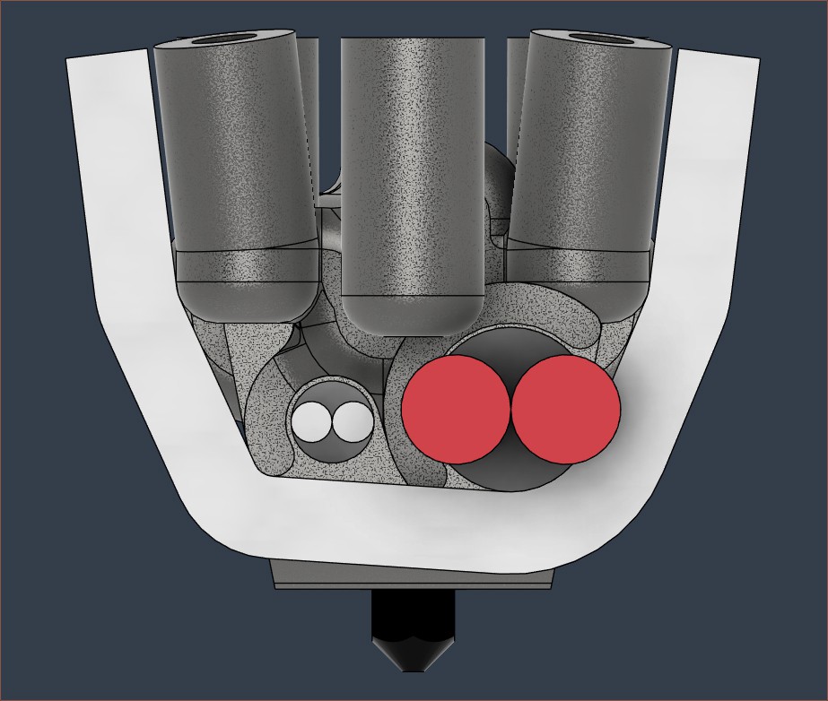

  • [M] Created heatblock using outer-shell
    kelvinA06/08/2025 at 09:39 0 comments
    I'm not sure how far I'll get before all the additional manufacturing complexity nudges me over the edge to essentially say "Well, it was a good run, but that #SlimeSaver [gd0105] isn't solving itself and still has the optimistic appeal of potential performance." but I've currently modelled a potential heatblock candidate that is about 3.3 cm3.
    I may have to extend the length of the press-fit tubes, as they're currently 5mm and all examples I've found look like they're >7mm:
    Considering that a V6 hotend is installed, the tube does look to be around 7 - 8mm here in this SV08 hotend.
    At 7mm, the heatblock is 3.5 cm3.
    Series of events
    I first designed the heatblock how I've always designed ones in the past, but it seemed to use more material than I'd like:
    This was 5.6 cm3; too much when I'm targeting 3.5 cm3 which is the amount for a standard volcano hotend.
    I then had the idea to use the Shell command to create the minimum-material-needed heatblock. Only the "rounded" type works anyway. The straight-edged shell would've used more material for little benefit:
     The above is 2.6 cm3, proving that a solution within target could exist.
    Next, I proceeded to delete a few faces, add the dowel holder, and fillet things:
    I think it looks nice, like an engine, so I kept the top non-symmetric like this.
    The dowel orientation is such because it was easier to make a nicer looking design.
    I tried the first orientation, but it only saved a negligible amount of material, looked less sleek and I eventually came to the conclusion that there was nowhere else for the heater to go but where the leak path would spill into.

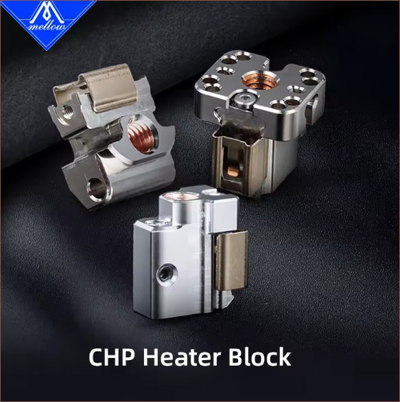

    For the heater, an ideal solution might have been the clip Mellow came up with in their CHP hotend:
    I don't think the clip alone is available, so I've modelled in geometry for a more traditional cartridge heater/thermistor, attached with nothing but boron nitride paste. They're not enclosed in part to save on material and to allow easy access of water to remove the cartridges if they need replacing.
    The cartridges are then insulated with 3mm wool that was used back in a time before silicone socks. Here, I'm using it as a shield against material wisps.
    It's designed to take a 15mm cartridge, but I'm going to test with a 20mm 70W one.
    Closing statements
    D3D, in their listing for a hotend they sell, does seem to confirm my worries about thermal expansion on this press-fit solution. I'm not sure exactly how thermally conductive this heatblock actually needs to be considering all the twists and turns inside of it, so printing in stainless-steel is still looking the most ideal.
    If anything, I might just take a page out of XYZDims and see if PCBWay or JLC can print 0.5mm thin tubes which I drill on the inside. I might have to ream too, but a rougher surface finish would both help with heat transfer of the filament and would actually turn the drawback of those pre-bimetal, chinesium all-metal heartbreaks into a feature by promoting "clogging" when the input is off. It might also save money both in material savings of the printed part but in thin-wall tubing too.

    I was wondering if I'd need tolerances similar to the Tetoroidiv rotors and it seems like I do. Charts, machinist forums and Gemini all agree that, for a dowel 6mm or less, the "interference" should be 0.0005 of an inch for a press fit, though one forum-user was able to work with 0.001. In other words, the holes are between 12.7 to 25.4 microns smaller than the precision round object that's going into it. I also found the below video that recommended that the initial hole should be smaller by 70 - 140 microns for 1 - 3 mm holes respectively, meaning that for a 2.5mm reamer, I'd be using a 2.4mm drill to enlarge the roughly printed holes.
    Now, since the rest of the world works in metric, the only options for reamers are 2.49 or 2.48mm. Gemini determined that 2.47 would be too much for a solid dowel pin, let alone a thin-walled tube. Speaking of the tube, my plan is to use 1.9 ID x 2.5 OD tube so that there is a tad less expansion space for the molten material and the tube walls give a little more strength than 2.0 ID.
    2.49mm is closest to what all the forum-users are using, but Gemini and I did the thermal expansion calculations and the interference would loosen by 4 microns (aka 40%) when heated up to 250C and up. This isn't really an issue for copper, such as the Creality Unicorn nozzles, as both materials have rather similar expansion. I'm considering printing the heatblock in stainless steel from JLC since both the tubes and the cross-dowel pin is stainless steel. I know Dyze uses a non-stainless steel, and in the comments they said it was because of higher thermal conductivity. Obviously, as I've found out in this project, stainless steel is tough stuff.
    I found some low-cost reamers and drill bits on AliExpress. I thought they'd be way more expensive. I'd have to spring for the coated ones from the other supplier I found if I go through with a stainless steel heatblock either now or in the future:
    2.49mm feels a tad too close to the limit, especially since the whole system is pressurised too and there are 8 of these that need to be confidently installed, thus my first choice will be 2.48mm. There's also the option of lightly sanding down the tube if it's too small.
    Allegedly, to actually insert the tube, I'll need something called an Arbor Press, which exerts forces measured in tonnes allegedly. I found a white, branded one that does 0.5 tonnes for around £50:
  • [M] Modelling for the fastest transition
    kelvinA06/05/2025 at 16:13 0 comments

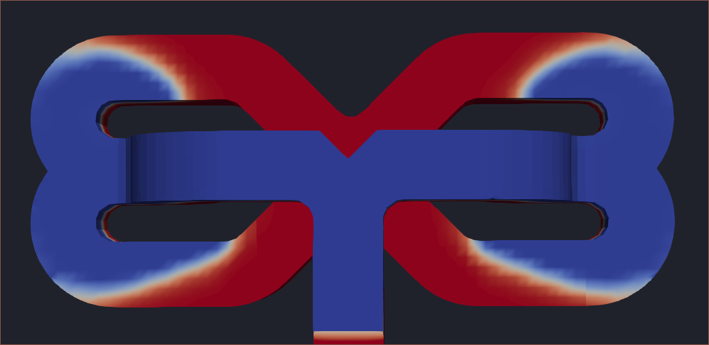

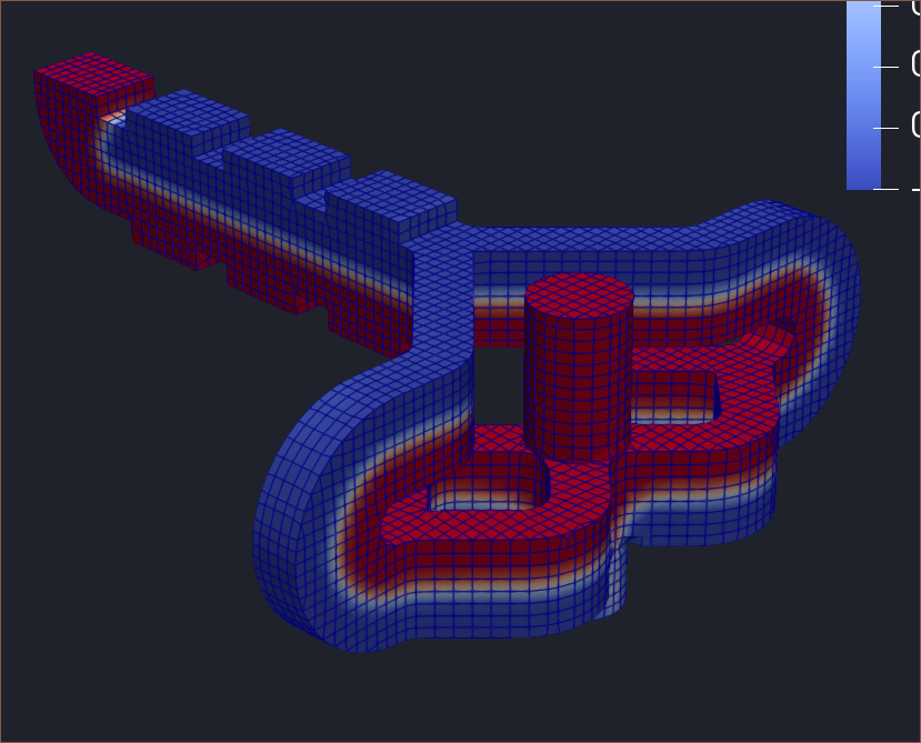

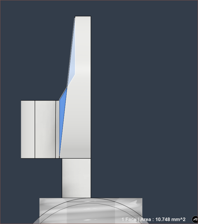

    This solution uses approximately 0.6 mm3 of molten plastic. The side inputs are spaced 6mm appart.
    Here it is. After multiple days of thinking up and simulating multiple ideas, this is currently the smallest pathway solution I've obtained.
    All the other things I tried, in chrono order
    I started of simply adding 90-degree spikes to cut the material flow and keep everything moving. This had a volume of 234 mm3.
    I wanted to see if this could be a strategy. It's 20% more volume.
    These next two designs explored if I could split only after going down a level to save on volume. This is 11% less volume.
    This one is about the same volume as the first one.
    The 4th one seemed to work fine.
    The pathways were reasonably matched too.
    The same could not be said with the 3rd idea.

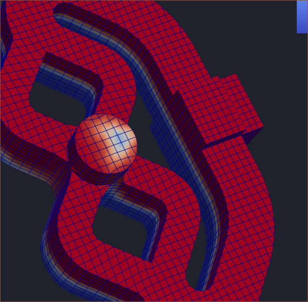

    I then decided that a reasonable way to further decrease volume and improve side-to-side matching was to make the paths thinner. I also looked at all the view modes ParaView has.
    LIC was nice because I could see the movement direction of the flow. U magnitude is in m/s.
    I tried pre-splitting and the transition time was 1.7s. Note that a total of 40 mm3/s is flowing through all these tests.
    Tried going up instead of down to potentially reduce the amount of material that needs to travel up from the tubes. I was assuming that the tubes would exit lower, accounting for the hole that keeps them in place. Transition was 1.5s.
    I tried a completely flat design, but transition speed was 1.7s, the same as with the 2nd design.
    I sent this off to PCBWay and they said that it would be possible to fabricate without powder in the channels.
    Tried this idea where it's mirrored but I couldn't think of a reason why it would be beneficial.
    Thought of having a FastPass input so that there could be faster transitions between support and the mix, for example.
    At this point, I was noticing that my solution was looking like a cleaner version of one section in Coaxial8or R0, but now this geometry for R4 does the job of the 7 rings.
    The transition takes 0.8s to complete. I was hoping for even less time.
    I tried seeing if I could split before and have 2 straight channels going straight into the diamond-squares. Obviously, it uses too much pathway material.
    The transition is 1.0s.
    In an attempt to reduce the amount of pathways needed, I tried bending upwards and staggering the inputs of these channels so that I could routhe paths in and out.
    I had quite mismatched channels and the reason was because of the starting condition. Once I fixed this, I had 0.8s transition.
    Then I ran this simulation and I got 0.9s transition.
    Then I did a simulation of a full mix change, which completed in 0.8s. I ran the FastPass input simulation afterwards and the transition was 0.6s
    I tried to loft-curve to save on volume, but it ended up slightly increasing it instead.
    Then I tried shuffling the inputs around to get a solution that was both symmetrical (to cut down on modelling/fabrication time) and didn't intersect with things. This solution doesn't work with the heatsinks, but I decided to model the internal channels anyway.
    The end result is barely larger than a CR-10/Ender-3 heatsink.
  • [R] Copper pin heatsink
    kelvinA05/26/2025 at 15:02 2 comments
    So I was wondering how I'd even know how much cooling was enough, and then I realised that the heatsinks I've got already were shown to work, implying that I just need a heatsink with similar surface area:
    Current heatsink (left) and 15x15mm heatsink (right)
    The faces exposed to air in the design are highlighted in blue. I then modelled the 22x8mm and 15x15mm heatsinks.
    • Current Heatsink: 865 mm^2
    • 22 x 8mm Pin: 836 mm^2 for the top+sides, 716 mm^2 for the top only.
    • 15 x 15mm Pin: 1065 mm^2 for the top+sides, 945 mm^2 for the top only.
    The price/volume is £4.52/487 mm^3 and £6.20/630 mm^3 for the 22mm and 15mm heatsinks respectively, so the price is proportional to the amount of copper.
    I also found out about the RP1010, a 10x10mm ceramic heating element that comes in a range of resistances and only costs £5.50 for 5pcs. As you can see in the graph below, the 20 and 30 ohm options are suitable for 24V, which corresponds to 29W and 19W of dissipation respectively:
    Due to the 15x15mm heatsink having a margin of additional cooling performance, the Flashforge heater is 15mm tall and this RP1010 is a square, it makes the most sense to use it for the next-generation Coaxial8or R4.
