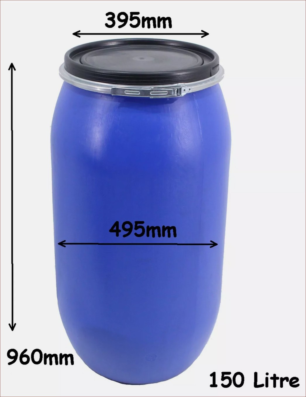

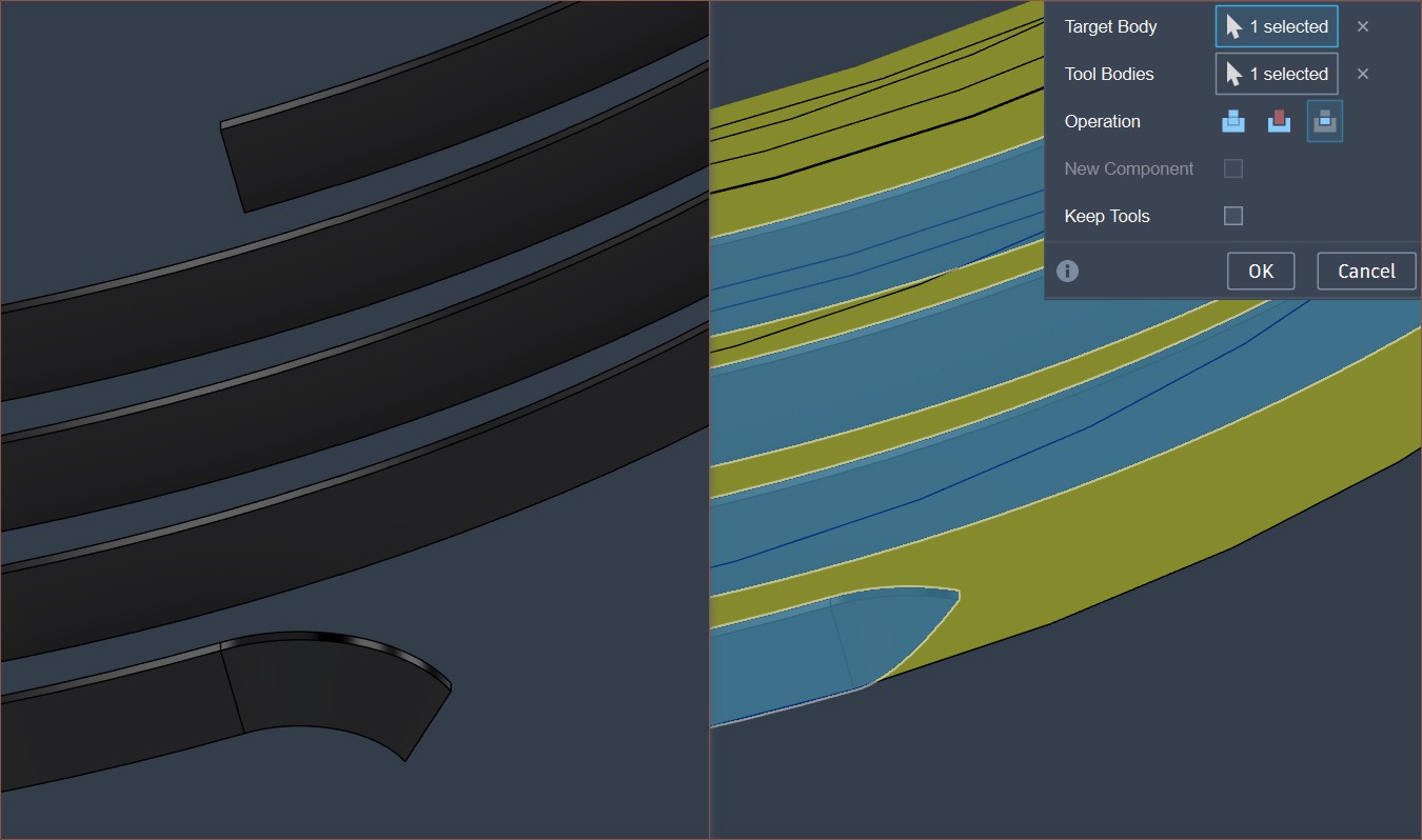

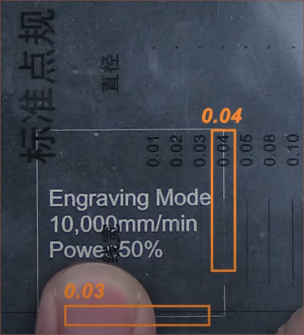

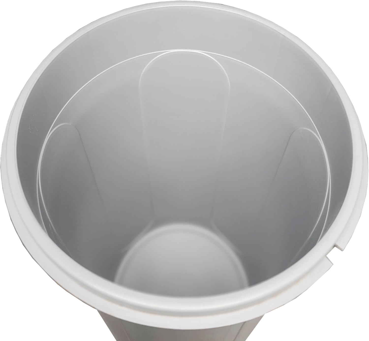

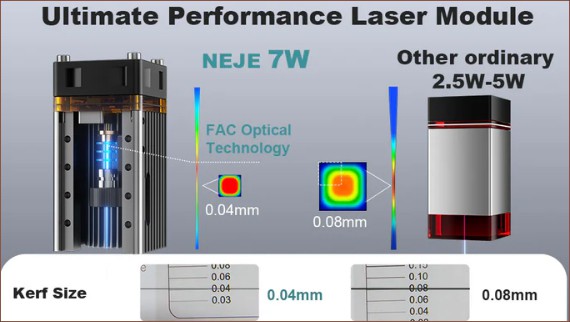

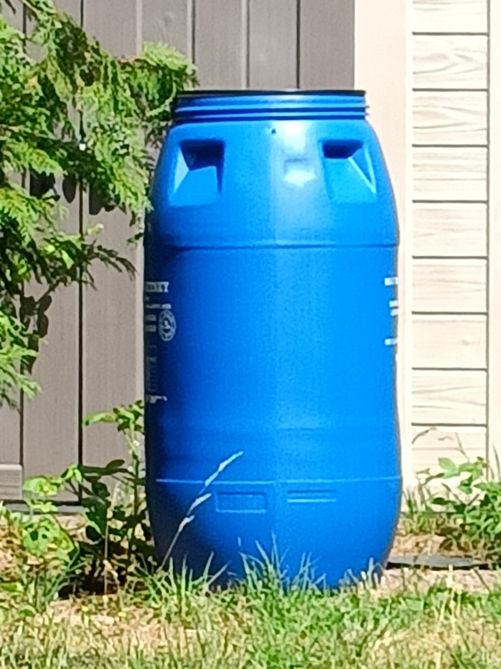

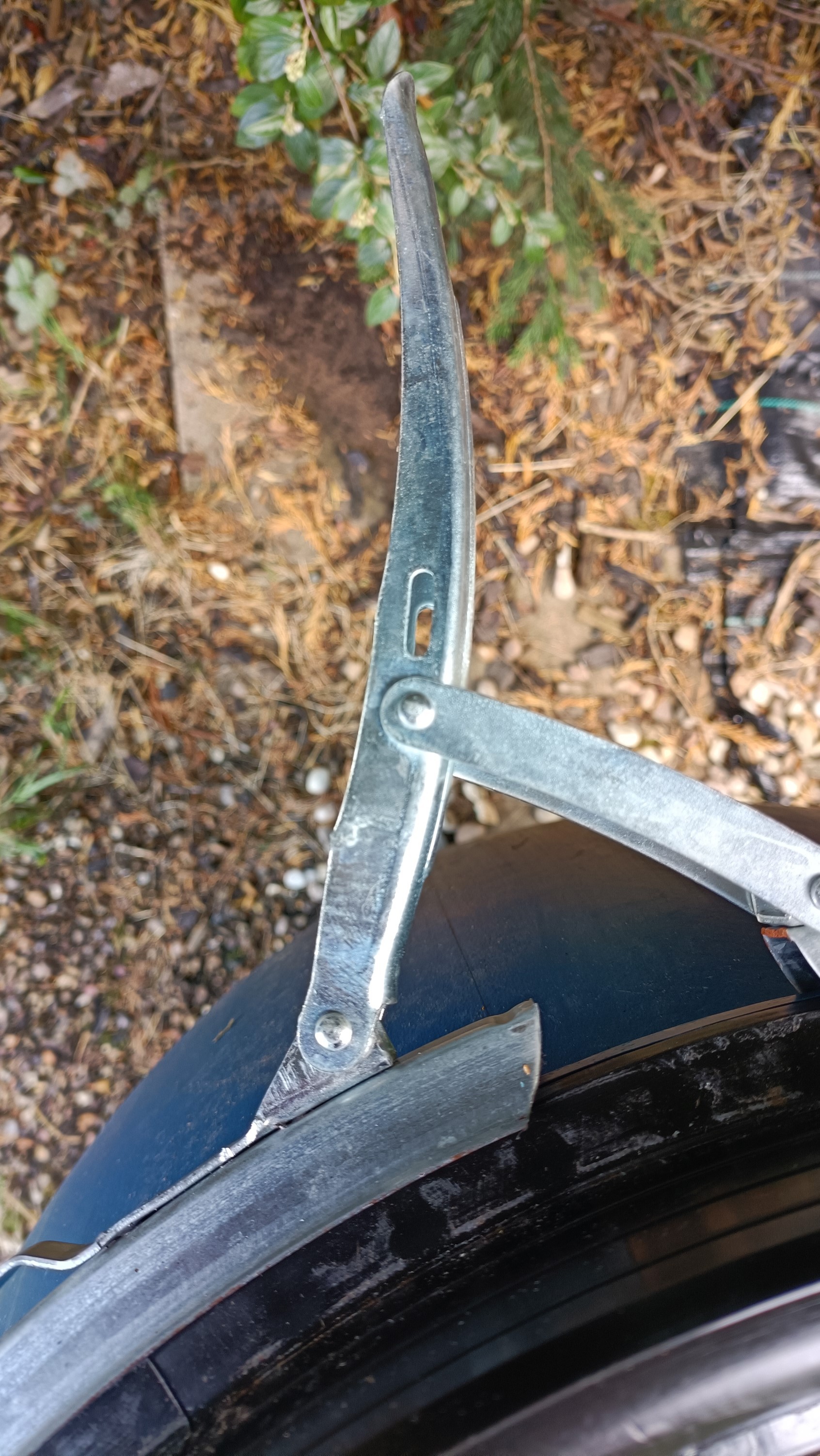

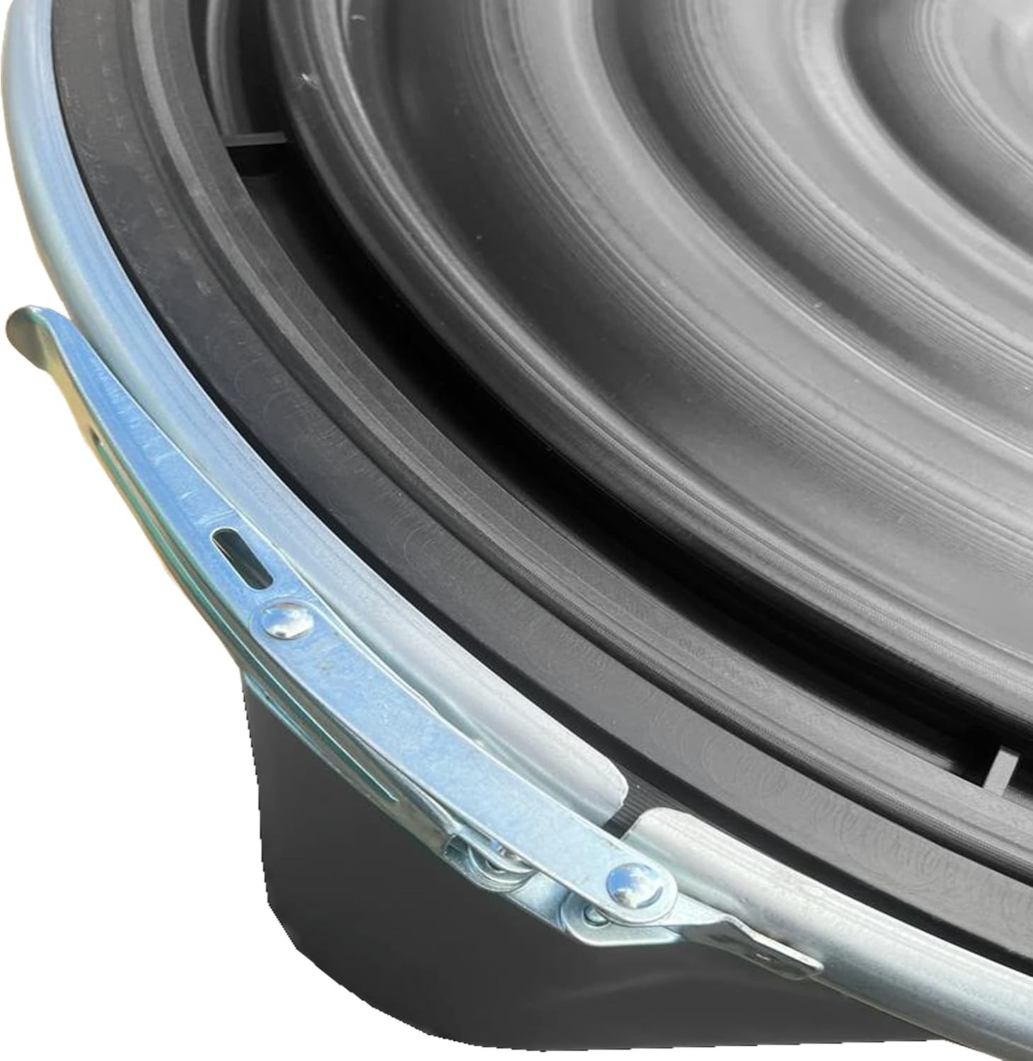

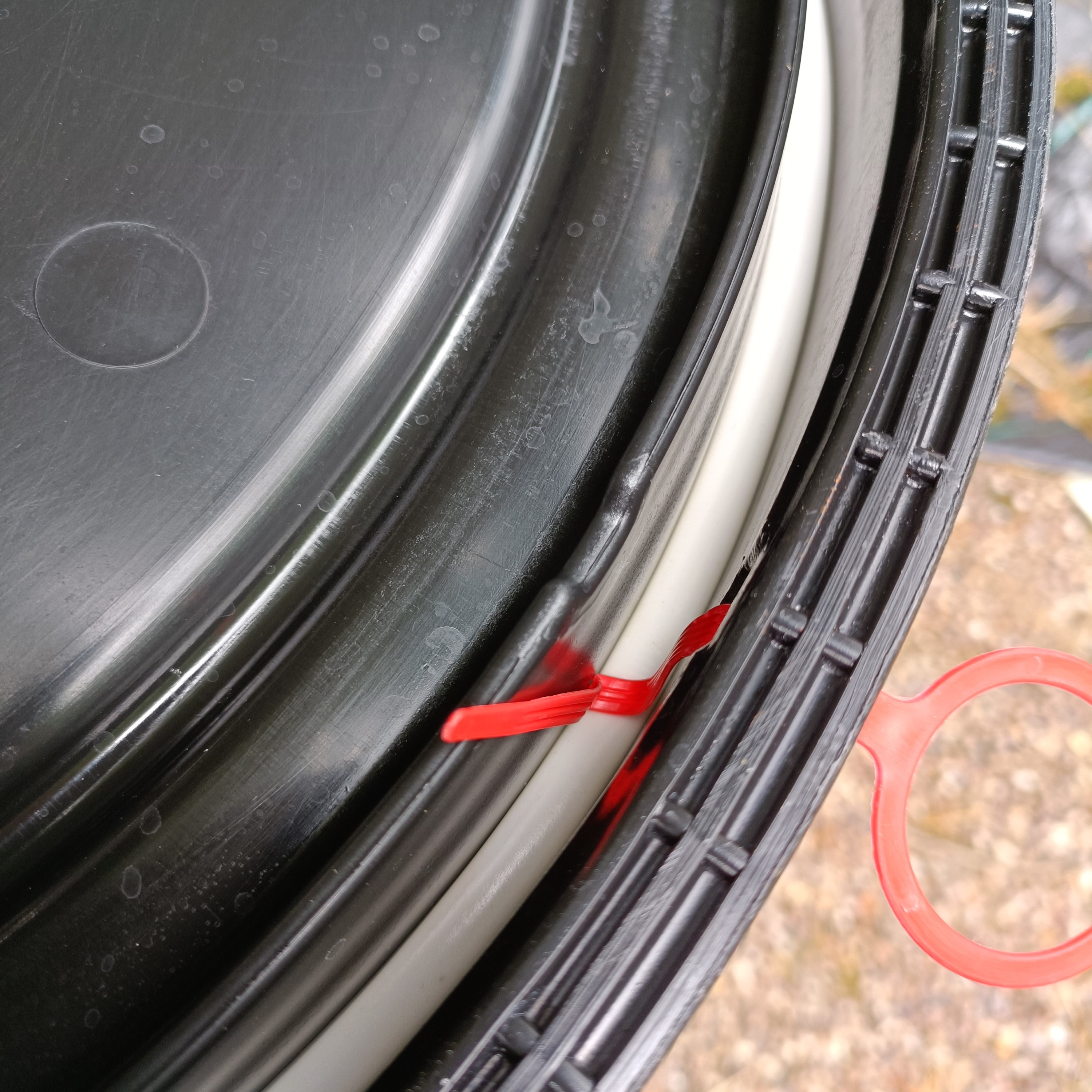

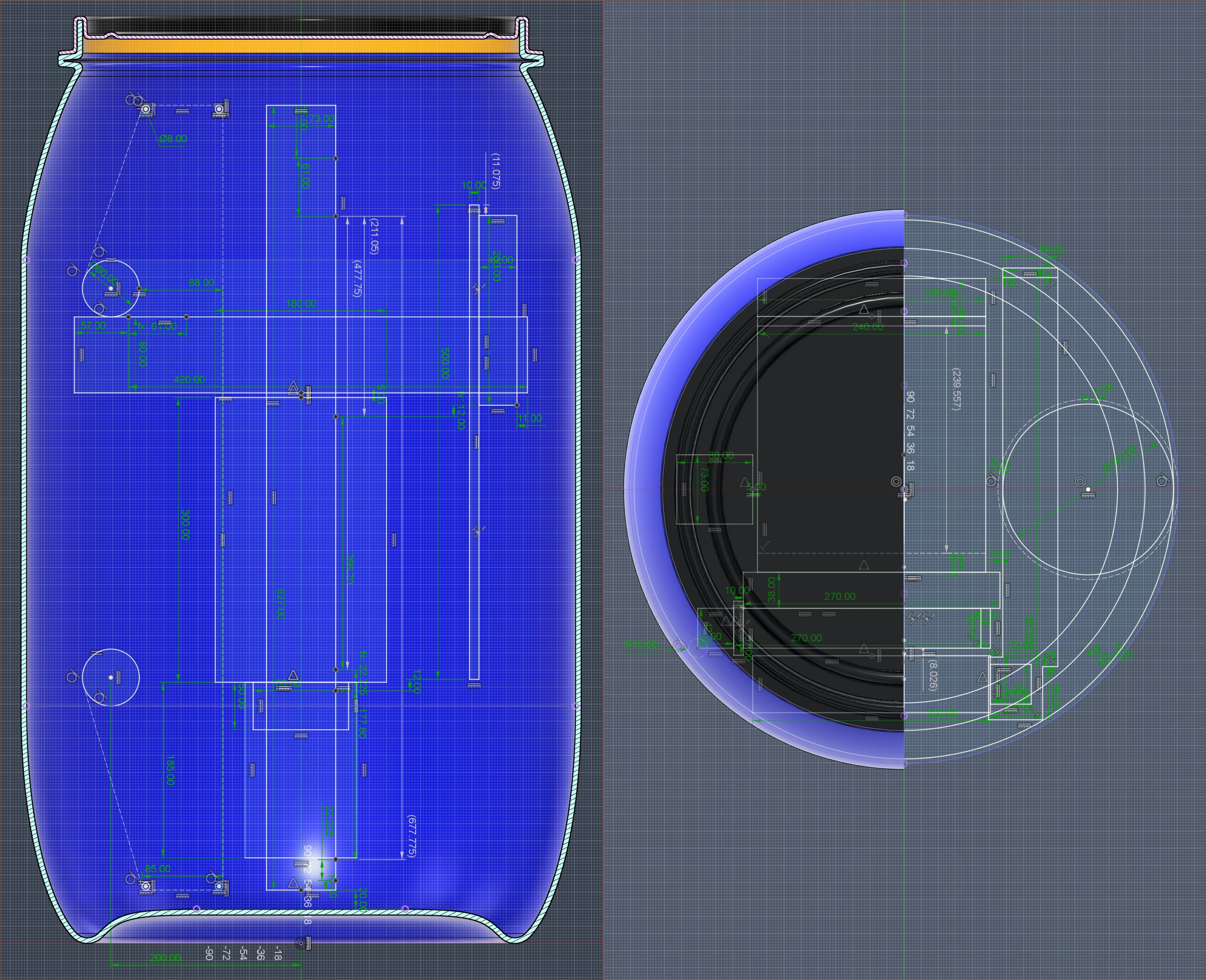

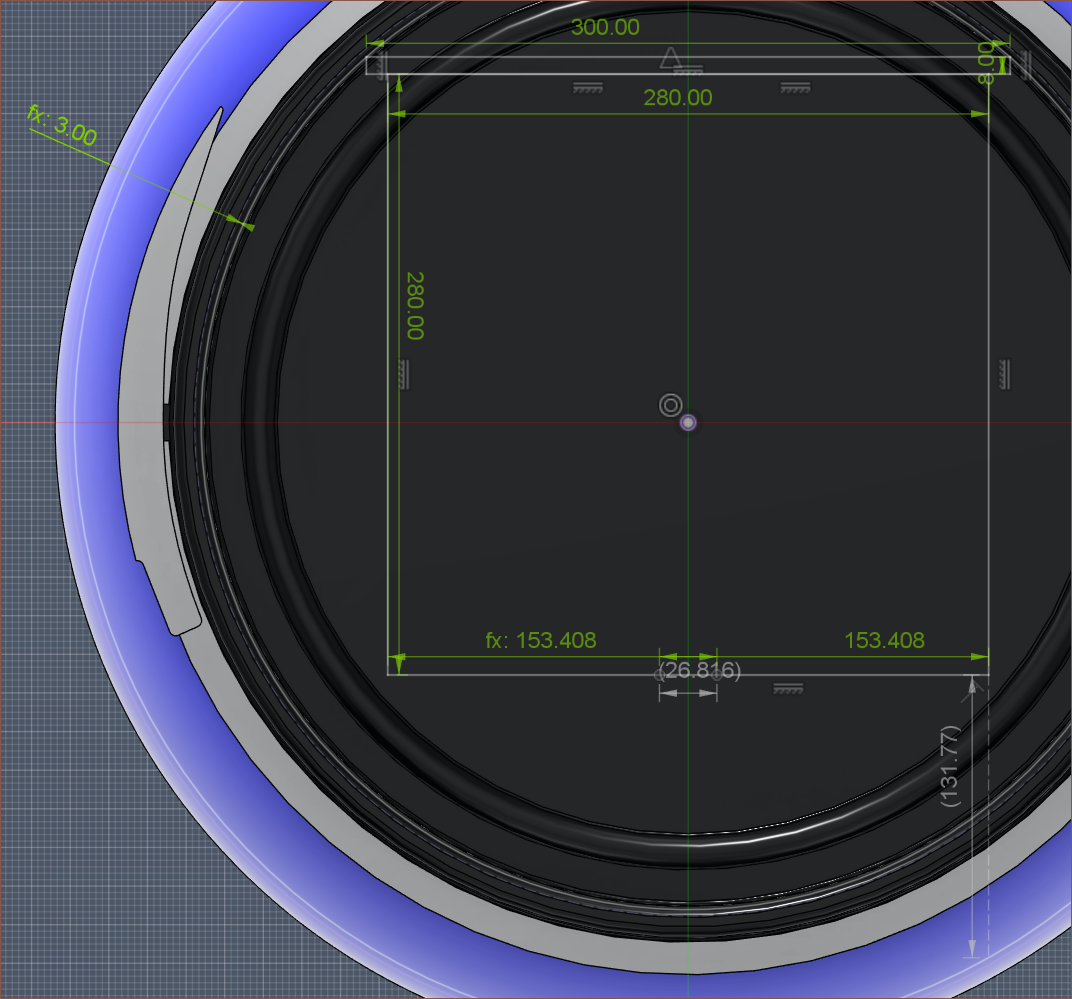

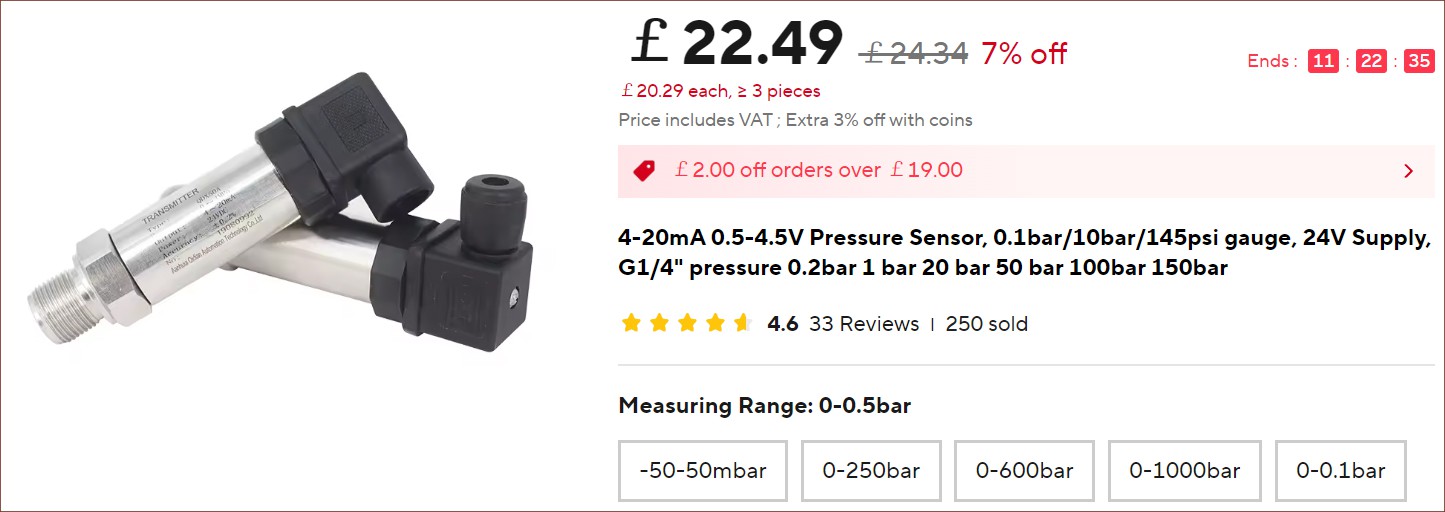

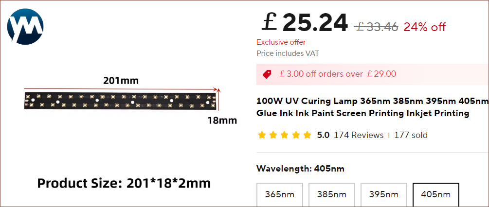

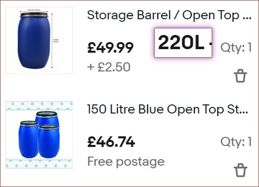

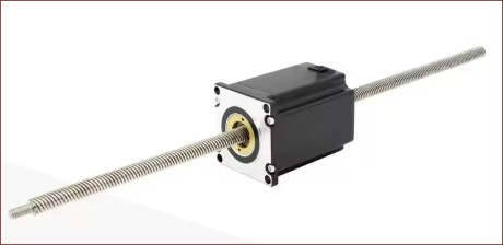

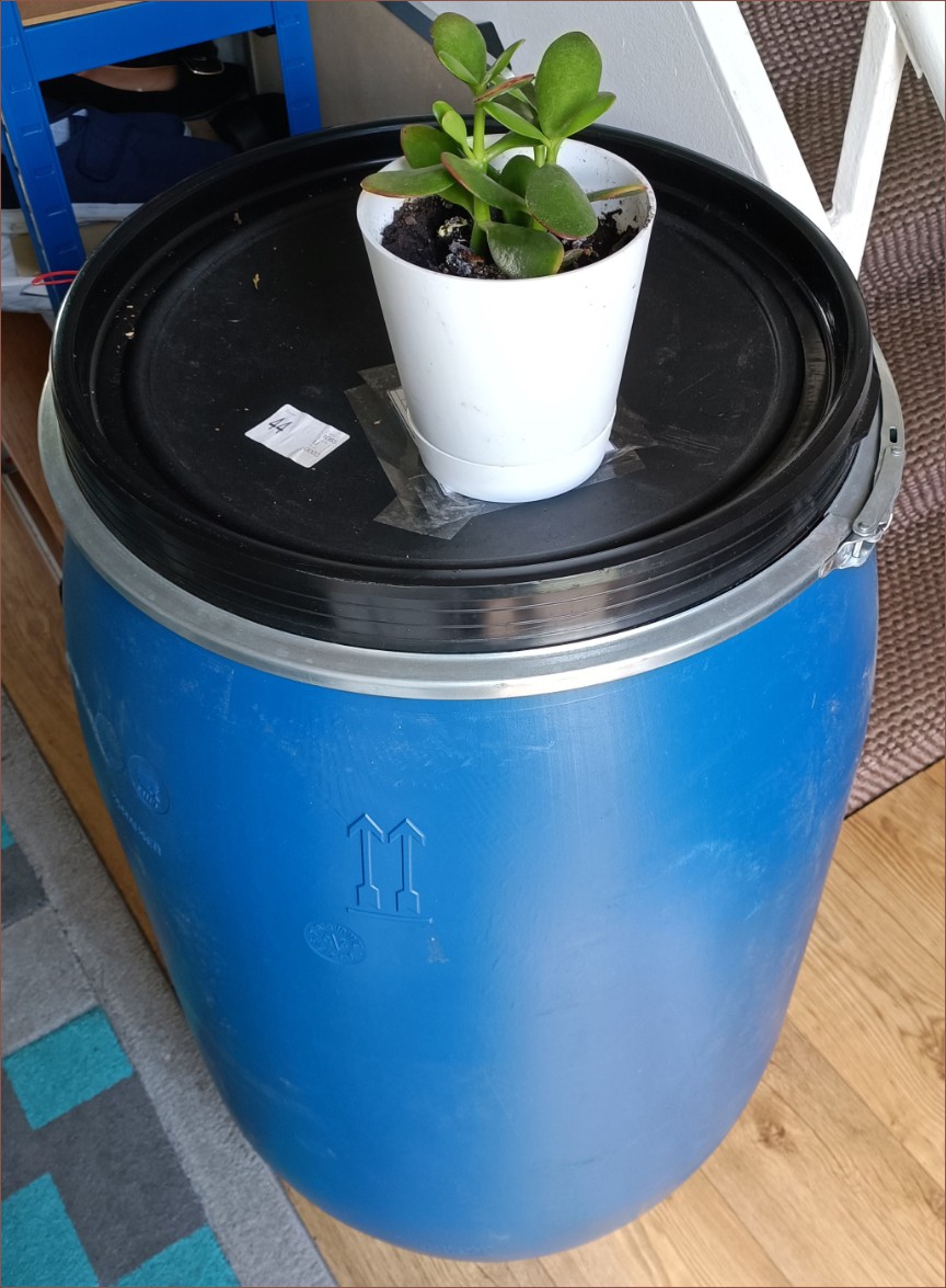

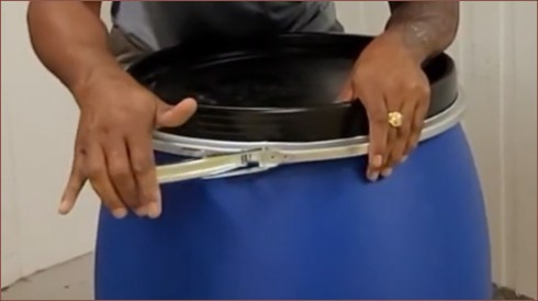

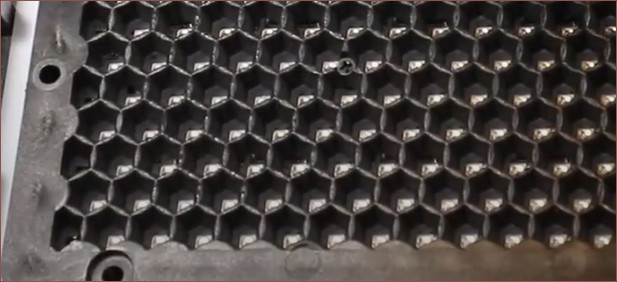

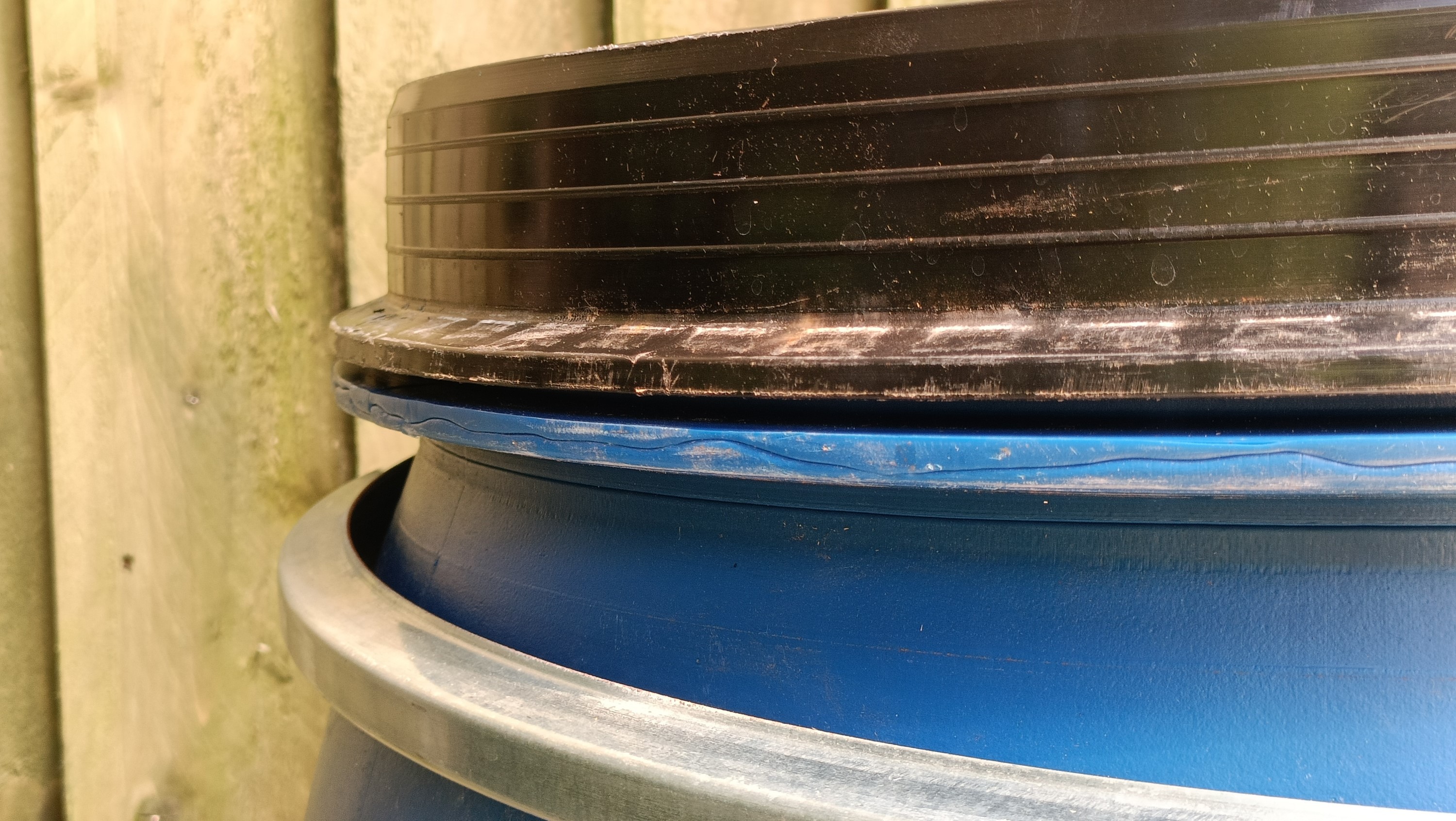

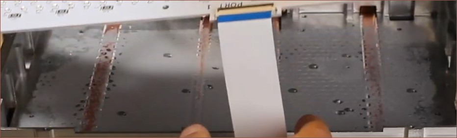

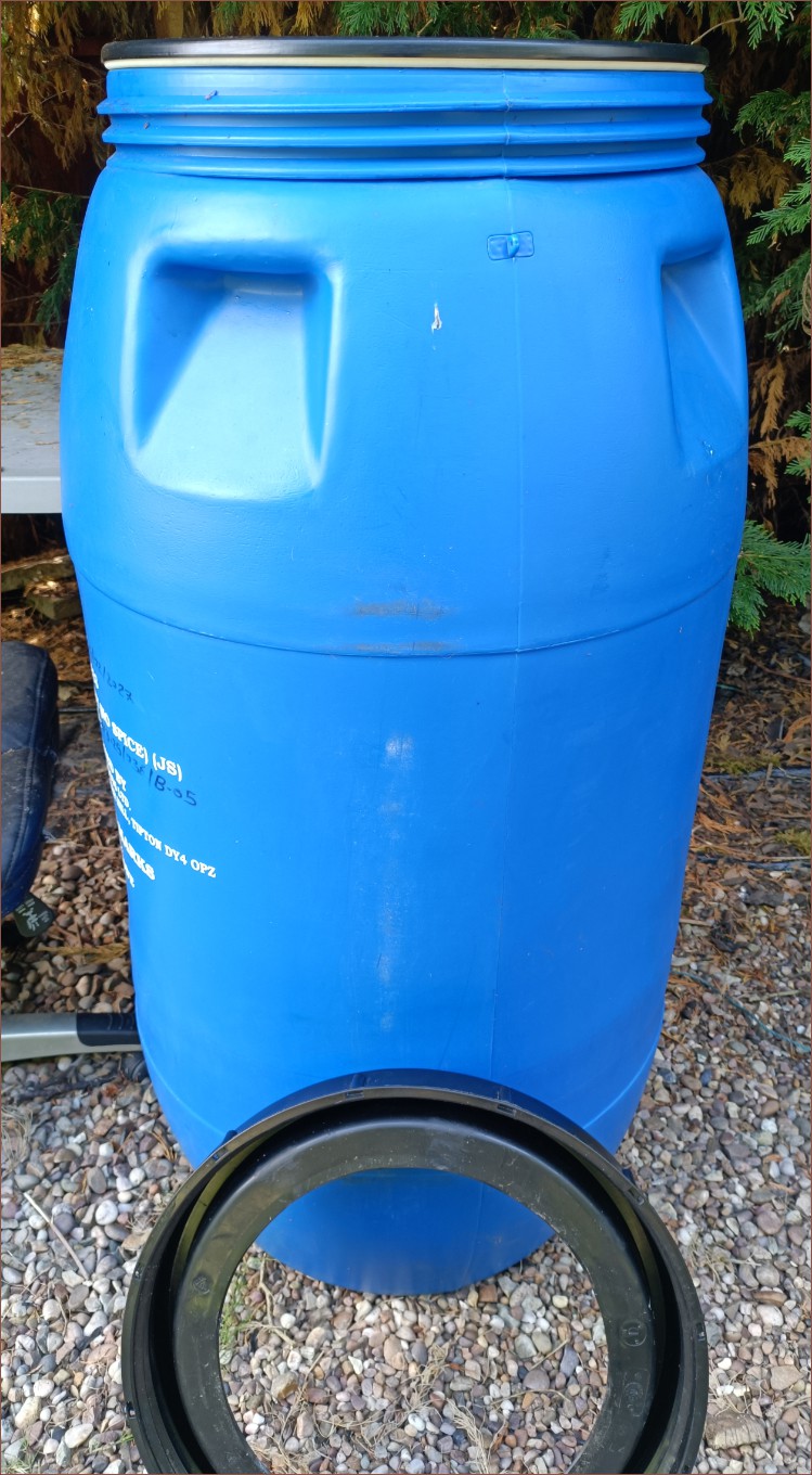

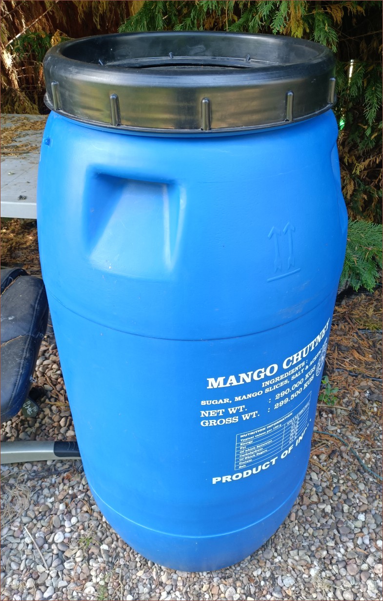

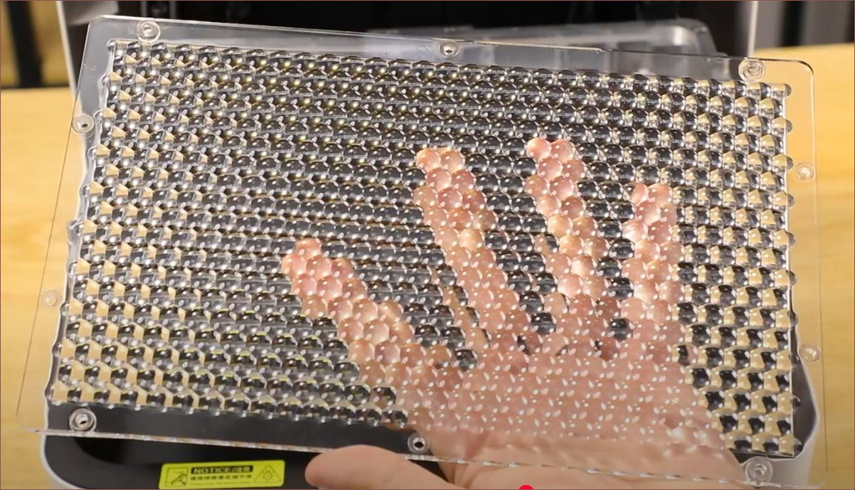

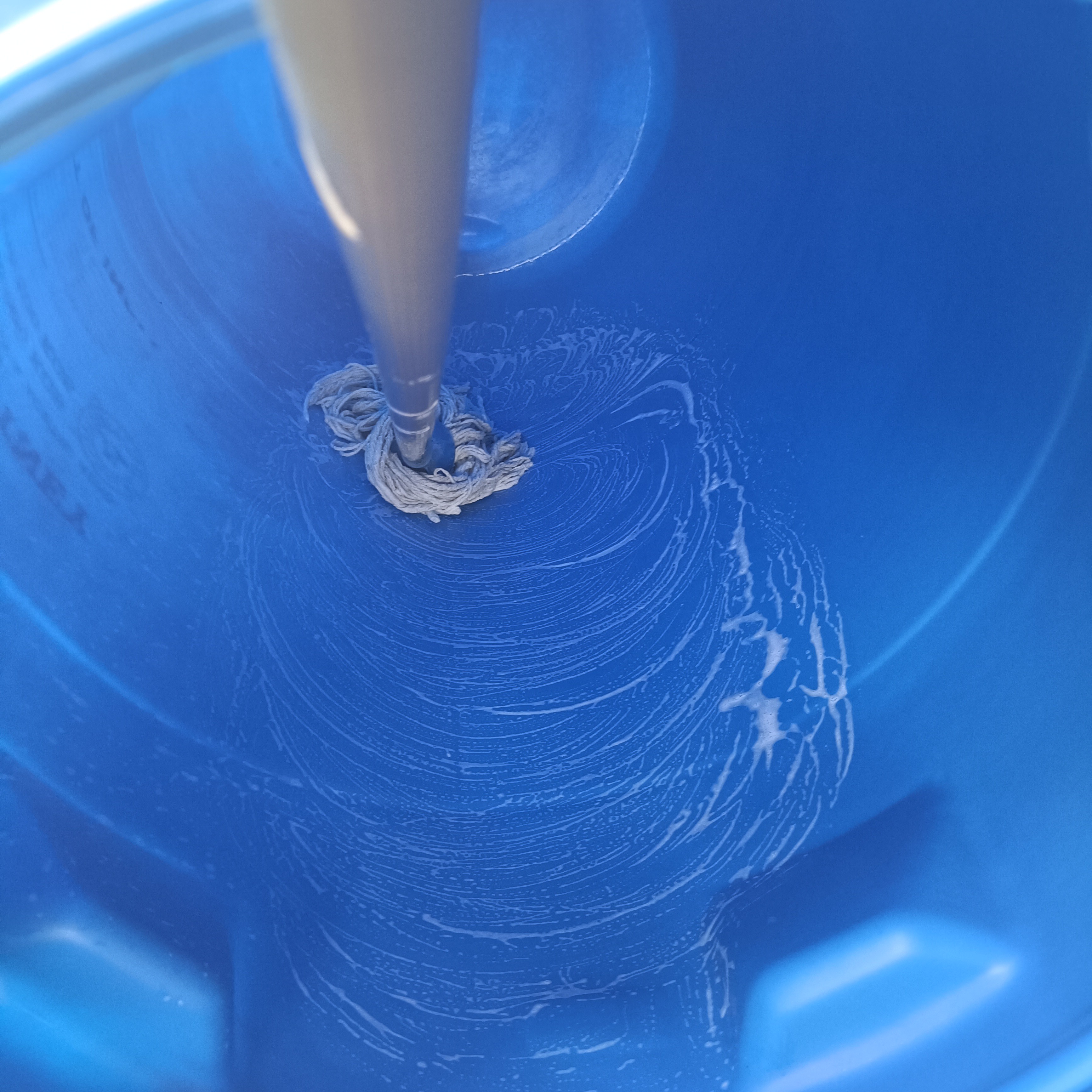

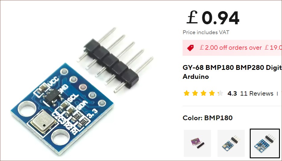

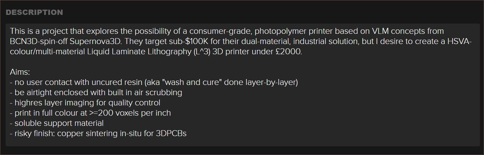

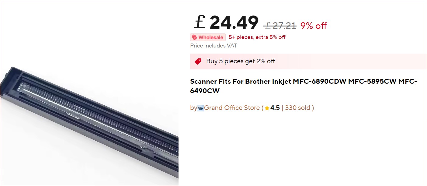

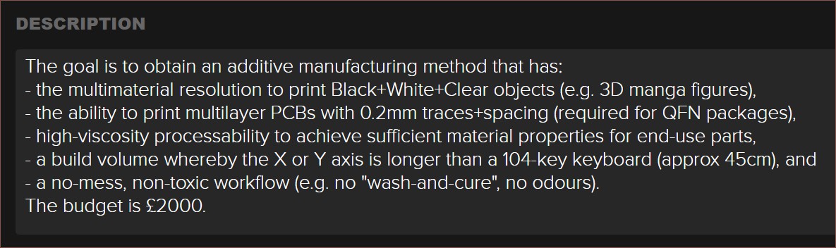

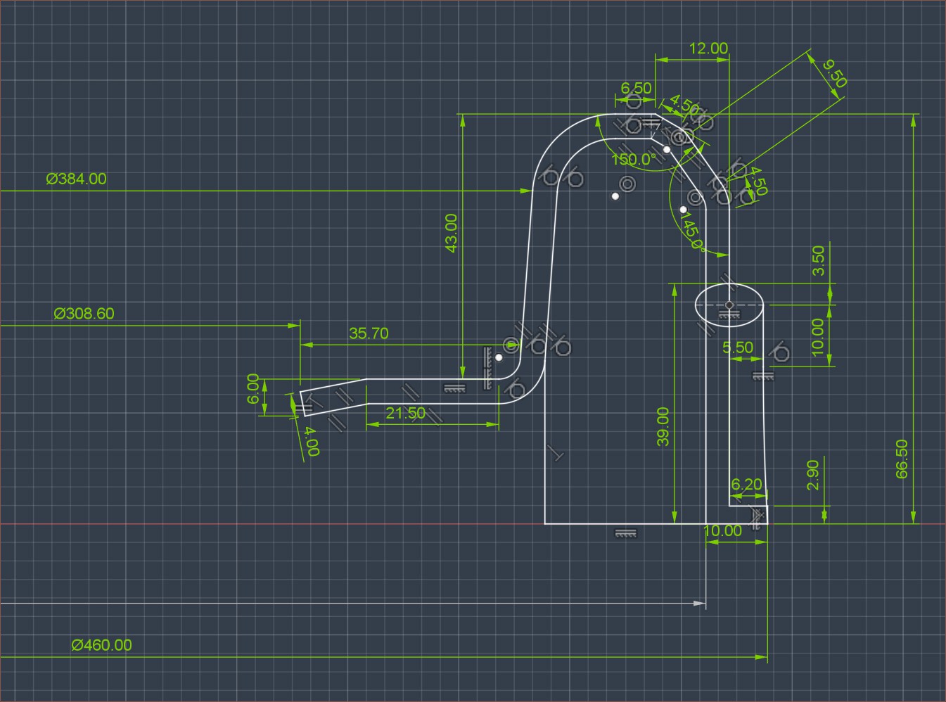

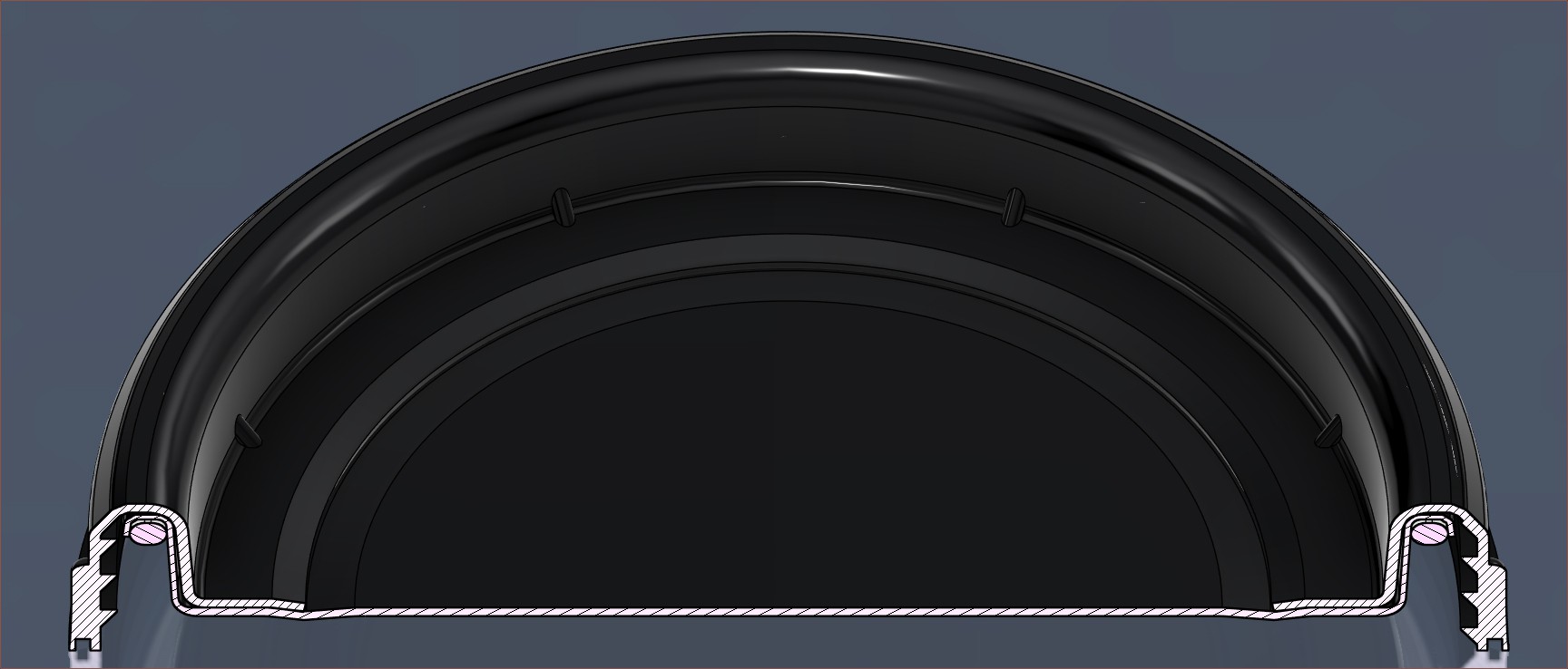

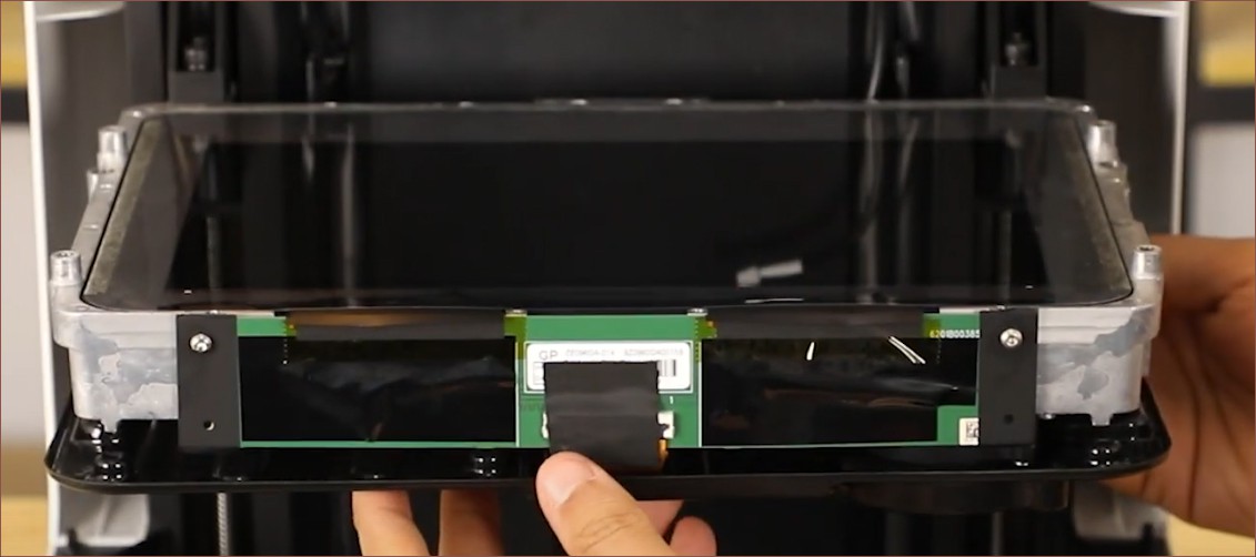

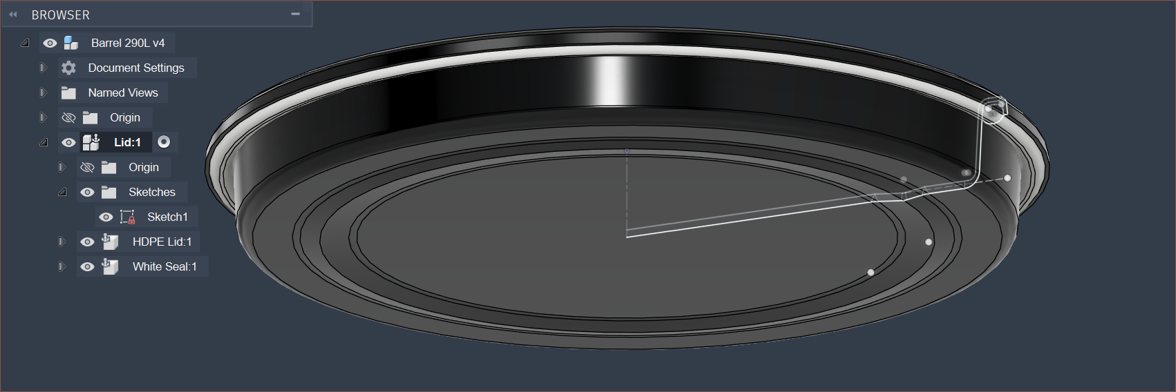

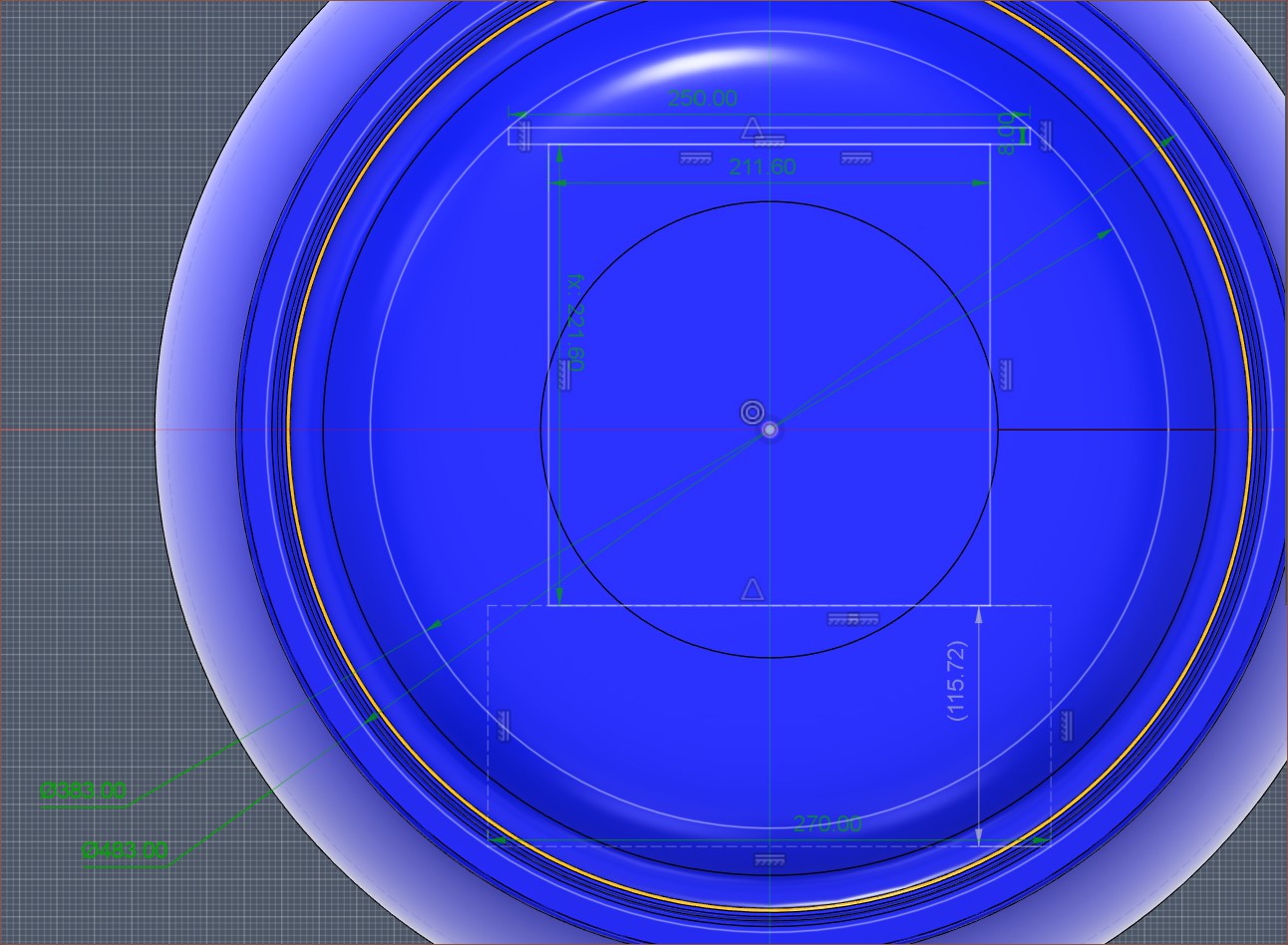

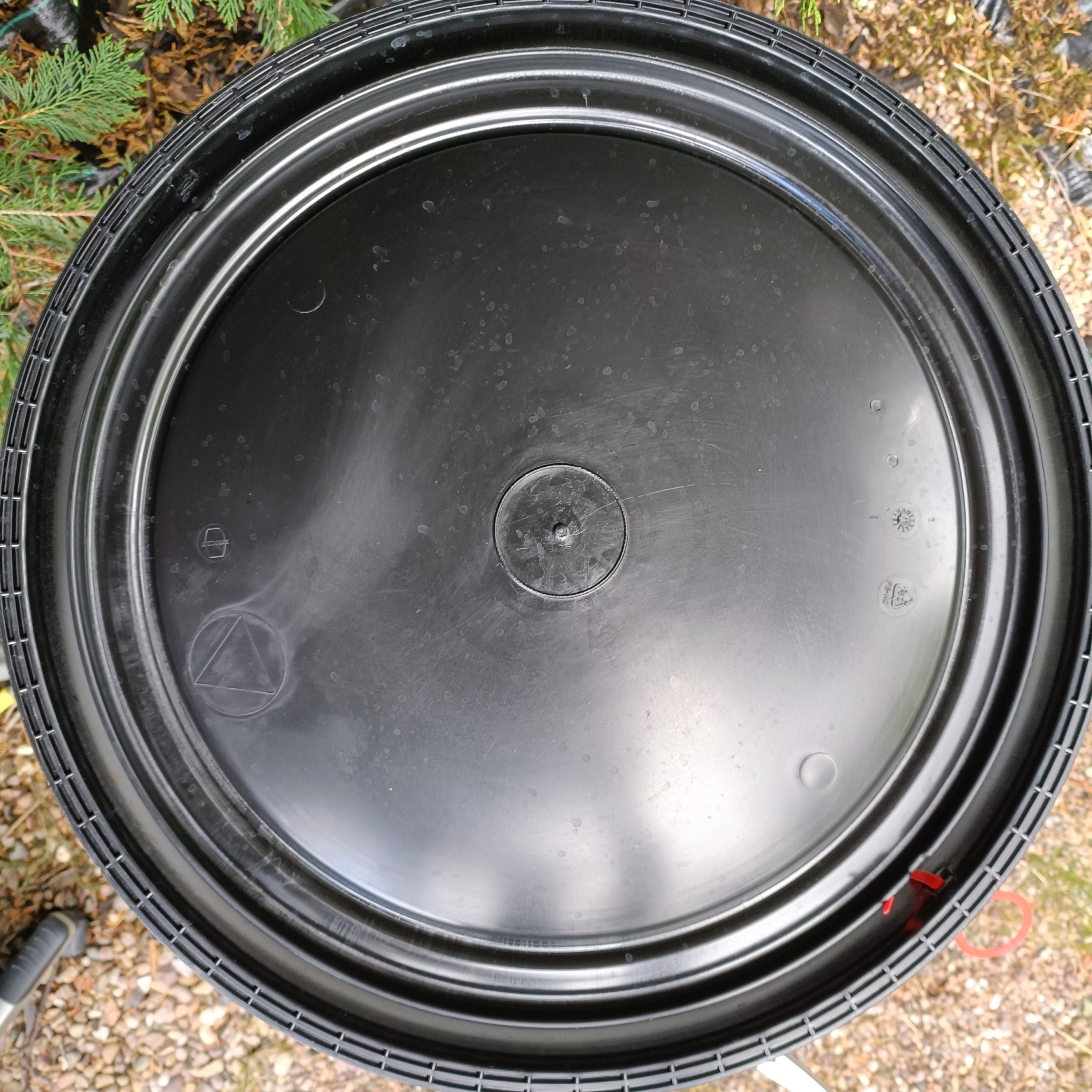

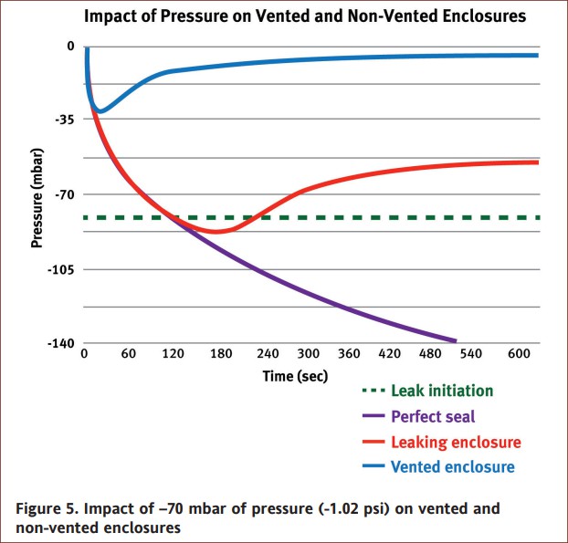

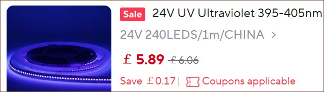

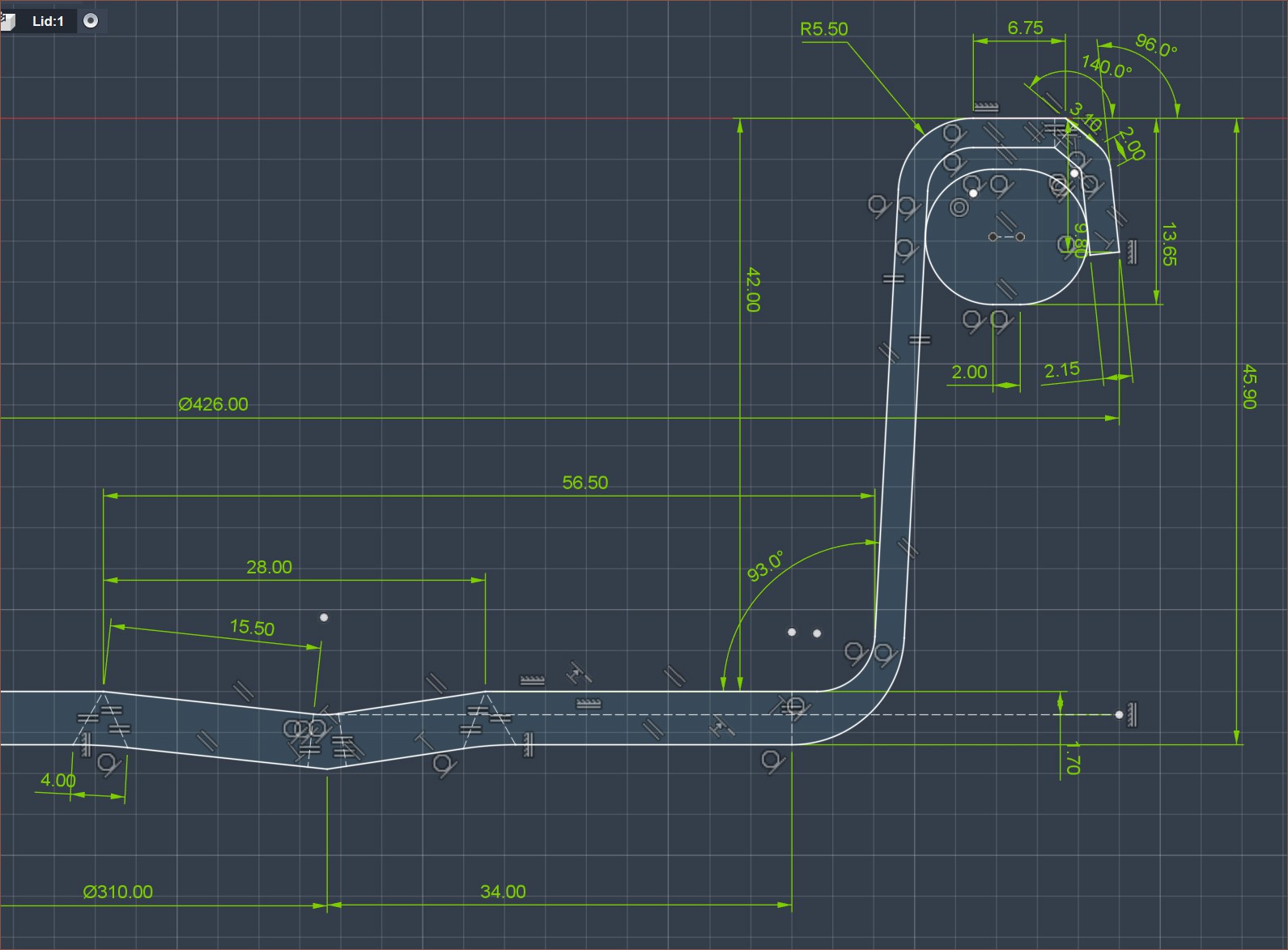

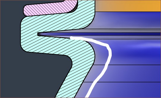

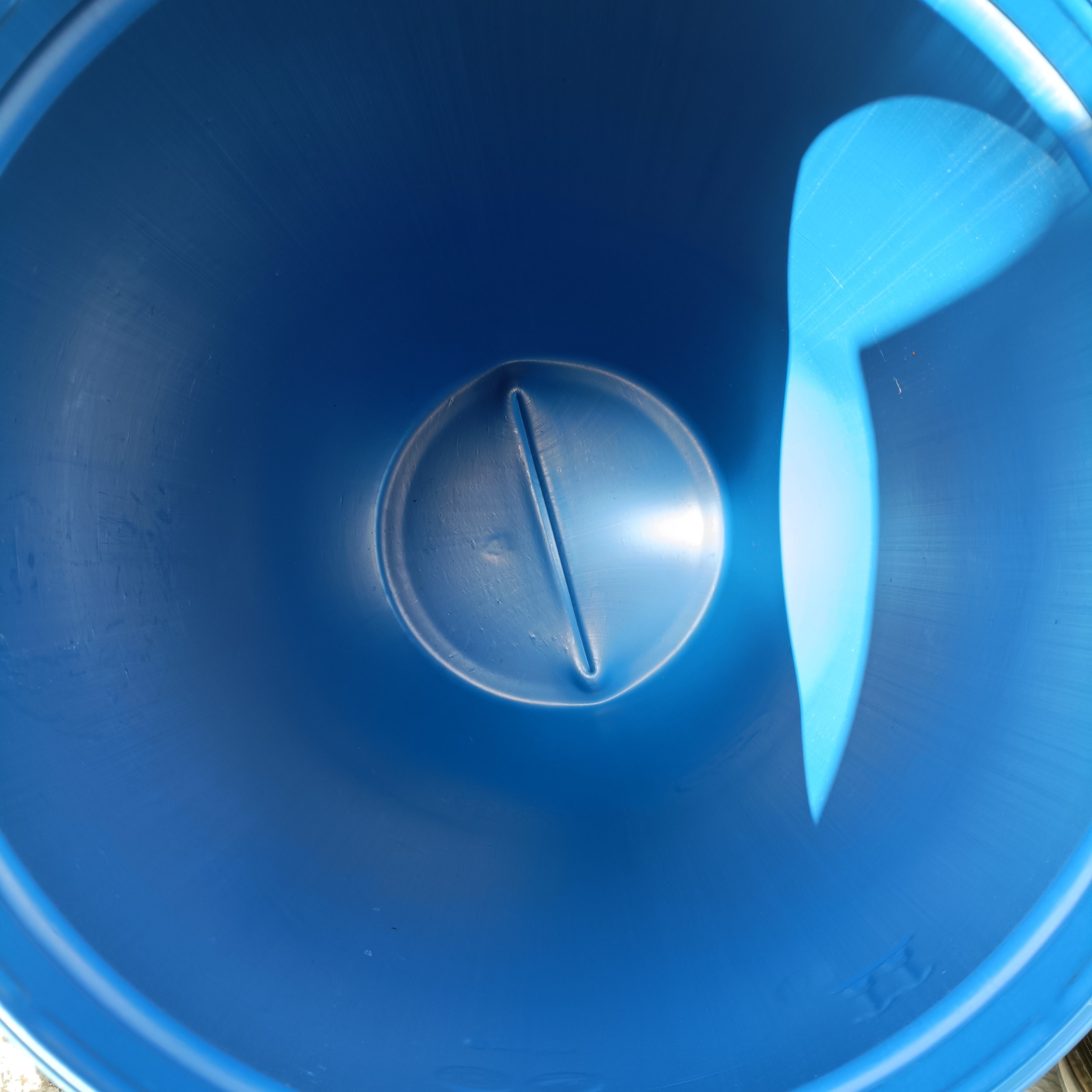

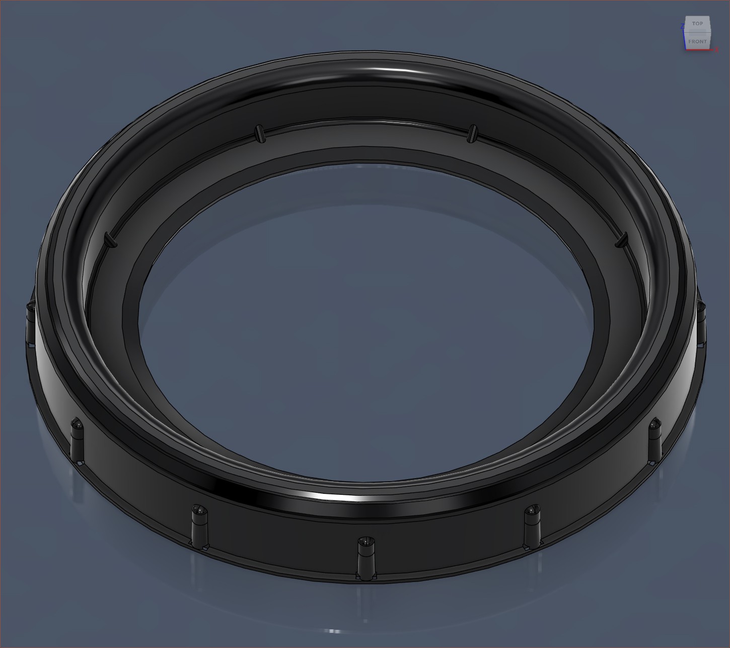

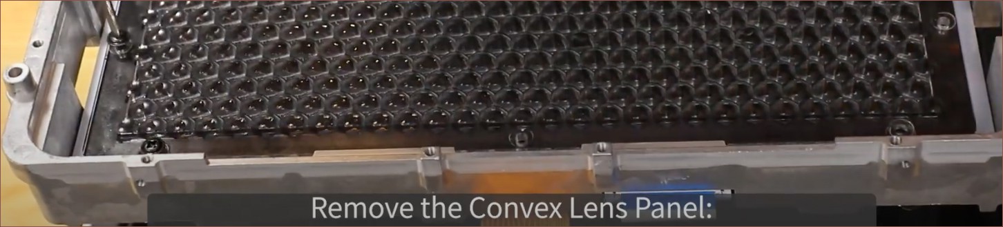

SlimeSaver [gd0105]
Combining MSLA and LOM to eliminate the time spent cleaning the slime.
The goal is to obtain an additive manufacturing method that has:
- the multimaterial resolution to print Black+White+Clear objects (e.g. 3D manga figures),
- the ability to print multilayer PCBs with 0.2mm traces+spacing (required for QFN packages),
- high-viscosity processability to achieve sufficient material properties for end-use parts,
- a build volume whereby the X or Y axis is longer than a 104-key keyboard (approx 45cm), and
- a no-mess, non-toxic workflow (e.g. no "wash-and-cure", no odours).
The budget is £2000.
Media
Inspiration and/or examples of working principle
The background music for this one is also the music I mentally associate with this project (though the one in my head is a bit different).
Navigation
Relevant Reading
Contents
The title tag system is explained here, and the most up-to-date is used (so there may be differences compared to the tags actually present in the log's title). Notable logs have bold white text.
L1
[T] Initial thoughts and ideas
L2
[M][T] Initial Thoughts 2022 Colourized
L3
[R][T] Screen Choices
L4
[T] Modding an existing printer?
L5
[R] Compatible with advanced FDM strategies
L6
[T] Technology Naming?
L7
[R][T] Screen, NanoDLP and the Photon M3
L8
[R] Screen
L9
[R] Plastic film (and resin removal)
L10
[R][P2] Plastic film
L11
[T] Shelved -> Researching Project
L12
[R] Target amount of colours to print a figurine
L13
[T] Moving LCD and light source?
L14
[R] IPA / wash fluid cleaning / filtration
L15
[R] Screens and build volume
L16
[M] Concept idea
L17
[T] Quick Print Method
L18
[M] Glass shelf on concept
L19
[T] Suspense Small
L20
[T] Demo print idea
L21
[R] Dithering for Full Colour 3D Prints
L22
[T] Print times and the importance of layer cleaning
L23
[T] Layer cleaning and curing ideas
L24
[B][T] Current price estimate
L25
[M] SleepCinema / CeilingSingle Frame compatibility
L26
[T] Current deliverable
L27
[M] 3rd Concept
L28
[T] Photon M3 Screen
L29
[M] Carriages and 495mm X axis
L30
[T] VLM as a wearable
L31
[M] Aluminium plate simulation
L32
[M] Roller Belt
- Thought of a differential belt solution
L33
[M] Roller Rail Holder
L34
[M] Roller now with LEDs
L35
[T] I'm going to try for 10 cartridges
L36
[T] Continuous fibre attachment
L37
[M] Continuous Fibre Arm Sketch
L38
[M] Continuous Fibre Initial Belt Path
L39
[M] Initial Z Axis
L40
[R] Magnetic Bed
L41
[R] PET Film Search
L42
[T] 3D Printed Circuit Boards?
L43
[T] Roller cleaning, motor drivers and air filtration
L44
[T] Smaller cleaning roller
L45
[M] Starting to remodel the roller
L46
[B] Current BOM price
L47
[M] 19mm OD roller
L48
[M] Updated Bed Assembly
L49
[B] Cost Cutting
L50
[T] Inital thoughts for the resin cartridges
L51
[A] 24 Stepper Drivers
L52
[R] Polyjet patent has already expired
L53
[T] Larger cartridges over more Z
L54
[T] Airtight enclosure
L55
[T] Back to ballscrews?
L56
[T] Lead screws, actually. (and maybe no filters)
L57
[R] Knife vs roller
L58
[R] Embedded electrical components
L59
[R] Multi Material SLA
- Academic research found
L60
[M] UV LED 108W
L61
[T] Building both the Suspense and SuspenseSmall
L62
[M] Roller and bed assembly for Small
L63
[M] Optimised Bed Assembly
L64
[R] Contact Image Sensor for coating detection
L65
[B][T] Current BOM Price (and more scanner sensors)
L66
[M] Second Belt on Roller Rail Mount
L67
[M] Fixed-Free Leadscrew Z Axis
L68
[M] Screen Block
L69
[T] Merge Application Rollers with Screen Block
L70
[B][M] Slighty more Z, Roller cover and X rollers
L71
[M] Small Case Shape
L72
[T] String bowden and 2060 Z
L73
[A] Proposed technology name: L^3
L74
[T] Magnets for reusable supports
L75
[R] Reusable supports
L76
[T] New cleaning method required
L77
[R] Electrostatic and magnetic resin
L78
[R] Expected PCB price
- As in, the expected material cost for this machine to make a PCB
L79
[T] Cartridge solution
L80
[B][A] A solution has been mentally computed.
L81
[M] Starting the LCD/Charged panel switcher
L82
[T] Replace cleaning roller with silver paste extruder
L83
[R] Polar molecules
L84
[R] Pick and Place (and silver paste)
L85
[T] SuspenseSizeable and Suspense^2
L86
[R] Laser Cutting
L87
[R][T] Quick Ideas for L^3 Additive Manufacturing
This one contains a lot of ideas and research and is constantly updated.
L88
[R] Ease Of Use
L89
[T][R] DIY 3D printing metal, without the furnace?
L90
[M][R] Auto Detach Bed
- Grid of spikes that goes through the build plate to detach parts
L91
[T][R] 3D Printed Mechanical Relay IC Chips?
- The start of the "mmRelay Array" idea
L92
[P] Scanner sensor and cable breakout
L93
[R] Q8100-60002 reverse engineering
- Name of the scanner sensor used.
L94
[P] Scaner...
  • [E1][P][M] 290L Barrel
    kelvinA07/20/2025 at 10:03 0 comments
    I still struggle to fathom how some companies somewhere need not one, but multiple barrels of mango chutney.
    While jumping through Ebay's "similar items" section within listings, discovering "wood barrel ice-baths", I found out that there's one semi-common HDPE barrel that is taller than the 220L, blue and doesn't use a galvanised metal clamping ring: the 290L barrel. Like the previous barrel, this barrel was acquired to store things outside, thus it's beneficial that the ring is made out of plastic. For safety with a 450/405nm laser, blue or white is more ideal than red, dark grey or black. It's also got 4 convenient indents to carry the barrel.
    Cleaning the barrel
    The one I found happened to be local; the going rates for both 220L and 290L seem to be sub £40/ea when collected instead of delivered.
    The black HDPE parts and the barrel's outside was scrubbed with a sponge and the inside was mopped:
    290L HDPE Barrel
    It's a 3-part assembly that is about 1115mm tall. This image was taken before cleaning.
    Inside of barrel before being mopped. It looked rather clean, and I think the base looks a bit more orderly than the 220-litre. Allegedly, these 290L barrels were used to transport orange juice. but it smelled like a new car mixed with something else that I can't identify.
    Mops don't work on walls, so I rotated the barrel 8 times to get around everywhere.
    Modelling
    I let it dry while I measured things for 30 minutes, mainly the height. I know it's taller than 1110mm but maybe 1120mm or less. Nominally, I got 1115 - 1116mm. Then I went to the other side of the garden to try and get a full-size image as orthogonal as I could so I could import the image in Fusion:
    I used a measuring tape against the branch, the wall and the barrel itself to get my 1115mm height estimate.
    Taking a picture from so far away highlights how surfaces on the barrel aren't as straight as they might appear when closer. I left the lid on because I imagined that I could use its height as a reference, but now I think I'll just measure the height of the barrel's straight section.
    I then spent over an hour modelling the lid:
    It took ages to determine where fillets started and ended, and I had to use some 48mm tape as a spacer to be able to use my calipers to measure the wall's thickness and height. It's rare times like these where I wish I had a 3D scanner. Fusion's weight estimate is 750g and the real one is 100g less, and I believe some of that discrepancy is because I don't know the cross section of the seal. The HDPE lid alone is reported to be 600g in Fusion.
    I have yet to model the other 2 parts.
    Trivia
    I also tried using Wispr Flow for this log, but ran into similar issues as when I tried Windows Dictation over 2 years ago. I have to think of the sentence, send it to my mind's Speech Processing Unit, say the sentence, read the sentence and correct it. The first 2 steps is the bottleneck because I don't think of sentences synchronously, so I generally have to think of the entire sentence in my mind, recite it, and then say it.
    Maybe this workflow is a lot better for people who can literally just say what's on their mind? It's still better than Windows dictation because at least I don't have to worry about punctuation and the default CTRL+WIN shortcut is a lot less cumbersome than WIN+H.
    [July 30]
    Modelled the screw ring
    Cross section of ring and lid
    I've modelled the ring and kinda see how they're supposed to mesh together. It seems like it aligns with the lid modelled previously.
    Cross section of the plastic ring
    Then I had to do some tricks here and there to properly design the custom thread:
    Left: Adding the curved start. Right: Combine intersection to trim away the excess.
    Complete ring
  • [R] 210L barrel?
    kelvinA07/09/2025 at 21:06 0 comments
    While I was writing the conclusion of the previous log, I came across this barrel that comes in 4 unique colours for some reason, such as light grey or turquoise:
    The dimensions are allegedly 500mm on the base, 660mm at the top and 940mm tall. It certainly looks like a more-ideal spread of those litres in terms of fitting components inside, and my opinion is that the light grey does look particularly home-like. Looking at the levels, the light grey is also even more reflective of blue than the blue barrel.
    The obvious drawback is that the clamping ring is even wider, as well as the entire barrel, requiring even more space. It seems that the ring has a more curved shape and doesn't overlap when closed.
    The inside for the light grey looks nice. I don't think it would be all that much harder to clean the edges inside. I just wonder if it's as solid as the typical barrels considering there's a £20 price difference. The cost might be because the walls are thinner, or the seal isn't airtight, or perhaps it's simply that they can save on shipping costs because these cone barrels can be stacked.
  • [P] 220L barrel and its steel ring
    kelvinA07/09/2025 at 20:21 0 comments
    One thing led to another, and an allegedly "new" barrel arrived:
    The ring was slightly rusted here and there, and the outer wall had some thin layer of mud/dust? Not a particularly inspiring first impression. I asked the seller and they apologised for the inconvenience and said that this was pre-used.
    Barrel body and lid: 4.5 / 5 stars for suitability as an enclosure
    The inside of the barrel and the lid looked fine enough:
    I did some knock tests and it's certainly some solid plastic. It's not some milk carton or 4mm pane of polycarbonate. It might look like a supersized yoghurt bottle but it's stiff like a desk.
    That 3D line thing at the bottom is raised 1cm and likely remnant of the fabrication process:
    You can see in the video that it looks a lot floppier when the plastic is hot and going inside the moulds.
    I also learned that the sealing is done with a white o-ring instead of the flanges, as implied by the CAD model:
    Some of the measurements I noted down (in centimetres):
    • Body
      • >43 for bottom diameter
      • 46 for the bump diameter before the opening (see Eccentricity below)
      • >58, likely 58.5 for the widest internal diameter.
      • 59.5 or thereabouts for the outer diameter.
      • 36 for the vertical section
      • 95 from the middle line to the rim of the barrel
        • 94 if from the bumps
      • 46.5 - 47.5 for the opening (see Ovality below)
    • Lid
      • 48.5 diameter for its tallest feature (that looks like a wall)
      • 23 out from that wall-like feature as the handle clearance
      • 1.8 between bottom of body flange to the taper of the lid's flange
    The barrel has a slight amount of eccentricity, ovality and coning.
    Eccentricity:
    The bump is a circle, but one side has the bump aligned with the opening and the opposite side extends out (white line) by about 1cm.
    Ovality: It's only 1cm. I think the lid flexes when it goes ontop of the barrel.
    Coning: Like a standard plastic bin or a plant pot, the "straight" section of the barrel slightly cones out. Maybe the angle is 1 degree or something so that it can release from the mold.
    All these things are kinda minor, and other than the seam line at the bottom of the barrel, it looks rather easy to wipe down. Its rigidity also inspires a lot of confidence. Furthermore, the roundness means that, while large, the barrel can fit in an outer corner:
    Like it's "big" but it feels like it needs less "personal space" than a CR-10, for example.
    Clamp ring: 2 stars
    Unfortunately, I've sent the barrel back because the clamp ring was too hard to work with. It's super easy, barely an inconvenience to open the lever and take the ring off, but the other way required levels of force I just didn't have. My brother did, but he had to take a stance like some kind of superstrength superhero when closing the lever.
    One of the first issues is that all the hinges are loose-fitting and the ring isn't much taller than the thickness of the flanges. As seen in the below video (at 3m 0s), you need one hand pushed on the lever to expand the ring and then align the entire circumference so both flanges. With practice, it probably would be less of an issue.
     I haven't seen a close-up image of the barrel without the metal ring on the internet, so I took a picture. Below, you can see the kind of gap between the lid and the body flange, as well as artefacts in the body flange due to the manufacturing process:
    Maybe the ring isn't the one that came with this particular barrel but another one where the height difference is smaller? The guy in the above video seemed to have a much easier time closing the clasp.
    Another issue is that an additional 23cm of space from the lid ring to a wall is needed to have enough space for the lever:
    This wouldn't be an issue if I didn't have to put my entire body weight on the barrel to stop it from spinning due to the high angular force applied, meaning that the lever would have to be facing away from me:
    For a barrel that's easier to close than the one I got,...
  • [R] Seal Detection
    kelvinA07/06/2025 at 12:06 0 comments
    Detecting if the barrel is sealed seems like most tamper-proof method of ensuring safety. This is because I remembered what was said in a BambuLab interview about the H2D:
    True story that one influencer tested the printer [and] write us a message to say:
    "I really want to open the door to shoot a footage of the laser engraving and I know you have some sensors on the door, so I tried my best to use magnetic to cheat your sensors, but uh somehow it didn't work. Could you tell me how to cheat the system to make the door open while the laser still works?"
    and uh yeah, we place lots of sensors, you know, to make sure even if the customer wanted to cheat the system, we won't, sorry. We won't allow you to, you know, light up the laser if all these security measures are not in place.
    And so, similar to encryption, whatever solution I come up with for a DIY strategy has got to be somewhat resilient to spoofing whilst the entire system is known. For example, a simple door switch can be bypassed by shorting 2 pins.
    With a pressure sensor, it both detects to make sure the lid is closed tightly and if air is unintentionally getting out, making the filtration less effective. My assumption will be that anyone savvy enough to program a microcontroller to send fake pressure sensor data also knows what they're doing.
    I guess trying to seal both a power inlet and pressure outport isn't too demanding. The issue is that it requires components that can move air out of the barrel and then re-equalise pressure when the print is finished, which costs money and space.
    I'm also reading Electronics Protection: The Unknown Problem with Airtight Enclosures (PDF), wondering if the temperature differentials of the barrel and its environment could pose an issue, and it sounds like it. Their proposed solution was "expanded PTFE" but it allows gasses to move in and out, which defeats the whole point of the barrel.
    It seems that the simple and inescapable choice is to maintain a detectably negative pressure with a compressor and electronic valve, where every 30 minutes or so, the print pauses, makes sure the air is clean and then equalises the pressure before recreating the negative pressure. The assumption is that the inside of the barrel will be hotter, thus the negative pressure will slowly increase.
    Some bargain bin pump is unlikely to pass my low-noise standard, especially since the pump will be going out to 1 bar. The air pump below went up from 66 to over 80 dB when pumping into the open air:
    The "fixed" pump at 37s in the below video is still much too loud when pumping into open air:
    Car tyre compressors aren't much better:
    It seems that, on the inside, a piston system is used:
    Perhaps the good old-fashioned way is to get the Y axis to push a manual bicycle pump? There was a graph in The Unknown Problem with Airtight Enclosures I mentioned yesterday where the pressure decreases and then equalises. The rate this happens will be enough to tell if the barrel is sealed enough or not.
    An idea could be to have a pump that is pressed when the effector goes to the bottom, which it typically would have to do when selecting the cartridge to clear the resin so that the laser can work on the printed part.
    When it comes to the actual sensor, I was a bit worried when AliExpress started off with sensors costing over £20 each, but with the help of Gemini, it sounds like I should be fine with a low-cost barometric sensor such as the BMP180:
    10pcs is £5
    whereby
    The BMP180 measures absolute pressure in the range of 300 hPa to 1100 hPa (or 300 mbar to 1100 mbar).
    1000
     mbar (ambient absolute) -
    50 mbar (gauge) 950 mbar (absolute).
    As you can see from the graph above, the drop to -52.5 mbar
    The listing also has the BMP280, which is cheaper. Turns out it's also the newer sensor with twice the...
  • [M] 3D sketching in the 220L barrel
    kelvinA07/03/2025 at 10:44 0 comments
    I've unintentionally put in upwards of 9-hour days for... checks notes... 7 days to get the above solution which achieves multiple desired goals. As you might understand, the first complication is that I need to work within a cylindrical area. The second is that it's not a pure cylinder but curves at the top/bottom similar to a filleted chamfer, meaning some things only fit at certain heights. If you look at the top-down angle above, that's the reason why there are 3 concentric circles to denote the perimeter of the barrel at its widest section, about an inch from the opening and the opening itself.
    Printers I've seen, like the Ender 3, have the screen on the right side. Thus, that's why the print volume is more leftwards. I plan to have the screen on the inside and perhaps a status LED on the outside.
    Most of the time was on the motion system. Considering that, unlike FFF, this application calls for very precise movements that don't need to be particularly fast, it's probably no surprise that most of my research was on ball screws. Considering my work on delta belt tensioners, I've decided that I'd rather not deal with belts and the design/manufacturing time that comes with it.
    Day 1
    One of the first things I saw was the below video:
    Then I went on AliExpress to see different options and how much extra length is needed for an axis. The lowest I found was 119 - 120mm.
    Day 2
    I found out about non-captive stepper motors:
    I was also asking Gemini about some questions about the build plate material. Both it and I believe that a typical aluminium bed will interfere with the charged-plate responsible for attracting uncured resin back onto the film.
    Then I found out about enclosed sliding tables, which look as sleek as the Windstorm S1 I mentioned a few logs back:
    I thought this would be particularly useful for the Z axis. If kept in the orientation seen above, the build plate would be vertical and exhibit no counter-lever sagging, unlike the typical orientation for 3D printers having the build plate parallel with the ground. This was one of many reasons for keeping the barrel upright. However, this orientation risks resin falling onto the ballscrew. Hence, that's why I thought this enclosed module would be beneficial.
    Then I found a forum post titled Ballscrew Basics where the OP mentioned some interesting things. notably:
    "But what about accuracy?? Isn't that the primary reason to use a ballscrew?" True, accuracy can be extremely high, but ACME screws can be ground and with a correct, matching nut, can exhibit identical accuracy to the finest ballscrew.
    This claim both tracks with the video above and the Prometheus MSLA designers testing both a lead and ball screw. One of the bigger factors is efficiency:
    A typical ACME threadform has an efficiency of roughly 40%, whereas a ballscrew's efficiency can easily top 90%.
    Hypothetically, wear is another one I've read in multiple different locations over the years, but in all my 8 years of scanning the entire internet for 3D printing information have I seen something along the lines of "my T8 lead nut wore down and I needed to replace it".
    A specifically important part are the bearings though:
    A C0 ballscrew is worthless if it is supported by a single, standard radial ball bearing.
    Moving on, I found this 201mm curing lamp but I'm likely just going to use a 240LED/m 405nm strip:
    For 25cm, this strip is 3 - 4W.
    Up until this point, I hadn't even really started to think about the cartridge situation. I had the great idea of
    • having each cartridge be 44.45mm tall (the same as 1U in a server cabinet)
    • a cam system such that the Y axis could select what cartridge is pressed onto the film-covered LCD,
    • designing a dynamic system such that trades Y print space for cartridges.
      • The X length of the LCD is a tad shorter than 3 cartridges, so the adjustment would essentially be a range of 2 -...
  • [T] Use Halot-X1 display assembly?
    kelvinA06/25/2025 at 12:23 0 comments
    I just found out that Creality just uploaded a rather interesting video about replacing the UV light board:
    I have a feeling a lot of good information is in here. It's basically a teardown video of their moving display module. Unlike other MSLA printers, this one is designed to move, and thus it's the most compact solution I've ever seen:
    The LCD assembly with the protective cover removed. The technician is holding onto the "heat sink base plate".
    And, as mentioned in previous logs,
    • the backlight has local-dimming zones for higher longevity / lower power consumption and
    • the screen is both
      • approximately the same width as A4 scanner sensors (the minimum for the X axis, for where an A3 is the maximum) and
      • extremely high resolution, so it's more future-resistant (though unfortunately with 3:4 pixels instead of 1:1 square).
    Thus, this solution feels star-aligning. The local dimming is the best part, because the whole screen wouldn't be exposed to UV when only a small section needs to be, which is a case that's even more likely with the SlimeSaver than a typical MSLA. I don't think even Creality knows just how long it will last though because no numbers have been reported.
    The Y dimension of the panel is 118.37mm, so it makes the most sense for the Y axis to be 4 times that at 473.48mm since it's rather close to the 480mm I was considering. Maybe some overlap would be required and it would be closer to 472mm.
    So, what's inside?
    The first thing I noticed was that they're using much more LEDs for the light source than usual. I counted 19x28/9pcs on the mesh grid under the lenses to block LED light from straying away. There's only 92 dimming zones, so there is likely some electronic reason why the engineers couldn't've done 542 zones. The product page claims 6.5 mW/cm2, which is more than double that of the Anycubic Mono 4.
    The lens array looks cool. This could've been the kind of backlight resolution if every LED was individually addressable.
    Hexagonal mesh. It looks rubbery but it's solid.
    I'm also starting to notice that more printer manufacturers are starting to incorporate cast metal (aluminium perhaps?) into their products:
    I believe it's also used as a bit of a heatsink as there are fins in it. There are also two blower fans; could they be curving around, or are they to exhaust the warm air? The product page suggests that they use the heat energy to warm up the enclosure.
    That orange cable goes to the LCD. Interesting that the signal goes through 2 different boards, with the input being notably smaller. Perhaps it's something like eDP or HDMI that is then converted to MIPI for the screen?
    Seems that the LEDs run on 24V and there are 2 ports on opposing sides. Perhaps the electrical path goes through one and out the other? Maybe each port controls half the board? this is an aluminium-backed board, so Creality is likely limited to a single layer, though I do wonder if any of those larger resistors are 0 ohms to jump over tracks. The board is certainly a lot fancier than what I had in mind, which may allude to the reason why it says V21 on the bottom.
    There also seems to be some copper (heatpipe?) rows that leave and go somewhere:
    At least this angle allows for a better look at the control panel. The 4 fan ports are obvious, but all the tables are unfortunately a bit more cryptic to me. I think, like with the Q8100-60002 scanner sensor I... still haven't talked about on Hackaday (whoops), the table is just referring to the names of each of the components in the densely packed sections. Is there some kind of regulatory or debug requirement to put each and every component name on the silkscreen? There's also some TX/RX pins; are they for a chip on the other side of the board or exposed from the input ribbon cable?
    I punched in "ze096da-01a" and one promising result I got was the YI2410A0-1:
    I presume that the dyed polarizer is to further improve LCD longevity?...
  • [T] Pivot?
    kelvinA06/24/2025 at 16:15 0 comments
    Pivot to 3D printing services?
    As alluded to in the conclusion of a recent Coaxial8or log, I'm currently wondering if it makes more sense to spend the time and money designing SlimeSaver parts that are printed via SLS or MJF services. I'm not living in 2018 when such services were rare and expensive. The benefits would be more design freedom, higher durability end-use parts, a BOM that doesn't rely on the builder already having a 3D printer and myself not being further delayed working on FFF -- a technology I still believe is ""legacy"" the same way any recent PC won't boot from a HDD but still good as an external storage medium.
    The main concern is being slowed down by checking over CAD files multiple times to ensure they're good enough to be printed.
    Pivot (back to) to 210mm, non-motorised X axis?
    Understandably, I still want a printer that is large enough for me to print the #T^2 Tiles [gd0095] (192mm?) and #Teti [gd0022] (205mm??) and other than the Y axis being in the 400 - 500mm range, my justification for going larger just seems kind of weak at the moment .
    On the flip side, there are 3 notable complications I'd avoid.
    First would be engineering/programming/testing a slider. I know there's still the laser slider that needs more or less the same things, but every little helps.
    Secondly would be getting the 4-segment intersections to line up. The shortlisted pixel sizes are merely 0.04mm and smaller, and it's probably already going to be an interesting thing to get entire rows to line up. XY tiling is likely an unnecessary complexity.
    Thirdly would be the CIS scanner sensor. A while back I found a sensor for "MFC-6890CDW MFC-5895CW MFC-6490CW" that is 291mm wide but, as you might expect, there are many more A4 sensors to choose from.
    Did they put the same scanner in both an A3 and A4 printer?
    What's extremely convenient is that the Halot X1's 10.1" screen is 211mm, meaning that the print area and scanner will be very well matched. The SlimeSaver doesn't necessarily need to use the 16K screen, but it would help massively for longevity to use its local-dimming backlight, negating the higher price of screen replacement. I think I've mentioned this in a previous log, but users are seemingly happy with the quality at 35 microns, meaning that the screen chosen needs to be 6048 pixels wide.
    While researching prices (around £95 - 115+ on AliExpress), I found out that the Saturn 4 Ultra has the same screen, as well as 8G of RAM. The Saturn 3 is mentioned to use Linux whereas the 4 is a "self-developed system". Could it be possible to hack a Saturn mainboard instead of buying a £130 NanoDLP computer and £30+ HDMI driver board?
    The minimum Z height target should be slightly longer than X to be able to print something cylindrical with supports.
    Pivot to 150L barrel and/or place on its side?
    Me remembering about the 150L barrel is partially what spurred me to consider the smaller build volume above. It's a slightly shorter, slightly rarer and notably narrower version of the 220L barrel:
    I'm wondering if it's a better user experience to fit such a barrel under a bed and get to the print like opening a drawer. I've also got concerns on gravitational forces exerted on the print itself during printing, but I don't really have any concrete evidence.
    220L barrels do seem a lot more common though, and now I've even found an ebay listing for a 220L for merely ~£5 difference. Therefore, the real question is if the 90mm smaller diameter is enough of a difference.
    The new 211mm print volume should fit in the 150L, which has a diameter not too far off from the 220L opening (orange ring).
    I guess it depends on factors like:
    • if the entire printer cylinder needs to be able to come out of the barrel.
    • the space requirements of the laser axis.
  • [T] Build volume of 28*48*28cm?
    kelvinA05/13/2025 at 18:57 0 comments
    So, 3 years after the start of this project, I've finally simplified the project description:
    Description before the change
    Description after the change, which sounds quite a bit like the #SecSavr Soapalai [gd0146] . Surprisingly, this took over an hour to write.
    One of the points is the build volume. I've been sketching some rough measurements and I believe that 28 * 48 * 28cm (XYZ) is a reasonable goal to aim for.
    Image showing the XZ build area, the 7" screen overlap of 27mm, and the 3mm gap between the 8mm build plate and the barrel neck. The expected height available for the screen and light sources is 131mm.
    This build volume is similar to a CR-10 (and its clones), but the Z axis isn't the longest. If anything, the Z axis will be the shortest if additional space is needed for internal components. Part of the reason is due to the shape of the barrel, but it's mainly so that the slowest axis isn't also the longest axis, which is usually the case in the MSLA industry.
    The X axis is limited by the fact that PET cake collars max out at 30cm wide. It sounded reasonable to use a 30 * 50cm build plate and have the XY build area be a 1cm margin within, hence 28 * 48cm. Due to BambuLab, it's also wise that the X is at least 25.6cm so that Makerworld models fit. To allow for the printing of vases and other large, cylindrical objects, it would be ideal if the Z axis matched the X, hence a height goal of 28cm.
    I expect the laser-accessible Y length will be around 10cm shorter. An area of 28 * 38cm is still plenty for PCBs, especially if they're printed such that the thin side is against the plate like standing dominoes.
  • [R] Laser reduction of copper (oxide) nanoparticles
    kelvinA05/05/2025 at 23:34 0 comments
    This is another log I moved out of the quick comments because it's starting to snowball.
    For a point of reference, the resistivity of pure/bulk metals are approx:
    • Copper: 2 μΩ cm
    • Brass: 4 μΩ cm
    • Iron: 10 μΩ cm
    • Stainless: 90 μΩ cm
    Finding "Copper Composites and Laser Sintering: Novel Hybridization Method for 3D Printed Electronics"
    On April the 24th, I found this open-access paper that's 2 years old:
    Two notable quotes are below:
    PLA-based composites with 90% and 80% (wt.%) copper loading [with] a 5.5-W 450-nm blue laser with various combinations of parameters to “sinter” the surface of the samples. [...] The copper particles became oxidized during the process, and none of the samples yielded a conductive result.
    Instead of partial melting, sintering (i.e., bridging adjacent particles) can be achieved by chemical reaction that causes deposition of a native copper layer on copper particles [...] using copper formate, which [...] spontaneously decomposes at approximately 200 °C to form native copper and volatile compounds. [...] However, copper formate, formic acid, and ethylene glycol are all incompatible with the temperatures associated with FDM printing (200–250 °C).
    They reported a resistivity of 400 μΩ cm and included a video showing a 5.5W blue laser adding a new trace to a printed, active circuit:
    Finding loads more papers
    Because I don't have the limitation of FDM, and my hypothesis of sintering particles suspended in matrix possibly disproven, I started looking into what the aforementioned paper was talking about when they mentioned native copper formation.
    It seems that it's possible to use a laser to "reduce" copper (oxide) nanoparticles to copper at a temperature low enough to apply circuits onto PET, for example. General reading gives the impression that copper oxide nanoparticles are more stable than copper nanoparticles.
    1. One-Step Fabrication of Copper Electrode by Laser-Induced Direct Local Reduction and Agglomeration of Copper Oxide Nanoparticle (2011)
      1. 31 μΩ cm
      2. Laser: 1070nm 0.4W 25μm at 30mm/s
      3. "There are two types of copper oxides: CuO and Cu2O. The band gap of CuO (∼1.2 eV) is lower than that of Cu2O (∼2.1 eV). Hence, Cu2O is reported to have a high transparency with a slightly yellowish color and usually absorbs wavelengths below 600 nm, while CuO strongly absorbs the whole visible spectrum range and is black in appearance."
        1. So it sounds like a 450nm laser should be fine. I expect all the researchers are using lasers that their uni had on hand, and high powered blue lasers are relatively new.
    2. Photonic Sintering of Composite Pastes with Copper Oxide Powders Using Different Light Sources (2021)
      1. 8 μΩ cm on PET substrate
        1. It seems only a single layer is formed in these experiments, so the substrate its on affects the resistance.
      2. Laser: 638nm 1W
    3. Direct Writing of Semiconducting and Conducting Microstructures by Using Selective Laser Sintering and Reduction of CuO Nanoparticles (2024)
      1. 88 μΩ cm
      2. Femtosecond Laser: 800nm 0.04W at 0.004mm/s
      3. "The cupric oxide (CuO) nanoparticles are air stable, cheap, and easily available materials; they are also good precursors for fabrication of Cu micro/nanostructures by using selective laser reduction."
        1. So I guess this is why they're common in academia.
    4. Fabrication of Flexible Copper Microelectrodes Using Laser Direct Writing for Sensing Applications (2024)
      1. 62 μΩ cm
      2. Laser: 1064nm 0.955W* at 60mm/s
        1. *This laser was defocused because it's minimum power was 10W for a 42μm spot size was too much.
    5. Direct laser writing of copper and copper oxide structures on plastic substrates for memristor devices (2023)
      1. They only mentioned ohm/square measurements
      2. Laser: 1064nm 4W 15mm/s
    6. Additive...
  • [R] NEJE 60μm lasers
    kelvinA04/22/2025 at 22:33 0 comments
    Table of 450nm Laser Modules
    A40630A40640E40E80VF20K30P2 33W
    Size (mm)40*50*8540*50*8540*48*14541*56*11350*80*80
    Weight210g204g280g600g360g
    Input Power12V 3A12V 4A12V 4A24V 5.5A24V 5.5A24V24V
    Optical Power
    Min / Max (W)
    6 / 7.510 / 1210 / 1120 / 2420 / 223033
    Claimed Spot XY
    (mm)
    0.04
    0.04
    0.04
    0.06
    0.06
    0.06
    0.06
    0.06
    0.08
    0.08
    0.16
    0.19
    0.08
    0.10
    Power Density
    (W/mm^2)
    375041662777555531259874125
    FocusAdjustable20 - 70mmFixedFixedFixedFixedFixed
    Cost (incl VAT)£60£132£110£312£200 - 300£430
    450nm Research
    So... don't be alarmed (I'm mainly talking to the mirror here) but I've been looking high and low for the ZBAITU VF20 and every listing I find allegedly cannot be shipped to my address:
    However, I just found the NEJE E80 which is a 20W laser that currently costs £312:
    I lowkey wondered why NEJE didn't seem to make anything more powerful than their A40640, which I didn't pay much attention to since it's a 10W (continuous) laser and I had been looking for 20W ones. I think it was one of the most expensive at the time. The lowest I've seen is under £135 now.
    The name is almost numeric soup. Anyway, it's 12W pulsed, 11W continuous and they recommend 80% power if cutting for long periods
    What I didn't know is that NEJE focuses on making sure their spot sizes are 0.06mm or less. For example, compared to a typical 0.08*0.08mm ZBAITU module:
    • the E80 is 0.06*0.06mm, thus a 77% higher power density.
    • the A40640 is 0.04*0.06mm, thus 167% higher.
      • Yes. This 10W laser has power densities equivalent to an VF20 outputting 27W
    Back to the E80, it seems that the engineers feel like it was best to keep their 20W offering in the oven for much longer than the rest of the industry. Here's some of the quotes (slightly edited for grammar):
    The focal point of NEJE E80 0.06x0.06mm, and the power density reaches 6666W/mm², Compared with *tool 40W module with power density 5000W/mm² (0.8x0.1mm, 8xLD).
    E80 is much better than that of similar 20W and 40W laser modules, with smaller focus, smaller angle, XY symmetry... The complexity is more than 3 times higher than that of ordinary 20W modules.
    We did not choose 8xLD or 6xLD to release new products relatively quickly for marketing gimmicks.
    I also found it interesting that all 4 diodes are on the same plane and mounted onto a copper heatsink:
    Anyway, I found this pic of multiple modules beside each other to get a better idea of size:
    The E40 is, understandably, half the power but the same dot size as the E80.
    I started compiling the table at the top of the log and the laser that stood out the most was the A40630:
    This is the smallest laser in multiple different metrics. It's the smallest cost, smallest footprint and a dot size of 0.04*0.04mm, merely 5 microns a side larger than a pixel on one of the 6.X-inch 4K displays, yet still has a power density exceeding the VF20. The only concern is that this doesn't agree with the wiki page, which states a focus of 0.13*0.13mm which is muuuch larger. It's literally the only one that's been tested in the wiki:
    The A40630 wiki page
    The A40630 product page
    Additionally, there's a forum thread from 2023 where one user said:
    I have the E80, and the spot size is about .08 x .10, the same as most 20W lasers.
    The only lasers I have ever seen that actually have a spot size smaller than 0.08 are 1.5W - 2.5W... 0.06 x 0.07ish under the microscope.
    Thus, without 3rd party evidence, I probably shouldn't blindly rely on NEJE's claims. At the same time, Metal Base seems to be getting results from a Laser Tree 30W laser, which has a notably lower power density.
    Laser Tree also has a K10 module that has a quick focus adjustment feature to toggle between engraving and cutting. It seems that 0.03*0.04 can be obtained for the shorter focus:
    I'd like to know what this measurement film is.
    Thus, perhaps NEJE's claimed spot sizes are at the absolute...
View all 120 project logs
FulanoDetail wrote 02/20/2025 at 20:58 point
Dunno if you are still working on the idea, but I was wondering about the possibility of cooling down the resin.
Conventional Two part epoxy resin stops curing at -40ºC, and a consequence of that is higher viscosity.
So, cooling down the photoactive resin of conventional resin printers may increase their viscosity well enough for viscous lithography.
Or even allowing to work with conventional two part resins since you could program the laser/projector to locally heat the resin and cure it.
kelvinA wrote 02/21/2025 at 23:06 point
I think the industry uses photoinitiators because of the low resolution of "locally heating" anything, since the heat moves due to conduction.
It also seems that there is correlation with the resin viscosity and toughness of end-use parts, so I'd rather just use a high viscosity resin from the start. Some resins even have a thinning agent added to make it printable on VAT printers, increasing its cost. So, to me, it sounds like high viscosity resins would generally be more durable and cheaper.
FulanoDetail wrote 11/11/2022 at 21:06 point
Hello, I just found this article here that made remember of your project: https://pubs.acs.org/doi/10.1021/ac403397r
Dunno if you already saw it, but I think it is worth the read :)
kelvinA wrote 11/11/2022 at 23:12 point
It's nice to read about the chemical and biological applications of 3D printing since I haven't heard much about it. I especially like the look of fluidics even though I don't have any practical use right now.
What lead to finding this research article?
FulanoDetail wrote 11/11/2022 at 23:35 point
I was just searching for 3d printing in general and the figure 5 of the article made me remember of this project because of the rolling film.
kelvinA wrote 11/12/2022 at 13:46 point
True. I heard about LOM ages ago with that full-colour paper printer.
Now that I think about it, It could be possible to make a micro L^3 printer with a transparent, spinning disk. The front area has the screen+build plate and the remaining area is for resin application rollers and their tanks.
Nathan wrote 08/26/2022 at 15:59 point
Interesting project! I'll be following
kelvinA wrote 08/26/2022 at 16:16 point
Glad to hear
Paul McClay wrote 07/21/2022 at 05:33 point
"...and so that these ideas are in the public domain so that any future patents can't be too vague and over-reaching."
Thank you.
kelvinA wrote 07/21/2022 at 21:01 point
😂 Thanks for this comment.
