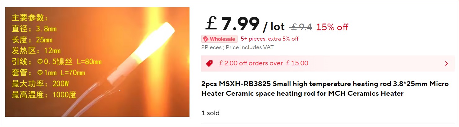

I was scrolling Amazon, searching for ceramic heaters when I stumbled upon a ceramic heatbreak, which is not something I've seen before.
I thought ceramics would be too heat conductive (I mean, they make heaters with it) and too fragile to work, but if it's not the case, it would make a lot of sense since ceramic bearings have even lower friction than stainless steel ones, so perhaps that low friction translates to polymers. I did more searching on AliExpress and found out that Fysetc and Trianglelab both make such heatbreaks, and I was surprised to find out how low the thermal conductivity is:
Trianglelab conveniently has a section view and were able to tell me that the tube is "tightly fitted". Comparing pixels, I estimate that the OD of the tube is 2.9mm.
The first tubes I found were low-cost but also had a matte surface finish. I then found some precision polished zirconia tubes in a variety of sizes, most notably 2x4x16mm and 2.05x3x25mm.
The only thing is that this costs £2 more than what Fysetc charges for their entire heatbreak. £7 for a 2.05x3x25mm tube implies £3.50 for a tube half its length.
I looked into it and, as I probably should've known, "ceramics" is about as precise as saying something is made of "metal" or "plastic". On AliExpress, there seem to be 2 types: Alumina and Zirconia. The former is 10x more heat conductive at 27 W/(m.K). NF goes one step beyond and uses "aerospace materials" for their NF Zone, which has a removeable black heatbreak so I don't even know what it could be:

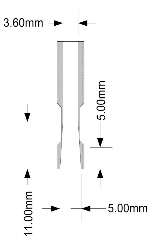

This is the drawing for the heatbreak. In this post, it's shown that a tapered reamer is used.

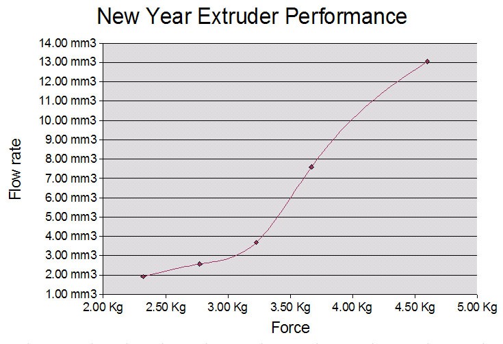

It seems that a tapered heatbreak is particularly well suited to reduce required forces when low flow rates are required, which would naturally be the case for a mixing hotend as any individual input may only contribute a fraction of the final mix.
The author hypothesised that the shallow side of the curve is "where the plug friction dominates".

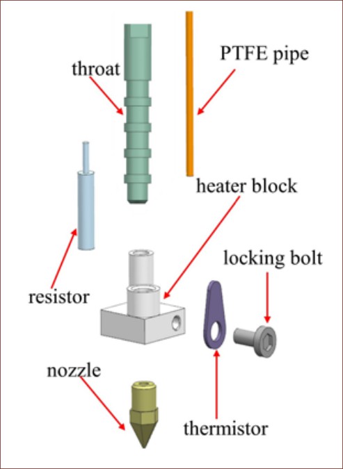

I remember Deckingman documenting having issues with heat creep, even with PTFE-lined hotends. This idea could be one more thing to increase reliability to an acceptable level.
Moving on, the main idea I've been thinking through is to have the press-fit heatbreak tube go through the entire hotend and stop a bit before the nozzle tip so that the purge volume is relatively tiny. However, this requires very good alignment of the nozzle and the tube, as well as a nozzle that has a larger ID hole. My hope was to use the Bambulab high-melt CHT clones and remove the copper insert and then have two tubes, one acting as alignment. Using pixel sizes, I estimated that the ID of these nozzles are 3.7mm.

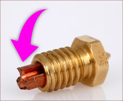

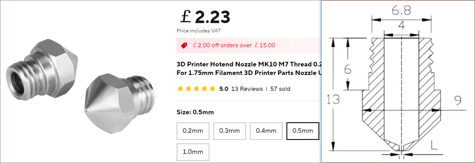

But not all hope is lost. I found a stainless steel MK10 nozzle that conveniently comes in 0.5mm which hopefully gives a bit more resolution than 0.6mm and a bit more flow than 0.4mm:
I'll probably have to use a hexagonal M7 nut.
The outer 4mm OD tube would seal from the inside of the nozzle. The drawback would be that additional length would be needed to hold this tube in place. One of my worries is if this strategy is wise considering that it will essentially double the nozzle length of the coating path.

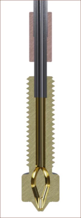

I found the cross-section of a nozzle collaboration between E3D and Creality, and estimate that the tube OD is 2.7mm and extends 4.5mm into the nozzle:
Seems that the tube is machined to have 3 discrete segments. One is in the copper section so that it can be positioned accurately on the length of the tube.

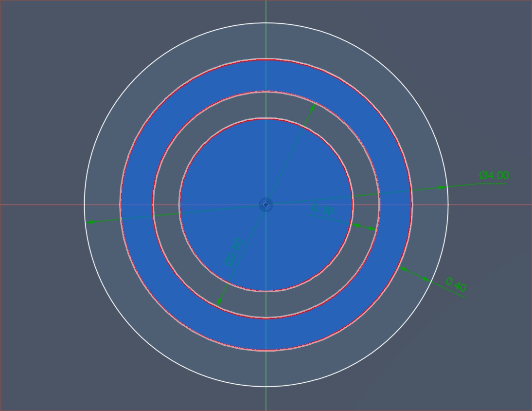

To keep the cross-sectional area approximately the same, I'd be looking for a tube that's 4mm OD 3.2mm ID.
Molten material is highlighted in blue.

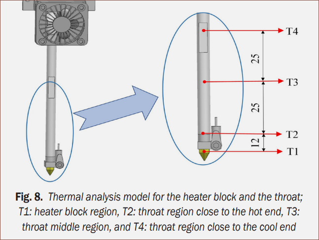

The cartridge is 25mm, of which 12mm actually gets hot.I also found the paper Design of a Throat-extended FDM Extruder for Multi-axis 3D Printing which looks into different parameters affecting a long heatbreak design: From what I understand, air flow speed has the greatest effect on the temperature gradient, followed by the amount of the bumps seen below. They only tested to a maximum of 5 and concluded that it was the best. The evidence is only partially conclusive since they never tested 6+ bumps.I can't see them on the manufactured version, but it seems that the slight bumps on the "throat" are needed for best performance.The heater may have to be permanently affixed in a case that clamps around the stainless tube, but where's the space for that? The alternative was to have one tube each between the heatblock --- heatvalve and heatvalve --- heatsink and have the heater be removable somehow. There's also the option that the case clips on almost like a Knexx and uses boron nitride paste to keep it in place. Another idea is to have a removeable heatsink (such as the Flashforge solution I mentioned in a previous log) so that the heater could be skewered onto the stainless tube and affixed with a setscrew.

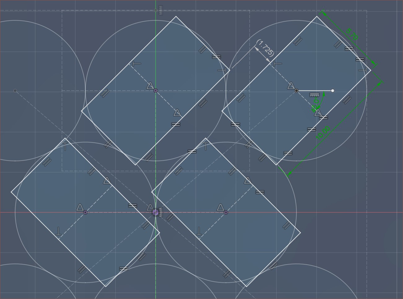

The above design is 5.0 cm3, which is more than half of R2. This design doesn't use a clamp plate, which contributed another 3.5 cm3 of hot-metal volume to R2. However, since I'm still unsure about being able to use boron nitride paste to hold the cartridges, this value is likely to increase.

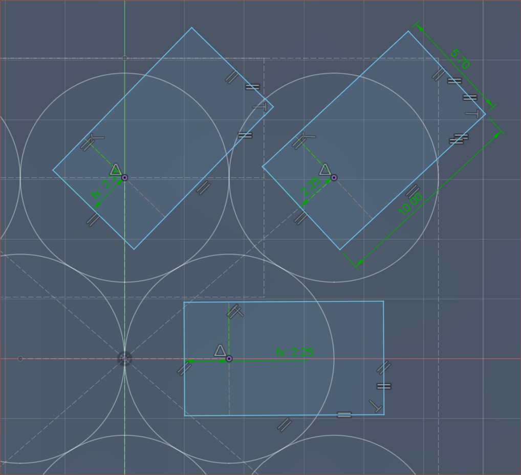

The spacing between inputs is 10.5mm. I tried 10mm (like in previous revisions) but the front-corner inputs come too close to the coaxialiser.
I tried to squeeze the heatbreaks to as little volume as possible because they really do add up when there are 8 of them. They also have to be short to ensure that the drill (and reamer) can reach. Each one is 0.23 cm3. There's only a little less than 6mm of space between rows, so I considered both heatpipes and heatsinks. I modelled 2 different 5mm-high heatsinks I found on AliExpress:

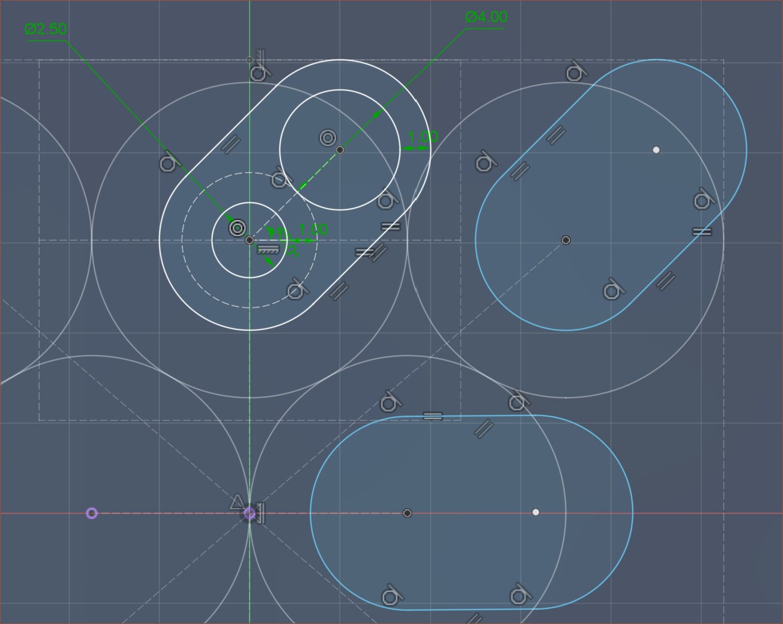

This design is 3.4 cm3.I modelled the idea I had during the conclusion stage of the previous log. It's a proof of concept, so the actual 3D file is somewhat fragile at the moment. There's little benefit for perfecting things now when the idea might not even get green-lit by fabs or geometric conflicts arise when designing the heatvalves and heatsinks.
I looked into the old-school all-metal heatbreaks and they use 3.2mm at the tube section. I believe I've also seen more recent hotend designs (like the SV08 in the previous log) use 3mm tube.
Currently, I've modelled 1.8mm ID 2.8mm OD tubes to try and balance powder removal, ease of drilling and lack of heat conduction.
The issue I see at the moment is the sealing of the heatblock to the heatvalve. Perhaps they would have to be integrated too?
