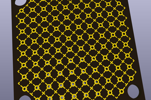

    Vias in pads vs. via-in-pad
    Vias occupy space if they're placed outside of pads. And quite often we're tempted to place them inside pads, which is absolutely fine when the PCB is made with proper via-in-pad tech. When we now head over to, say, electronics stack exchange, we'll quickly realize that placing an "open" via in a pad will quickly result in great-great-grandma raising from her grave to grab us by the ear and pull us to the table because it's time for dinner before we can even release the mouse button. And for a production board that would probably be correct. But we're building a prototype and proper via-in-pad is expensive.
    So - again - what can we get away with? Turns out, A LOT. Here's a bunch of 0201 caps on 0402 footprints with open vias in pads:
    Honestly that still needed a little touchup and cleaning, but it works!
    So if it's really an advantage for your layout: just do it. A via in an 1206 pad is certainly not a problem at all, and even down to 0603 it's not really a problem. Below that, you'll want to fill the via with solder first. Then it's business as usual. Vias in pads are ok.
