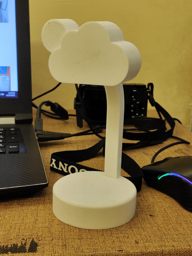

2Designing & 3DPrinting
- I have designed the model in Fusion360.
- Download the STL Files and 3D print them.
- By clicking on the 3D Model Link you can view the model in your PC/Mobile browser and the Model can be edited in Fusion360 software.

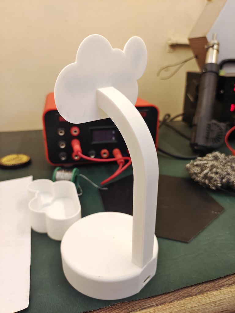

4Assembly
- Assemble all the parts together using quick glue.

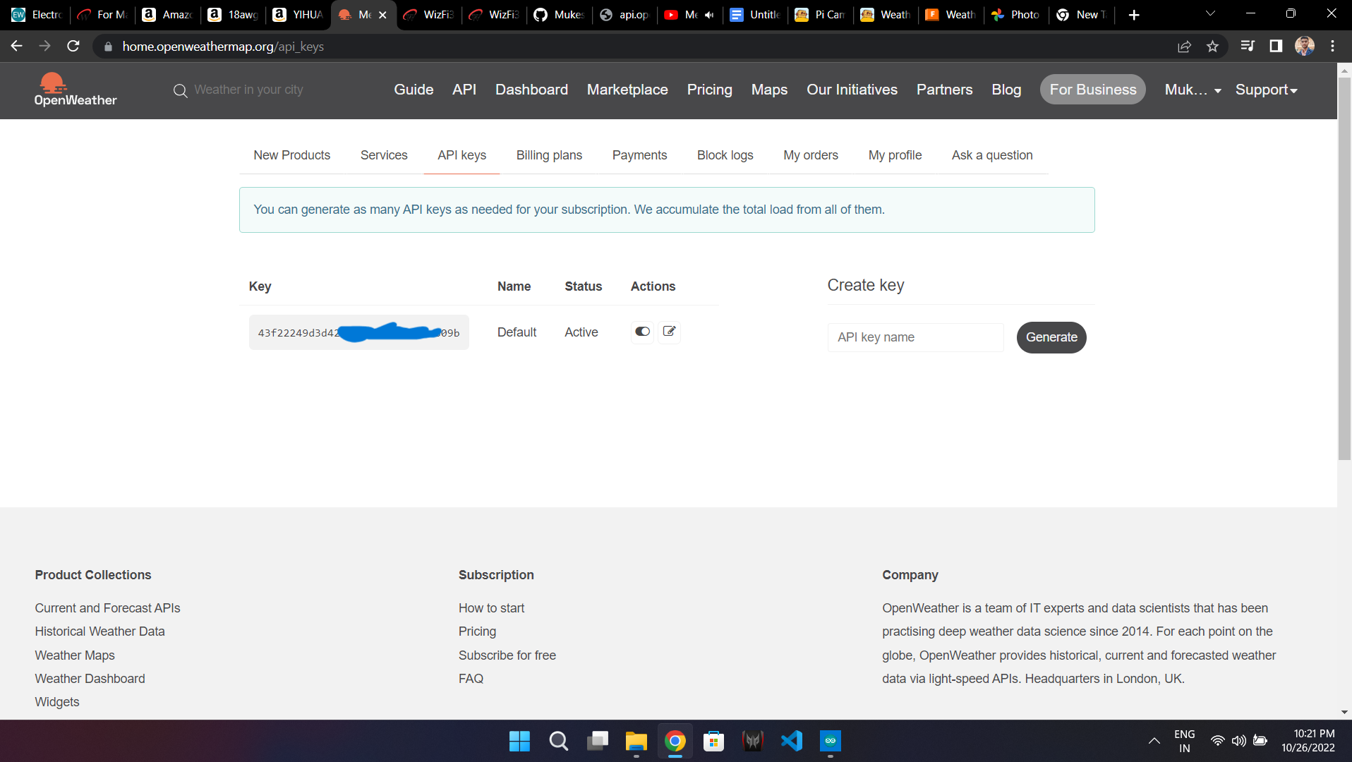

5Getting Openweathermap API Key
- Go to openweathermap.org and create your account and verify it.
- Now login to your account and click on you profile or right-top corner and go to My API Keys.
- Copy the API Key that you see this will be used later in Step 7.

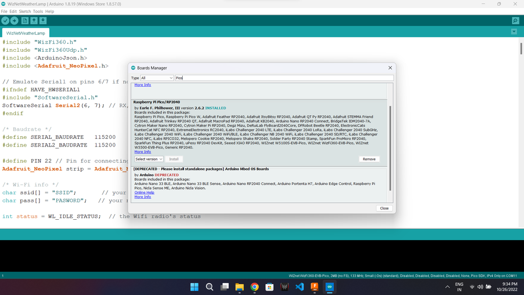

6Arduino Libraries Setup
- First go to Files->Preferences and copy paste the following URL in Additional Boards Manager URLs:
https://github.com/earlephilhower/arduino-pico/releases/download/global/package_rp2040_index.json
- Go to Tools->Boards->Boards Manager and search for Raspberry Pi Pico/RP2040 and dinstall it.

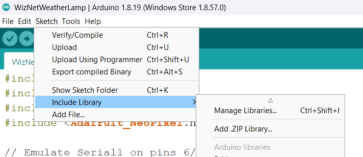

- Download the WizFi360_arduino_library-main.zip , Go to Sketch->Include Library->Add .Zip Library and select the downloaded Zip file.
- Now got to Sketch->Include Library->Manage Libraries and Search for ArduinoJson, Adafruit_NeoPixel and install them.
