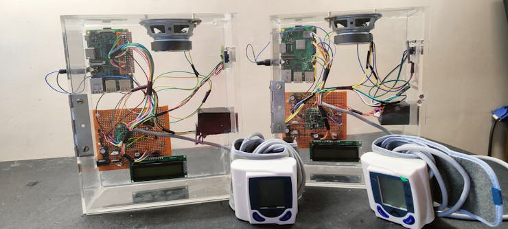

In this Upgrade Project, I Have added The following New parameters
1. SpO2
2. IR Temperature Sensor
3. LCD Display
4. Voice Broadcasting
5. Data Saving For Future ML Training
In the previous project, I added the basic details of different Classifications of blood pressure for adults (18 years and older). I will utilize the same chart to create the current Project.
Block Diagram Of the Project
I will Explain How To Interface The Sensor With the Raspberry and How to Process to Display the Output. By following this blog You can find what are the libraries and Software settings need to configure for the project.
By using This project you can measure Blood Pressure, Non-Contact IR Temperature Measurement, and SpO2. All these results are displayed on LCD and the Results are Broadcast through Voice. Based on the Accent you required you can change your Voice Broadcast Accent.

Once all the Mentioned Configurations are made we can Run the BP Sensor Interfacing Code.
The Output Of the BP Sensor Is saved in the Text Format In Below Figure. You can see the Results Image.

Once all the Mentioned Configurations are made we can Run the IR Temperature Sensor Interfacing With Raspberry Pi Code.
The Output Of the Temperature Sensor Is saved in the Text Format In Below Figure. You can see the Results Image.
SpO2 Sensor Interfacing With Raspberry Pi
To interface the SpO2 With the raspberry pi we use I2C Communication, Since We already Installed All the Required Configuration For I2C, LCD There is no need to enable Them Again. You Just Need To add the Library Called max30102, This Library is modified for the Raspberry Pi based on My requirements. you just need To add those files to the Folder.
The main code is in SpO2 Sensor Interfacing With Raspberry Pi file You need to run this to view the result on the LCD. Before running the code You need to save the hrcalc.py and hrdump.py and max30102.py codes to the folder location as same as the SpO2 Sensor Interfacing With Raspberry Pi code location folder.
In this project, all the above codes run individually you can modify the code to run through a single code.
