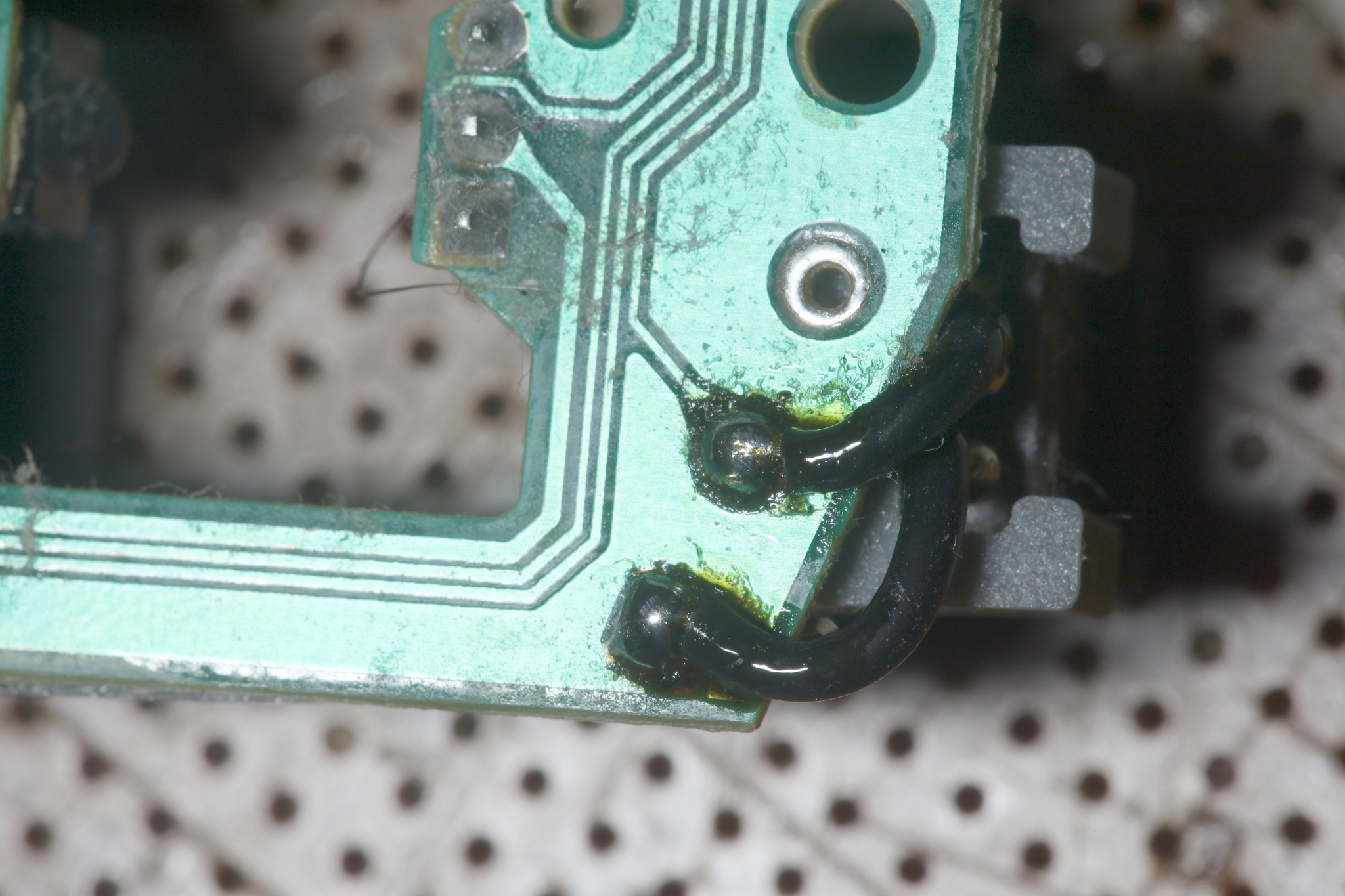

Brought the grand total to $30 with yet another new M100. Big surprise, the new one was nowhere close to the old one with all its modifications & wear. The new buttons & wheel weren't as loud & didn't travel as far. The replacement tact buttons in the old one were a big improvement. Lions just seem to have adapted to longer travel, more resistance, louder clicks. They might also be making new mice quieter for video conferencing.

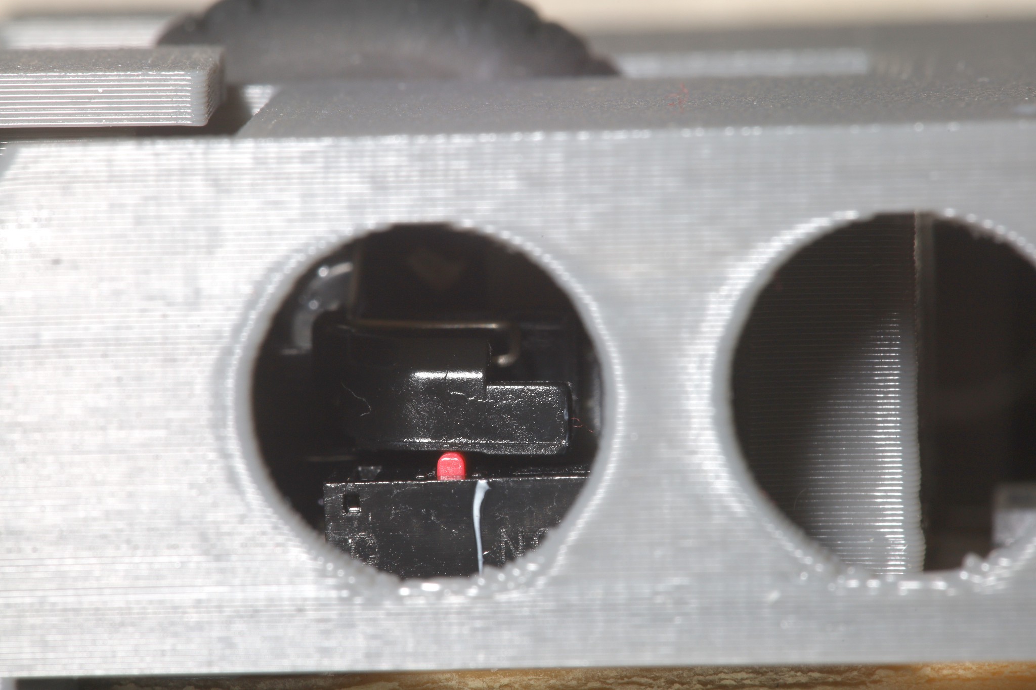

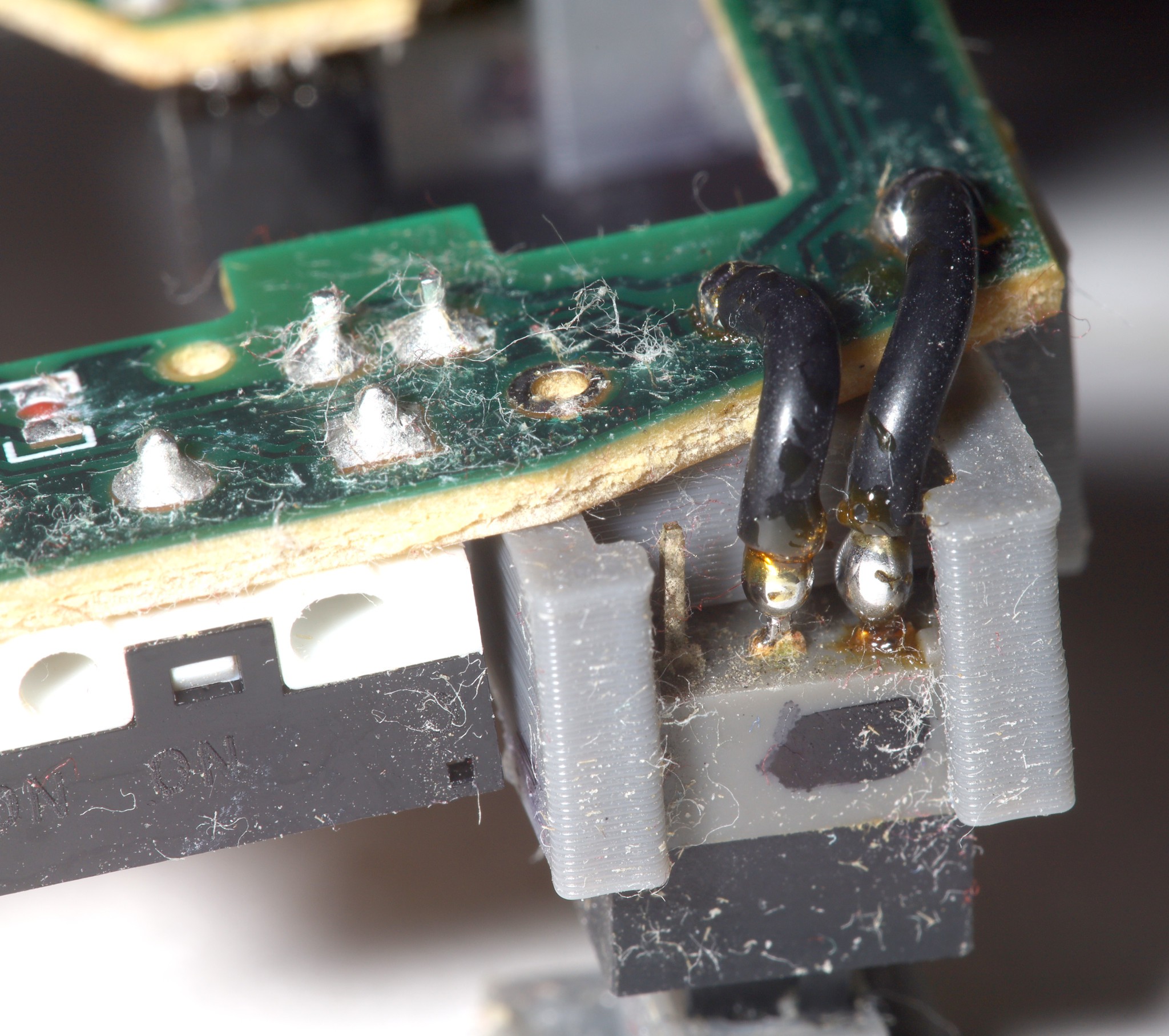

MHPS buttons aren't a sure thing anymore. They might require too much travel for double clicking since they have to fully extend. The winner might be mechanical keyboard keys or more assertive tact buttons. Low profile tact buttons just don't last long enough. The standard mouse button is based on a limit switch, designed for high wear but doesn't travel very far. All the resistance comes from the tiny limit switch button.
The limit switches would travel more if they still had their levers. The standard wheel has a lot of resistance from being a mechanically disadvantaged lever. Ended up stuffing the old electronicals in the new enclosure with the new wheel.

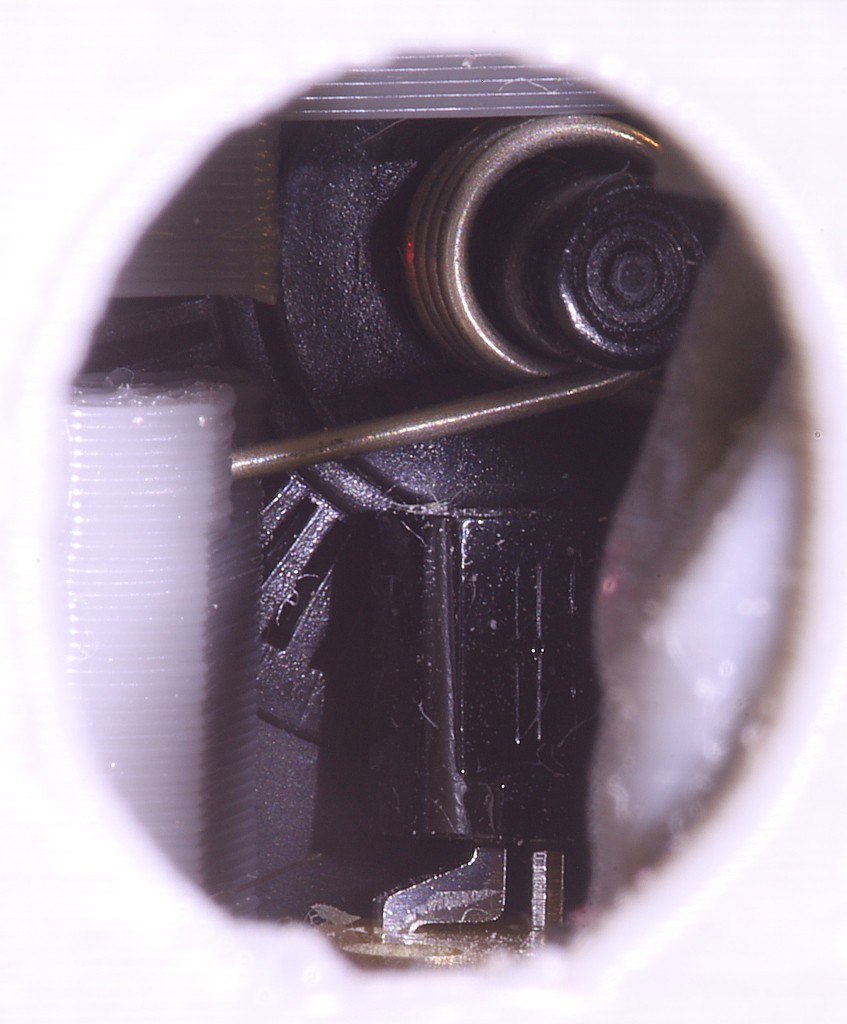

Stiffened the new springs to give the wheel clickiness & resistance. Added silicone grease to keep it from shedding plastic. It became clear that the wheel uses a different limit switch with more travel than the buttons.
In the search for assertive button clicks, the basic amazon isn't it. It's smaller than the bottom line M100 & the buttons hardly move despite being discrete plastic. The wheel doesn't have any resistance at all. The button clicks are still better than a worn out M100 though. There's no reason to believe any more expensive mouse would do any better, since they all have the button design of the M100.
In a custom mouse, it might be good enough to replace the case & the side buttons while keeping a stock wheel assembly. How to port the wheel assembly is the tricky part. Sadly, the wheel dies intermittently.

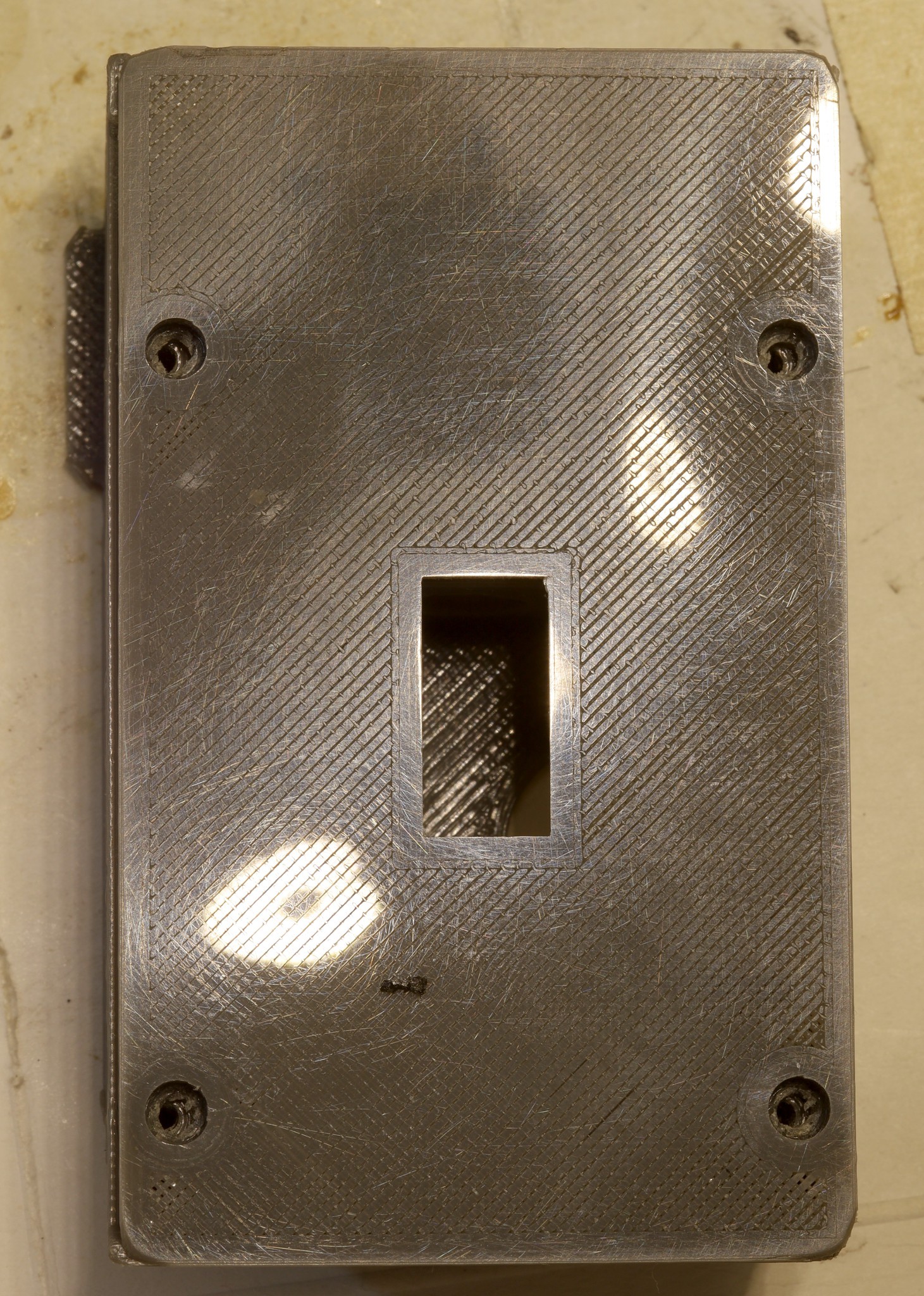

How to cheaply print test cases is another problem.

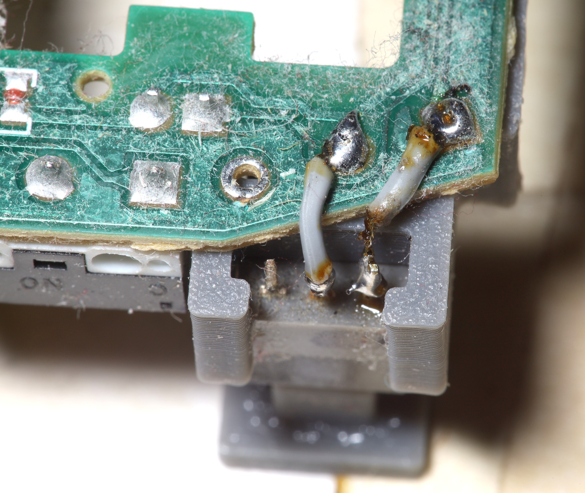

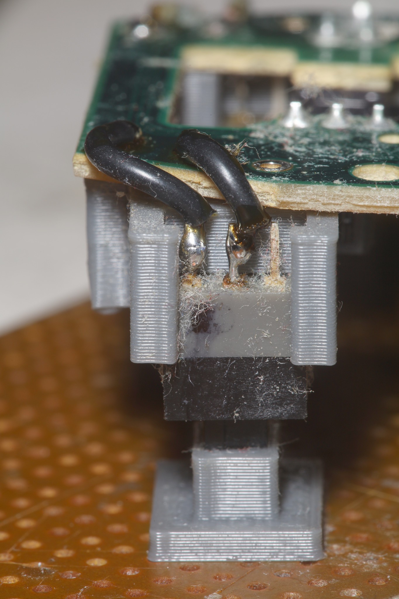

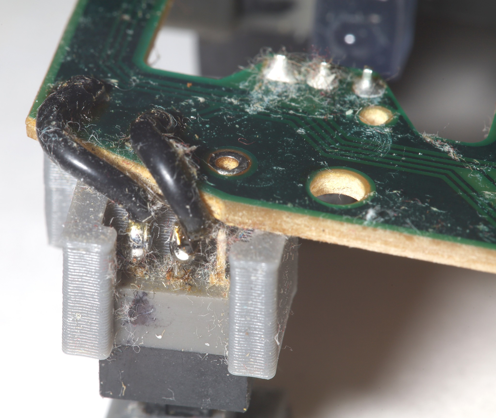

Another broken USB cable & another repositioning. It's just a hair aside from the very bottom. Also found plastic filings from tightening the wheel. There's a limit to how clicky the wheel can be. It might benefit from silicone grease. Settled on ordering a bunch of amazon basics mice & letting them wear out. 6 months might be the most any animal can expect.

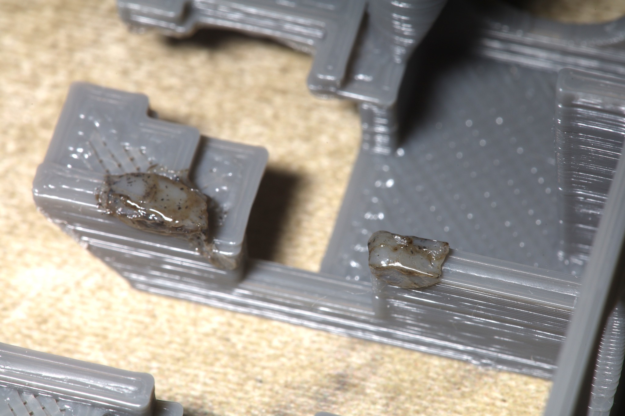

Another problem is PTFE pads required for sliding. Raw PTFE is more expensive than a mouse.

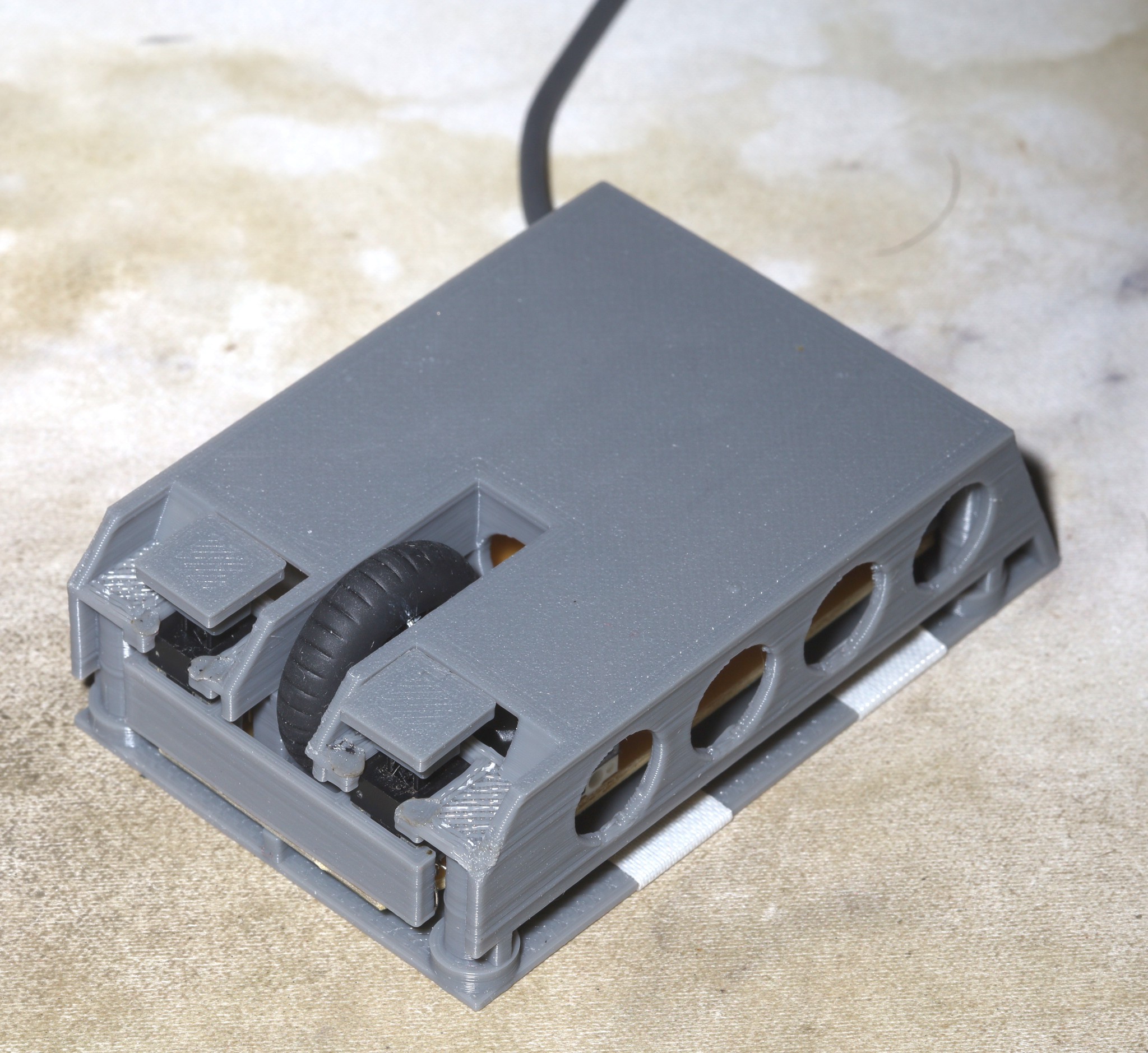

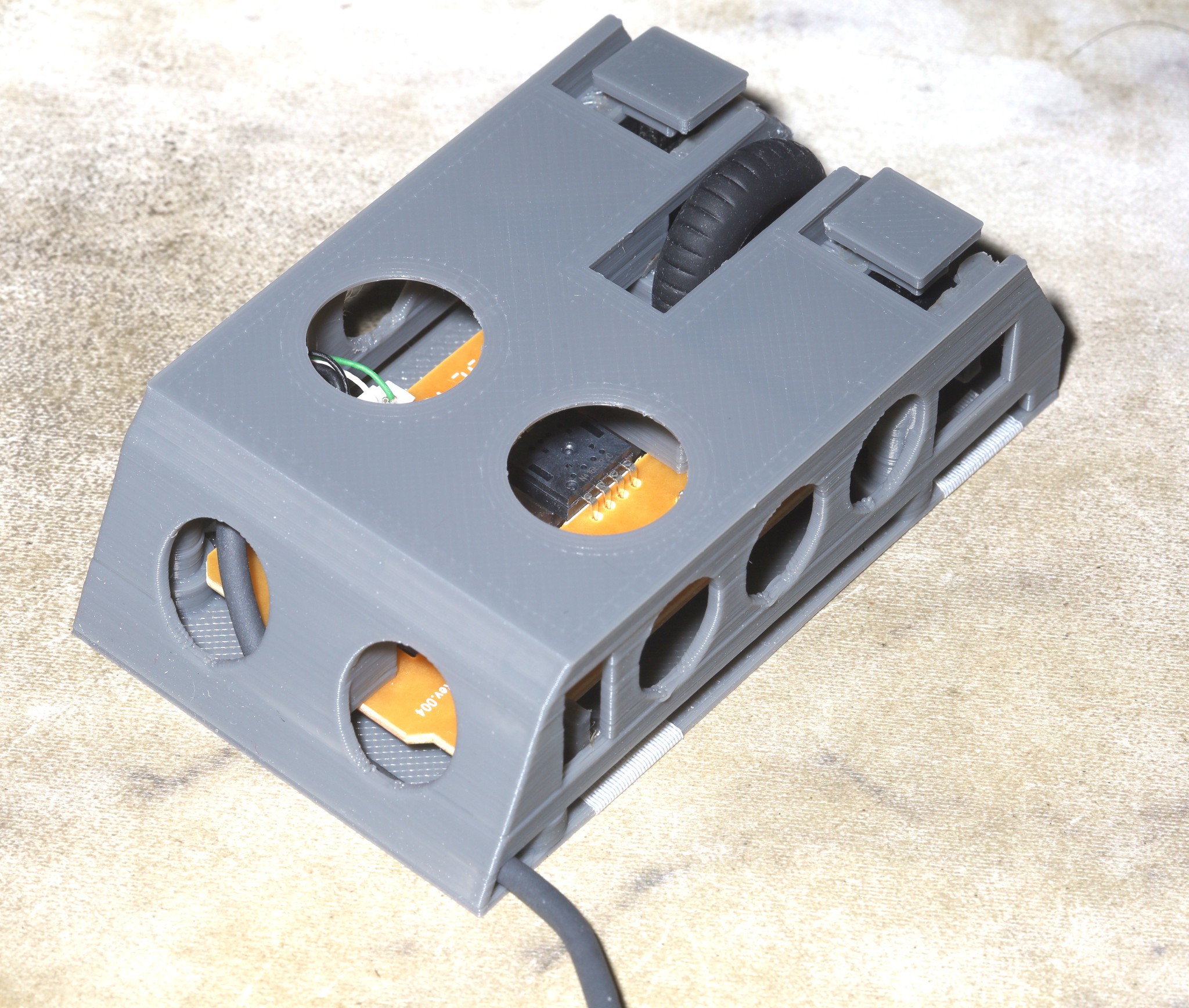

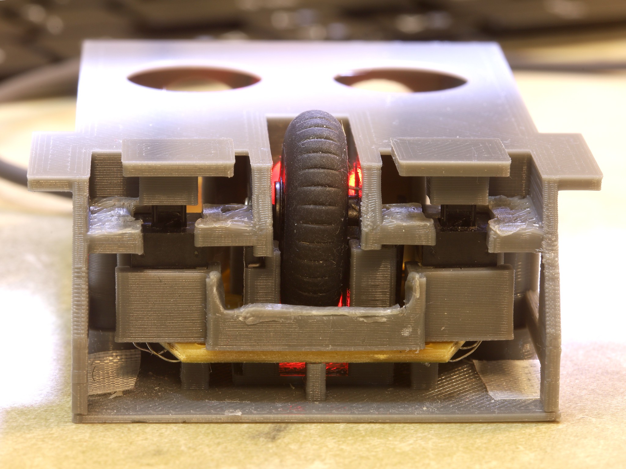

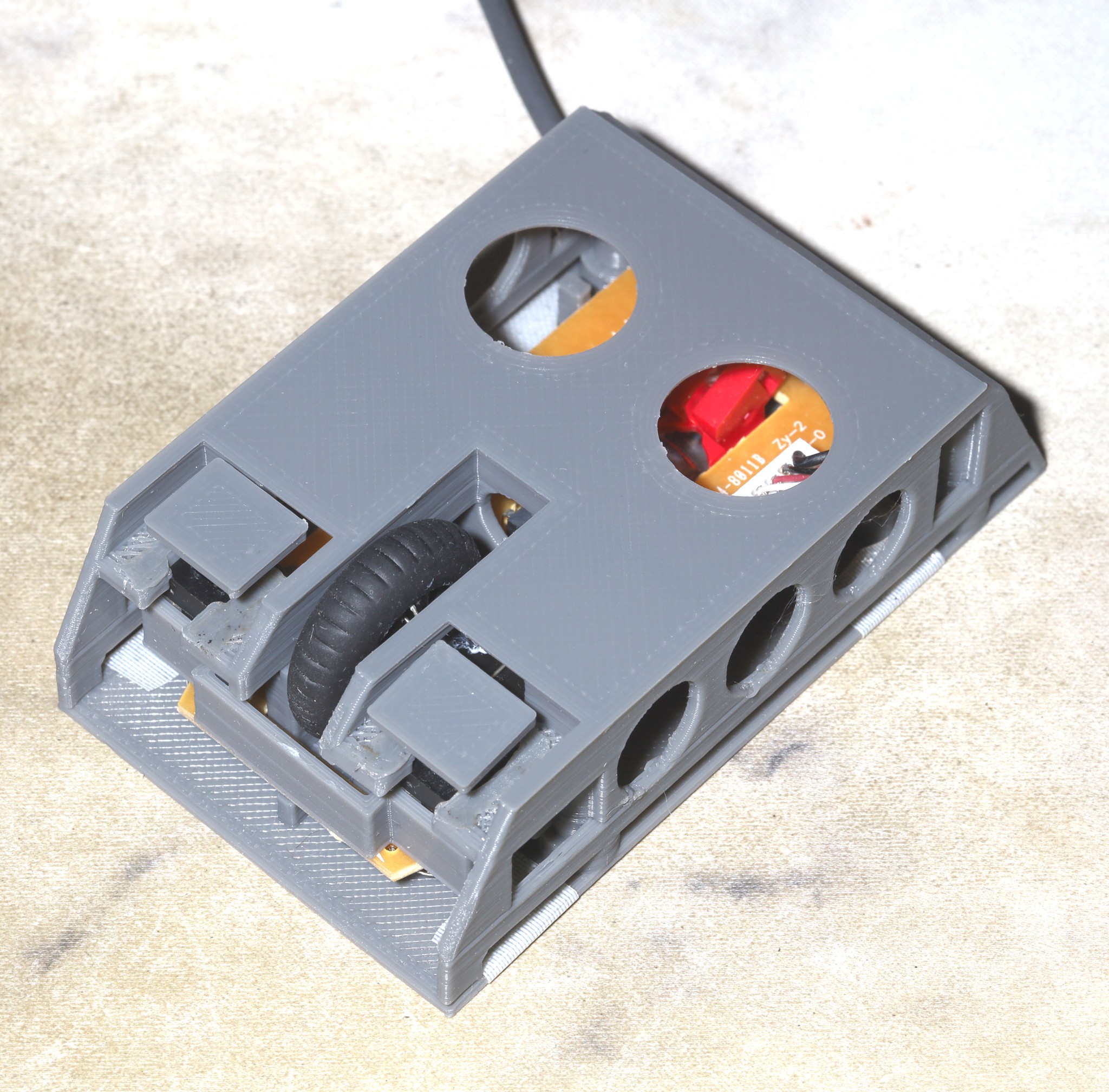

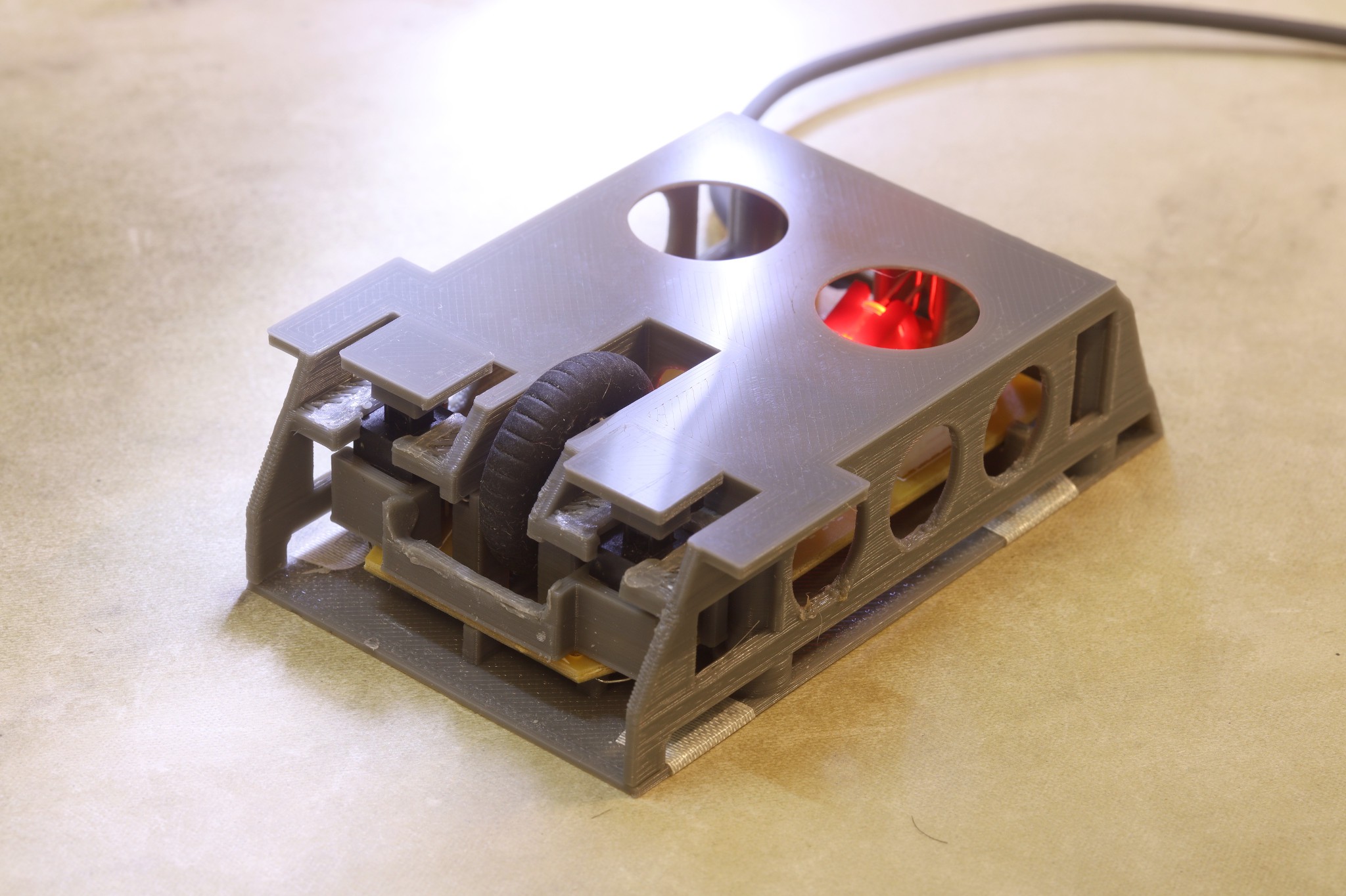

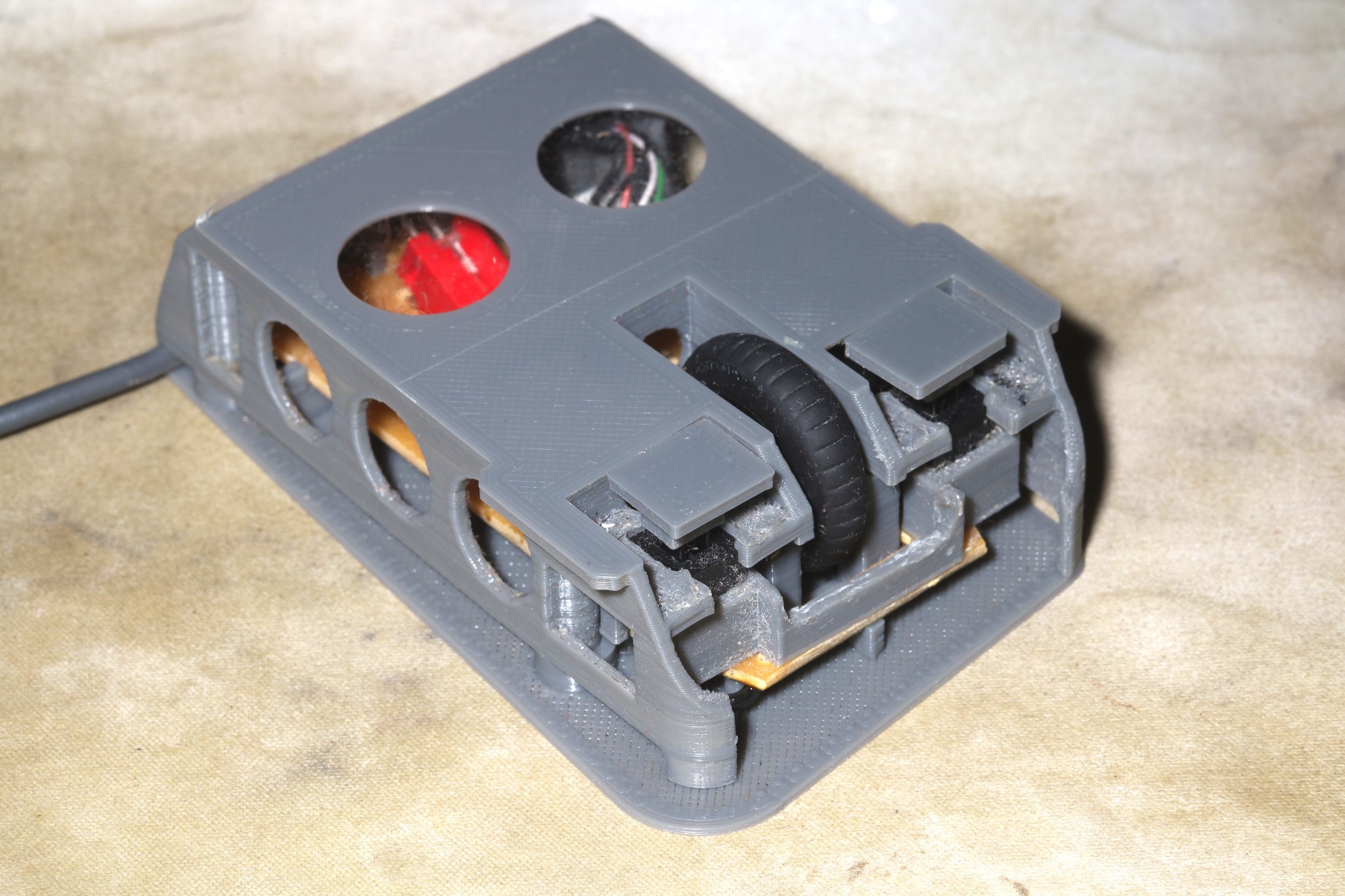

The general plan is a microsoft mouse clone with 3 physical buttons & a wheel. The wheel goes above a small button & has no button of its own. To be sure, this must have been tried 30 years ago.

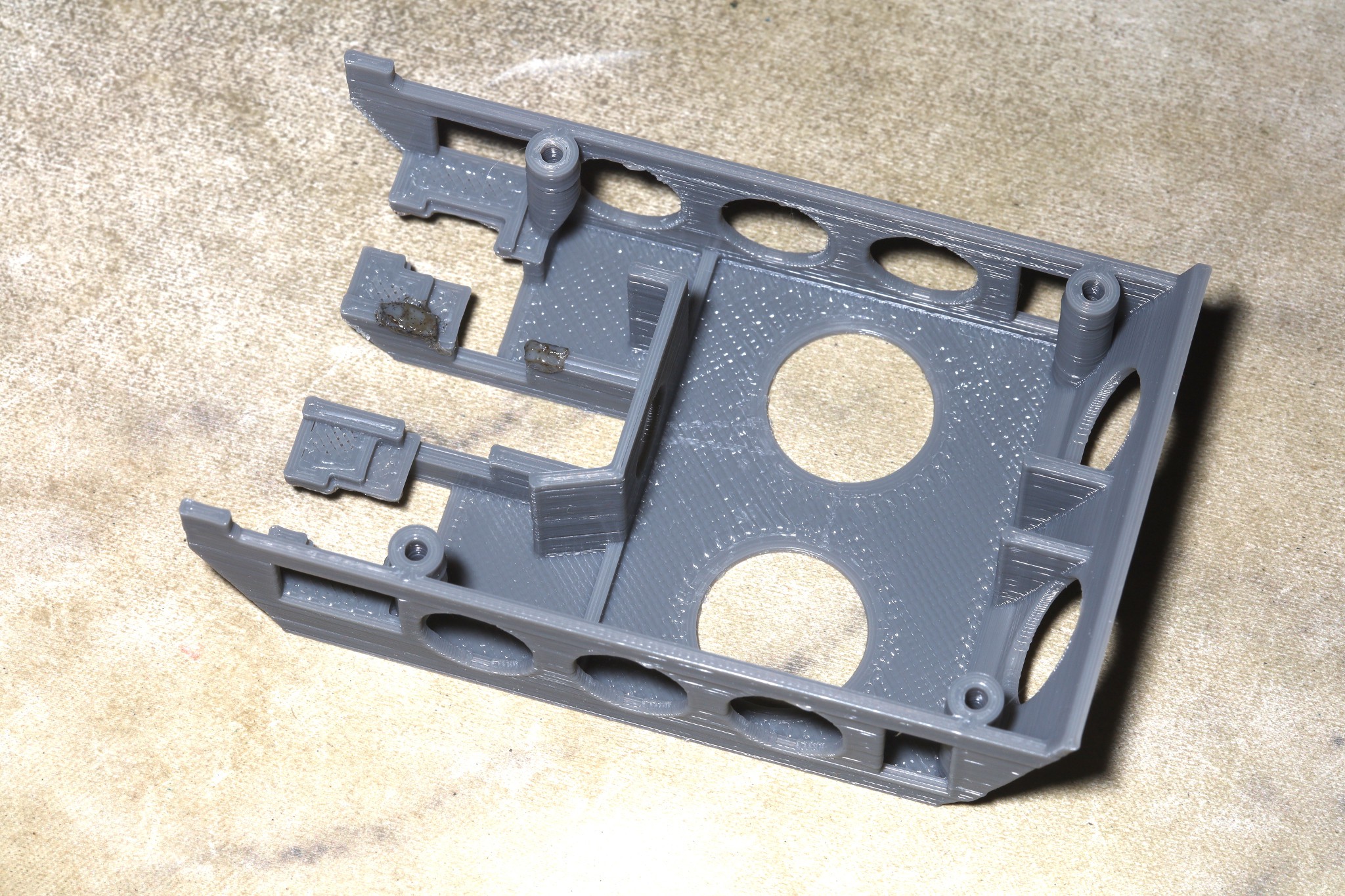

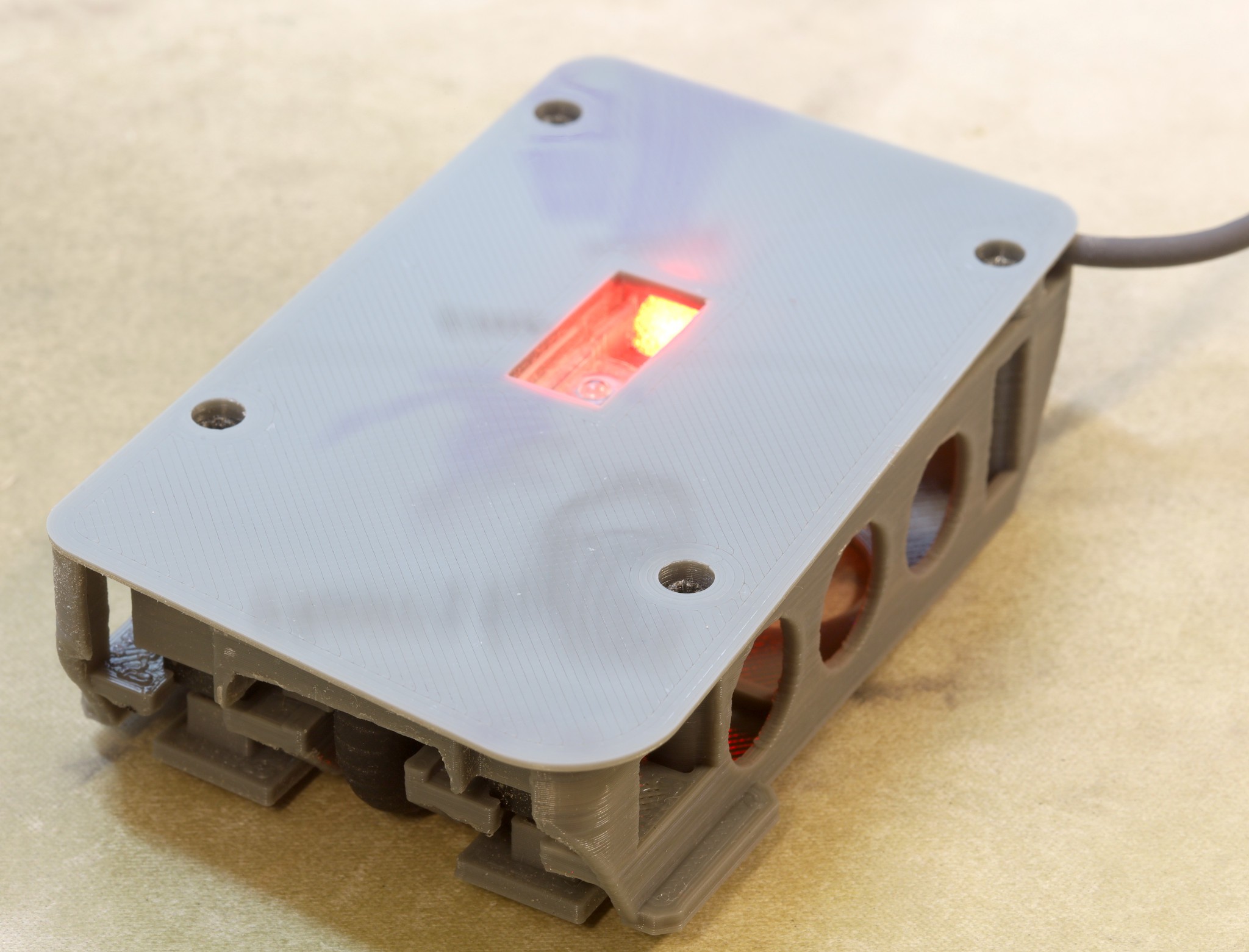

Sizing would be done with playdough models. Prototypes would be 2 part enclosures with no support. The top would glue on the sides & all the panels would be curved. A final enclosure would be a single piece with support. All the electronicals would come from other mice.

The lion kingdom has gotten by with the cheapest mice for the last 20 years. They last about 6 months & then become difficult. Tests have shown the mane difficulties being cable management for the corded ones, battery management for the cordless ones, the tact buttons wearing out, the case getting crunchy, the teflon sliders wearing down, the optical sensor getting dusty.

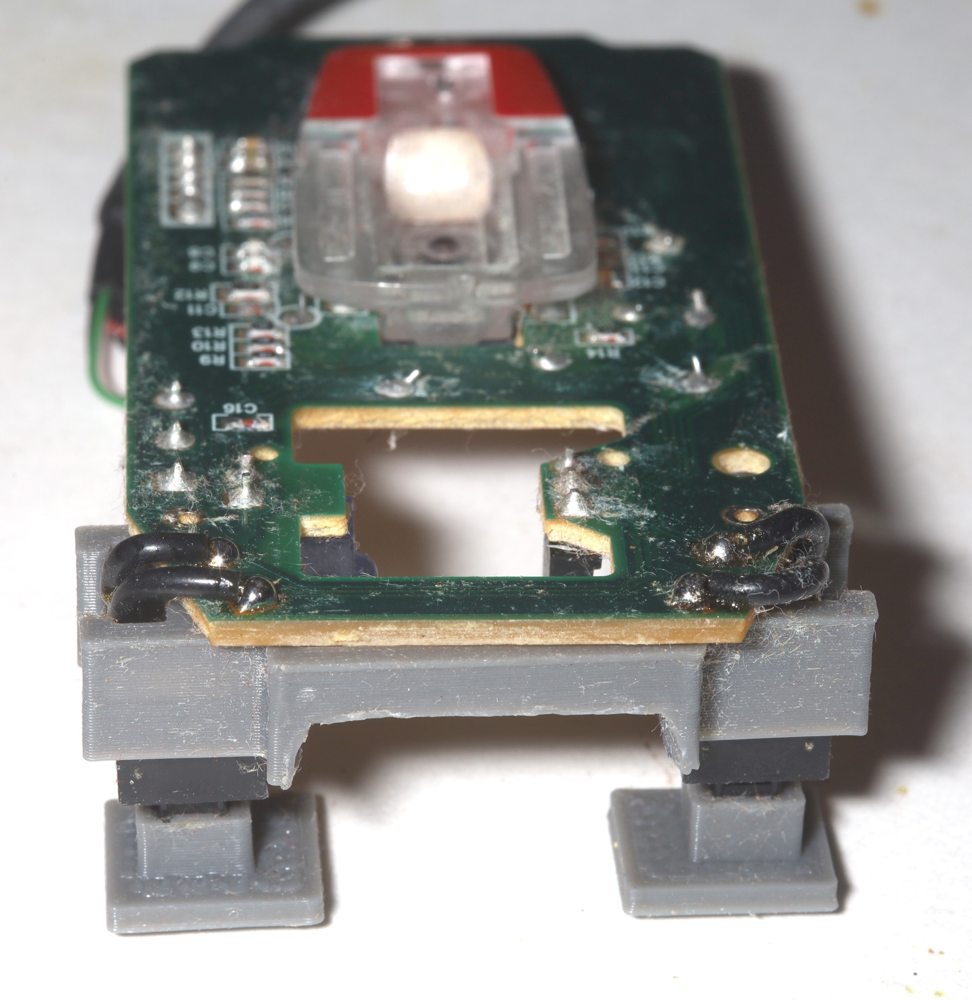

A mouse prototype would reuse the teflon sliders, the scroll wheel, & the electronicals from a commercial mouse. The switches & case would be replaced. Lions aren't convinced mechanical buttons would be an improvement because the large deflection might be too slow.
The biggest problem is improving the scroll wheel. Maybe the answer is a middle mouse button & scroll wheel side by side. Maybe it should be a bigger wheel. Generally, the more clicky & rigid the wheel is, the better it does at resisting crosstalk & the more assertive the scrolling is. Lions have improved this by manually bending the springs.
