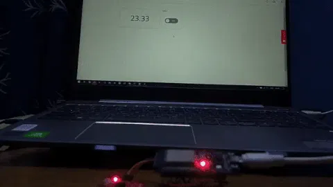

7Device Control - Dashboard
Let us now see how to control our device from the Arduino Cloud Things. For this, there aren't many changes, only a few additions -
1. Go to the Things we created earlier -
2. Add the variable 'light' to store the data on the cloud, with a boolean type.
3. We will be using the device for controlling an actuator, select the variable type as 'boolean'. For digital control over the pin. See below -
Great! Now let us make a user interface for this control (dashboard)!
1. Go to Arduino Dashboards. (Or even select the Dashboard tab on top)
2. Select the created dashboard and use EDIT mode to make changes.
3. Select the 'switch' widget -
4. Link the variable 'light' to the widget -
Congratulations! Your Dashboard view is ready! ✨🎉
Code Changes on Hardware - Arduino IDE
Let us add the variables and functions -
bool light; int LED = 2; void onLightChange();
Now inside void initProperties() function, add this -
ArduinoCloud.addProperty(light, READWRITE, ON_CHANGE, onLightChange);
Inside void setup(), declare the pintype -
pinMode(LED, OUTPUT);
Now, add the below function definition to the code -
void onLightChange() { if(light){ digitalWrite(LED, HIGH); } else{ digitalWrite(LED, LOW); } }
The compiled code should look like this -
#include <ArduinoIoTCloud.h> #include <Arduino_ConnectionHandler.h> float temp; bool light; int LED = 2; void onLightChange(); const char THING_ID[] = " "; // Thing ID of Arduino Cloud const char DEVICE_LOGIN_NAME[] = " "; // Device ID of Thing const char DEVICE_KEY[] = " "; // Secret device password const char SSID[] = " "; // Network SSID (name) const char PASS[] = " "; // Network password (use for WPA, or use as key for WEP) void initProperties(){ ArduinoCloud.setBoardId(DEVICE_LOGIN_NAME); ArduinoCloud.setSecretDeviceKey(DEVICE_KEY); ArduinoCloud.setThingId(THING_ID); ArduinoCloud.addProperty(temp, READ, 1 * SECONDS, NULL); ArduinoCloud.addProperty(light, READWRITE, ON_CHANGE, onLightChange); } WiFiConnectionHandler ArduinoIoTPreferredConnection(SSID, PASS); void setup() { pinMode(LED, OUTPUT); Serial.begin(9600); delay(1500); initProperties(); // Connect to Arduino IoT Cloud ArduinoCloud.begin(ArduinoIoTPreferredConnection); setDebugMessageLevel(2); ArduinoCloud.printDebugInfo(); } void loop() { ArduinoCloud.update(); temp = random(20,30); delay(500); } void onLightChange() { if(light){ digitalWrite(LED, HIGH); } else{ digitalWrite(LED, LOW); } }
Watch the IoT control on the board 🚀
