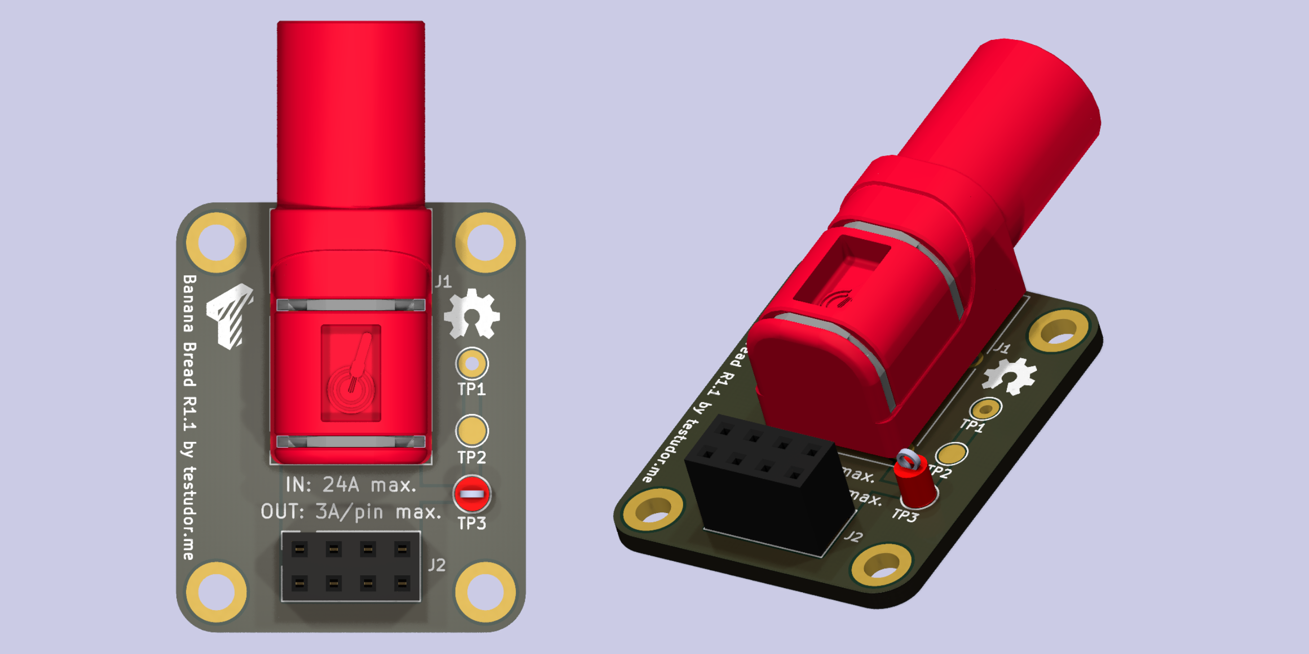

Banana Bread
Continuous 24A, this time for real
I finally got a PSU powerful enough to test the advertised 24A current capability of the old board, and it didn't work out too well. While the board didn't catch fire, it got too hot to touch. I did use a PCB trace width calculator, but it seems I made a mistake.
The new board uses wider traces as well as 2 oz instead of 1 oz copper and should easily handle the 24 amps.
Using the free PCB real estate
Since it makes almost no difference in cost, I added some additional stuff, which could come in handy:
A 2mm test pad
A 1mm via, which prevents standard multimeter probes from slipping
A loop-style through-hole test point
