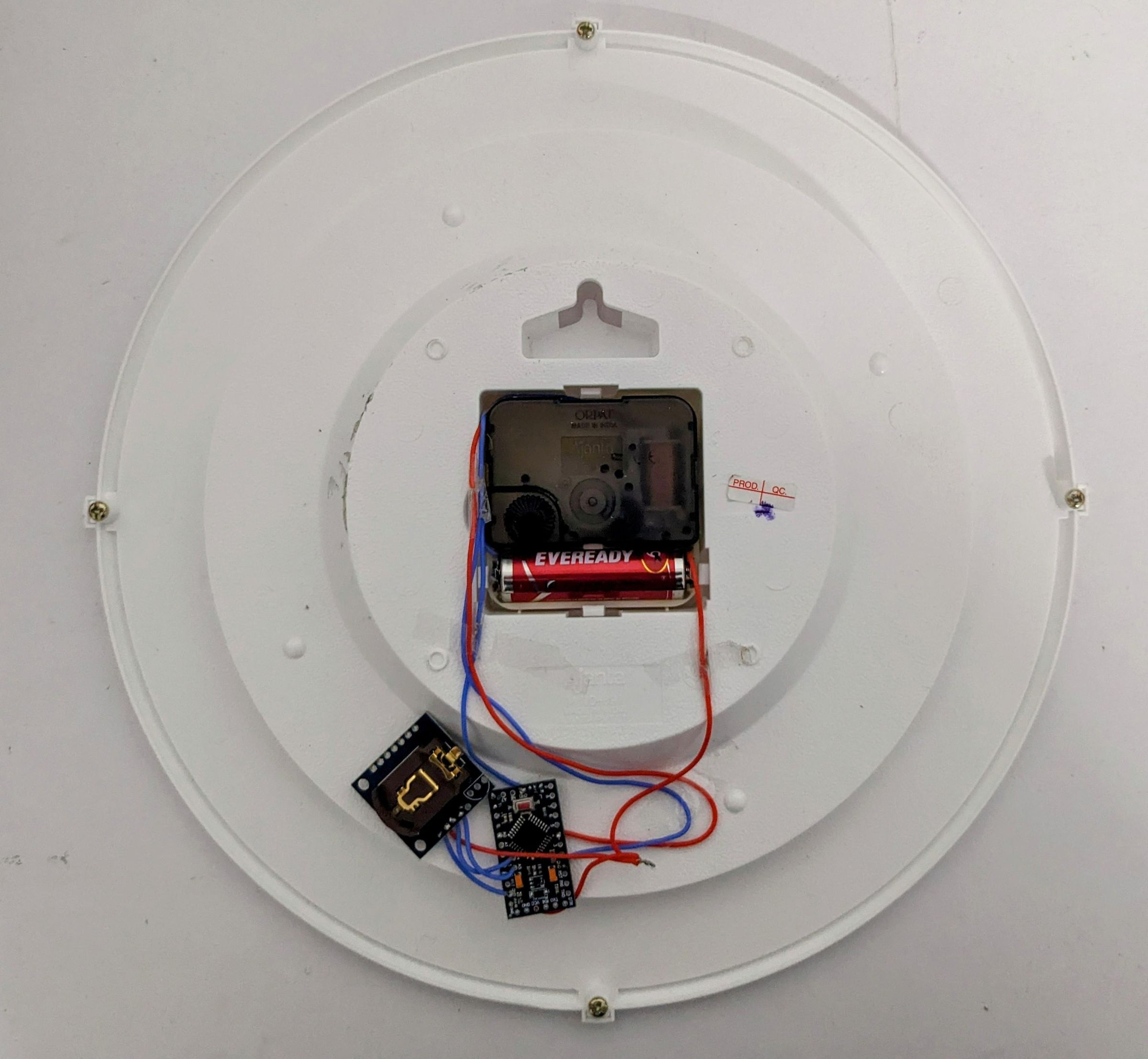

The idea for this project is to repurpose an analog wall clock to display the date instead of the time.
The idea for this project is to repurpose an analog wall clock to display the date instead of the time. The hour hand will display the month (1 to 12) and the minute hand will correspond to the day.
This hack involves slowing down the clock mechanism so that the minute hand only moves once a day and it takes the hour hand a whole month to move by an hour.
Thus the clock only ticks for a few minutes each day, this reduces the current draw significantly to around 6uA, leading to a theoretical battery life of around 50 years.
The Calendar Clock visually indicates how much of the year has passed by and can potentially incentivize people to plan their days and use time more effectively.

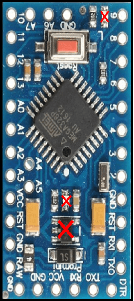

    Saving PowerSince we are running the Arduino pro mini off a single 1.5V AA battery, we need to reduce power consumption by removing components such as the voltage regulator and SMD LEDs. These can be desoldered using a soldering iron or a screwdriver can be used to break these from the board.

    Wiring Things UpWire the Arduino Pro Mini & DS1307 RTC with the clock mechanism as per the above diagram. Note that if you still want to use the battery holder on the clock mechanism you would have to open up the mechanism and disconnect the wires from the battery holder to the PCB.
