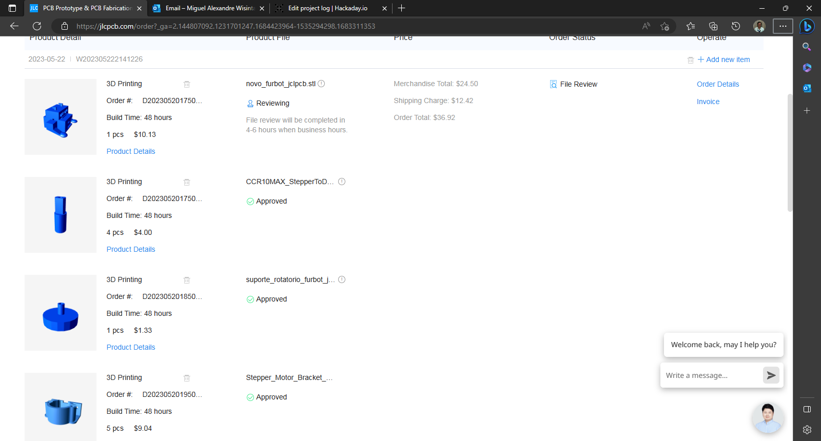

-build a 3D support to motor on chassis and axis converter to connect the step motors to the wheel
-build a prototype of a square using the insulating tape on the table to make tests with step motor wheels, to test speed and torque. We used 5V step motor model 28byj.
