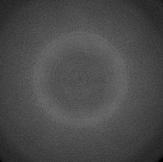

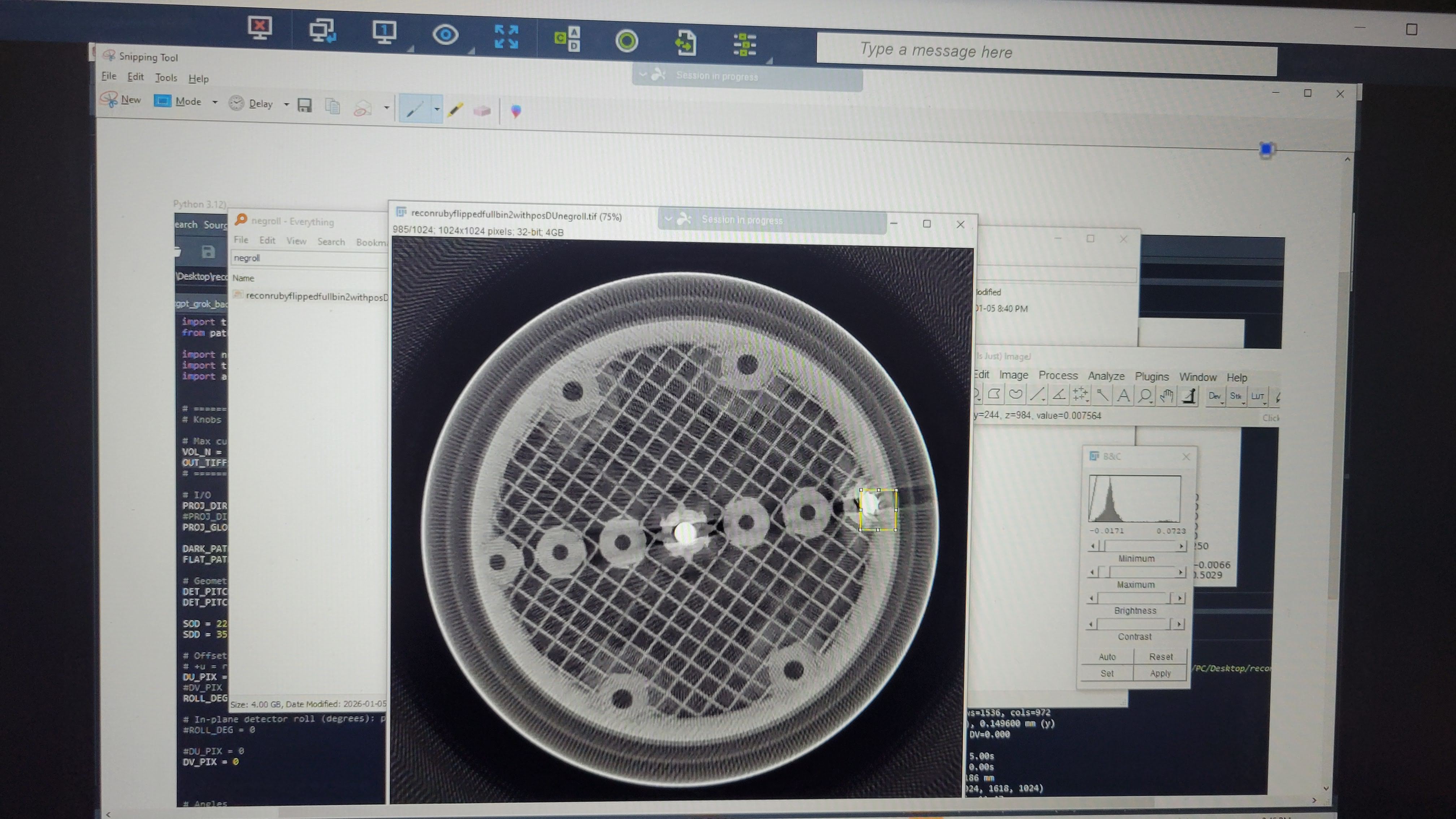

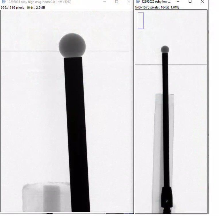

    It was about a week after the last post, having stared at balls for a really long time, that I got reconstruction working - for anyone else building a CT scanner in the garage, the key turned out to be flipping images sideways, or equivalently rotating in the opposite direction - I owe a particular someone beer for that. But then reconstruction worked:

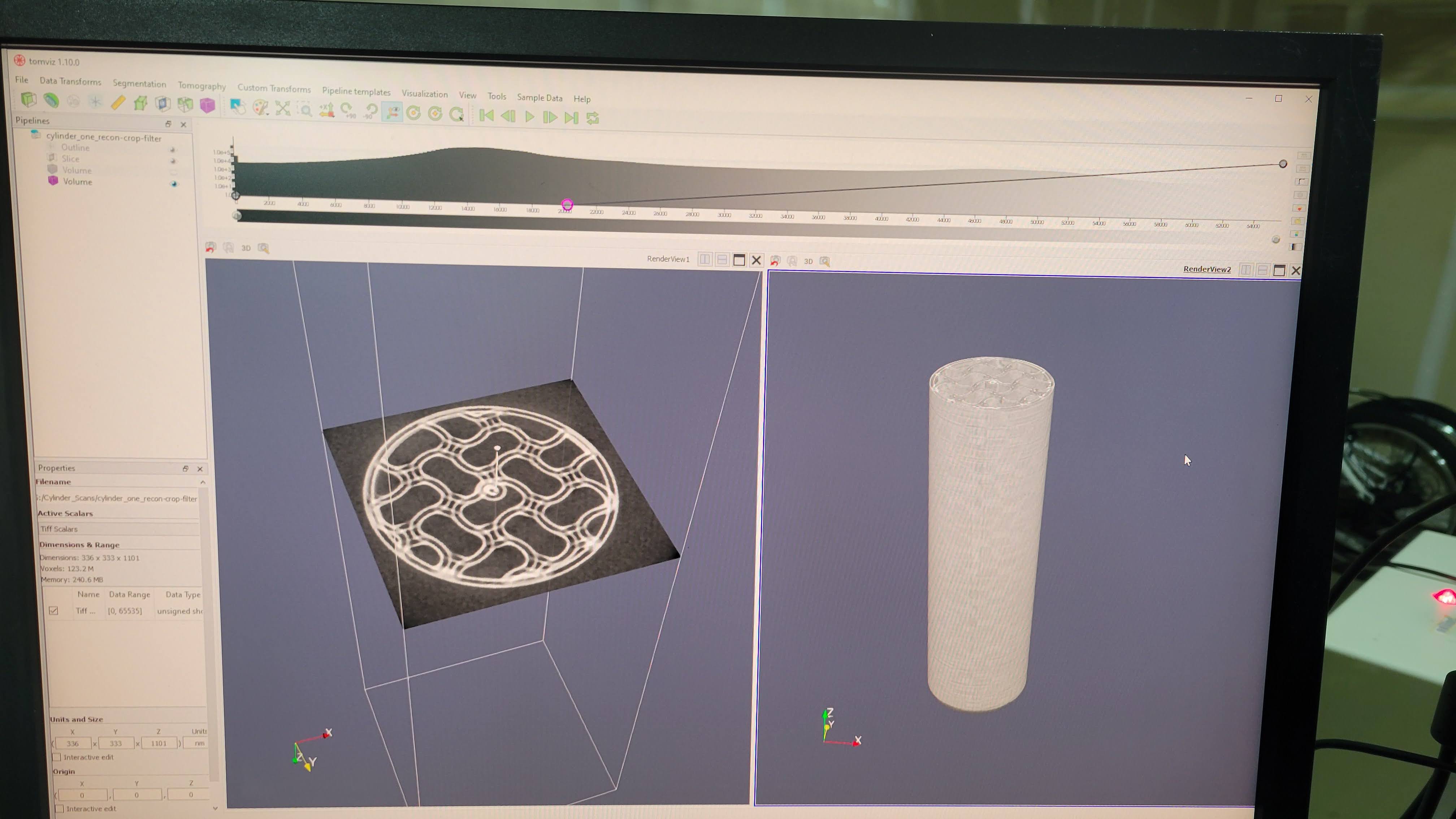

    My monitor, with the first reconstruction on it. This is a cross section of my ruby-ball holder

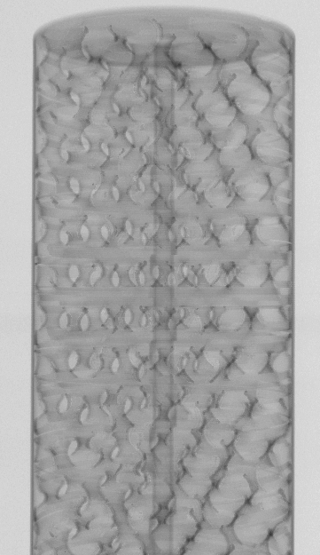

    I started (and then never finished) a series about 3D printing infills - I printed 5 different cylinders with different infills and was going to show what they looked like inside.
    TomViz - my new favorite Non-Volume-Graphics visualizer (also free)

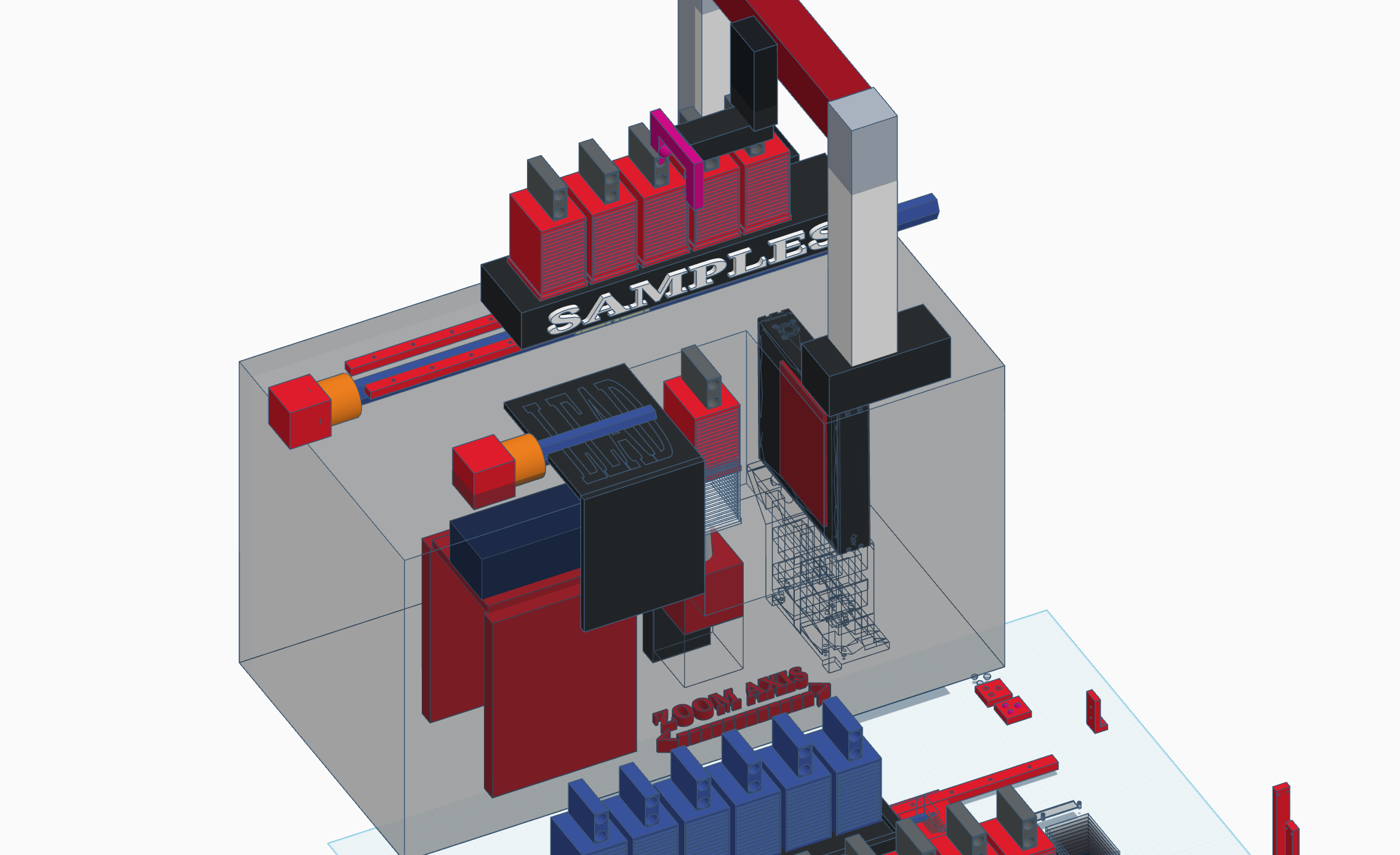

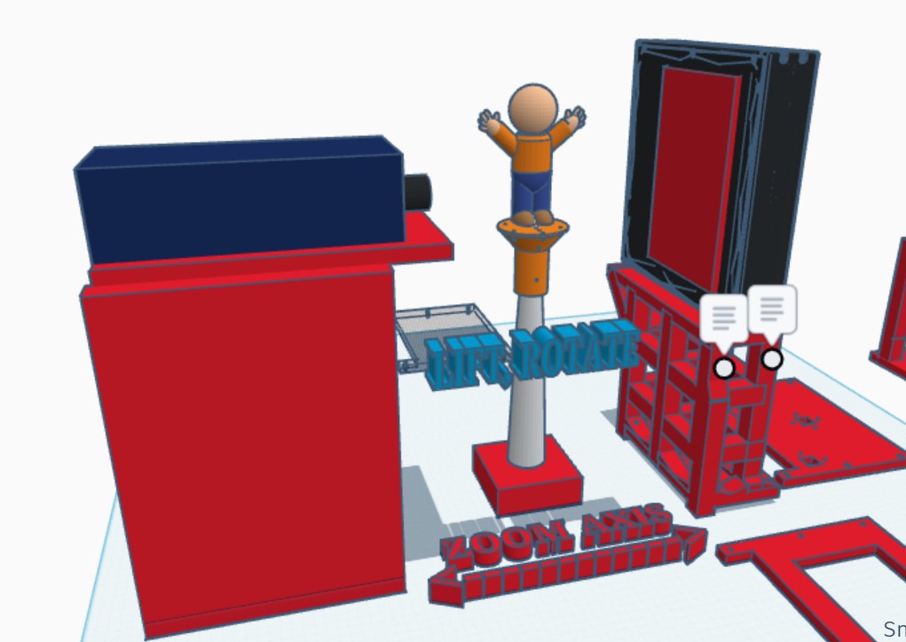

    And now it is. Behold, my first concept, rendered in 120FPS photorealistic 8k in solidworks, I mean, it's a screenshot of blocks and cylinders stacked together in TinkerCAD:
    I should just accept that I'm a lifelong TinkerCADer and stop apologizing for it
    So you got a some kind of linear pushing thing, holding samples that I'm calling "cartridges". you got a some kind of bridge thing that holds a some kind of gripper, and moves back and forth and picks up samples and moves them up and down. And you've got a some kind of a door opener thing, cuz x-rays go pew pew pew and we want them to stay safely inside our lead box. Even if chatgpt thinks this is impossible and refuses to help me with anything the moment it sees any of the scary words. (personal rant)
    Well, if it works in CAD! Let's build it!

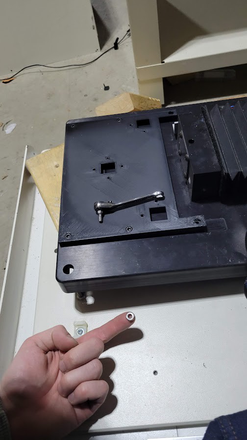

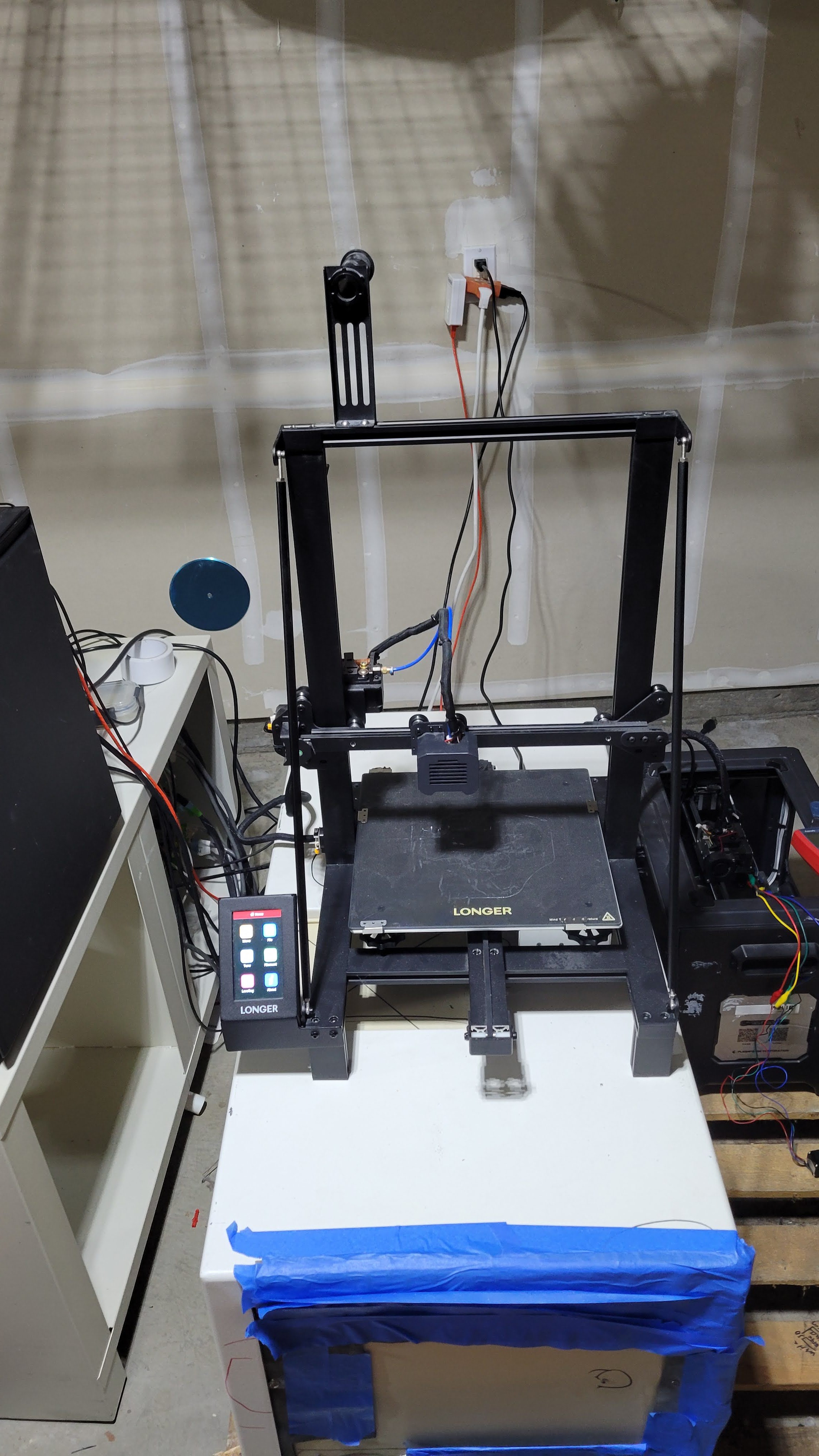

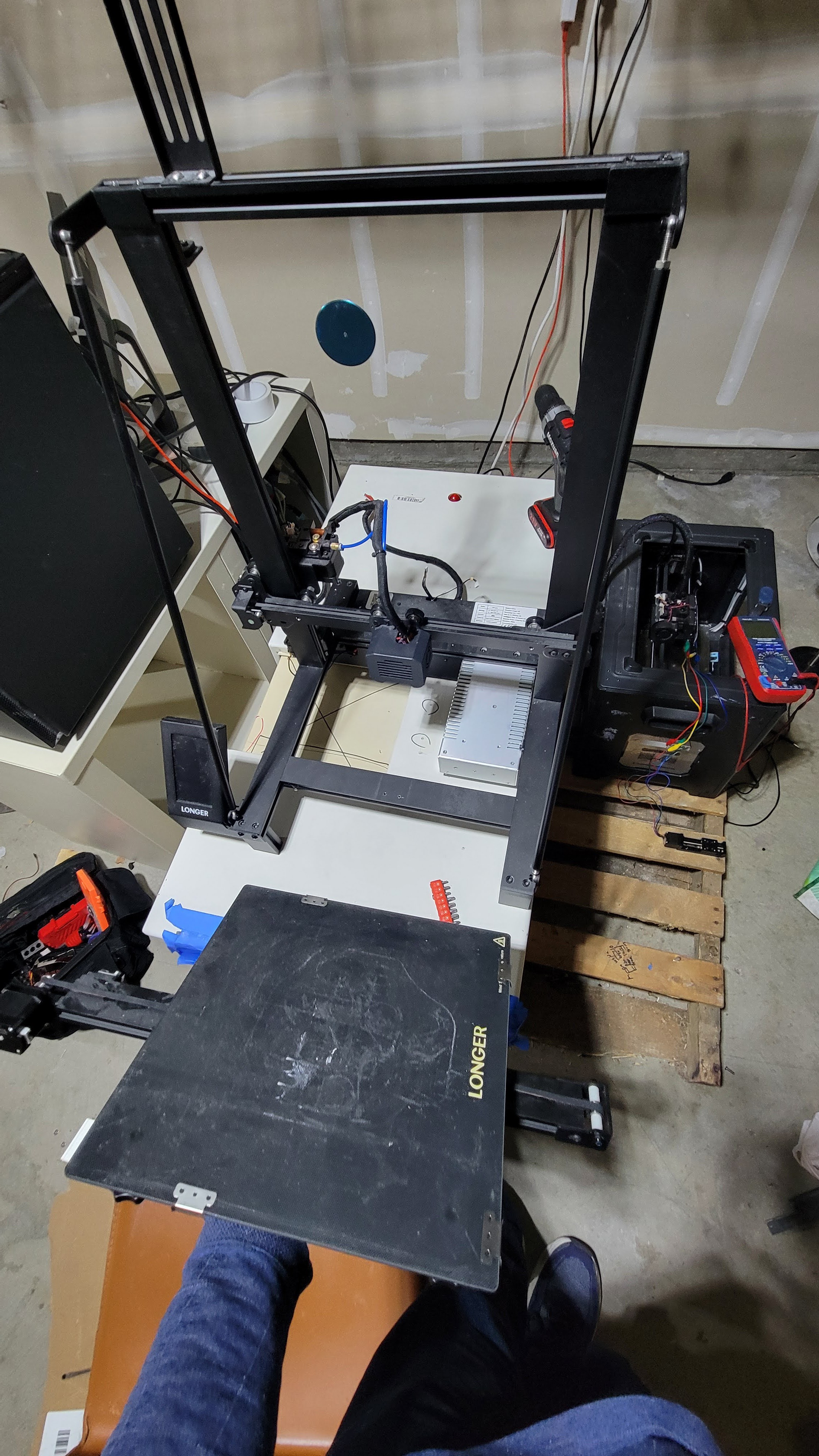

    I basically knew right off the bat that I would use a 3D printer as the core for this thing. I looked on facebook market place and scored this beauty: A "Longer" 3D printer, runs Marlin, 400 mm of Z travel (used up all but ~20 mm of that), FIFTY BUCKS!
    On the side, a Creator Pro that back home my dad used to Raise Dough
    There it is on top of my machine! Fits perfectly! I actually felt a little bad about disassembling it - I could use a big 3D printer - but I bought it for expressly this purpose, so disassemble it I did. Off went all the 3D printery-stuff: Hot end, build plate, and extruder.
    I was left with an open frame, which I realized I could go through instead of having an open bridge like in my initial concept. My designs are nothing if not c̶o̶m̶p̶l̶e̶t̶e̶l̶y̶ ̶d̶e̶v̶i̶a̶t̶i̶n̶g̶ ̶f̶r̶o̶m̶ ̶t̶h̶e̶ ̶o̶r̶i̶g̶i̶n̶a̶l̶ ̶p̶l̶a̶n̶ ̶i̶f̶ ̶i̶t̶ ̶e̶v̶e̶r̶ ̶e̶x̶i̶s̶t̶e̶d̶  flexible.

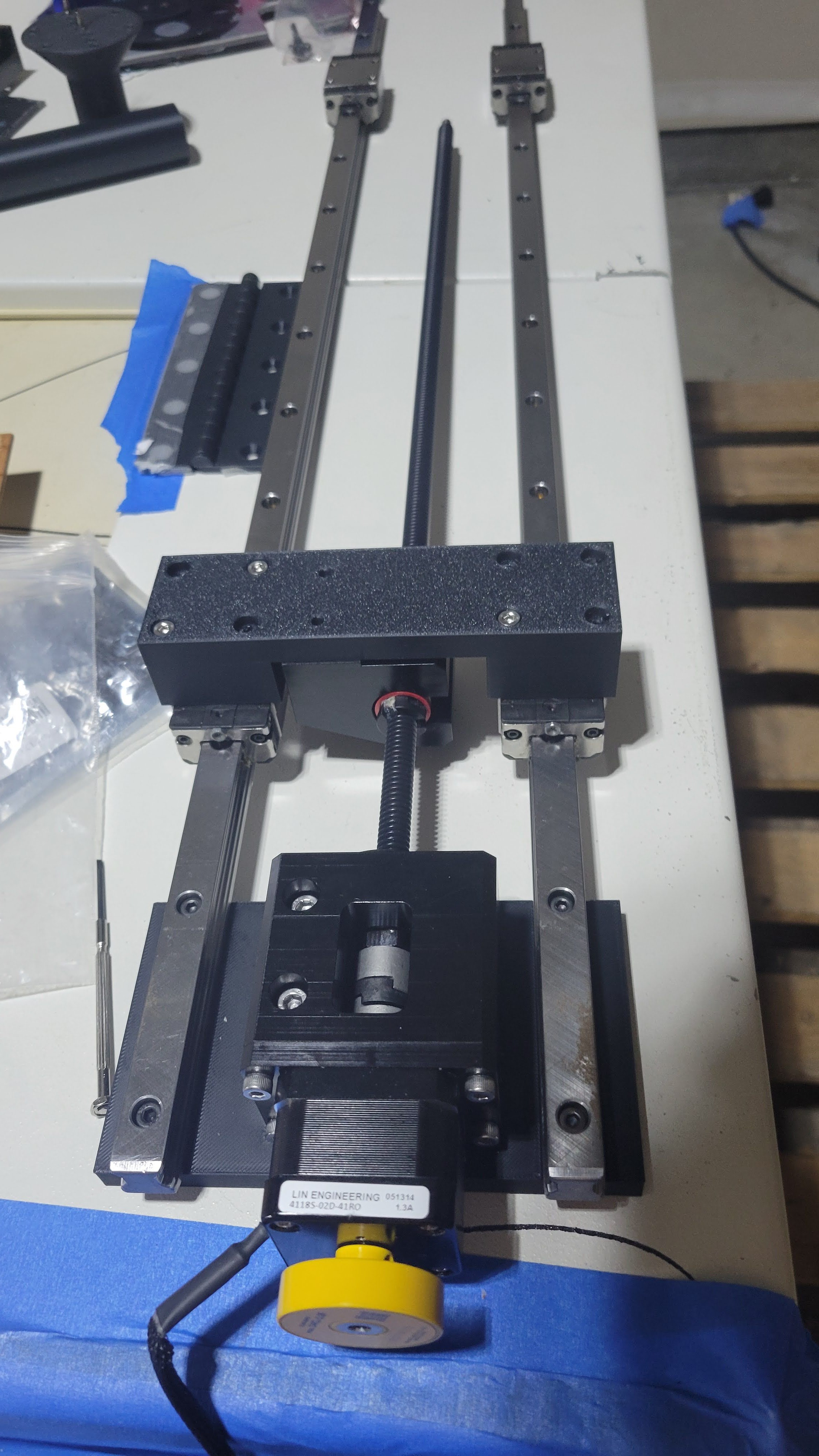

    There's my linear rail, in progress. it is a great example of "I spent 20 hours to use what I found in the dumpster last week instead of paying 200 bucks for a pre-built version on amazon". The problem being that the deal with the 3D printer was so good, how could I spend more on a single axis. What a trap, and what a pain....

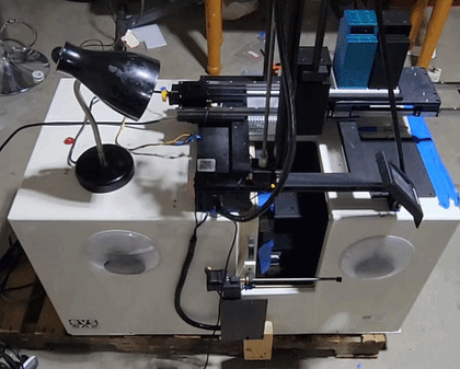

    I don't really remember what the state of the machine was the last time, but I know it's been a long time. Here's the state of the machine:
    Still on the same wooden pallet it was shipped on? Why not?

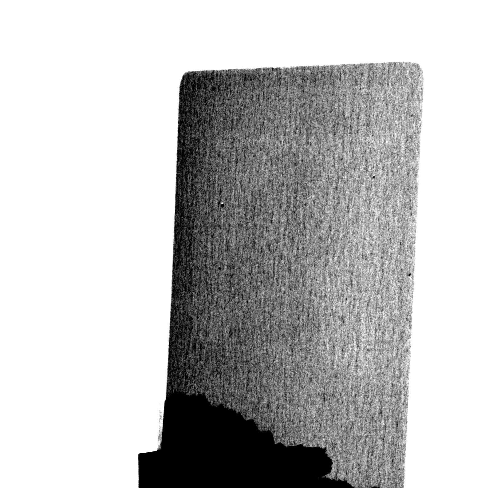

    Detector: Did a bunch of work on this lately. New detector stand, much sturdier, from the general advice of my (day job) coworker, to "box it up", which is just solid advice on the account of making stuff sturdy. And shifted over 15mm to the left, 10 mm up (as far as I want to go towards the ceiling!).

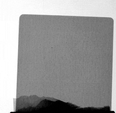

    The detector is mounted vertically. As in, the skinny end of the active area up. Here is a simple layout of the system:
    I'm expecting a lot out of this detector, being the most modern thing in the machine by 2 decades at least. It's a solid industrial flat panel, not superior to the original detector in every way from a pure physics standpoint - for instance, that one probably had a pretty thin scintillator, being geared more towards soft x-rays. But it is so much more stable and less noisy and that means faster images and also it's controlled directly by me instead of relying on a wacked out shutter mechanism which is huge.

    Source to Detector distance. And source to object distance. Like most calibration things in x-ray land, it involves balls.

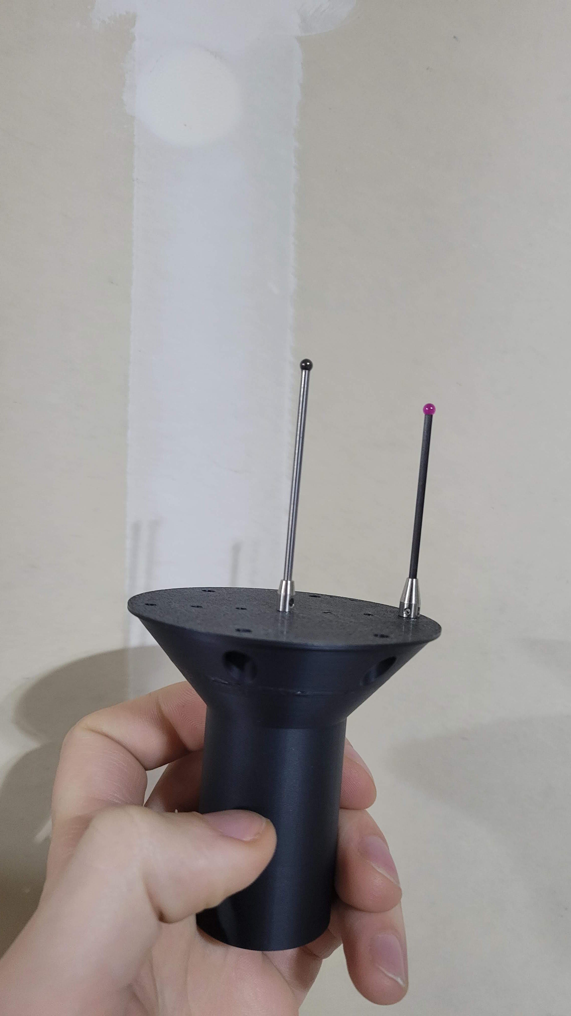

    Place a ball at magnification A, for example, with rotation axis as close as possible to the detector. Measure the projection on the detector. For instance, this ball is nominally 3.00 mm, and it covers 62 pixels, which are each 75 (74.98) microns, so the ball is apparently 4.64 mm and the magnification is like 1.5. Then you home to the other side, which is 164 mm closer to the source, and measure the ball as magnification... 5.5. I hate math, but if you see how much the magnification changed you get the source to the detector as like 350 mm, and the positions you scanned at like 64 and 228 mm, and I'm just rounding real data but you get the point...
    Step Two (step 0?). Before this actually you should have aligned the RA to the source in the magnification direction. You can do this with a ball. You put the ball at the rotation axis, and move the magnification axis, and see if the ball moves side to side. if it moves side to side, you adjust the source or the rotation axis with a motor or micrometer so that the ball stays still.
    Step Three (step two?) Now that the source and RA are aligned along the mag axis, We want to see how centered our detector is along that. You can do so using balls.
    Place a ball in the path of the beam, and move the magnification axis. The vertical location of the detector extent,...

    This is a kit kat bar, and that is actually a pretty substantial difference. Whenever you do this, you're in a sense corrupting the image, but generally to a state that is more pleasing to the eye.
    This is what the kit kat projections look like with and without edge finding (the "filtered" part of filtered back projection).
    It's not meant for structured noise, but it still doesn't do a terrible job at it anyway. AI is weird.
