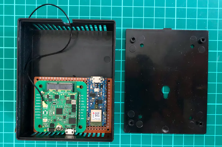

This project requires a low-powered, reliable, and widely available yet cost-effective cellular network radio to send alert messages to the phone and cloud. I will be using a Blues Wireless Notecard (for Cellular connectivity) and a Blues Wireless Notecarrier-B, a carrier board for the Notecard.
Although the Notecard is capable as a standalone device for tracking purposes, we need to run Tensorflow Lite model inferencing using Edge Impulse, so we will be using an Arduino Nano 33 BLE as a host MCU. The slim profile of the Notecard with carrier board and inbuilt microphone on the Arduino Nano 33 BLE make it a good fit for our purpose. We need an antenna for better indoor cellular connectivity and a protoboard to assemble the hardware.
The Notecarrier-B and Arduino Nano 33 BLE are connected over I2C.

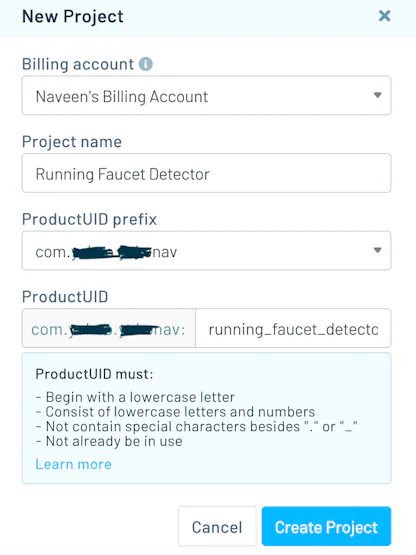

Before starting to run the application we should set up the Notecard. Please see the easy-to-follow quick-start guide here to set up a Notecard with a Notecarrier-B to test that everything works as expected. The application code does the Notecard setup at boot-up to make sure it is always in the known state. We also need to set up Notehub, which is a cloud service that receives data from the Notecard and allows us to manage the device, and route that data to our cloud apps and services. We can create a free account at https://notehub.io/sign-up, and after successful login, we can create a new project.
We should copy the ProjectUID which is used by Notehub to associate the Notecard to the project created.

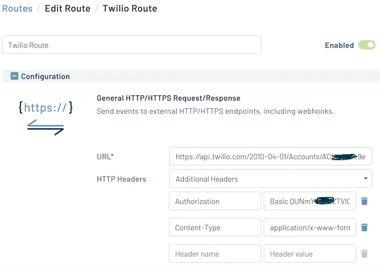

For SMS alerts we need to set up an account at Twilio and create a route by clicking the Create Route link at the top right on the Route page. Please follow the instructions given in the nicely written guide provided by Blues Wireless, for leveraging the General HTTP/HTTPS Request/Response Route type to invoke the Twilio API.
In the Filters section, we have to specify which Notecard outbound file data we want to route to Twilio. It would make sure that we always send out the intended data. In the application code, we would add notes to the twilio.qo file.
To send SMS messages, the Twilio API expects form data with three key/value pairs (Body, From, and To). This can be achieved using a JSONata (a query and transformation language for JSON data) expression to format the data into the required form. We should choose JSONata Expression in the Data > Transform field and we can enter the JSONata expression in the text area as shown below.
The JSONata expression is given below that formats the JSON payload to a Twilio API consumable message format.
( "&Body=" & body.event & "&From=" & body.from & "&To=" & body.to & "&" ) -

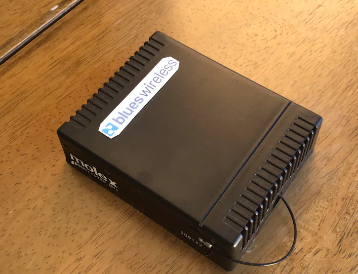

6Casing
For protection, the device is placed inside a plastic box that can be mounted on a wall.
The flexible cellular antenna is stuck to the side of the box.
