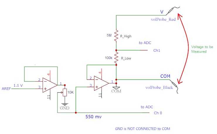

Real voltmeters have COM (Black) and V(Red) terminals, you connect COM to one node, V to another node on a circuit. The voltage reads on V node with respect to COM node.
You need to build an (AFE) Analog Front End, some sort of signal conditioning circuit to generate a COM like behavior. This COM node should have a voltage somewhere in between AVCC and Gnd. Ideally, half AVCC volts but for this design it's half AREF.
When external voltage measurements are taken with respect to COM, you can easily measure both positive and negative voltages !

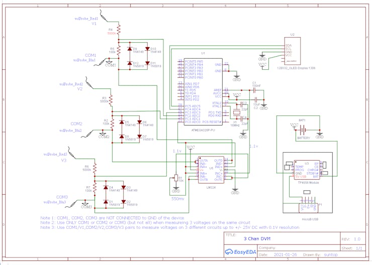

Please check the following circuit carefully :
Differential measurement with 2 single ended ADC channels
So, what's happening here ? Internal reference AREF is enabled on ATmega328P (from firmware/code in void setup). AREF pin has 1.1 V. Now, ADC measurement has an effective range of 0 to 1.1 volts.
Next, using a LM324 Opamp this 1.1 AREF voltage is buffered, meaning we still have 1.1 voltage from the first Opamp's output. A 10k multiturn trim pot is set exactly to 5k to produce 550mV (half AREF) volts. This 550 mV signal is buffered with the second Opamp. 550 mV signal is also connected to ADC Ch - 0. It should read 512 (half of 10 bit).
There is a voltage divider network consist of 5 Mega Ohms (two 10M in parallel) and 100 Kilo Ohms resistor, which is connected to the output of second Opamp.
I am defining, lower resistor end (100k) as COM and higher resistor (5M) end as V on this voltage divider network. The mid point of this divider is connected to ADC Ch - 1. When no external voltage is applied to this divider, ADC Ch - 1 should read 512 (because of 550 mV)
When an external voltage is applied, the voltage divider mid point voltage will shift above or below 550 mV. If external voltage on V is higher (positive voltage) with respect to COM, it will shift above 550 mV, If external voltage on V is lower (negative voltage) with respect to COM, it will shift below 550 mV. The ADC Ch - 1 reading will change accordingly. Using this change in ADC reading we can calculate external voltages.

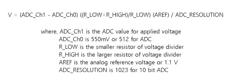

2Voltage Calculation Formula
Measured voltage with ADC will be a tiny fraction of actual voltage applied. That's why following formula is used inside the firmware to calculate back the actual voltage:-

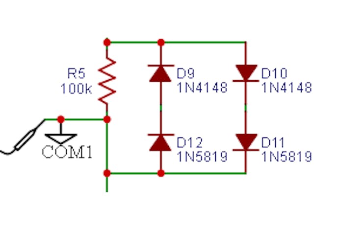

This is the bi-directional diode clamping for over voltage or surge protection you may use in parallel to R_Low. I left this part in my build due to lack of space !
Bi-directional voltage clamp
Safety should never be taken lightly ! These diodes will start to clamp when the voltage across R_Low exceeds +/- 800 mV. This is just an example, use different diode types for a suitable clamping voltage as needed.

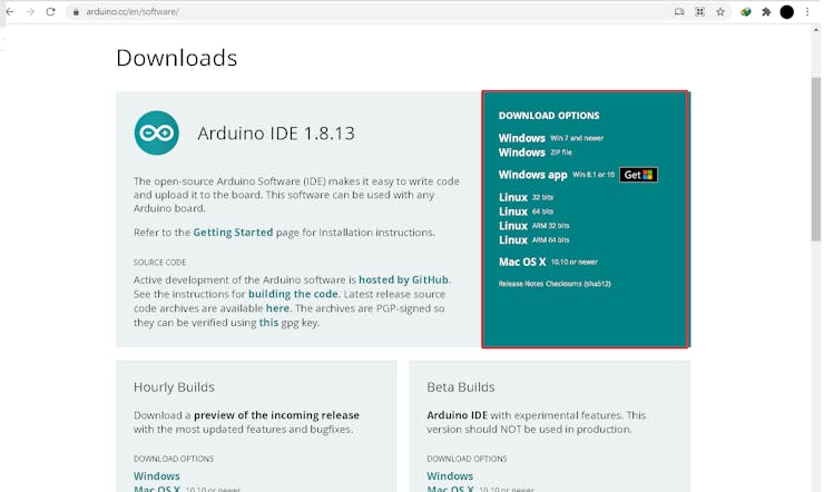

- Step 1: Download and Install Arduino from here on your computer.
Download IDE

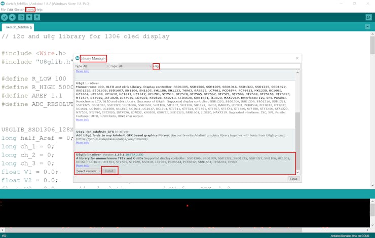

- Step 2: Open the IDE. Go to Tools > Library Manager and type 'u8g'
Installing u8g library
install the u8glib (by Oliver) library for 1306 OLED display.

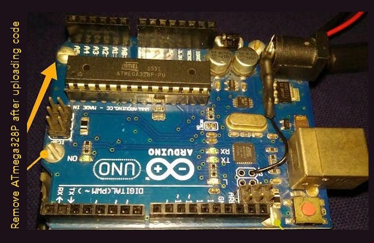

- Step 3: Connect Arduino Uno to USB, copy and paste the code attached below. Then compile and upload the code.
- Step 4: Remove the Atmega328P chip from Uno board
Remove Atmega328 after uploading code
- Step 5: Build a circuit according to this schematic. Solder all the components on a protoboard.
1 / 3 • Voltmeter Schematic

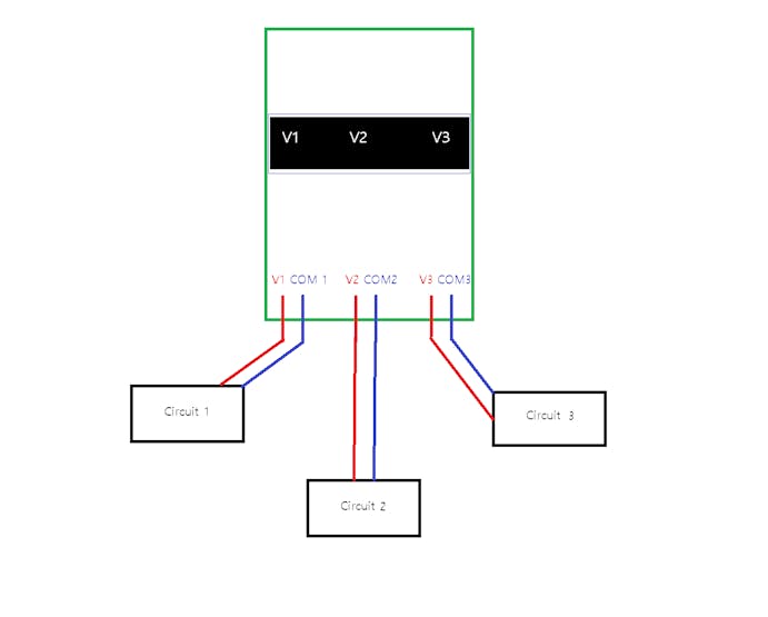

There are 3 Commons COM1, COM2, COM3 and 3 corresponding V1, V2, V3 probes for voltage measurement on 3 different channels.
For channel 1, voltage is measures on V1 with respect to COM1. If a circuit node probed with V1 has higher potential than a node probed with COM1, voltage reading will be positive. If both V1 and COM1 are swapped on those two circuit nodes, voltage reading will be negative.
Same goes for channel 2 with V2 & COM2 and for channel 3 with V3 & COM3.
When measuring three different voltages on 3 different circuits which don't share any electrical connections, use V1/COM1, V2/COM2, V3/COM3 pairs for 3 circuits.
3 different voltage measurements on 3 different circuits

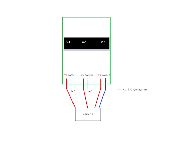

When measuring three different voltages on a single circuit, DO NOT USE multiple COMs. Just connect ONLY ONE COM (for example just COM3, any COM will do !) to the Gnd or any node of that circuit. Then use V1, V2, V3 to measure 3 different voltages on 3 different nodes with respect to the Gnd or node where COM is connected.
3 different voltage measurements on single circuit
Connecting multiple COMs on same circuit will screw up readings !
