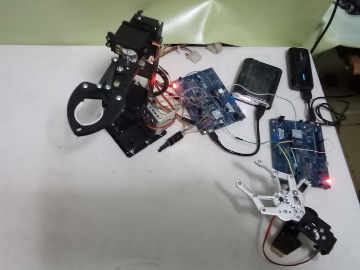

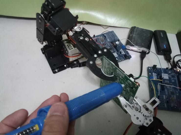

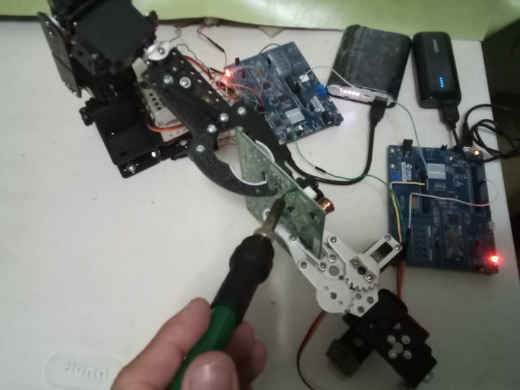

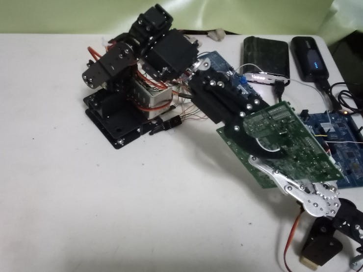

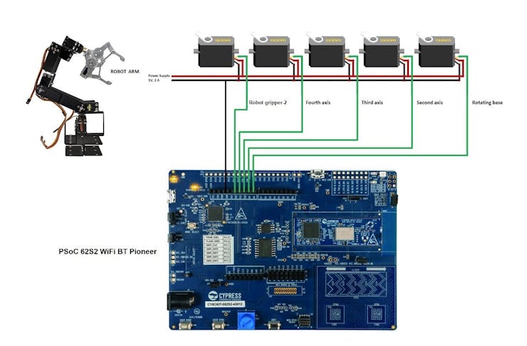

7. Unsoldering Components With Infineon Version
A project log for Work-holding Robotic Arm for Electronic Workshop
Collaborative Robotic Arm Used as Assistant in an Electronic Workshop And Controlled by Voice Commands and Capsense Technology
guillermo-perez-guillenGuillermo Perez Guillen 07/30/2023 at 00:030 Comments
Now, I show you how to use the CAPSENSE technology to unsolder components, and again using the PSoC 62S2 WiFi BT Pioneer Kit board. Below I show you the schematic diagram.
Schematic Diagram
Schematic diagram
Schematic diagram
How does it work?
The gripper-1 also helped me to desolder components on a PCB board.
The gripper-1 also helped me to desolder components on a PCB board.
Between two grippers the PCB board is fixedly clamped as shown in the picture
Between two grippers the PCB board is fixedly clamped as shown in the picture
Its time to desolder a component with the soldering iron
Its time to desolder a component with the soldering iron
Finally we use the solder extractor to remove the component
Finally we use the solder extractor to remove the component
Prgramming With ModusToolbox
Again as in section 4, I have used the "CAPSENSE_Buttons_and_Slider" example and named the project as Unsoldering_Components_Using_Capsense.
We repeat the same steps already seen to program the other PSoC 62S2 board as a component desoldering iron
We repeat the same steps already seen to program the other PSoC 62S2 board as a component desoldering iron
Finally, I have modified the "led.c" code. Below I show you the full code.
// AUTHOR: Guillermo Perez Guillen
* Header files includes
#include "cybsp.h"
#include "cyhal.h"
#include "led.h"
#include <stdio.h> // added
#include <math.h>
* Global constants
#define PWM_LED_FREQ_HZ    (1000000lu)  /* in Hz */
#define GET_DUTY_CYCLE(x)    (100 - x)
* Global constants
led_state_t led_state_cur = LED_OFF;
cyhal_pwm_t pwm_led;
cyhal_pwm_t servo_1; // robot arm
cyhal_pwm_t servo_2;
cyhal_pwm_t servo_3;
cyhal_pwm_t servo_4;
cyhal_pwm_t servo_5; // robot gripper-2
 * Servo Macros - added
/* PWM Frequency */
#define PWM_FREQUENCY (50u)
/* PWM Duty-cycle */
#define PWM_DUTY_CYCLE_1 (4.44f) //  30 degrees
#define PWM_DUTY_CYCLE_2 (8.02f) //  100 degrees
#define PWM_DUTY_CYCLE_3 (10.76f) // 150 degrees
#define PWM_DUTY_CYCLE_4 (8.02f) //  100 degrees
#define PWM_DUTY_CYCLE_5 (3.48f) //  10 degrees - robot gripper-2
* Function Name: update_led_state
* Summary:
*  This function updates the LED state, based on the touch input.
* Parameter:
*  ledData: the pointer to the LED data structure
void update_led_state(led_data_t *ledData)
    if ((led_state_cur == LED_OFF) && (ledData->state == LED_ON))
        cyhal_pwm_start(&pwm_led);
        led_state_cur = LED_ON;
        ledData->brightness = LED_MAX_BRIGHTNESS;
        for (int i = 65; i <= 90; i++){ // servo_2 ***
        float PWM_DUTY_CYCLE_S2 = 0.00003 * pow(i, 2) + 0.0472 * i + 3;
        cyhal_pwm_set_duty_cycle(&servo_2, PWM_DUTY_CYCLE_S2, PWM_FREQUENCY);
        cyhal_pwm_start(&servo_2);
        cyhal_system_delay_ms(20);
        cyhal_system_delay_ms(50);
        for (int i = 100; i >= 30; i--){ // servo_1 ***
        float PWM_DUTY_CYCLE_S1 = 0.00003 * pow(i, 2) + 0.0472 * i + 3;
        cyhal_pwm_set_duty_cycle(&servo_1, PWM_DUTY_CYCLE_S1, PWM_FREQUENCY);
        cyhal_pwm_start(&servo_1);
        cyhal_system_delay_ms(20);
        cyhal_system_delay_ms(50);
        for (int i = 90; i >= 65; i--){ // servo_2 ***
        float PWM_DUTY_CYCLE_S2 = 0.00003 * pow(i, 2) + 0.0472 * i + 3;
        cyhal_pwm_set_duty_cycle(&servo_2, PWM_DUTY_CYCLE_S2, PWM_FREQUENCY);
        cyhal_pwm_start(&servo_2);
        cyhal_system_delay_ms(20);
        cyhal_system_delay_ms(50);
        for (int i = 8; i <= 60; i++){ // servo_5 *** robot gripper-2 opened
        float PWM_DUTY_CYCLE_S5 = 0.00003 * pow(i, 2) + 0.0472 * i + 3;
        cyhal_pwm_set_duty_cycle(&servo_5, PWM_DUTY_CYCLE_S5, PWM_FREQUENCY);
        cyhal_pwm_start(&servo_5);
        cyhal_system_delay_ms(20);
        cyhal_system_delay_ms(500);
        for (int i = 65; i <= 90; i++){ // servo_2 ***
        float PWM_DUTY_CYCLE_S2 = 0.00003 * pow(i, 2) + 0.0472 * i + 3;
        cyhal_pwm_set_duty_cycle(&servo_2, PWM_DUTY_CYCLE_S2, PWM_FREQUENCY);
        cyhal_pwm_start(&servo_2);
        cyhal_system_delay_ms(20);
        cyhal_system_delay_ms(250);
        for (int i = 60; i >= 10; i--){ // servo_5 *** robot gripper-2 closesd
        float PWM_DUTY_CYCLE_S5 = 0.00003 * pow(i, 2) + 0.0472 * i + 3;
        cyhal_pwm_set_duty_cycle(&servo_5, PWM_DUTY_CYCLE_S5, PWM_FREQUENCY);
        cyhal_pwm_start(&servo_5);
        cyhal_system_delay_ms(20);
        cyhal_system_delay_ms(50);
    else if ((led_state_cur == LED_ON) && (ledData->state == LED_OFF))
        cyhal_pwm_stop(&pwm_led);
        led_state_cur = LED_OFF;
        ledData->brightness = 0;
        for (int i = 30; i <= 165; i++){ // servo_1 ***
        float PWM_DUTY_CYCLE_S1 = 0.00003 * pow(i, 2) + 0.0472 * i + 3;
        cyhal_pwm_set_duty_cycle(&servo_1, PWM_DUTY_CYCLE_S1, PWM_FREQUENCY);
        cyhal_pwm_start(&servo_1);
        cyhal_system_delay_ms(20);
        cyhal_system_delay_ms(250);
        for (int i = 10; i <= 60; i++){ // servo_5 *** robor gripper-2 opened
        float PWM_DUTY_CYCLE_S5 = 0.00003 * pow(i, 2) + 0.0472 * i + 3;
        cyhal_pwm_set_duty_cycle(&servo_5, PWM_DUTY_CYCLE_S5, PWM_FREQUENCY);
        cyhal_pwm_start(&servo_5);
        cyhal_system_delay_ms(20);
        cyhal_system_delay_ms(50);
        for (int i = 90; i >= 65; i--){ // servo_2 ***
        float PWM_DUTY_CYCLE_S2 = 0.00003 * pow(i, 2) + 0.0472 * i + 3;
        cyhal_pwm_set_duty_cycle(&servo_2, PWM_DUTY_CYCLE_S2, PWM_FREQUENCY);
        cyhal_pwm_start(&servo_2);
        cyhal_system_delay_ms(20);
        cyhal_system_delay_ms(500);
        for (int i = 60; i >= 8; i--){ // servo_5 *** robot gripper-2 closed
        float PWM_DUTY_CYCLE_S5 = 0.00003 * pow(i, 2) + 0.0472 * i + 3;
        cyhal_pwm_set_duty_cycle(&servo_5, PWM_DUTY_CYCLE_S5, PWM_FREQUENCY);
        cyhal_pwm_start(&servo_5);
        cyhal_system_delay_ms(20);
        cyhal_system_delay_ms(250);
        for (int i = 65; i <= 90; i++){ // servo_2 ***
        float PWM_DUTY_CYCLE_S2 = 0.00003 * pow(i, 2) + 0.0472 * i + 3;
        cyhal_pwm_set_duty_cycle(&servo_2, PWM_DUTY_CYCLE_S2, PWM_FREQUENCY);
        cyhal_pwm_start(&servo_2);
        cyhal_system_delay_ms(20);
        cyhal_system_delay_ms(50);
        for (int i = 165; i >= 100; i--){ // servo_1 ***
        float PWM_DUTY_CYCLE_S1 = 0.00003 * pow(i, 2) + 0.0472 * i + 3;
        cyhal_pwm_set_duty_cycle(&servo_1, PWM_DUTY_CYCLE_S1, PWM_FREQUENCY);
        cyhal_pwm_start(&servo_1);
        cyhal_system_delay_ms(20);
        cyhal_system_delay_ms(250);
        for (int i = 90; i >= 65; i--){ // servo_2 ***
        float PWM_DUTY_CYCLE_S2 = 0.00003 * pow(i, 2) + 0.0472 * i + 3;
        cyhal_pwm_set_duty_cycle(&servo_2, PWM_DUTY_CYCLE_S2, PWM_FREQUENCY);
        cyhal_pwm_start(&servo_2);
        cyhal_system_delay_ms(20);
        cyhal_system_delay_ms(50);
    else
    if ((LED_ON == led_state_cur) || ((LED_OFF == led_state_cur) && (ledData->brightness > 0)))
        cyhal_pwm_start(&pwm_led);
        uint32_t brightness = (ledData->brightness < LED_MIN_BRIGHTNESS) ? LED_MIN_BRIGHTNESS : ledData->brightness;
        uint32_t servo_control_gripper_2 = brightness;
        uint32_t PWM_DUTY_CYCLE_GRIPPER_2 = 0.00003 * pow(servo_control_gripper_2, 2) + 0.0472 * servo_control_gripper_2 + 3;
                /* Drive the LED with brightness */
        cyhal_pwm_set_duty_cycle(&pwm_led, GET_DUTY_CYCLE(brightness), PWM_LED_FREQ_HZ);
        cyhal_pwm_set_duty_cycle(&servo_4, PWM_DUTY_CYCLE_GRIPPER_2, PWM_FREQUENCY); // servo 4
        cyhal_pwm_start(&servo_4);
        led_state_cur = LED_ON;
* Function Name: initialize_led
* Summary:
*  Initializes a PWM resource for driving an LED.
cy_rslt_t initialize_led(void)
    cy_rslt_t rslt;
    rslt = cyhal_pwm_init(&pwm_led, CYBSP_USER_LED, NULL);
    rslt = cyhal_pwm_init(&servo_1, P7_5, NULL); // pinout
    rslt = cyhal_pwm_init(&servo_2, P7_6, NULL);
    rslt = cyhal_pwm_init(&servo_3, P12_3, NULL);
    rslt = cyhal_pwm_init(&servo_4, P12_0, NULL);
    rslt = cyhal_pwm_init(&servo_5, P12_1, NULL);
    cyhal_pwm_set_duty_cycle(&servo_1, PWM_DUTY_CYCLE_1, PWM_FREQUENCY);
    cyhal_pwm_start(&servo_1);
    cyhal_pwm_set_duty_cycle(&servo_2, PWM_DUTY_CYCLE_2, PWM_FREQUENCY);
    cyhal_pwm_start(&servo_2);
    cyhal_pwm_set_duty_cycle(&servo_3, PWM_DUTY_CYCLE_3, PWM_FREQUENCY);
    cyhal_pwm_start(&servo_3);
    cyhal_pwm_set_duty_cycle(&servo_4, PWM_DUTY_CYCLE_4, PWM_FREQUENCY);
    cyhal_pwm_start(&servo_4);
    cyhal_pwm_set_duty_cycle(&servo_5, PWM_DUTY_CYCLE_5, PWM_FREQUENCY);
    cyhal_pwm_start(&servo_5);
    if (CY_RSLT_SUCCESS == rslt)
        rslt = cyhal_pwm_set_duty_cycle(&pwm_led,
                                        GET_DUTY_CYCLE(LED_MAX_BRIGHTNESS),
                                        PWM_LED_FREQ_HZ);
        if (CY_RSLT_SUCCESS == rslt)
            rslt = cyhal_pwm_start(&pwm_led);
    if (CY_RSLT_SUCCESS == rslt)
        led_state_cur = LED_ON;
    return rslt;
As in the previ
As in the previous section, I have also used Capsense sliding to control the gripper. Again, all other servos are controlled by the formula obtained in section 3, for example, servo 2 is moved from 65° to 90° with:
for (int i = 65; i <= 90; i++){ // servo_2 ***
        float PWM_DUTY_CYCLE_S2 = 0.00003 * pow(i, 2) + 0.0472 * i + 3;
        cyhal_pwm_set_duty_cycle(&servo_2, PWM_DUTY_CYCLE_S2, PWM_FREQUENCY);
        cyhal_pwm_start(&servo_2);
        cyhal_system_delay_ms(20);
Test
