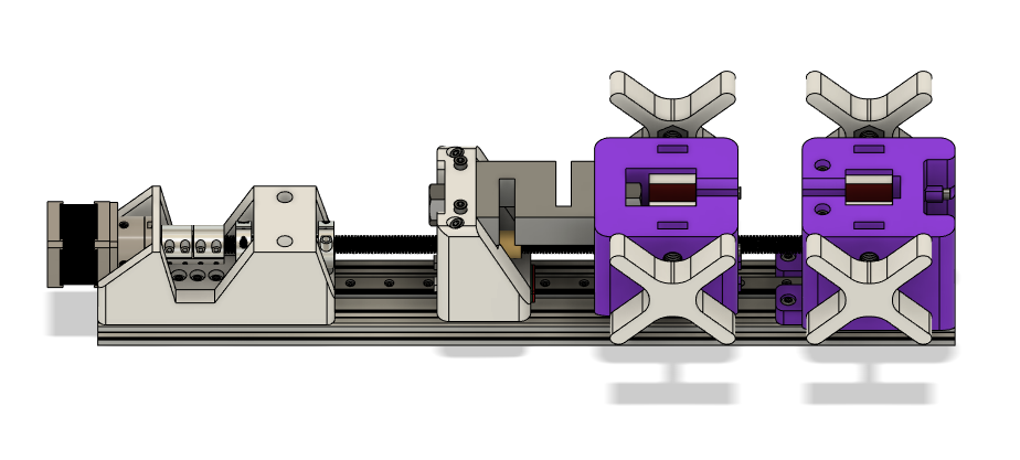

A $300 low cost electronic universal testing machine for tensile testing applications with loads under 1000N made from 3D printed and commercial parts.
Licensed under CC-BY-NC-SA 4.0
What is a universal tensile testing machine?
Tensile testing machines are variants of universal testing machines made specifically to test tensile strength of materials. It applies a tensile force to a specimen (stretches it) until it breaks, and measures the forces applied while doing so. Although this specific machine is built with mainly tensile testing in mind, this version is able to perform compression tests as well.
Benefits over commercial universal testing machines:
  • Significantly cheaper (costs around $300 versus $12,900-$150,000)
  • Customizable (Arduino programed)
  • 3D printable and accessible
  • Open source
Commercial tensile testers are extremely expensive. While they produce accurate and highly repeatable results given the right conditions, many material testing situations, especially for rapid prototyping, do not require the precision and accuracy that those machines give. They cost from 12,900 to 150,000 depending on the model! There is a need for low cost material testing systems for low strength materials, and that's where my UTTM comes in. For only $300, you get a machine capable of testing strengths up to a kilonewton with repeatable results (see research projects in logs section).
How does it work?
This tensile testing machine has mainly five parts: the stationary fixture, moving fixture, load cell (and its mount), and the motor (a geared NEMA 17 stepper motor). The moving fixture is attached to a load cell and controlled by the motor via a lead screw. After the specimen is loaded and a tensile test had begun, the motor rotates the lead screw. The lead screw translates rotations into linear motion, causing the load cell to be pulled back, but the specimen resists the pulling force by exerting an equal and opposite reaction, which is then measured by the load cell. This process continues until the specimen fractures. The same process is used for compression tests, except the specimens will be loaded in the opposite direction.

    With all the flaws in mind, I redesigned the machine in Fusion 360. This was while I was designing a large scale 3D printer known as the Blackstone Cube (I still haven't published it yet).
    The design went surprisingly smooth. With knowledge from the first version, I was able to finish it and build it within a few months. Of course, no electronics-related project would not be complete without its rite of passage - the magic smoke.
    That was not the only component I blew up. I took out an electrolytic capacitor, stepper motor driver, and my mom's computer's USB port, all due to a reverse polarity mistake. It was at this moment I realized the true power of tantalum and electrolytic capacitors.
    I developed some temporary trauma due to that.
    Now let's get to the serious business and talk about what changed compared to the previous version.
    List of Improvements:
    Hardware:
    • Ability to perform compression tests
    • Much less fixture deflection due to reinforcements
    • Much stronger grips
    • Shaft collars instead of flanged nuts to save space
    • Higher torque transfer
    • Designed in Fusion 360
    • More clearance in mounting holes
    Electronics:
    • Custom PCB for a more permanent electronics solution
    • Buttons and OLED display for testing without computer
    • Emergency Stop/Reset All button
    • Many more testing modes, including speed selection and modulus testing.
    • Support for PLX-DAQ data acquisition
    • Dedicated ATTiny85 for separate stepper motor controls
    • Easy to configure Arduino code
    From my testing, this new version is able to handle at least 1kN of load.

    One of the previous issues was hull deflection/flex under load. This shouldn't affect the maximum readings to a significant extent until the flex starts to introduce forces not parallel to center line of the specimen. To solve this, I've added bolt reinforcements to the machine and improved the structure.
    I'm no physicist, nor have I taken MechE classes, so to be frank, I don't know if the bolt placements are the most optimal. I do know that they should provide at least some reinforcement.
    The grip blocks now have nut inserts to aid against stripping and greatly increases clamping force by the fixtures.
    Better pillow blocks using shaft collars allowing longer couplers and higher load.
