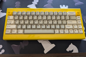

Project goals:
* make a keyboard which is sufficiently thin to fit inside steamdeck official case
* experiment with making flex PCBs using copper tape and a vinyl cutter (both as cheap flex PCBs and rapid PCB prototyping in general)
Keyboard stackup:
* OHP transparency film (layer 1 backing)
* copper tape
* OHP transparency film (middle layer with holes for making switch connections)
* copper tape
* OHP transparency film (layer 2 backing)
* vinyl stickers/labels
Usefulness as a PCB prototyping/ cheap DIY flex PCB creation method.
While the cutting process was relatively quick, weeding process (removal of unwanted parts) was quite slow (~20min for each layer). Copper tape held better than expected. Not sure what plastic the transparency film is made of, but it started melting at ~240 oC. With soldering iron at 220-225 melting it isn't too much of a problem. But the glue holding copper tape will loosen at that temperature, so you have to be very careful to avoid lifting or sliding the traces around. Not sure how easy it would be with lead free solder, since with it temperature window between melting solder and the plastic would be very narrow. This would be less of an issue with proper materials like kapton.
In theory the glue of copper tape was supposed to be somewhat conductive. With bigger overlapping patches it somewhat worked, but with thinner traces it was somewhat unreliable. Had to add small dots of soldering to connect the strips of copper tape together more reliably. Uses as wide copper tape as you can get to reduce amount of joints required. 50mm tape is most commonly available, 100mm is somewhat less common. It is also possible to find 20x30cm sheets of copper tape sold for shielding electric guitars, that would probably avoid the issue of having a joint across the middle of PCB, although I am not sure how easy it is to smoothly apply foil that is so wide.
