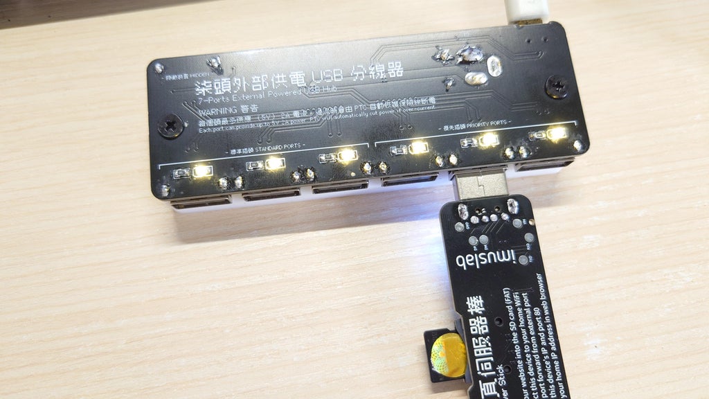

It is important that you check if there are any shorts on the PCB before plugging it into your computer. As chips these small are usually found with soldering defects like bridging between pins or worst, short circuiting your VCC (5V from the USB) to ground, it is a good practice to check if your WebStick is well soldered by inserting it into a protected power supply like a proper lab bench power supply.
In my case, I have built myself a DIY USB hub that build in PTC fuse and protection circuits on each USB port. When I insert my prototype into it, the fuse didn't pop, which means I can safely insert it into my computer's USB port!

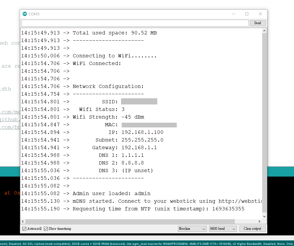

To start your web server, simply plug your WebStick into a power supply. If you plug it into your computer's USB port, you will see it started to giving out some debug information on Serial @ 9600 baudrate.
At the bottom of the debug info, you will find the reported IP address of your WebStick. In my case here, it is 192.168.1.100. So you can connect directly to it using either the mDNS or IP address by opening the following link in your browser
or
And you will see your homepage shown up.
