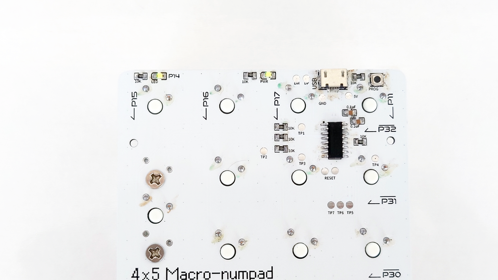

3Populate the PCB

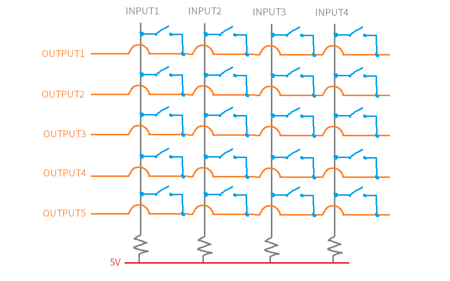

After the parts that can be out sourced to factories, now it is the hand crafting parts. Follow the diagram above to solder the parts in place. This will allow the MCU to perform a grid scanning on all the switches by activating each row (LOW activated) and read from each column (when the read is LOW, means that active row's reading column button is pressed).
This diagram showcase the simplified circuit diagram of the PCB, in which the rows are low activated instead of the normal high activated. This design can save 1 10K SMT resistors compare to HIGH activated design, and therefore making the BOM list identical as the previous macropad design.

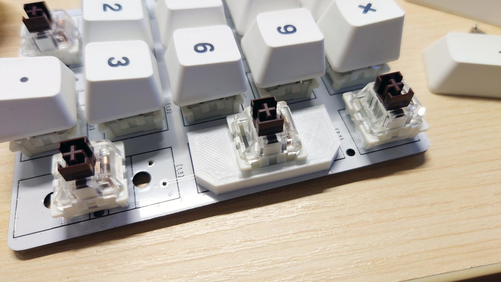

4Soldering the Switches
This numpad can be used as a macro-numpad if you populate all the 20 switches, or as a standard numpad if you only solder the 17 switches. Of course, you can always pick any number of switches in between like having one "0" and one "00".
5Installing Switch Stabilizer (Optional)
If you are using the standard numpad layout and solder only 17 switches, you might want to add the stablilizer parts to make the switch not wiggling around when pressed on the edge of the keycaps.
You can screw the stabilizer pieces in place using 2 M3 x 5 screws using the unused hole for the switches itself.
