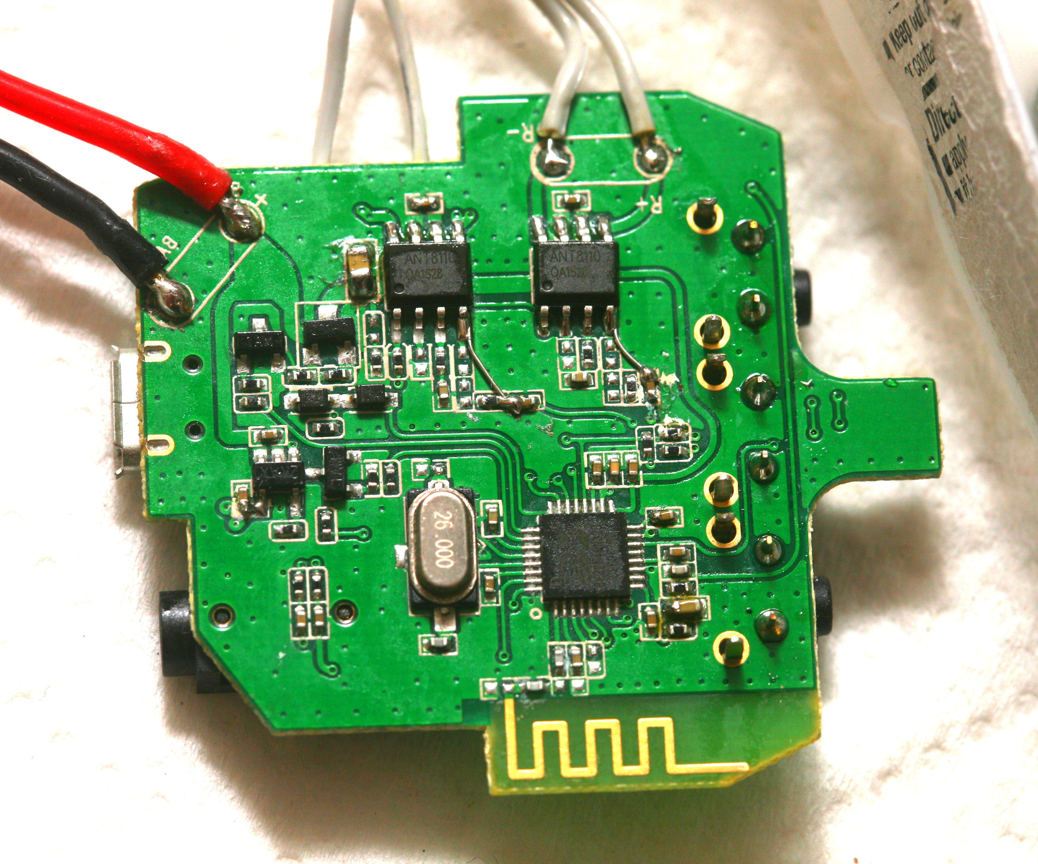

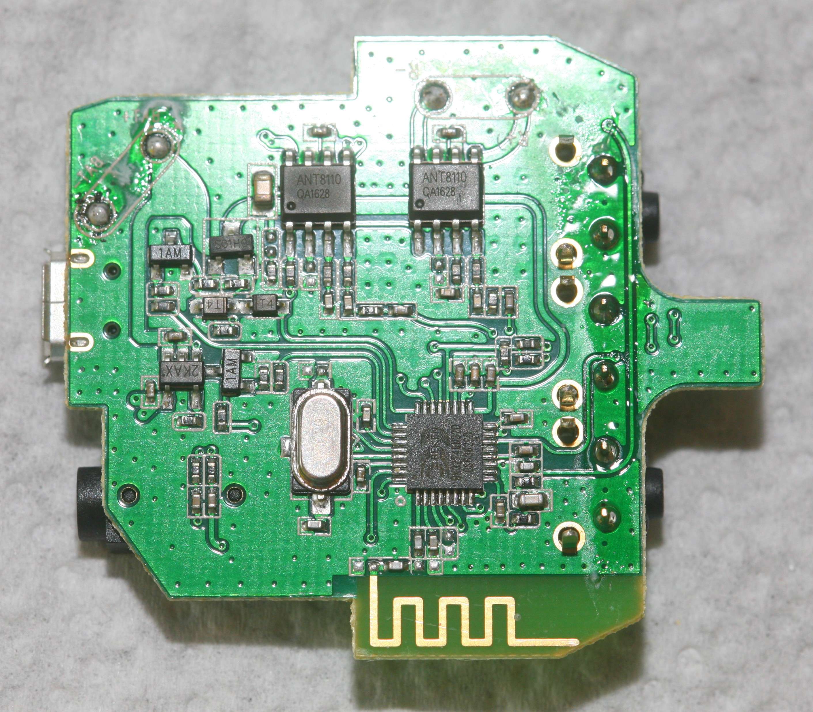

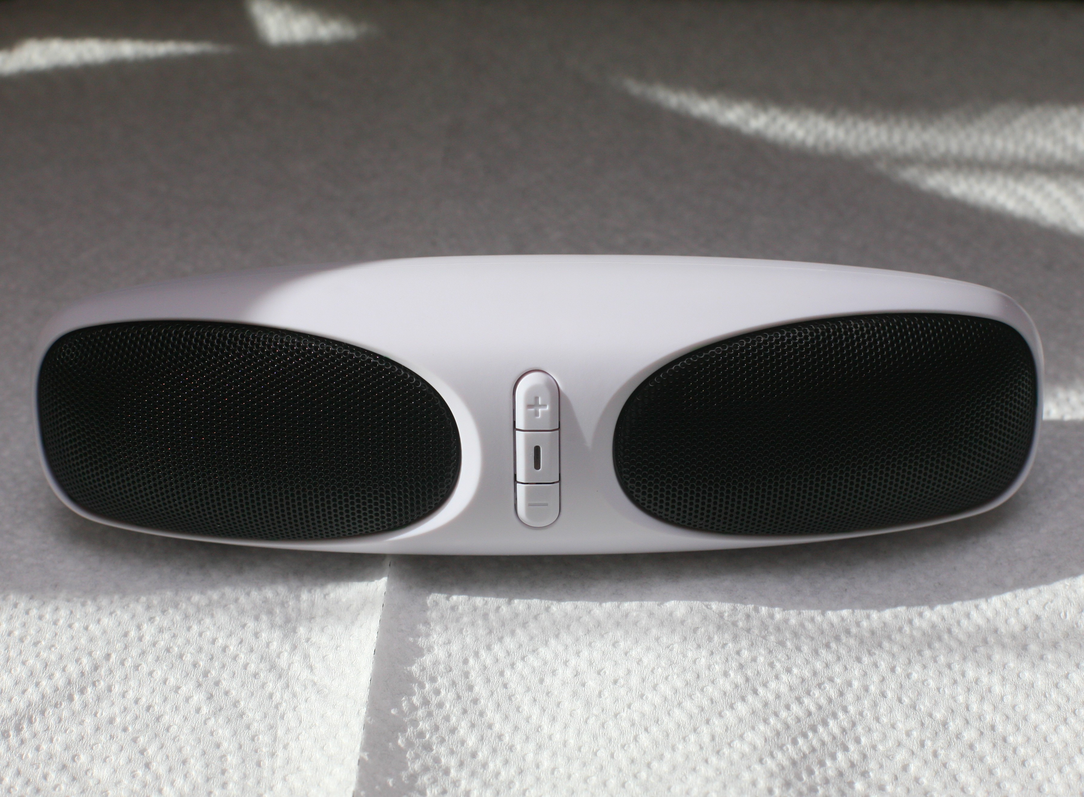

    After 2 years of bad connections & wrangling the cable, it was finally time for the long awaited bluetooth upgrade.  The lion kingdom's only stereo bluetooth speaker was a terrible vivitar from 9 years ago.
    It would have been too easy to just use it intact, but it didn't have usable quality sound.
    It previously had some bypasses to get rid of a highpass filter.

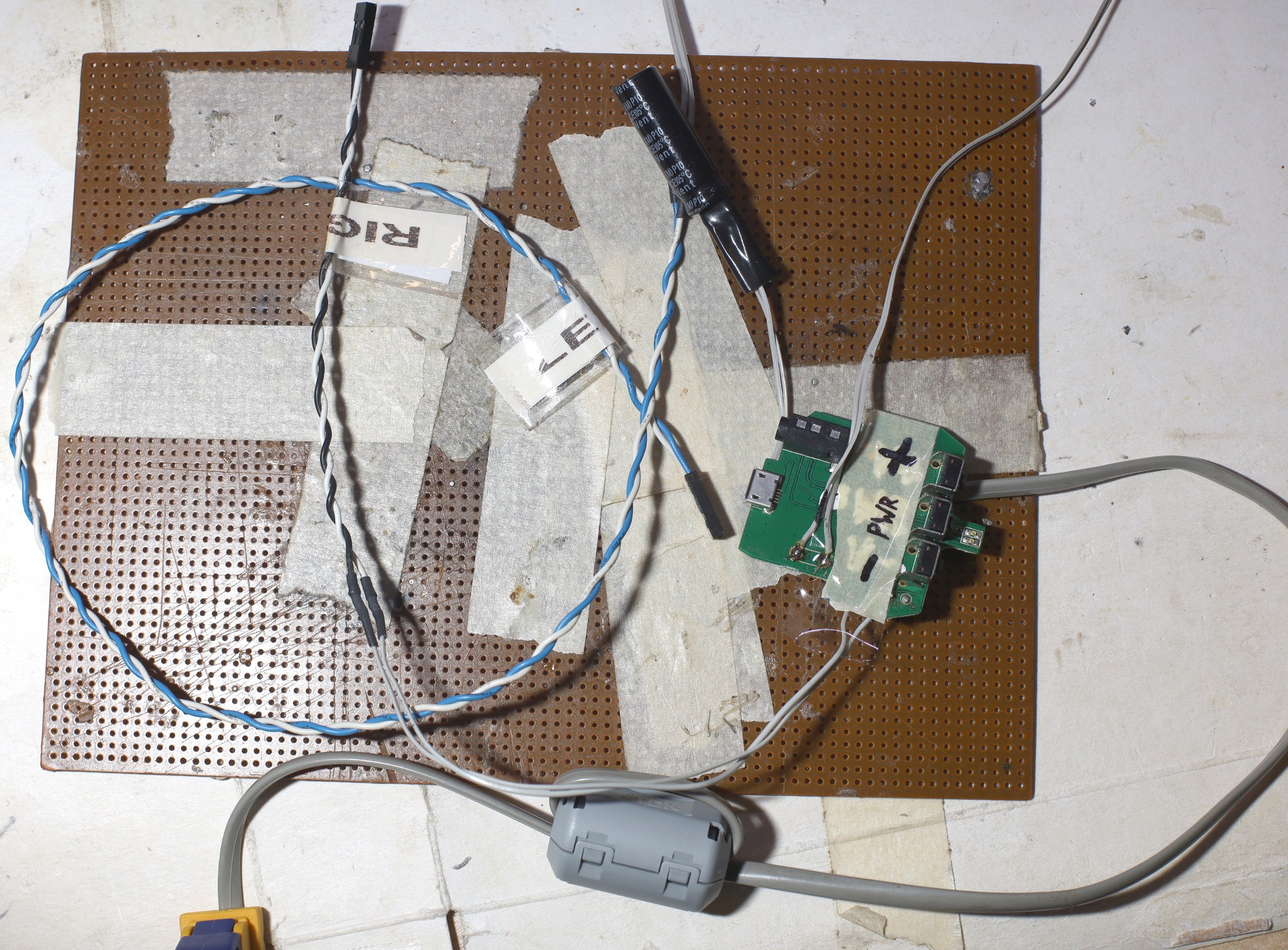

     The great challenge was eliminating the power supply noise.  It took a big cap & an RF choke.
    The mane challenge is its bluetooth advertising interferes with the other audio gear so it has to be turned off & on every day.  When it's turned off, it loses its volume setting.  Fortunately, the default setting doesn't seem to affect the signal to noise ratio.

    The 1st setup used some arduino speakers & an ancient amplifier based on  a TDA1517 from a soundblaster 16.  It has an LF353 for gain adjustment but no EQ.
    This setup wasn't very loud on 12V before clipping.  Seem to recall the TDA1517 getting louder with bigger speakers.  It's better than what lions had before.
    Using a spare bluetooth board would give it a power switch & more loudness.  It only burns .05W when idle & lions used to power this chip 24/7 when it was in a soundcard.  The headphone wire is a pain.
