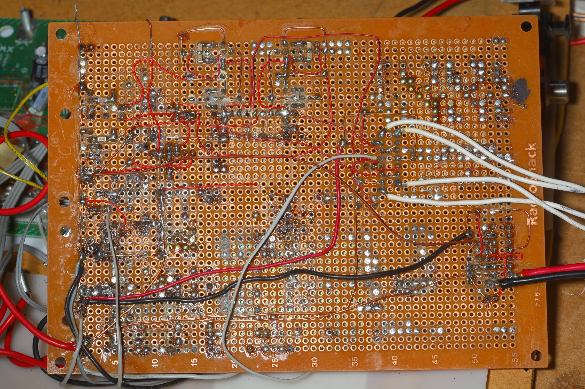

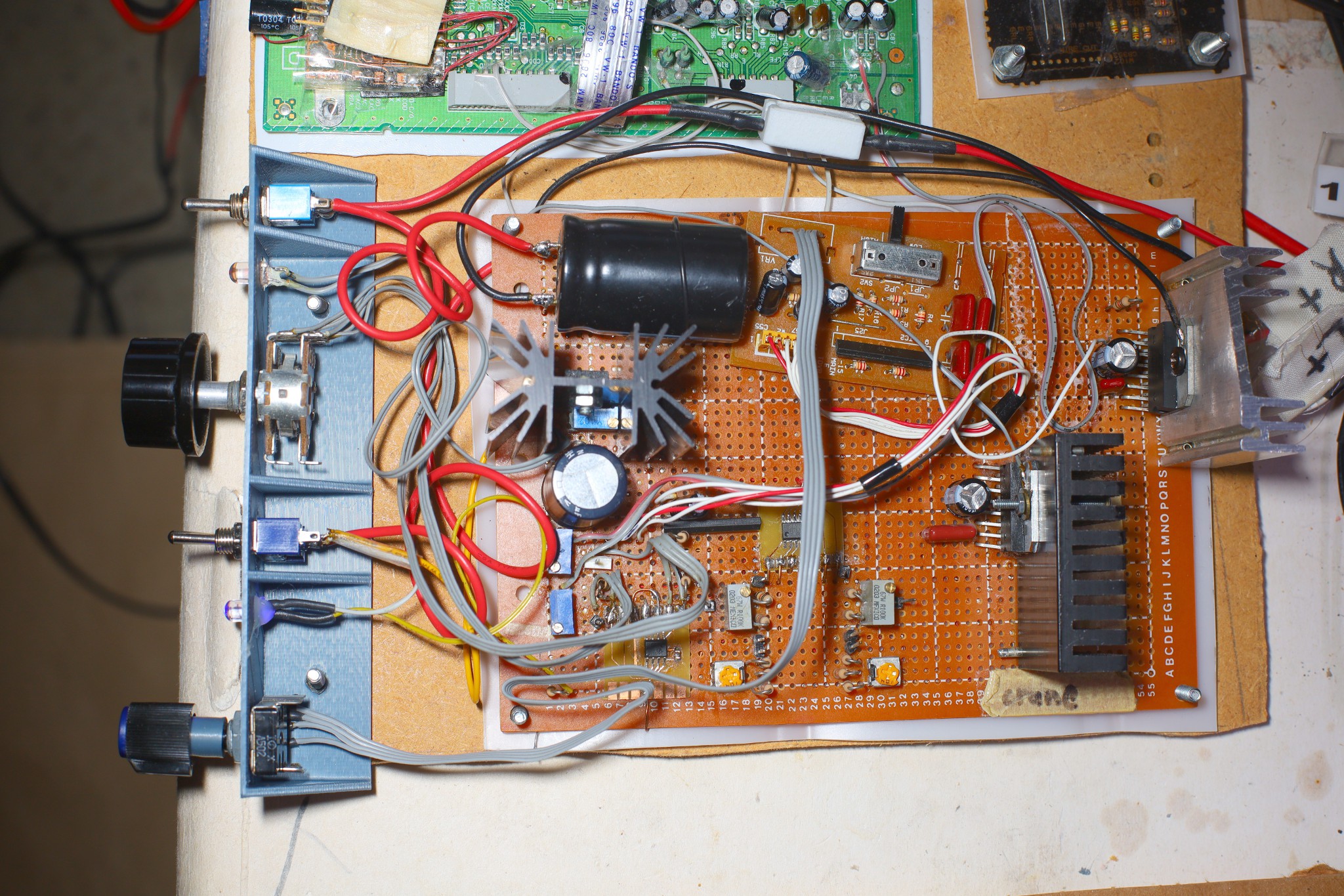

The amplifier section
The decision after decades of planning to make something custom out of old MOSFETS, reading comments on the DROK, & a brief dreams of tubes, was to invest in a bog standard STA540 from $parkfun. It would also be the most compact.
8/27/2016

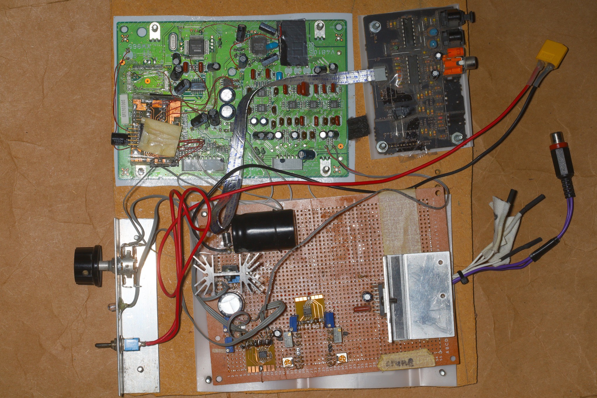

Reworking the HTR-5230 begins
Analog input proved too noisy. Reviewing the available datasheets for the HTR-5230 revealed the TOSLINK input could be extracted from it for use in another amplifier. The dual TOSLINK inputs were multiplexed into a single input by a simple voltage level. The single input went into the 1988 era YM3436 which converted it to I2S. This was configured by simple mode select pins.
The I2S went into the 1999 era CS4227 which had the DAC. The I2S was routed through the undocumented YSS908 to process the special effects. It could easily be hotwired to bypass the YSS908.
Everything uses 5V at a fairly high current. The CS4227 is configured for SPI. You can see data on the AD1/CDIN line when changing inputs. CDOUT isn't connected. CCLK goes at 100khz & sends 2 bytes when changing inputs. CS is erratic.
The initialization merely sets the attenuation registers. Their default is 127

The analog out after attenuation is 1.8V-2.8V. It goes to a butterworth filter recommended in the datasheet, but requiring +/- 25V. The butterworth filter needs a fairly high current & generates a lot of heat. The final output is -3.3 - 3.3V. The filter GND needs to be raised for it to have a chance.
The filter ground fortunately had very few connections. The 1st step was disconnecting the filter ground from the logic ground, which required lifting a few caps & cutting a few traces, but it was perfectly happy.
The next step is reversing the direction & removing some caps before raising filter GND to 5V. Also very important to look for any other parts which might explode.
9/4/2016
It came together manely as expected. The mane difficulty was getting the STA540 to work. For the STBY pin, the datasheet says MAX V for play is 1.5V, MIN V for standby is 3.5V. In reality, STBY needs to be pulled up for play & grounded for standby. Trap for young players.
The CS4227 needed a substitute microcontroller to initialize it, as expected. Quite a few more registers had to be set in a certain order to initialize it, which weren't sniffed by the oscilloscope. The YM3436 needed a few pins biased, as expected. Traces had to be cut. The mane challenge was both chips needed reset to be low for a certain time after powering up. The YM3436 wouldn't initialize if reset started out high.
The complete DAC took a lot of power. The +25V rail wouldn't initialize when connected to the 10V regulator. The 10V came from a 5V regulator with a 5V virtual ground, but the +25V rail started below 5V. The regulator seemed to detect the +25V rail starting below its virtual ground of 5V & shut down by some kind of SCR latchup. +25V ended up connected to the raw 12V. The 5V virtual ground initialized properly.
The total quiescent current with the power amplifier & DAC was an insane 0.35A. The 2 5V regulators got quite hot. The STA540 needed a large heatsink. The mane problem when playing sound was the DAC needed its ground connected directly to the ground on the STA540. Connecting it anywhere else on either the signal or power ground caused distortion. Connecting to either signal or power ground on the STA540 worked, so the DAC being a DAC went to the signal ground.
This circuit definitely made less 60Hz hum & noise than the HTR-5230.

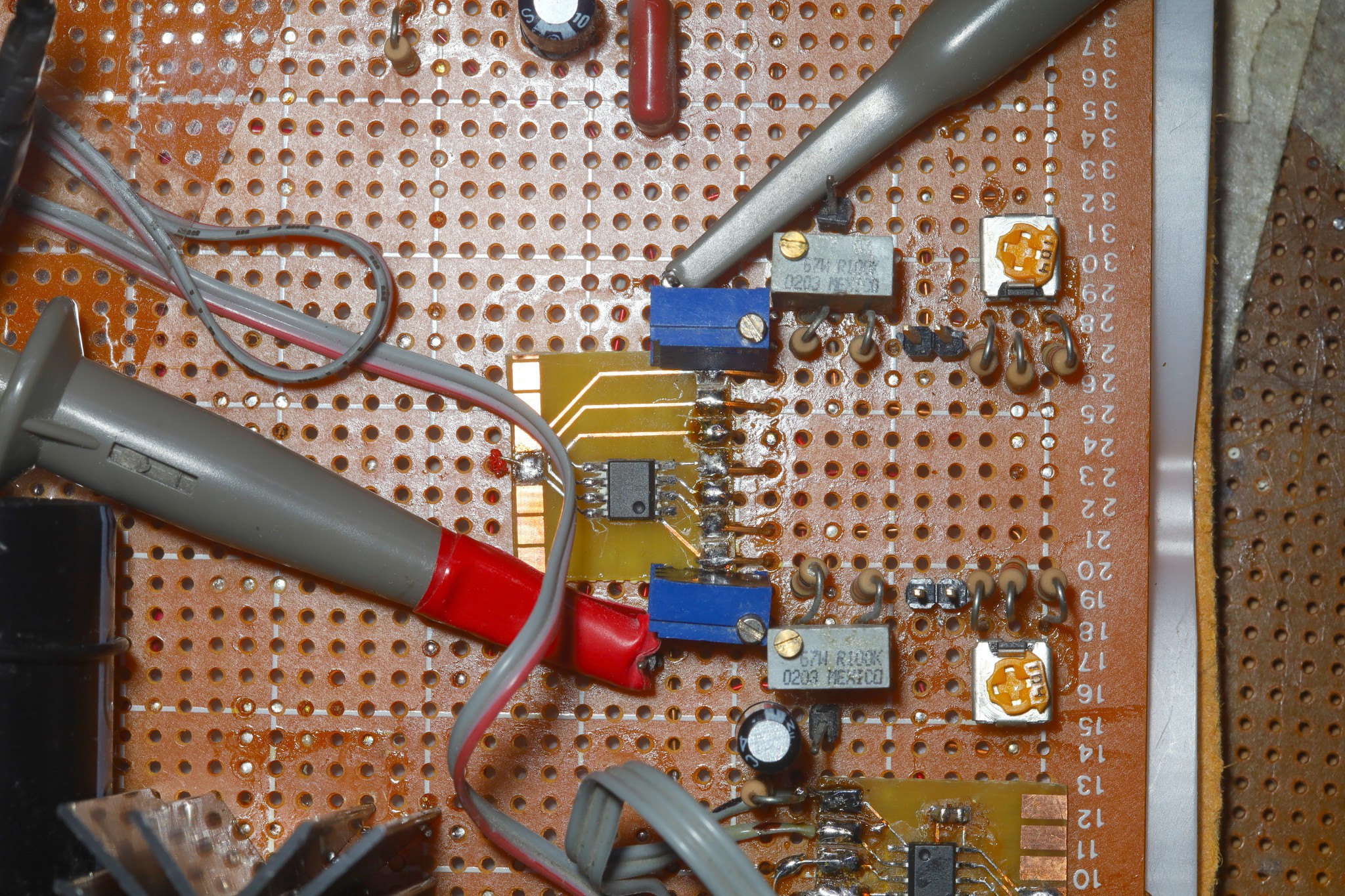

The Baxandall from Elliot sound projects worked much better than the EQ in the HTR-5230. Despite doubts, the decision was made to max out both treble & bass. Put in a single turn pot for the bass to make it easier, but left treble as a multiturn since it would never change.

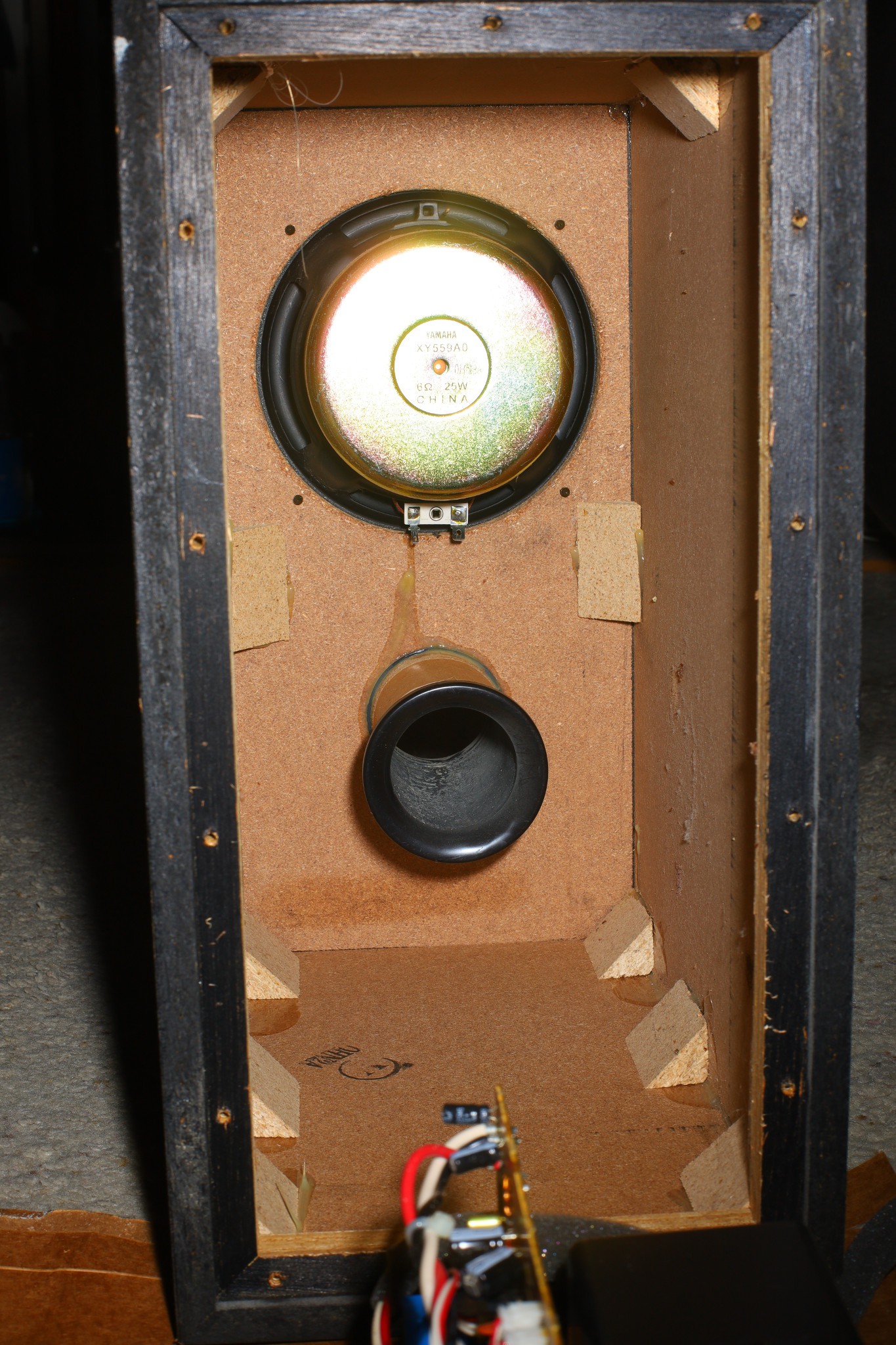

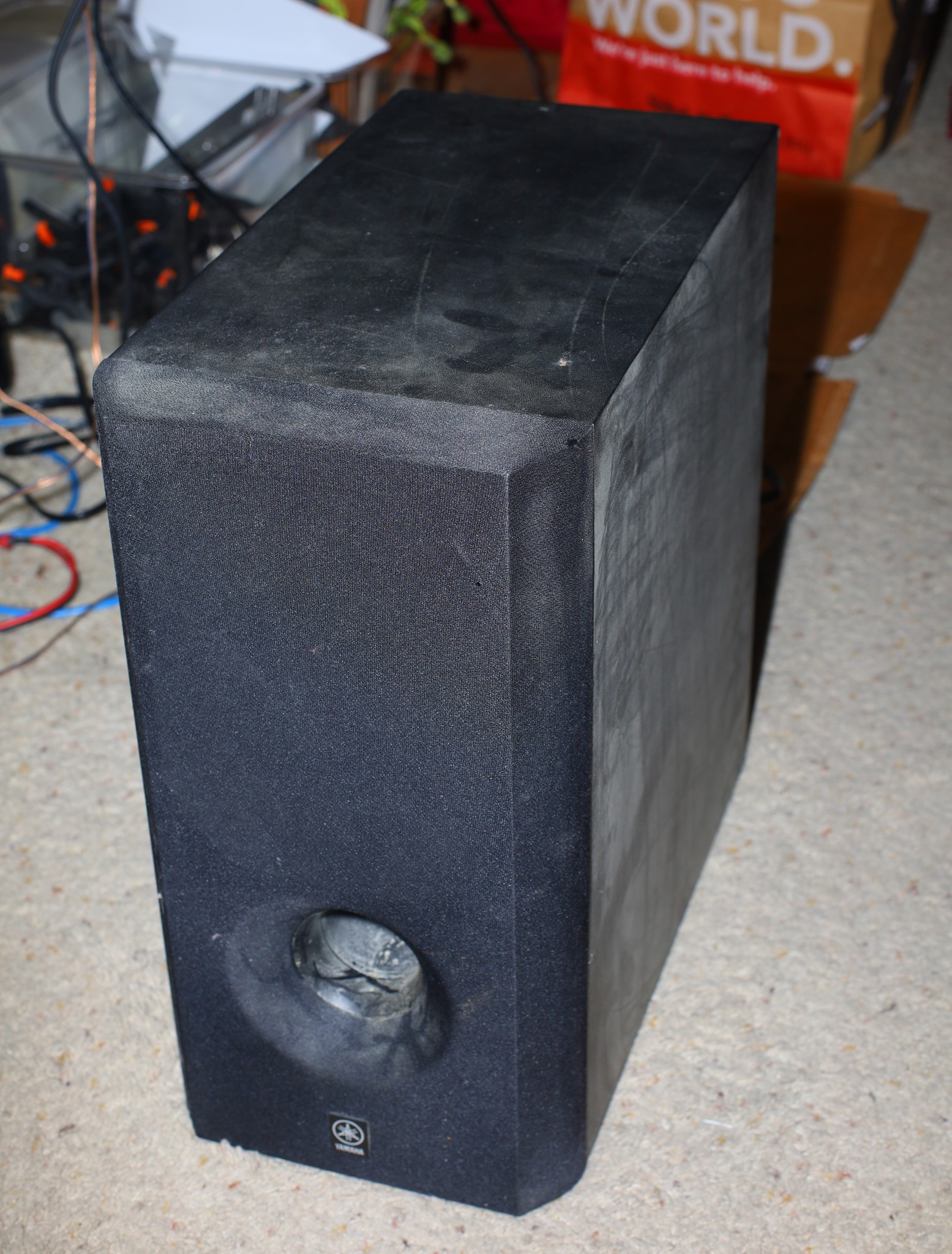

  • Subwoofer teardown
    lion mclionhead09/01/2026 at 22:50 0 comments

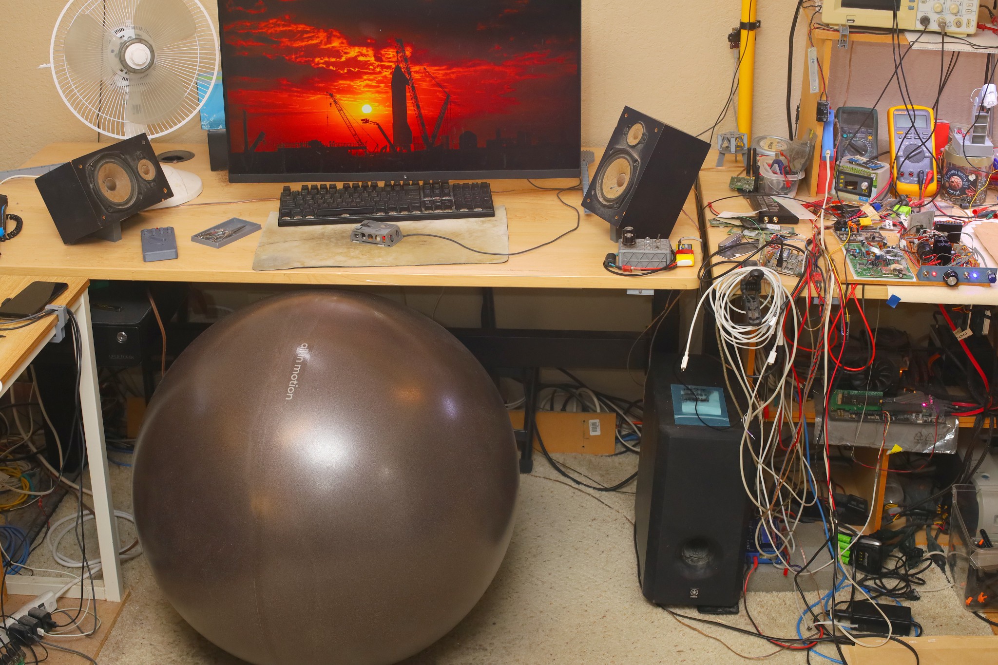

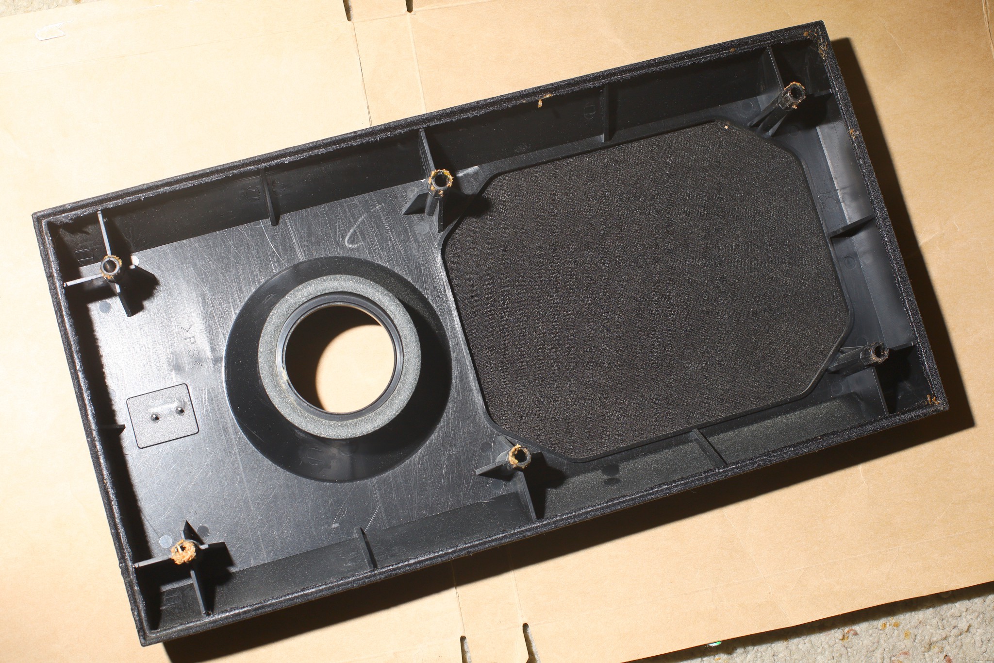

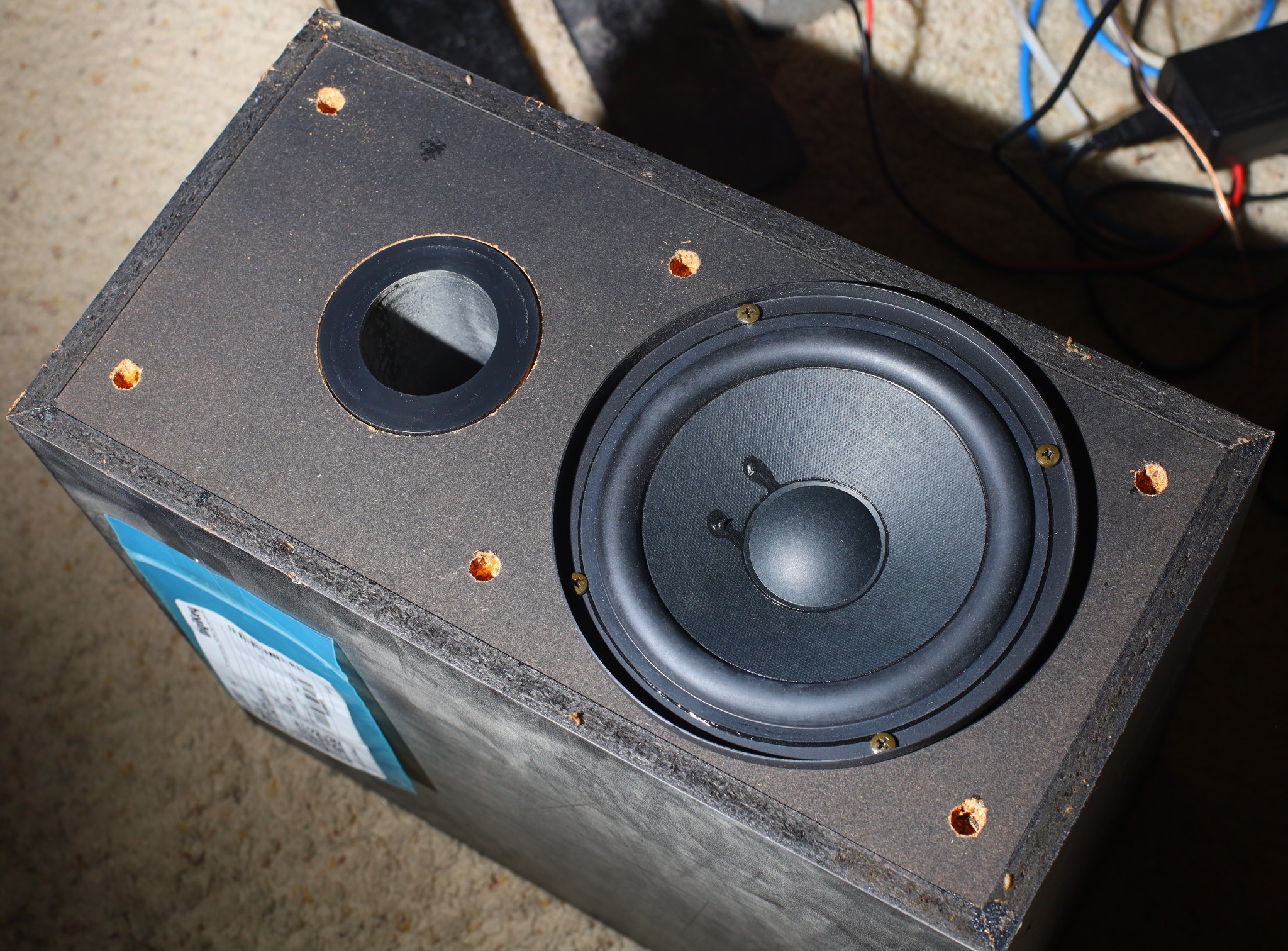

    Finally cracked the fabric off & recycled it, after 25 years.  It's just a 6" & the port is a cardboard tube.  To point up, it probably needs some protective screen.
    The very smallest desk sized subwoofers have 6" drivers nowadays.  Most have 10".  Lions once had a crappy desk subwoofer in a cube farm.  It didn't go very low.
    The old man's SB-L52's had a 10" woofer in each speaker.  You don't know what you have until it's gone but we didn't have any modern audio sources in those days either.   Music came manely from tape, radio, analog TV until 2011.  2019 brought a big leap in audio processing which further enhanced it.
    Besides loads of critters, the cover had solid, tapered sides so it didn't radiate as well as the uncovered speaker.
    Listening the hell out of the upgraded system, the subwoofer impact depends on the music.  Some music has a lot of it & some has none.  Some music requires more subwoofer gain & some requires less.  It generally makes the sound richer below 200Hz but its full thunder is outside normal music.  Someone has to sit down & play a bass line to make it go but constantly blasting tones at 40Hz causes ear fatigue.  It requires critical listening lions have rarely done since the 90's.  There isn't as much music which gets lions excited as there was 25 years ago.
    The subwoofer gain has gradually worked lower until it might be time to step down the feedback resistor.  The mane volume similarly needs to be stepped down more.  At the same time, the old man's SA-310 tuner & the HTR-5230 were rarely run over 1/4.  It seems to be a marketing tactic to tune the gains way up.
    The desk height affects the subwoofer gain.  It's kind of a return to the days before single band compression.  Multiband compression may be the end game.
    It's never going to be as loud as it was in childhood because lion ears can't take the loudness.  It never gets close to saturating the STA540.  It has intermittent interference, independent of volume level but dependent on speaker cable position.  The speaker cable itself seems to pick up something.  That might explain why subwoofers have integrated amplifiers.
    The next big problem is a permanent location for the amplifier.  It's going to be hard to reach on the bench.  The 10' fiber optic & the subwoofer cable make it difficult to place under the router.  It's going to entail spending.  It seems 2 TOSLINK cables can be joined with a 3D printed part, if you can find a cable locally.
    If lions still didn't use the space for exercise, as it was 25 years ago, there could easily be 2 rear speakers & a subwoofer behind the seat.  There's sort of a case for modular floor transporters which automatically reposition all the gear.  As bad as modern movies are & the housing situation is, there's a case for watching the good movies with a good sound system during the daytime, when no neighbors are around.

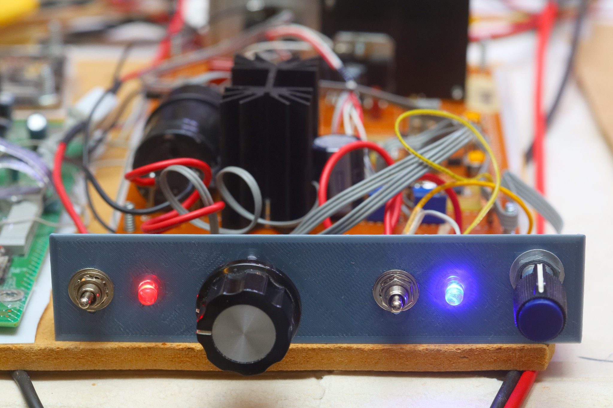

  • Front panel update
    lion mclionhead08/31/2026 at 23:56 0 comments

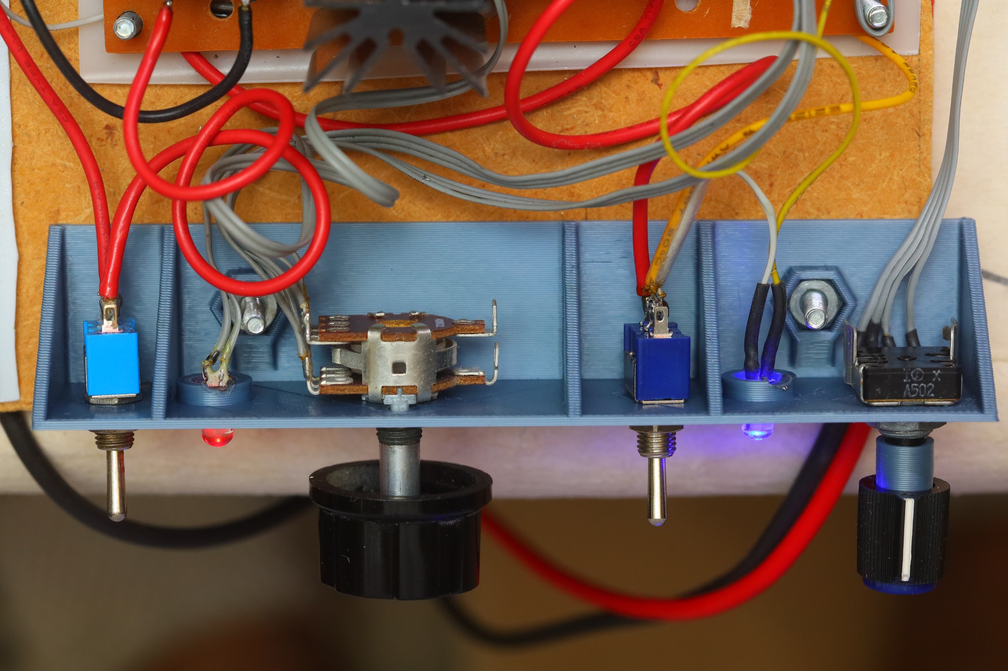

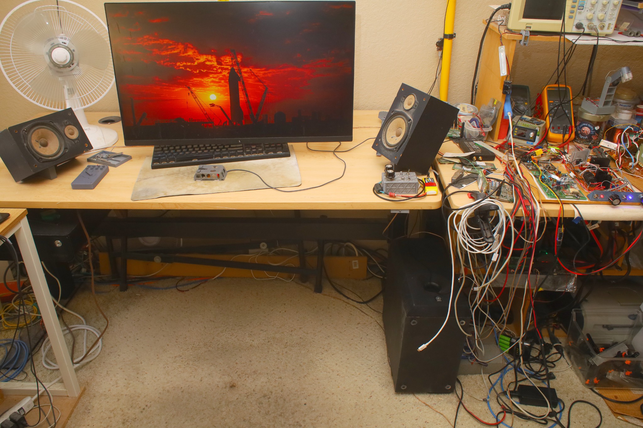

    Moved the subwoofer switch farther away from the mane volume to prevent accidents.  Welded the LEDs on & installed the captive nuts to make it final.  Subwoofer pot barely squeezed by the captive nut, with some bending.
    With the woofer pointing up at the desk & the gain stepped up to make 1/2 on the front panel the optimum level, it was a bit louder than the original HTR-5230.  It still vibrates the desk a lot more than it increases the loudness.  The compressor tends to disproportionately boost the bass.  It still all came from the right side.
    The apartment is officially out of 100k pots.  The last 2 single turn ones are rusted.  Remember when those were down the street in Radio Shack.
    With the EQ applied to the manes & the upward placement of the woofer, it definitely sounds better than it did 25 years ago, but not good enough to be a daily driver.  It takes a lot of space & has proven to not have any setting suitable for neighbors.  With the mane EQ, it's either blasting or it might as well not be on.  It may go down as a toy.  There's enough room to temporarily put it right behind the sitting position.
    There is a desire to play the organ album with it, during xmas season.
    There are better bookshelf speakers for a price.  The current ones were always piss poor.  Verified the tweeters actually do something.  They don't have any low end.
    Pondered scrapping the 25 year old subwoofer & putting its driver in a custom enclosure of smaller size.  The smaller version might fit on the desk, under the monitor.  The fabric on the Yamaha speakers can't be removed without destruction.
    New ones are just big enough for the driver but are super expensive compared to 25 years ago.  The HTR-5230 kit with all the speakers was $400.  New subwoofers start at $200.  A passive radiator for a custom enclosure could be under $50.

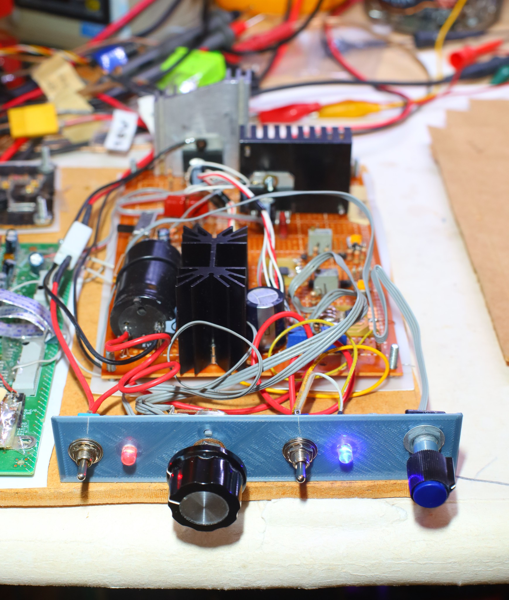

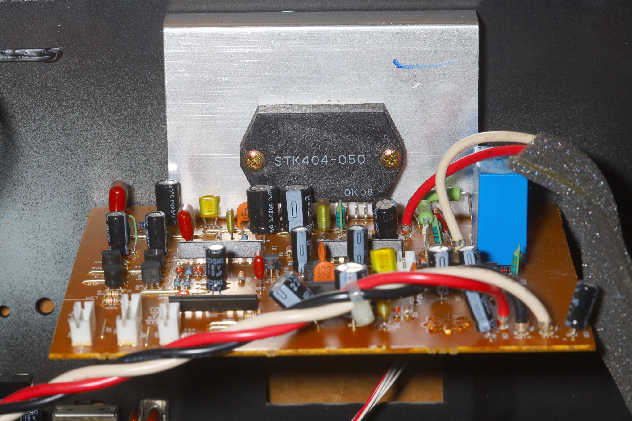

    After 2 weeks of snail mail, the 2nd STA540 went in.  Stepped up the feedback resistor to 20k.
    Positioned it for future heat sink expansion.
    The subwoofer power & volume are a lot more convenient than stock.  The PLA front panel no longer requires isolation or grounding.  It just needs some captive nuts.  The subwoofer pot needed an adapter to fit the improved knob.  It probably needs some indicators for a more stable position.
    Standby power went back to 7W.

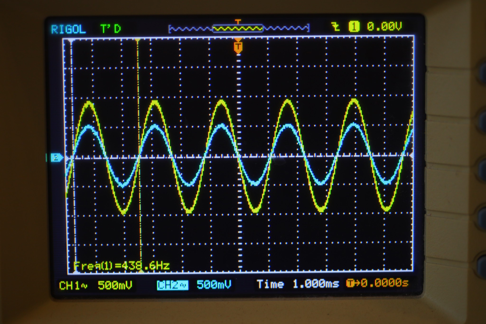

    The useful subwoofer range was only the top 1/4 on the front panel.  Stepped the feedback resistor up again to a 100k pot so it could be dialed into the mid range of the front panel.
    The STA540 had no problem powering test tones beyond useful levels but it seemed weak during music.  It was easier to feel the bass in the stability ball than hear it.  Recall the stock receiver having the same problem.
    1st, the manes are being driven harder in the low end than the stock amplifier.  2nd is the subwoofer's unfortunate position.  It was obstructed under a table before 2011 & now is in front of the manes.  The only space has it pointing away from the lion.  A working system would entail sitting far away from the monitor.
    Tried pointing the woofer up, which slightly improved things.

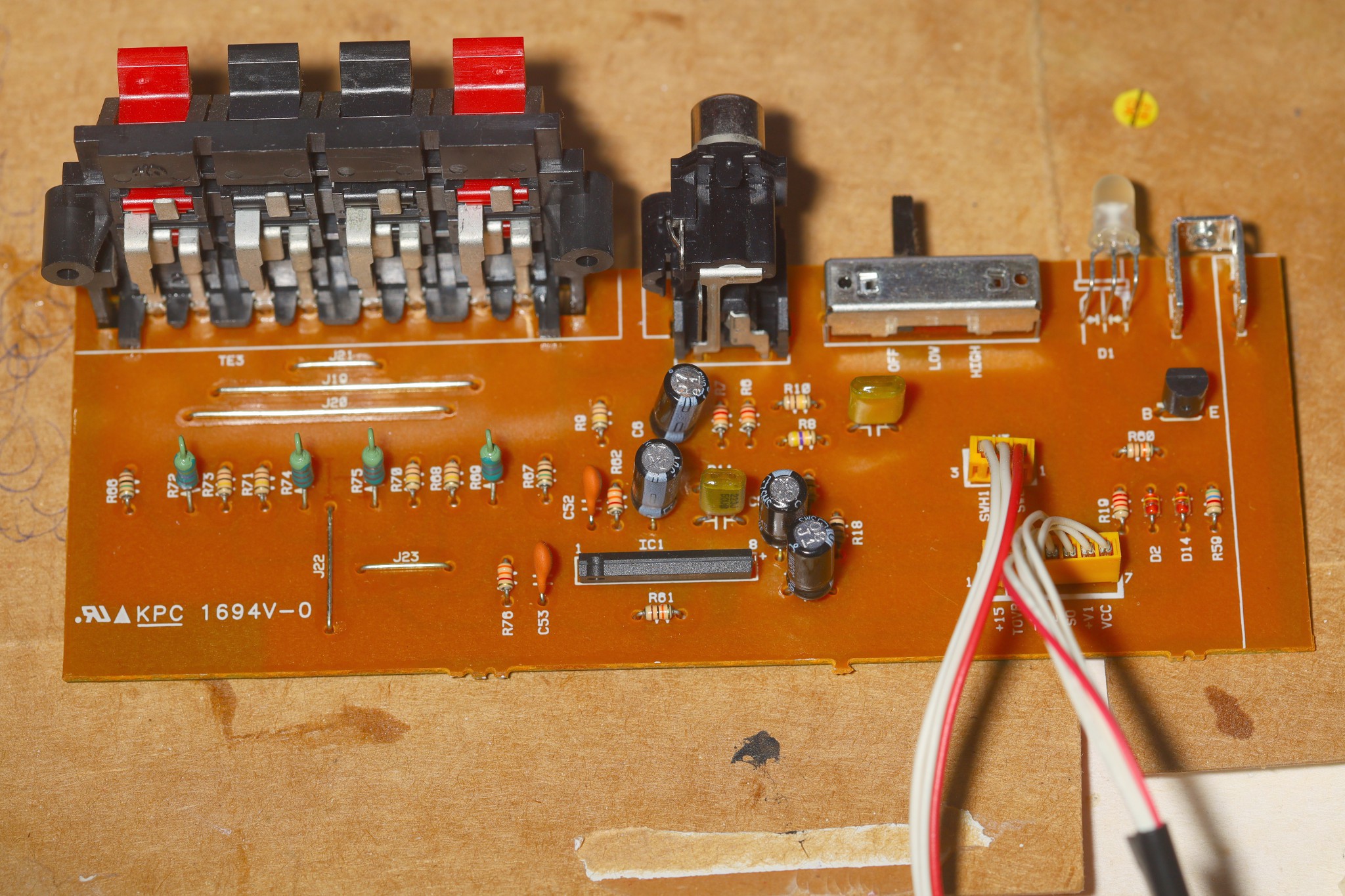

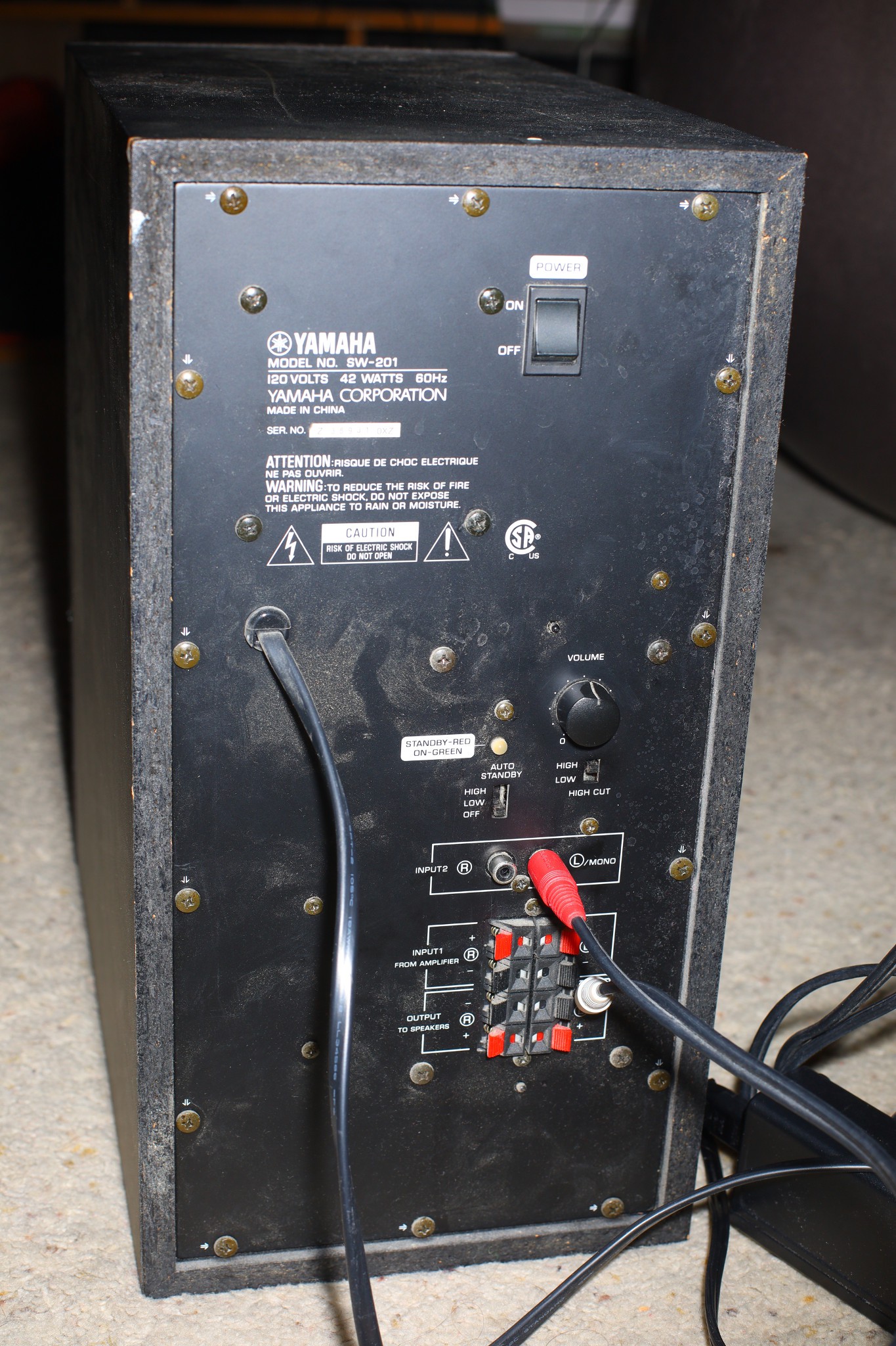

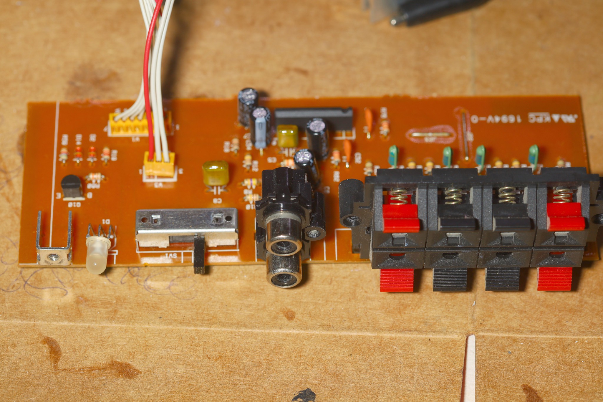

    Turned the power cable into a speaker connection & the active subwoofer became a passive subwoofer.  There was no way to extract the power switch without destroying it.

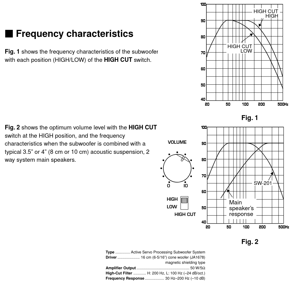

    The SW-201 manual had the original cutoff frequencies.  It had an active lowpass filter while the "active servo advanced negative impedance" amplifier blocked DC.  It had an optimum volume level which lions never used.  The high cut was intended to merge it with the manes. What lions remember was a large gap between the manes & the subwoofer which distinguished it from the 3 ways of childhood.
    The woofer is not the way to truly get back the sound of childhood.  Better manes than these recycled ones might do the job, but the sound of childhood never was as good as what lions remember.  The childhood speakers were in odd, off center positions, playing non ideal tapes & radio stations.  It wasn't worth the hassle so the parents usually ran the TV speakers instead of the audiophile speakers.  They only briefly ran the audiophile speakers loud in 1983, playing xmas organ music.

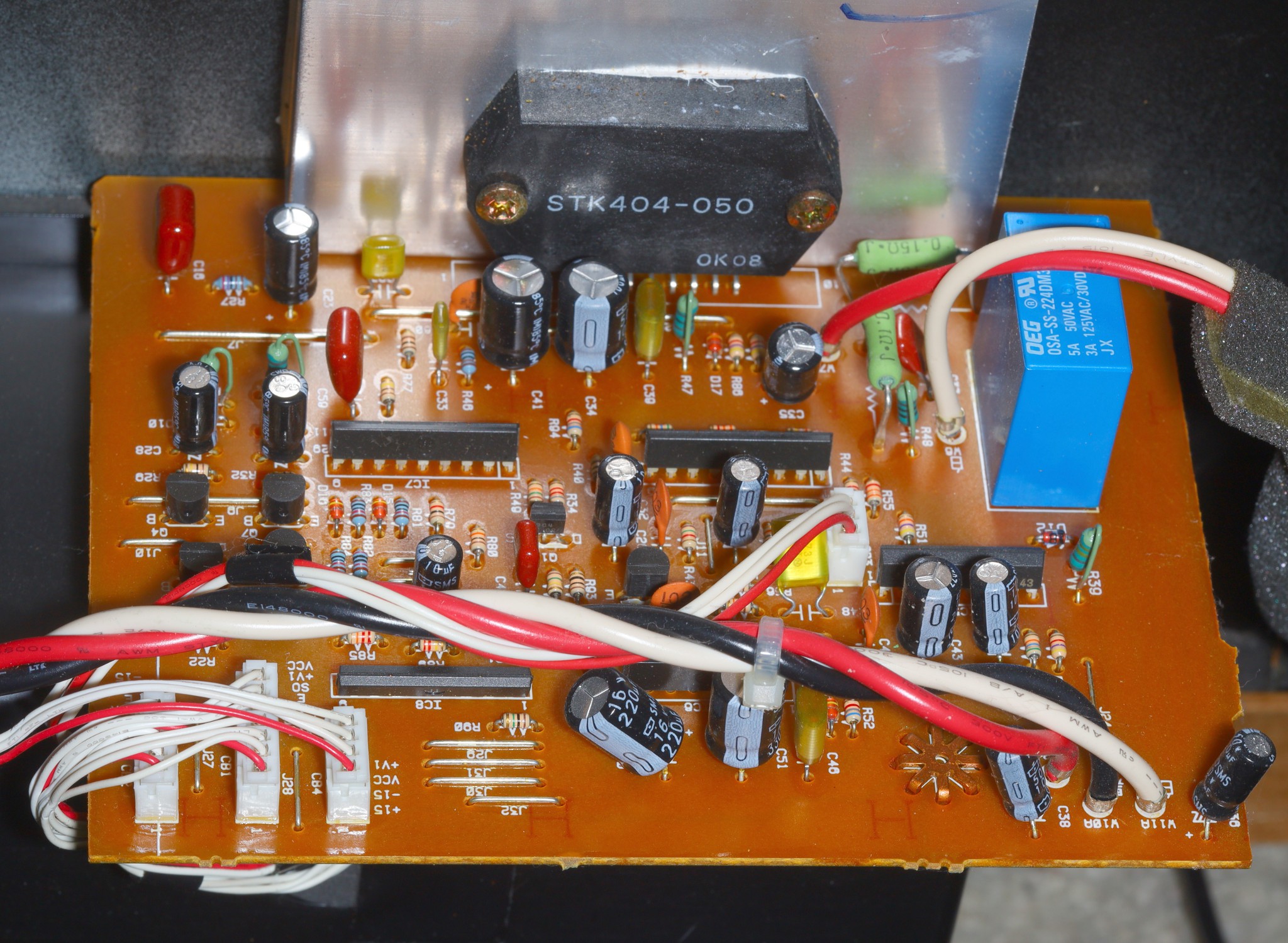

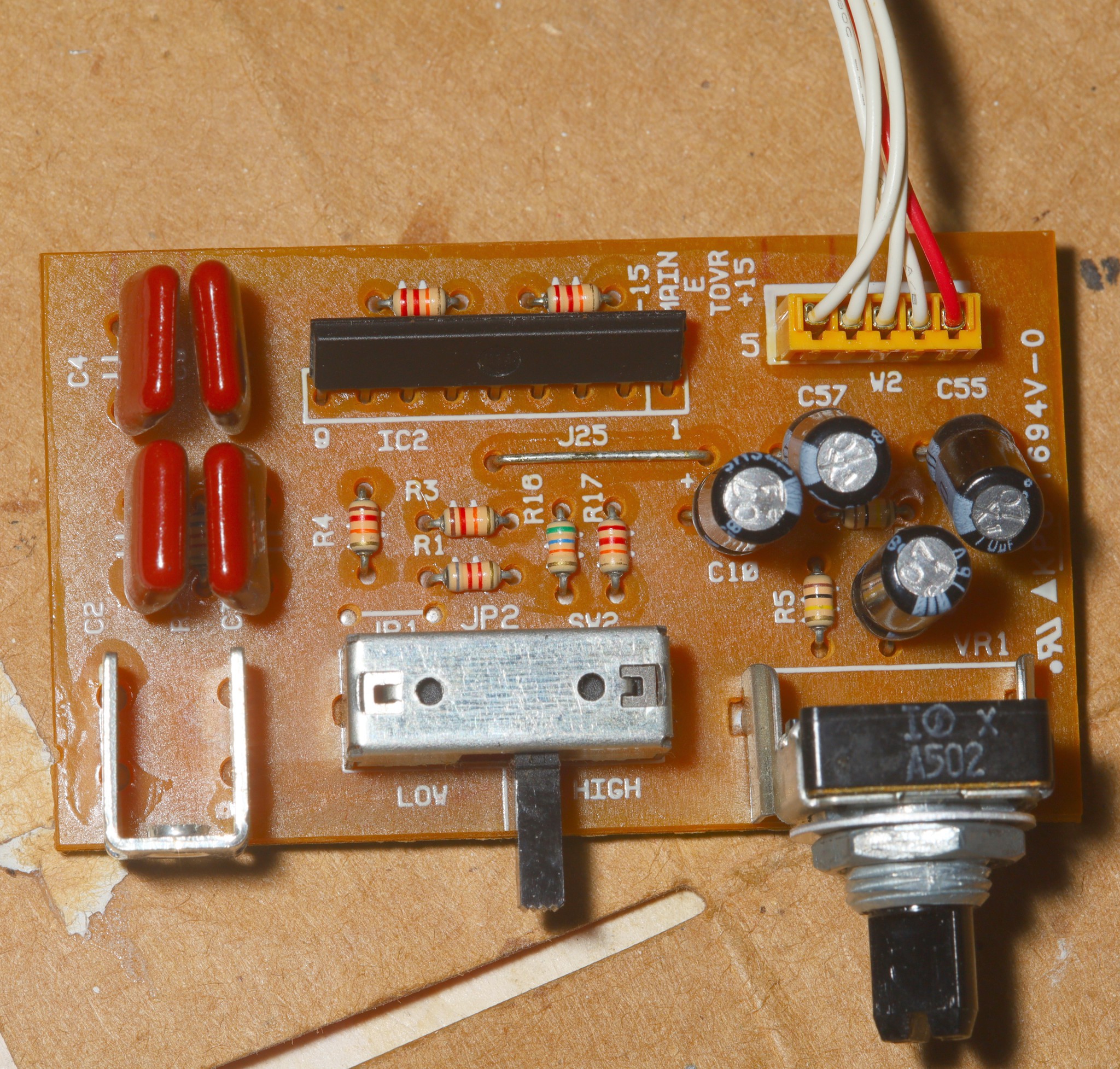

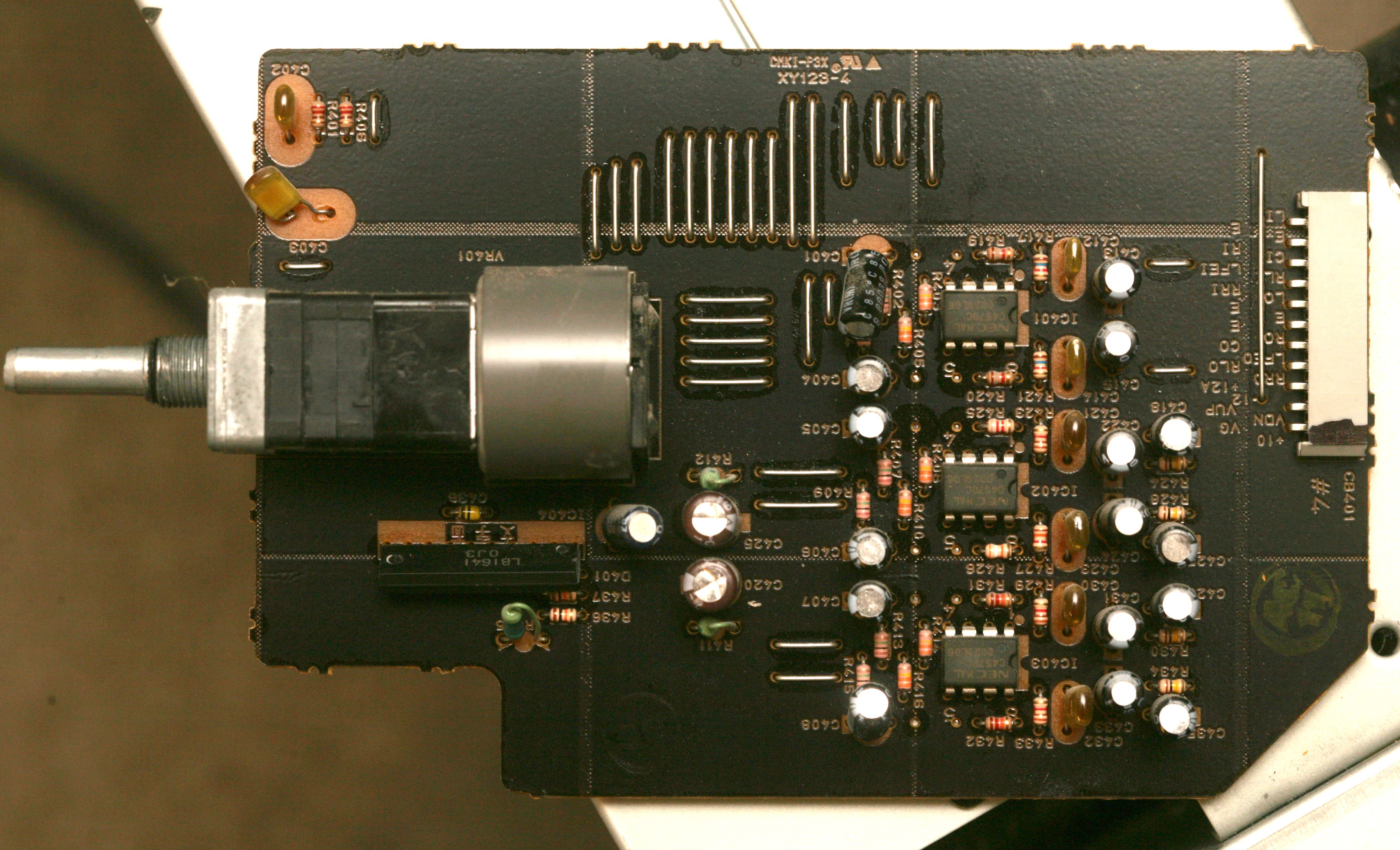

    Started inspecting the SW-201 for parts which could be used for a lowpass filter.
    This board just buffered up input from the many choices & had the auto standby selector.
    This one just had the "advanced negative impedance" power amplifier.  Lions already give negative impedance.  The STK404 requires a boat load of passives & a true negative rail.

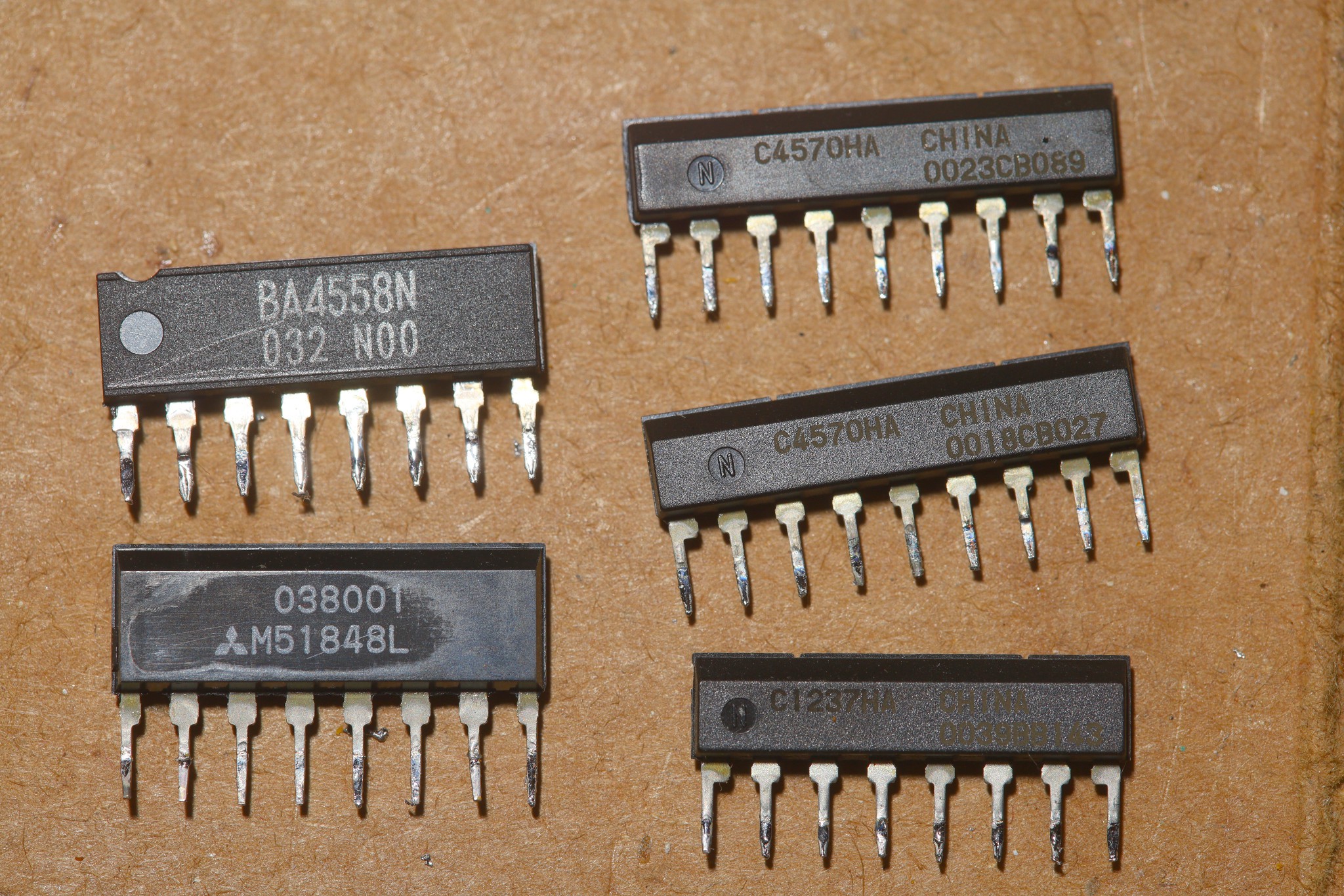

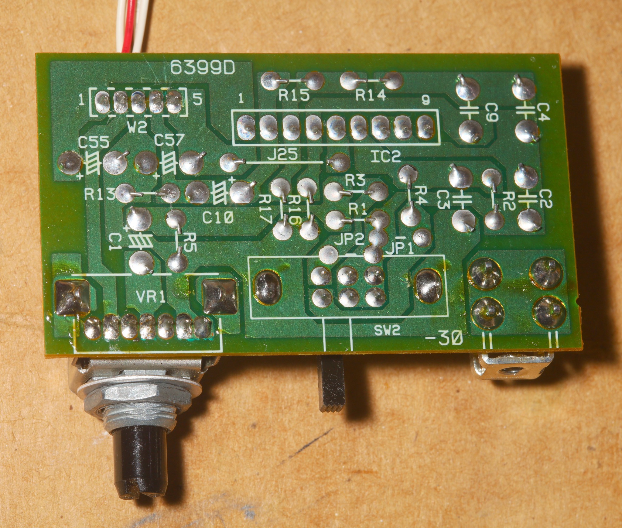

    The lowpass filter was entirely a standalone circuit on the volume control board.  MAIN was the output. TOVR was the input.  It accepts +15, +5, & GND in place of +15, E, & -15.  It's a low impedance input so it needs a buffer of its own.  It's non inverting while the EQ is inverting.  Its buffer needs to invert to get the same speaker polarity.  Not very optimistic about that 25 year old, 5k pot's longevity.
    The woofer yielded some BA4558 1V/us & C4570HA 7V/us  op amps.  Helas, the mighty LF353 does 13V/us but these are the best through hole op-amps in the apartment.  C1237 is an overload protection.  M51848 is a timer, probably for the standby mode.
    The volume output was stepped up from +/- .5V to over +/- 1V to give more juice to the subwoofer but any more juice above +/- 1V made the EQ audibly clip.  The volume probably needs to stay below +/- .5V & the subwoofer probably needs more gain.  A scavenged C4570HA from the subwoofer provided a 2nd gain stage, in addition to buffering it.

    Baxandall EQ has a low impedance input & low impedance output so it has to run at line level.  Its output has to be divided down to amplifer input level.

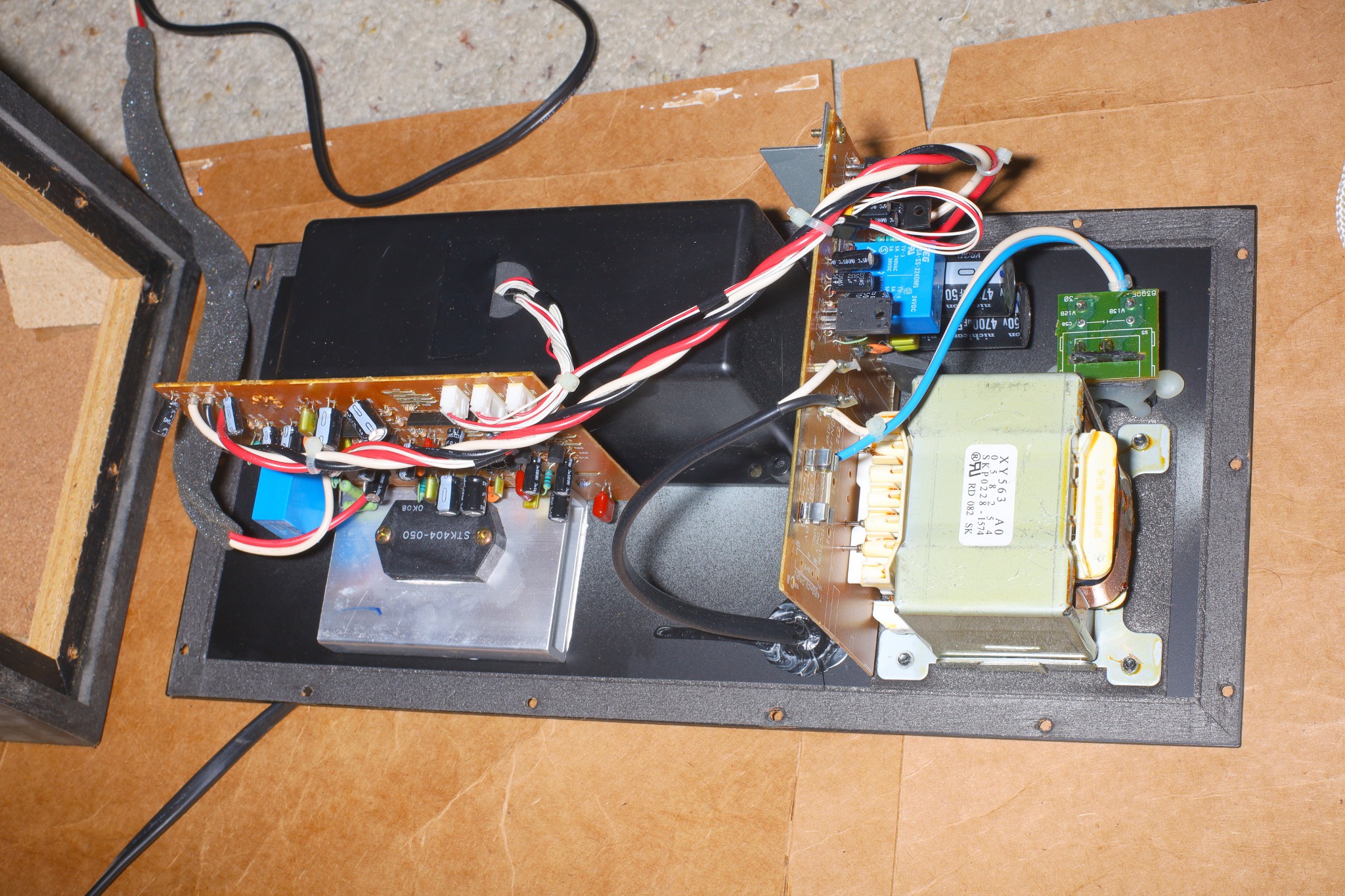

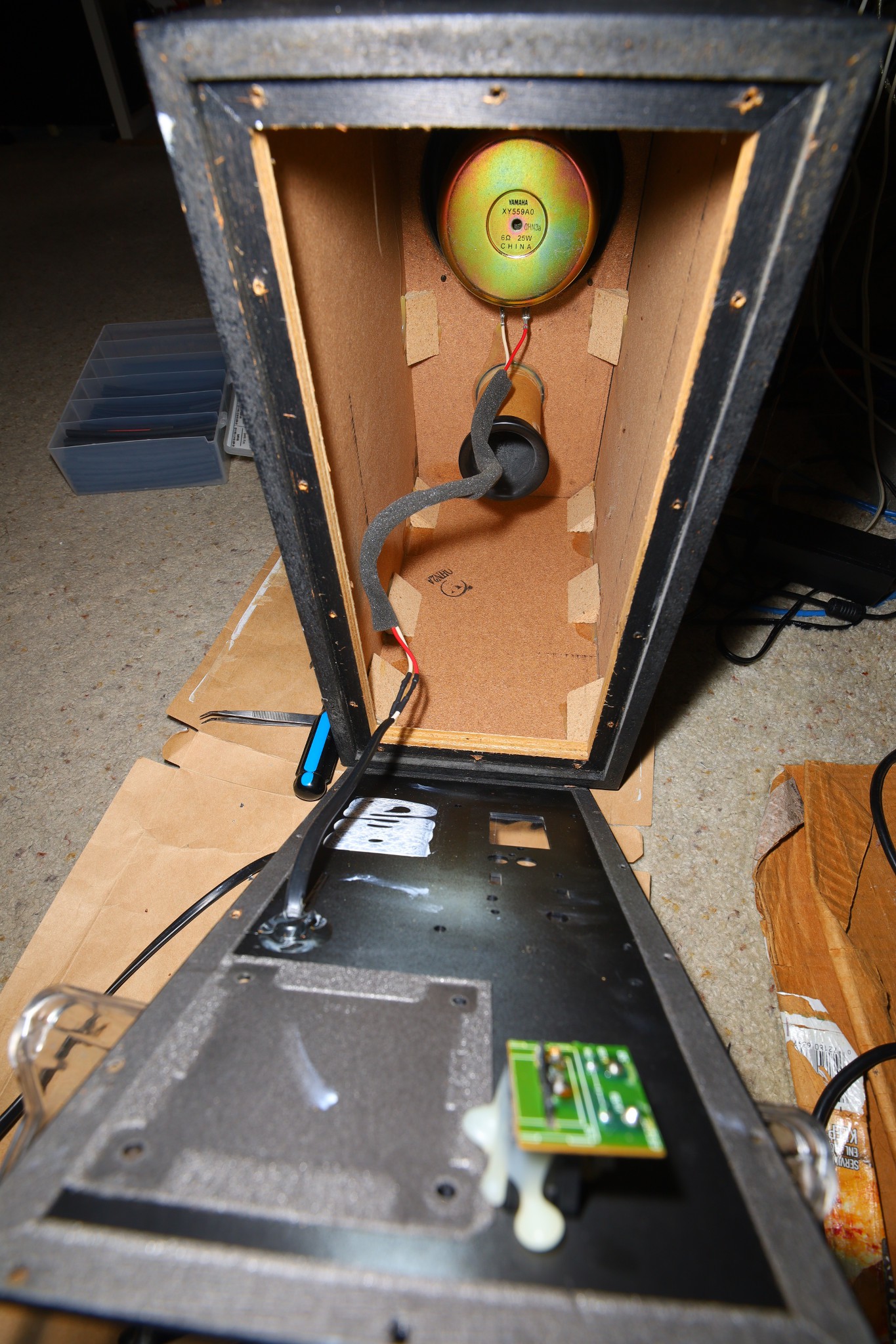

    Firing up the subwoofer after 15 years, it had a nasty AC hum.  It has its own facility for mixing down stereo input.  It might need a lower impedance signal than a blocking cap.  The subwoofer is isolated so it could be floated to virtual GND.  Helas, that did nothing.  The AC hum tends to start random times after it's powered up, pointing to a dead cap or broken solder joint.  Power cycling it or whacking it makes it go away for a certain amount of time.  When it works, it makes lions wish they had the $4M for a detached house, $600k when the speaker was new.
    The worst case is another STA540 directly powering the subwoofer with a lowpass filter.
    In the interest of only passive networks, adjusting subwoofer gain entails generating a sine wave in the flat 1khz EQ range, viewing the manes & subwoofer output of both channels on the scope, adjusting 1 channel at a time so the manes match & are a fraction of the subwoofer stage.   The subwoofer itself has another pot for field adjustment.
    A painful teardown of the subwoofer revealed relays, over stretched ribbon cables, chip amplifier, & lots of spider webs.  These are typically perishable parts.  The easiest next step would be a dedicated STA540, lowpass filter, dedicated volume pot for the subwoofer.  A speaker wire would go to the existing cabinet.  The idea is to have easily replaced parts.  The front panel would need another pot & switch.  Basically, the whole thing would be rebuilt.

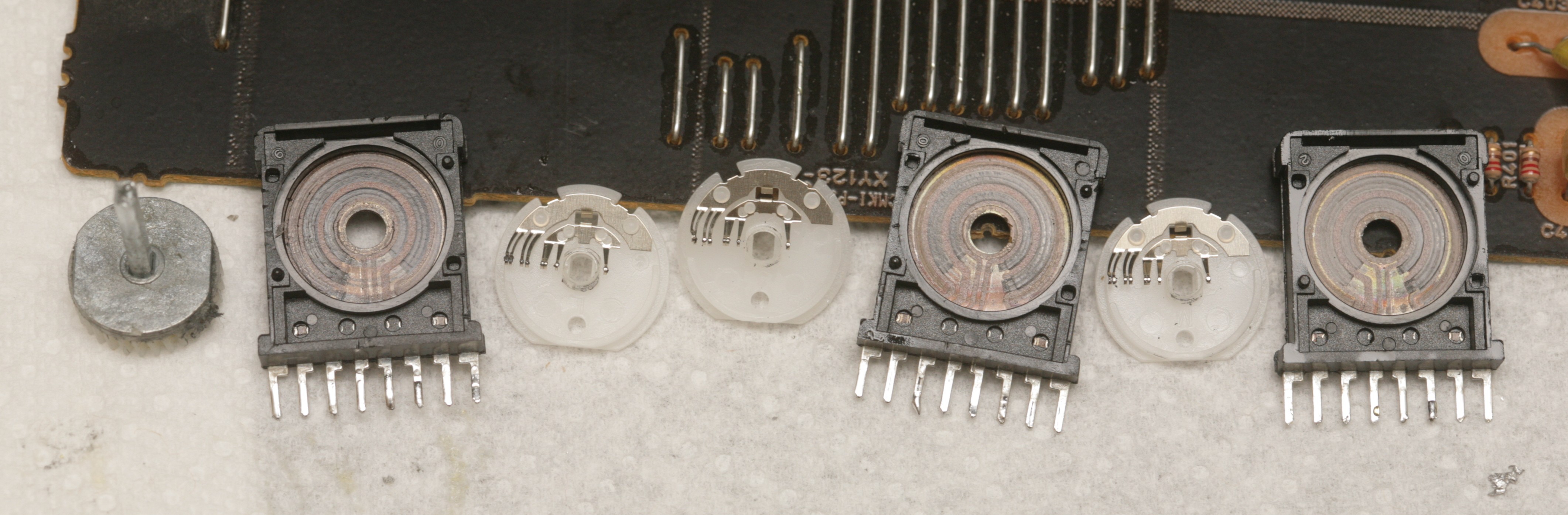

      The original HTR-5230 had separate volume pots for all 6 channels inside the volume control.  It was documented in June 2014.
    Each layer of a 3 layer pancake had a stereo pot.
    Each pot was a feedback resistor in a non inverting op amp.  Modern volume controls use a VCA.

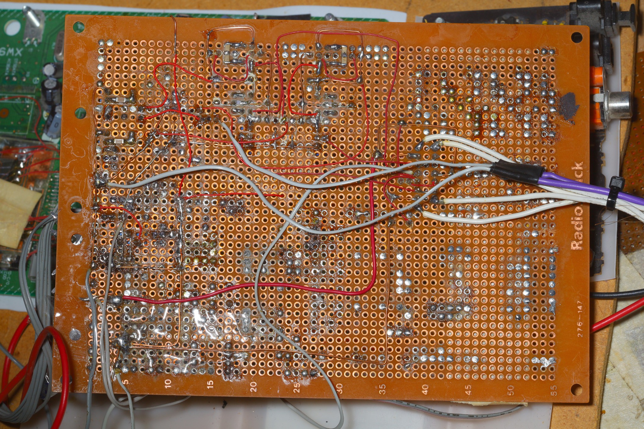

    A jumper from GND to the switch panel ended up killing all the noise.  It didn't stop the growing number of spontaneous power downs.  The panel seemed to be an antenna.  If it wasn't metal, the volume control might need a ground.  The apartment gained a house 12V power supply which would greatly simplify the amplifier.  The tricky part is the wiring from the amplifier to the apartment 12V.
