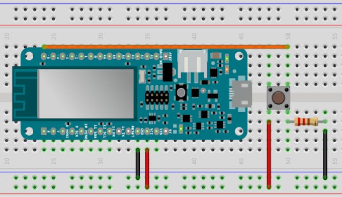

Arduino MKR1000 w/ header pins, push button,
female-male jumpers, resistor LiPo battery, breadboard
The battery is of course optional and the resistor can be of any value really. We're just using it to pull down one of the push button pins to ground. The small push button will have 4 pins that are organized into two pairs. You'll want to bridge the gap in the breadboard by placing the button so that the longer gap between pins is utilized to span the space between the two sides of the breadboard.

Time to wire up the breadboard like so...
Fritzing Breadboard ViewAny digital I/O pin will do for the pushbutton. Just remember to set
const int dashButton = 14; //DIO number of the pushbutton pinto whichever pin you end up choosing. I've used jumper cables and a smaller breadboard so my final configuration looks like this...
Breadboard Arduino Dash ButtonIf you feel like making this a bit more portable you can grab a prototype board, and a header plug to create a sort of push button shield for the MKR1000.
