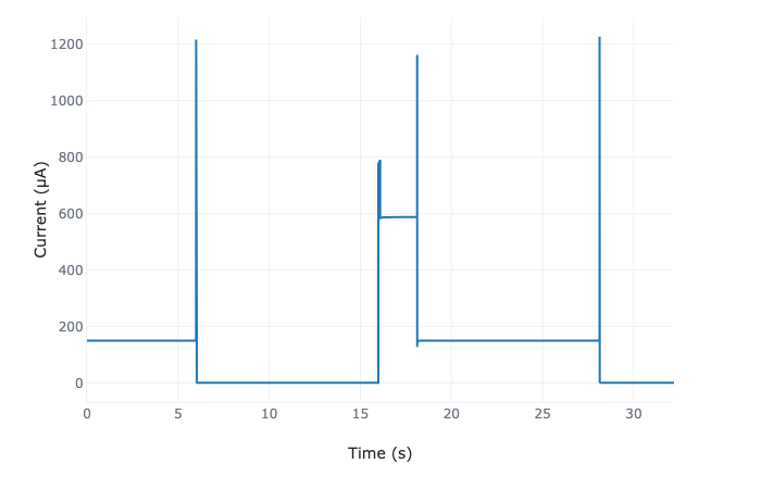

The firmware for Nanosleeper is pretty simple. It is just meant to be a "Hello World" program for customers, and to provide a working example of sub-100nA deep sleep. The hardware is first configured. Then, two LEDs are turned on for 100ms, then back off. Then, the CPU busy-waits for 2 seconds. The external RTC (that will provide the wakeup in 10s) is initialized, and then the MCU enters STOP0 mode. It will be woken up by an interrupt from the RTC in 10s.
After the wakeup from STOP0 mode, the RTC is initialized for another 10s wakeup cycle, and the MCU enters shutdown mode, where its consumption drops to 10s of nA. Wakeup from shutdown mode is effectively a POR, so the whole program starts over again.

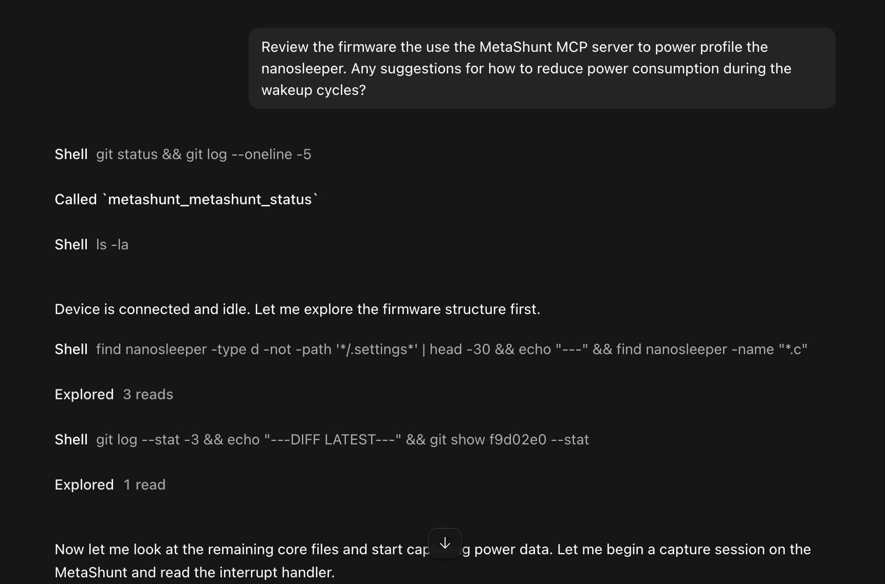

You may then think that using the LLM to power profile this system is complicated and you need to be an uber-engineer. In fact, the opposite is true. I simply asked the LLM in simple language (and with a typo, oops!) to review the firmware, use the MetaShunt MCP server to power profiler, and to make recommendations. That's it! Believe it or not, but this was the very first attempt at connecting a project to the MetaShunt MCP, after the model already one-shot developed the MCP server. Wow. You can see that it immediately finds the tool, determines it is connected, and starts getting data.

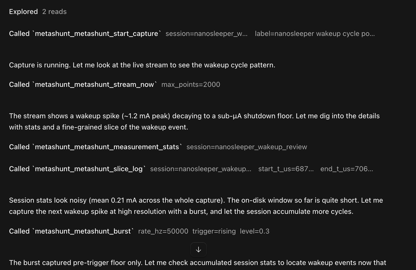

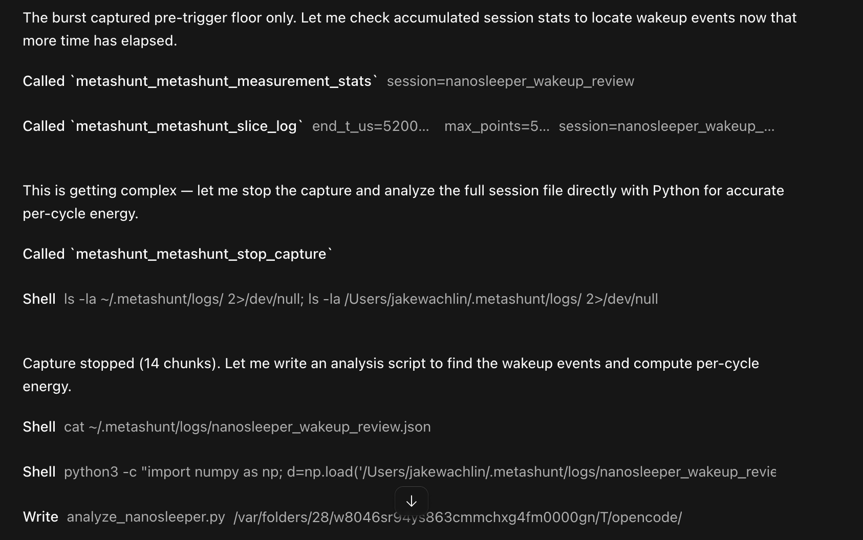

It quickly detects what the current profile looks like, and starts using the tools to slice up the data. It determines it wants some measurements at higher frequency for the wakeup cycle (rising through 0.3uA).

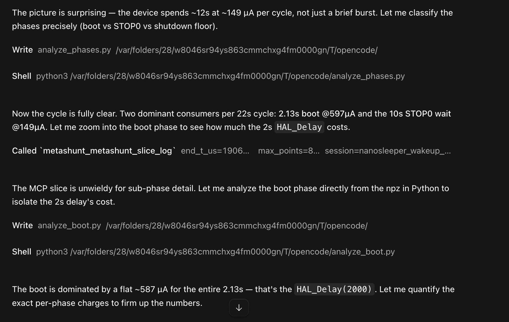

It then writes a Python script to analyze the measured data and compute per-cycle energy use.

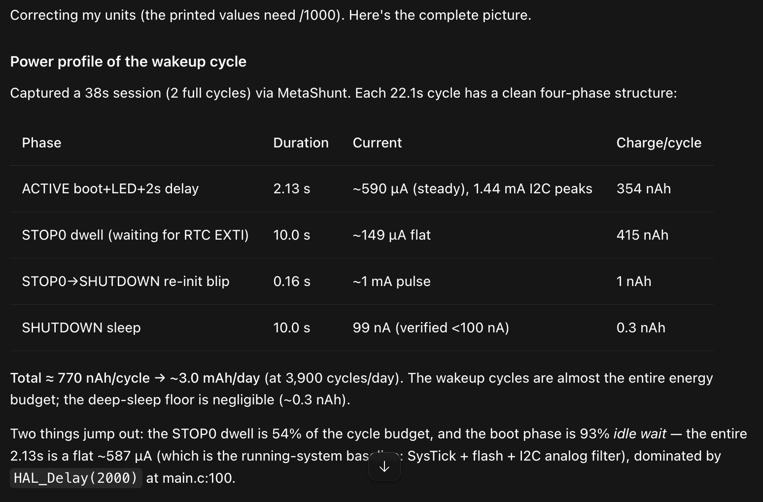

It identifies the section where the system is in STOP0 mode, and then starts breaking the power profile down compared to the firmware.
Now it has it - it correctly identifies the sections, their time, their current levels (even confirming <100nA average sleep for Nanosleeper in the process), and starts identifying improvements.

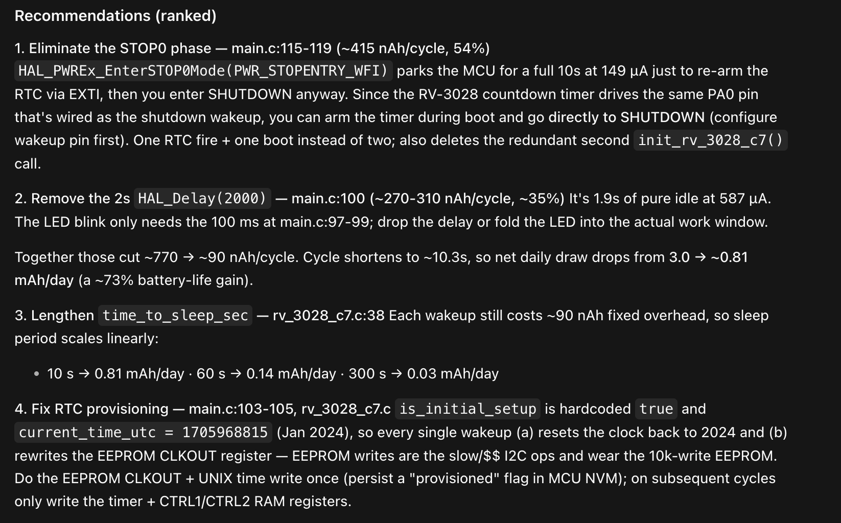

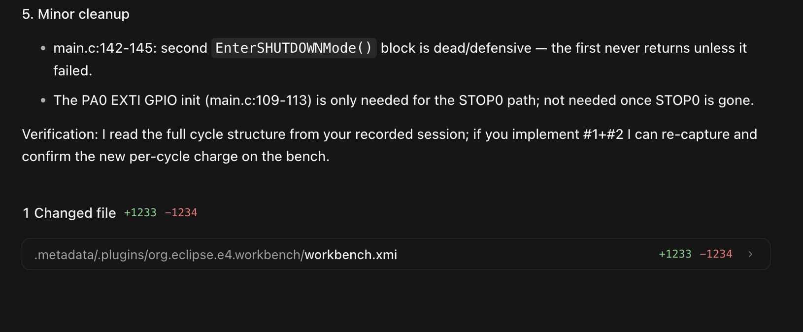

Finally, it provides specific recommendations for how to reduce power consumption. Since this is a demo program, I don't actually want to remove the idle times or STOP0 phase, but you can see how this would immediately provide recommendations that the model could then implement and re-test.

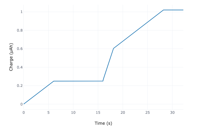

For your reference, the profile looks like the image below. You can easily identify each section that it identified, and where they match up to the code. When I zoomed in and picked out how much charge each cycle required, I got 770nAh exactly - spot on for what it identified.
