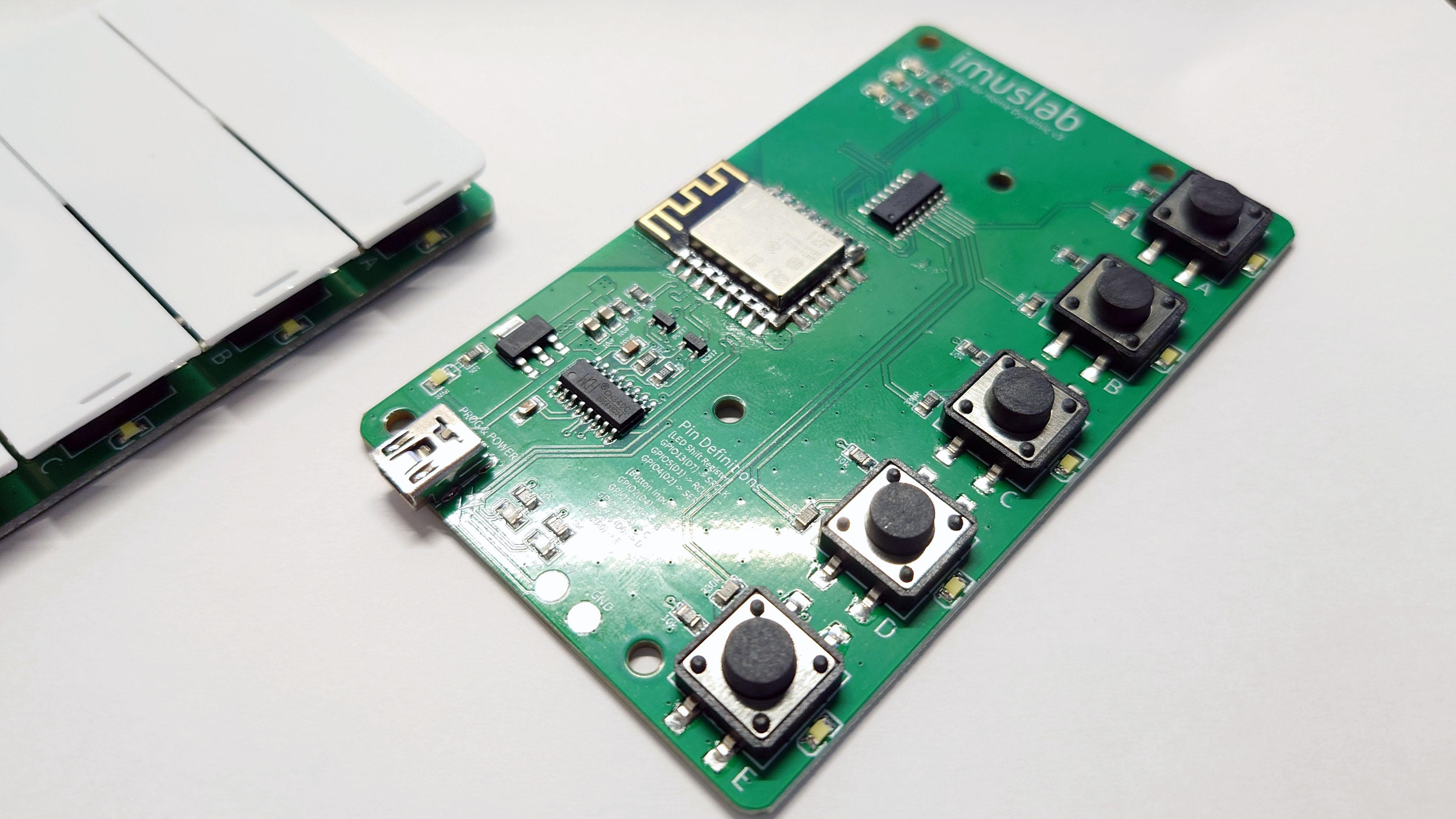

As I am designing this board with parts that is available on most of the PCB manufacturer, you just need the followings to make your own
- A computer with Arduino IDE (with ESP8266 installed in the board manager)
- A PCBA manufacturer like NextPCB to manufacture the switch for you
- A 3D Printer
- Soldering iron (if you plan to build it yourself)
- SMD components (See the attached diagram)
- 4 x M3 x 5 screws
- The other things you want to control which accept RESTFUL API (e.g. the relay module I am using, I will show you in later steps)
2Send the Switch PCB to Print
If you are good at soldering, you can print the PCB using any PCB manufacturer you like. However, as I am busy renovating my room, I don't have time to work on SMT soldering. Recently NextPCB approach me and ask if I am interested to accept a sponsorship from them and try their services. So I ask them if they could make the switch for me with their PCBA service.
The PCB gerber files can be found on my Git server over here.
https://git.imuslab.com/TC/HomeDynamicv3/src/master/hardware/hds_5-way-switch/pcb
Why NextPCB?
I personally do recommend their service as they do really have a great team of engineer to handle problems for you. If you are first time PCB maker and want to try all sorts of interesting design while making sure it is possible to produce, you can ask their engineer directly and they will give you recommendations on how to make it cheaper like sourcing alternative parts from China or how to pick another chip so it is generally faster to build.
They also help me to get this UR Mark that is really helpful if you are building commercial products.
Manufacturing
I ordered 5 pieces for my room which should be able to cover all my room's lighting and automation devices. After the boards arrive, you can start the 3D printing process and programming!
33D Printing & Installing Switch Panel
The step is quite straight forward. I designed a flexible PLA pieces that can be screw on top of the PCB to act as a front cover while provide enough flexibility so you can press the pieces and activate the SMD button below.
There are also tiny holes next to each of the switch so you can know if the press is registered or not. You can also program them to show the status of the device being controlled.

6Quick Test
After everything is done and firmware has been flashed, give it a quick test by powering both device. If both device are working, you shd see the switching motions of the device is pretty much instant with little to no delay as all communication are done within the same local area network.
7Installation & Deploy
There are two pads on the bottom of the PCB here where you can power it either via the micro USB port or the pads. I personally don't mind using the mini USB port as I am planning to stick it under the table, but if you are embedding it into your table or wall, you can also use those two pads for powering.
If you want to go truly wireless, you can even attach a thin power bank at the back and cut a USB A cable for power. The method of powering it is up to you :)
