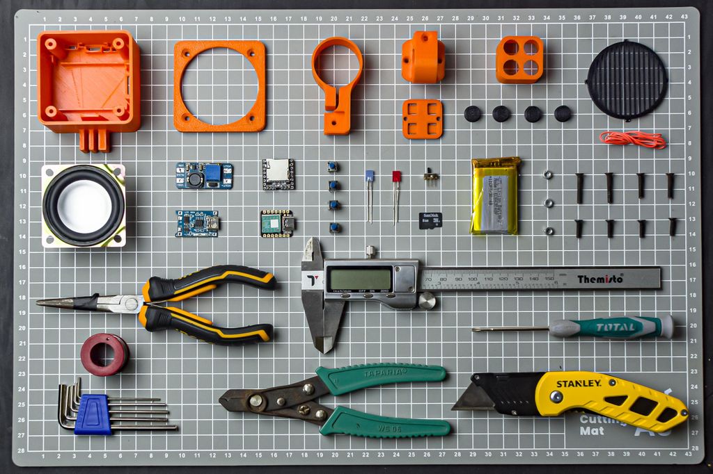

Supplies
components
- 1*2 inch 4 ohm 3w speaker
- 1*Mini slide switch.
- 1*3.7v 1200mah battery (all batteries blow 30mm*48mm is supported in this design)
- 1*Red Rectangle flat LED 5*2mm (find the diffused LED on the drop-down menu)
- 1*Blue Rectangle flat LED 5*2mm(find the diffused LED on the drop-down menu)
- 1*TP 4056 battery charger USB C
- 1*DC-DC Step-Up Converter MT3608
- 1*MP3-TF-16P(DFPlayer Mini)(always comes with header pin pre-soldered so remove header pins)
- 1*Seeed Studio XIAO SAMD21
- 1*Micro-SD card(Here I am using an 8GB Micro-SD it is overkill, you can go with the lower capacity)
- 4*6mm x 6mm x 9mm Micro switch push button ( select the height of 9mm)
- 3*M3 20mm CSK screw ( select length from the dropdown)
- 4*M3 12mm CSK screw( select length from the dropdown)
- 2*M3 16mmCSK screw( select length from the dropdown)
- 3*M3 Nuts(select length from the dropdown)
- 5-core wire 4mm OD x 500mm length (I am repurposing my old USB cable for this it is a fast-charging cable with 6 cores )
Tools
- Soldering iron
- Allen key set
- Nose plier
- Glue gun
- Wire cutter/wire stripper
- Heat shrink tube
- Multimeter
- Zip Ties (black)
- 3d printer ( 3d printing service )
