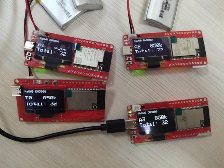

Well, in practical application, the most problem of UWB is the signal mutual conflicts/interference, that when there multiple anchor& tags exists.
And now, Makerfabs latest MaUWB module solves this problem by integrating an STM32 controller running default firmware, and MaUWB arrange up to 500m, support 8 anchor/32 tags, suitable for applications such as indoor position/robot tracking...
  • 4 × MaUWB_DW3000 with STM32 AT Command Note at least four modules for positioning, three for Anchor and one for tag.
  • Step 2: How to Use UWB Positioning
    Makerfabs12/27/2023 at 08:04 0 comments
    1.No python environment required
    • Use Type-C USB cable to connect the A0 and PC.
    • Power other devices with 3.7V lithium batteries,and adjust the positions of A1, A2 and A3 so that they form a square of 10 metres with A0.
    • Open position.exe, and you can see the red dots on the canvas move according to your position.

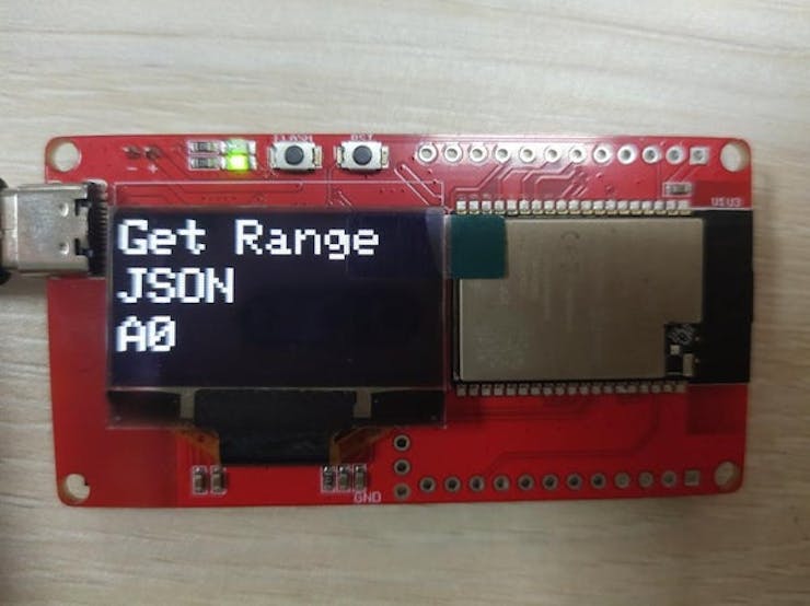

    1.Configure Anchor0
    • Open the get_range.ino by Arduino IDE. This program parses the AT instructions into JSON format and uploads them through the serial port.
    • Use Type-C USB cable to connect the board and PC, and select the development board "ESP32 Dev Module" and the port.
    • Verify the code and upload.
