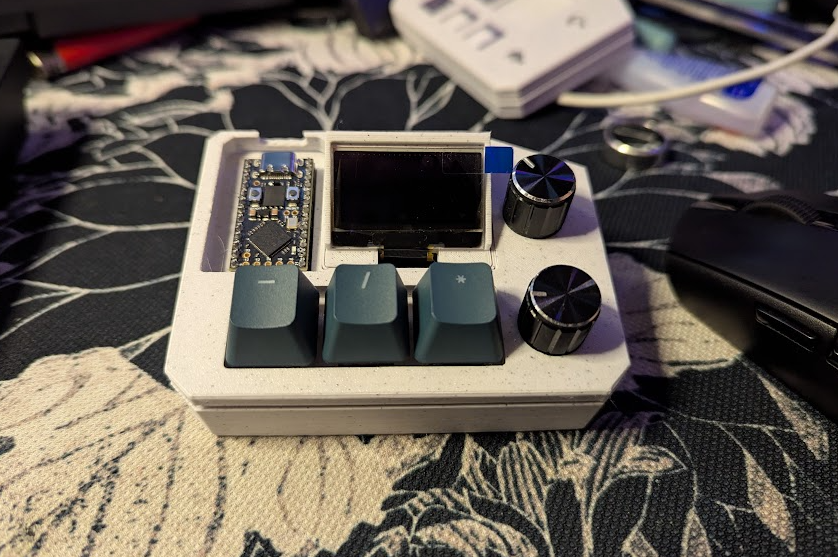

  • Log 5.2:
    neatloaf703/15/2025 at 17:34 0 comments
    I think I will move forward with this case design, I think the extra thickness looks good.
  • Log 5.1: New enclosure
    neatloaf703/14/2025 at 23:08 0 comments
    I made a new 2 piece enclosure with the upper piece acting as the top plate.
    I am currently making a "high profile" enclosure, where the bottom of the keycaps will be about flush with the top of the enclosure, as opposed to the floating key design shown above. I will see which one looks better and then hopefully begin wiring everything up.
  • Log 5: Prototype Enclosure
    neatloaf703/13/2025 at 02:44 0 comments
    I printed out a test enclosure to check fitment on everything and it turned out pretty well. I got alot of warping on the top plate but it still fit. The entire assembly is larger than i'd like it to be so I'll see how I can save space on the next design iteration.
    I want to avoid cutting the perfboard since I'm not very good at it, it looks like I can save some space by seating the pcbs directly against the enclosure wall, or even by having them sit slightly inside the wall. I need to figure out a good way to make a two piece enclosure so I can sandwich the plate between the two pieces. I have alot of space so I should be able to wire everything fairly easily. I am going to solder in the female headers to allow the pro micro and screen to stand on their own, and then will start routing wires. I may have to switch some pins around depending on how well I can utilize the space. The hardest things to wire will be the key switches but I can do that last.
