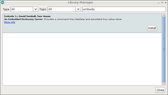

Installing Embedis
To Install Embedis in the Arduino IDE, please see the Detailed Install Directions. Embedis is installed using the Arduino Library Manager, from the top menu bar :
Sketch -> Include Library -> Manage Libraries -> Embedis

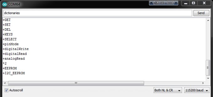

Embedis Dictionaries :
Now this is where it gets really interesting, you have two (2) different memories available to you to store your data in, which in Embedis are referred to as "DICTIONARIES" and these are named EEPROM (internal to the CPU) and I2C_EEPROM (external chip on the I2C bus) :

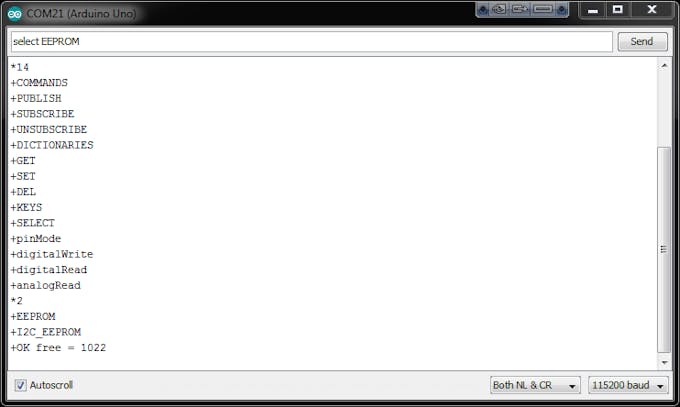

Embedis Select :
By using the Embedis "select" command, you can select which memory you are going to use to read and write, for example when you type "select EEPROM", then Embedis will return the number of bytes of free space in the EEPROM dictionary. The Uno gives you 1024 bytes of EEPROM, and two (2) of those bytes are used by Embedis for a pointer, so you have 1022 bytes to work with

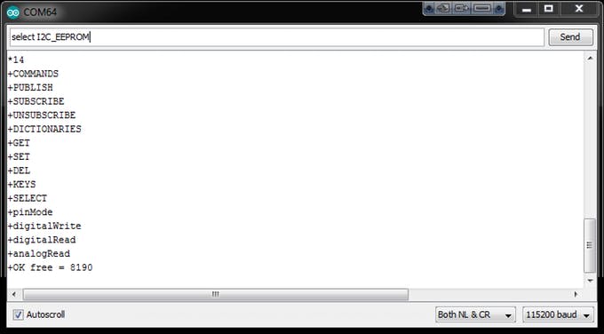

Embedis I2C_EEPROM :
Similarly, when you "select I2C_EEPROM", Embedis will select the I2C_EEPROM and return the number of free bytes in that Embedis Keystore. If you are using a 24AA64, you will see that you have almost 8K bytes of storage to work with, and if using a 24AA256 you will have almost 32K of storage space! In the example below, we are using an 8K x 8 (24AA64) I2C EEPROM part :

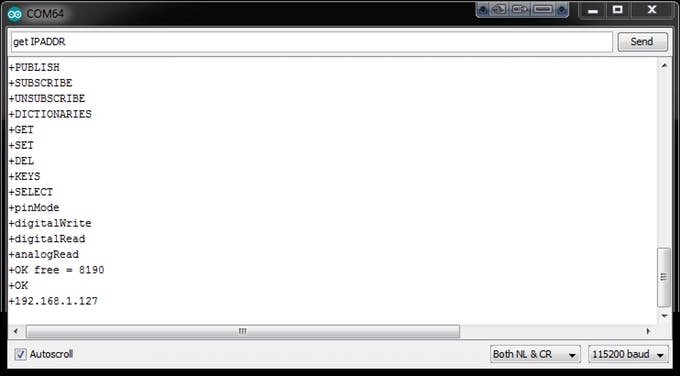

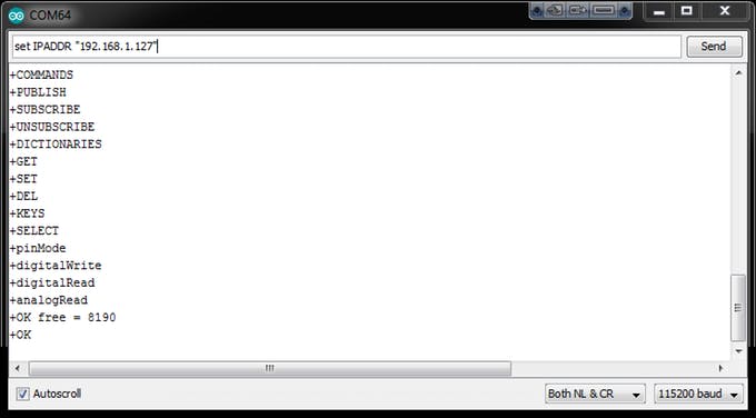

Embedis Set/Get/Del
Now you can start to add data to your Embedis Keystore using the "set" and "get" commands. Since the last "Dictionary" that was selected was the I2C_EEPROM, that is where our data will be written, for example :
So we created a key named "IPADDR" and set it to "192.168.1.127" . Make sure to use quotes around any string with spaces or special characters. Now let's use the "get IPADDR" command to retrieve the data from the Embedis Keystore.
There are many advanced features of Embedis, including the ability to publish and subscribe to changes in keys and the logging system. We'll cover those in upcoming projects here at the thingSoC platform!
