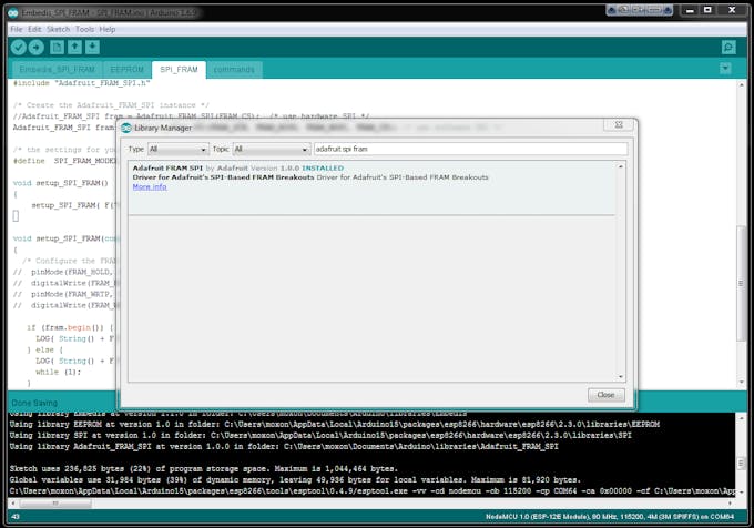

    Installing the Adafruit SPI FRAM Library
    The Adafruit FRAM SPI library is installed using the Arduino Library Manager, from the top menu bar :
    Sketch -> Include Library -> Manage Libraries -> Adafruit FRAM SPI

    After installing the Embedis library in the Arduino IDE, the Embedis examples will be available under the menu as :
    File -> Examples -> Embedis -> esp8266 -> Embedis_SPI_FRAM
    Make sure to select your specific ESP8266 board model under the Board Manager, and set the "port" to the correct COM: port for your board. Then just press the "Download" button to compile and download your project.
