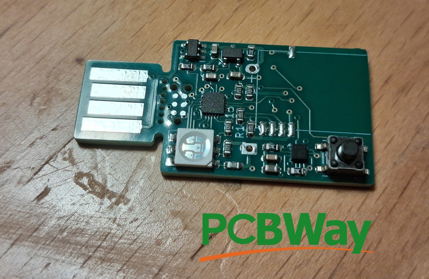

    Back in January I finished the rev 2 board (mentioned in previous post). Liam from PCBWay kindly offered to sponsor the board. It was finished and arrived in just a few weeks time. The board is very well-made, as I have come to expect from PCBWay them (I use them also for work).
    I have confirmed that I can program the microcontroller and done some basic checks of the LEDs, etc. Unfortunately, this year has been very busy, so I have been unable to do more checks of the board.

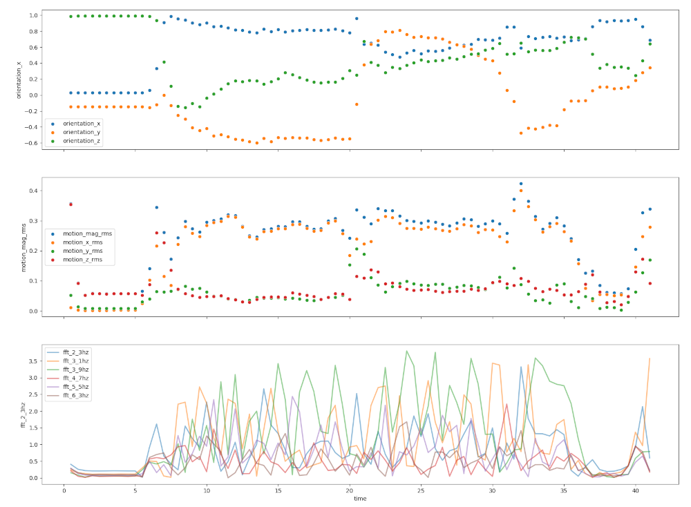

    However, I was able to improve the software stack for doing motion classification with the emlearn machine learning library.
    There is now a C implementation of a motion preprocessor/ feature extractor, in addition to the MicroPython motion preprocessing code that already existed.

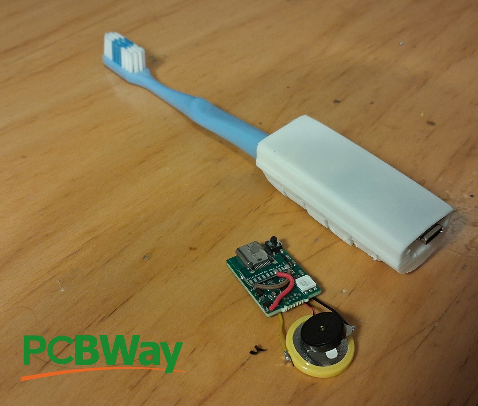

    Last Christmas I also created an example project, an automatic toothbrush timer that uses the accelerometer to track time being actively spent brushing. It is currently running MicroPython with emlearn-micropython on an ESP32-based device from M5Stack. I am now porting the toothbrush firmware to this board, using the above C preprocessing code.
    Motion during toothbrush session
    Motion decomposed into different features: orientation, overall energy, and energy per frequency band (using FFT)
    Trying out the board for the toothbrush usecase revealed a few shortcomings. The main one being that it would be nice to have a USB Type-C socket instead of Type A edge connector, to avoid something sticking out of the device. For now I have done a quick hack by soldering on an external USB Type-C connector breakout. But this is something I am considering changing for future revisions.
    Toothbrush timer with quick adaptation of board
    USB Type C connector was retrofitted. Needs some firmware work for the Puya PY32F microcontroller.

    Revision 2 board for motion
    The main changes are as follows:
    • Size is now 20x40mm (including USB Type A for charging), down from 26x52 mm.
    • Has connector for a LIR button cell battery. LIR1220 or LIR1632 should both fit
    • Has a button in addition to RGB LED, to support basic user interactions
    Also fixed a couple of design issues, like there was no 3.3V regulator (I thought running off battery would be OK, but the voltage was too high for some components).
    I might do a couple of more tests on the rev1 board to make sure there are no other issue. But otherwise, I think this is ready to send to production.
