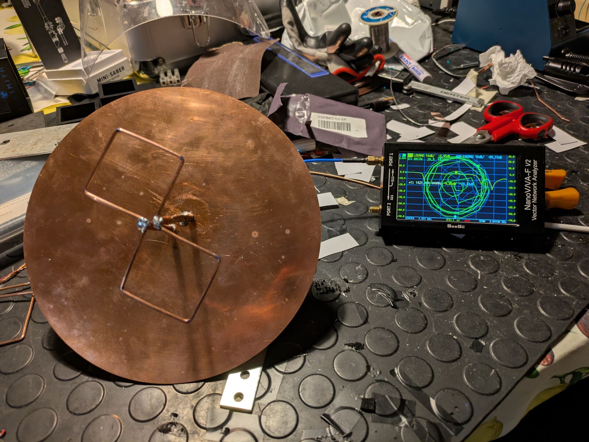

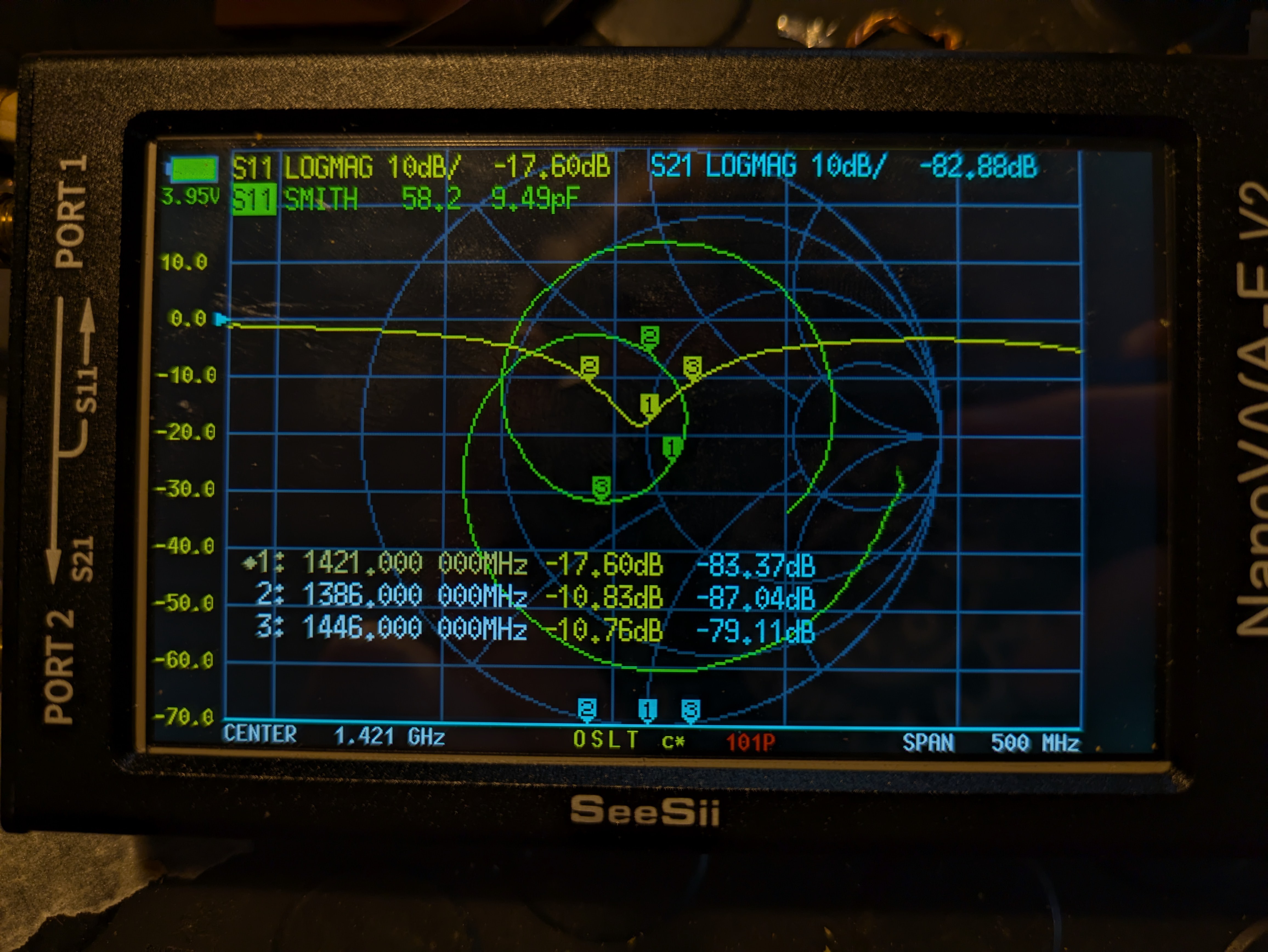

    The first thing I did was actually measure that old CanAntenna feed you see in my previous logs. Back then, I just followed the theoretical dimensions and hoped for the best because I didn't have the tools to test it. Well, I finally hooked it up to a VNA and found out it was barely tuned at all. I had an S11 of only -5dB at 1421MHz. In plain English, the feed was basically "deaf" to the Hydrogen Line. No wonder my 1.2m dish wasn't performing like it should have.
    So, I decided to start from scratch and build a Biquad antenna. I chose this design because it’s not crazy complicated to build, it performs better than a simple dipole, and it’s a much better symmetric illuminator for my parabolic dish. I also used it as an excuse to learn how to simulate antennas in MatLab. I have to tell you though, the simulation only gave me a rough starting point. In the real world, almost every dimension changed. Simulations usually assume ideal conditions with air, vacuum, and materials that just don't exist in a garage.
    I ended up building at least six different versions of this Biquad before I finally hit the right resonance frequency. It was a total grind. Some were too long, some were too short, and every time I adjusted the distance from the reflector plate, it threw the resonance off again. This whole manual, experimental process was only possible thanks to a NanoVNA. Without a tool like that for spectrum analysis, you’re just guessing. I learned that the hard way with my first antenna.
    Biquad Antenna next to my VNA
    Once I finally got the Biquad resonant at 1420MHz, I added a small microwave circuit on the back. It’s just a strip of copper acting as an impedance transformer to get the antenna to 50 ohms. This makes a massive difference because it stops signal reflections caused by impedance mismatch, meaning more signal actually makes it into the system.
    Performance of the biquad antenna on my VNA. We get -18dB at Hydrogen Line frequency, which is great!

    If you're thinking of building one of these, here is my advice from the trenches. I started with the theoretical square shapes and just kept rebuilding them bigger or smaller depending on if the frequency was too high or too low.
    Don't underestimate the distance between the Biquad and the reflector plate; moving it even a tiny bit changes the entire behavior of the antenna.
    Also, don't bother 3D printing jigs to bend the copper wire perfectly. I tried that at first, but since I had to make so many versions, it was a waste of time. A simple ruler and some pliers work just fine if you're patient.
