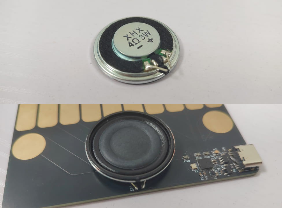

    I finally allocated the time to solder this on. The enameled wire I've purchased was too thin, so I reached for the leftover clipped leads from through-hole LEDs.
    Montage of the assembly process: (1) the speaker with wires soldered on; (2) the speaker soldered to the board.
    It takes some tweaking to get the length and angle right, but it is cakewalk overall (especially with a newly replaced iron tip ^ ^).
    The entire assembled board, the speaker further bound by two thin stripes of black electrical tape.
    The speaker's single side of connection did not feel secure enough; it seemed that the soldering pads might get pulled off anytime soon. I finally resorted to electrical tape again, but I don't think this is the best way. I need some inspiration >_<

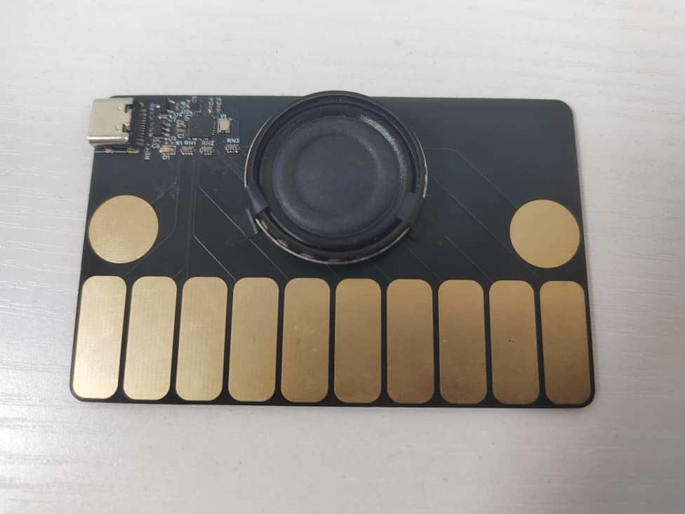

    Let me introduce you to the new revision — Canta CC!
    Assembled card device.
    Among friends who have received the last batch (Rev. 2), there is this recurring curiosity that one day the user will be able to customize the instrument as they like. In this revision, I hope to bring that into reality.
    The updated set of components were selected for USB connectivity and improved performance, while still maintaining a decently low cost. The microcontroller here is the CH591, a lightweight wireless RISC-V MCU by Nanjing Qinheng Microelectronics (also known as WCH). The audio amplifier is now the hobbyists' staple MAX98357, but in its tiniest WLP package.
    Empty circuit boards with footprints for updated components.
    The inner workings stayed the same. Touch pads are still sensed with the RC network despite our new MCU integrating a touch-key peripheral, as I hope to keep the code and hardware construction widely portable with minimal changes (in case of further reincarnations, right? >_^). The digital audio bus (I2S) is still emulated with SPI lines with a timer output nudged into lockstep by a string of nop's.

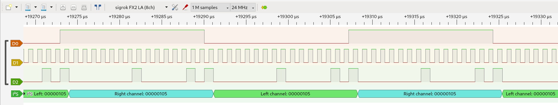

    Probing I2S signals into such a tiny chip is impossible (almost), so there is a switch in the code that re-routes I2S to the exposed touch pads. The 16-bit 0x0105 pattern is a good one when wrapping my head around the timings.
    Logic analyzer screenshot depicting time-aligned signals and the bit pattern of 0x0105 helping to identify byte borders.

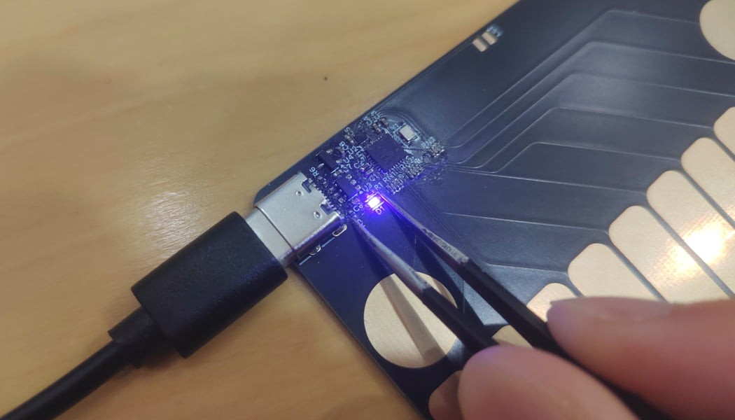

    Now that the MCU carries USB, we no longer need a separate debug connector. When a specific pin (PB22) is shorted to ground at boot, the device enters the factory bootloader which allows program upload through USB. Here, during normal operation, PB22 functions as the activity LED's cathode, so entering bootloader is as simple as clipping specific points on the board with a tweezer.
    Tweezers shorting the correct pins on the board, while the LED lights up.
