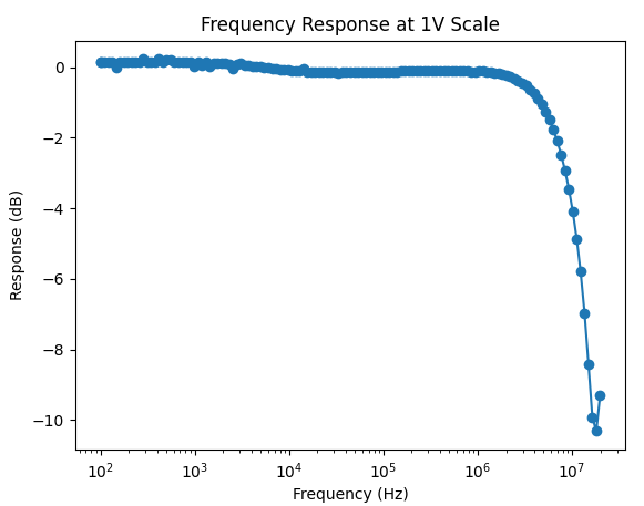

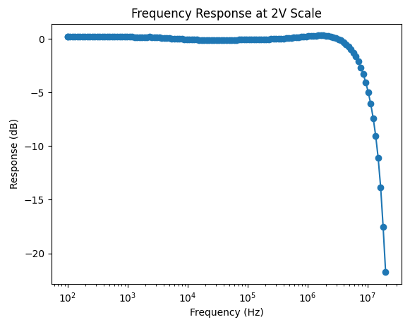

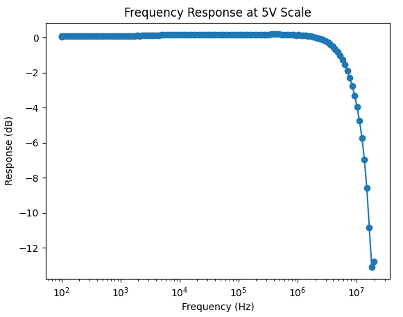

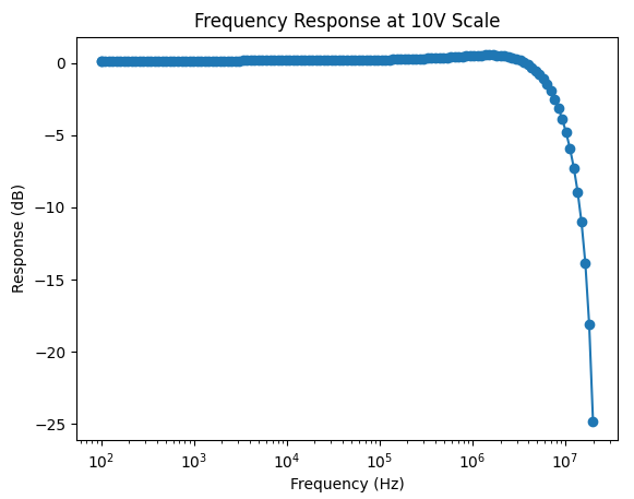

Frequency Response
Here is a measured frequency response for each of the ranges. The frequency response is shaped digitally via a 3 point FIR filter. That is, this is the overall system frequency response, not just the analog front end response.

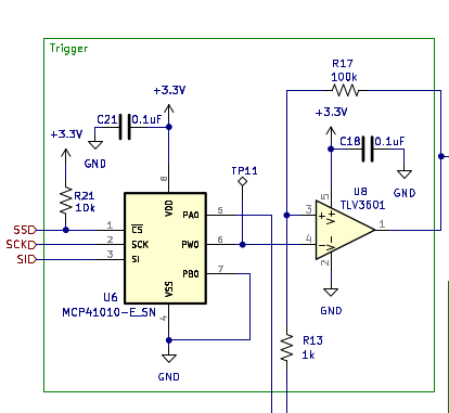

Triggering
The system has two triggering modes, force trigger and normal trigger. Force trigger starts the capture when the trigger is initiated, whereas normal trigger waits for a trigger edge event before starting the capture. With normal trigger mode, the trigger event is recorded at the center of the capture. Normal trigger is achieved with a comparator and a settable trigger voltage as shown below:
There is also a trigger correction algorithm in Voltpeek to properly center the trigger event.

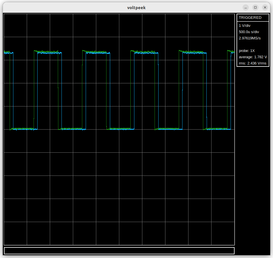

  • Asynchronous Multiple Channels
    schuyler406/16/2025 at 23:06 0 comments
    I have begun work on multiple channels. Multiple channels are implemented by plugging in multiple NS1s into the same host computer; Voltpeek can then connect to both of them and capture data. Each NS1 is a channel. The channels are not synchronized yet. The waveforms below show the same square wave, but they appear offset. There is a way to synchronize them using the trigger circuit; I just haven't tried to implement it yet.

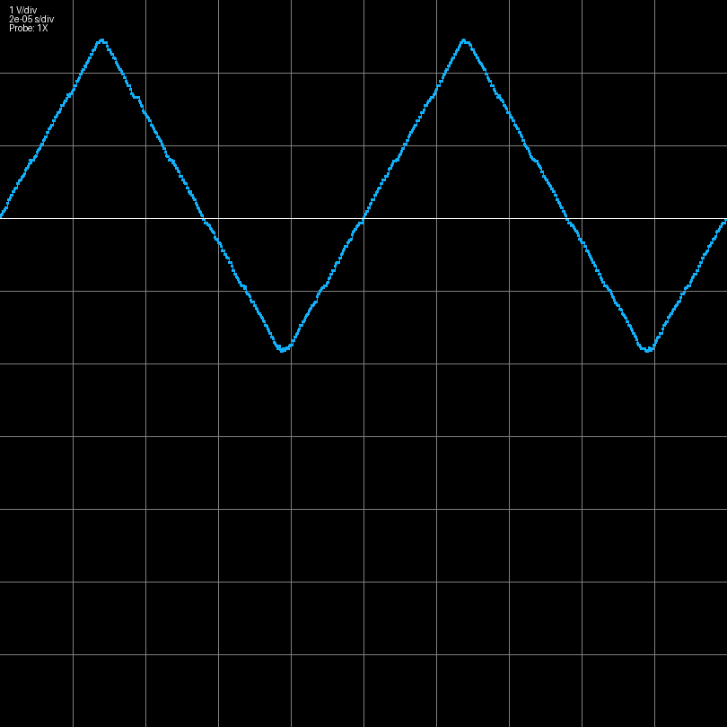

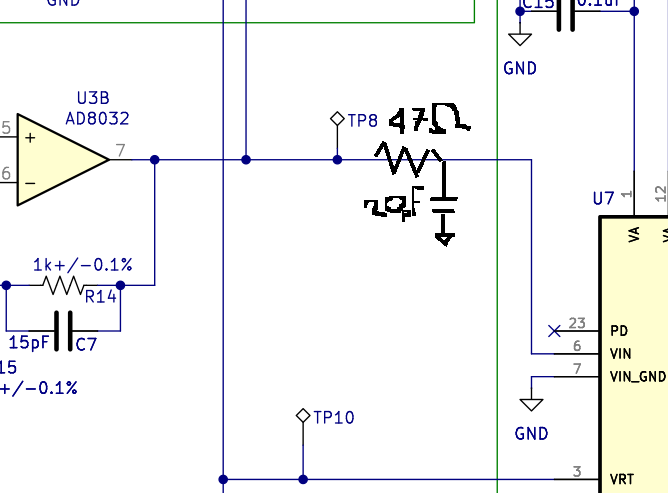

  • Distortion Improvement
    schuyler406/03/2025 at 21:32 0 comments
    I have discovered that adding a low pass filter in between the last op amp stage and the ADC like shown below improves the distortion performance of the scope.
    This has -3dB frequency of ~170MHz, so it does not lower the bandwidth of the scope. Rather, as mentioned in the datasheet of the ADC08100, the circuit absorbs energy coming out of the ADC input.
    Below are triangle waves measured using scopes without and with this modification.
    Without low pass filter:
    With low pass filter:
