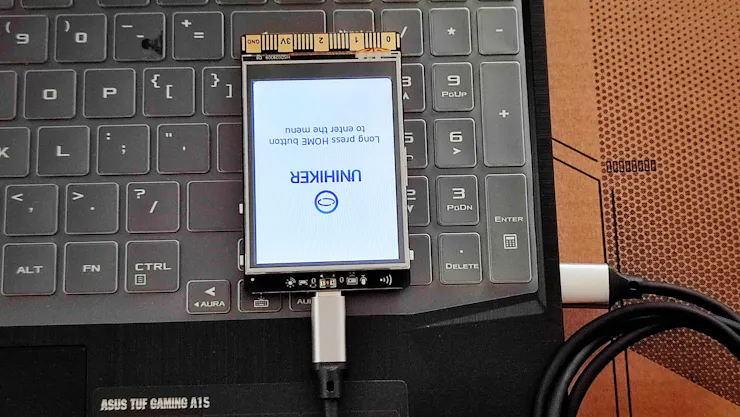

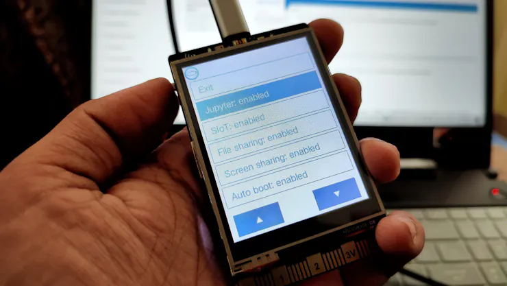

    Setting up UNIHIKER is straightforward, using a Jupyter Notebook for programming in this project. Follow these steps below to enable Jupyter programming.
    • Connect the UNIHIKER device to your PC.
    • Wait for it to boot up and the home screen to appear.
    • Press the HOME button to bring up the menu.
    • Navigate to the Service Toggle option using the up and down buttons.
    • Enable Jupyter in the Service Toggle and wait for it to activate.
    This completes the setup on the device side; now we will proceed to file uploading and programming on the PC.

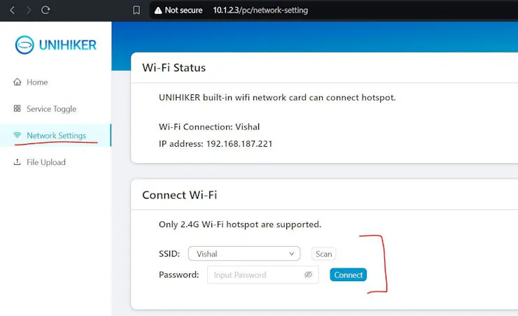

    After following the above steps, proceed to the PC.
    Open your browser and type "10.1.2.3" in the address bar. The UNHIKER page will appear, giving you control over the device.
    • Go to the network settings.
    • In the "Connect Wi-Fi" section, connect to your Wi-Fi network.
    After connecting to Wi-Fi, it will be able to update the time from the internet.
