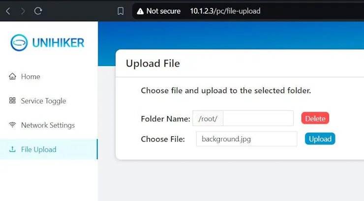

4Uploading Image and Code
Now it's time to upload the Python script and image to the board.
- Download the python file and background image from Github.
- Click on the File Upload section.
- Make sure the folder name field is empty.
- Click on "Click to Select File" and choose the Python file, then click on "Upload".
- Click again on "Click to Select File" and choose the background image, then click on "Upload".
To view all the files, go to the Service Toggle and click on "Open page in Jupyter" section. The next page will show the file selection for the board, where you can verify all the files and images.

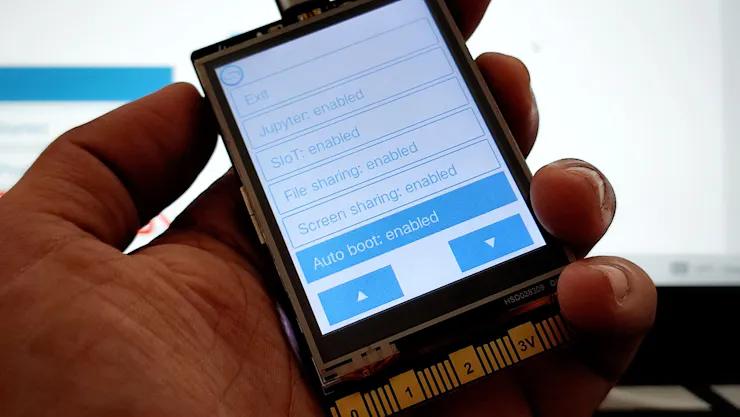

5Run Code on Startup in UNIHIKER
By default, the code won't run at startup. You need to enable auto boot.
- Power the UNIHIKER with a Type-C cable.
- Press the HOME button to enter the menu.
- Find and open the Service Toggle in the menu.
- Now enable the Auto Boot option.
Now the device will automatically start the last running code 5 seconds after booting. After enabling the auto boot option, run the program once so it can auto-run on boot.
- Find "Run Programs" in the menu and open it.
- Here, navigate to the /root/ directory where all the files were uploaded.
- Run the EcoSpectrum_Timepiece.py code and wait for it to show the dog face.
Now, it can be powered off and will run the program automatically 5 seconds after booting.

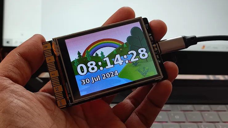

6Done
Done
The EcoSpectrum Timepiece is now ready to enhance any desk with its vibrant and serene design. Perfect for both home and office environments, this desk clock not only adds a touch of coolness to your workspace but also ensures you stay on time.
Featuring a Type-C connection, it offers convenient and versatile connectivity options, making it easy to set up anywhere. Thanks to its internet connection, the EcoSpectrum Timepiece maintains accurate time without any chance of loss, ensuring you’re always on schedule.
